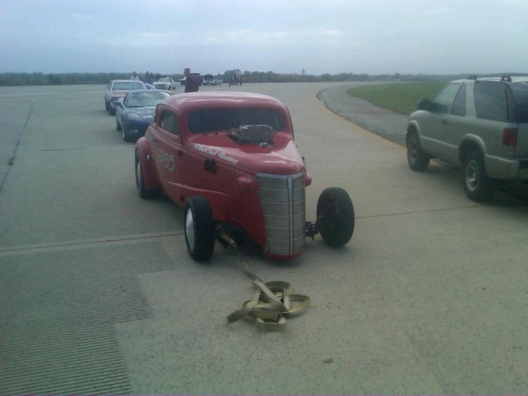

  5. Yeah - I made it ALL the way to the end (didn't go past the end) and deliberately turned the car around on the LEFT side of the track facing back up the track (thinking that would make the tow easy). Also, didn't want anything to leak on the track, so I pulled onto the grass apron. BAD IDEA :eek:: As I forgot the left side is the "I'm in danger!" side.
    So about 15 seconds after stopping and starting the 'get out of the belts fun' - I see all the crews come racing, lights blazing and now I've shutdown the track . . . you then realize that you're the dumbass that just caused all the drama (not a proud moment). So as TMAN said - might as well have crapped my pants and sat there in it, would not have made it any worse on me.
    I will say that the ECTA track crew (and the FlatCad team) were very professional, to the point and also gentleman in their conversations with me - can't say enough about them. Obviously safety is #1 - Keith T. was gracious but clear in his talk with me . . . all of which I deserved.
    If I'd pulled the chute earlier and quit thinking about it opening and just stepped on the brakes a LOT harder, wouldn't have had any issues. You might say I learned something on Saturday . . . to NOT do again. There was absolutely no reason for me to not make the turn-out . . . so the blame is squarely on me.

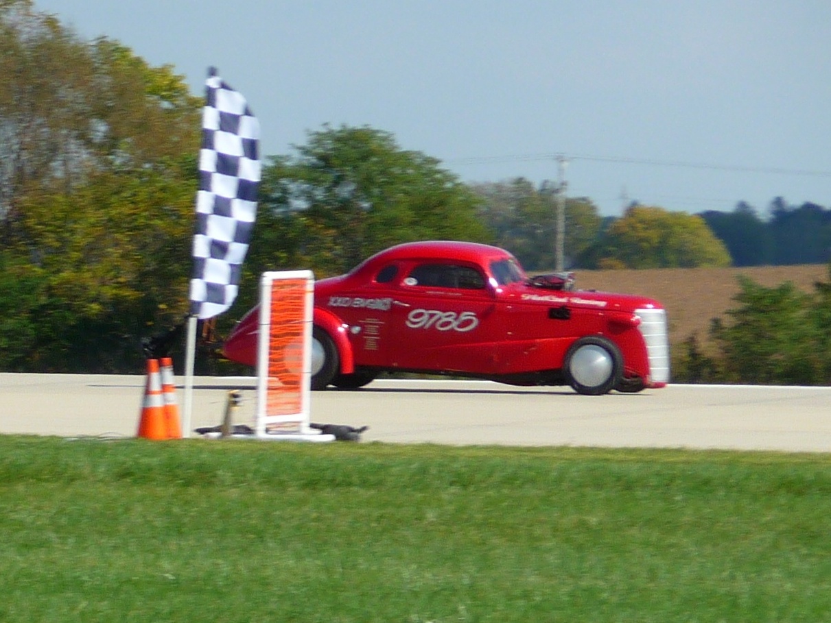

    What a year!
    Bonneville was great, even if the car was set up too light.
    The Ohio Mile was a big learning experience, engine wise. We had been taking little steps all year long, and Sunday I decided to roll the dice. Much to Dale's consternation, I decided to run the engine HARD, with a max tune on. 16lbs boost, shut the rev limiter off, and told Danny to drive the effing car to 6000. Dale was very hesitant, but I said something like "Eff it- we built it to race, not take pictures of!"
    Unfortunately, I thought we could pull the 2.96 gears in the mile, and have a speed of 169. Wrong-the track is just too short! I should have left the 3:08's in there. Danny drove the wheels off of the car, and crossed the finish line in 3rd gear, at 152.592 mph, and 6100 rpms.
    The engine sounded like an angry herd of water buffalo! So, we know the engine has a LOT of potential left, if we make the right tweaks to it this winter.
    ....and Dale, we won't run it like that again!
    ..........Unless we have to, to make 200mph!:eek:;):D

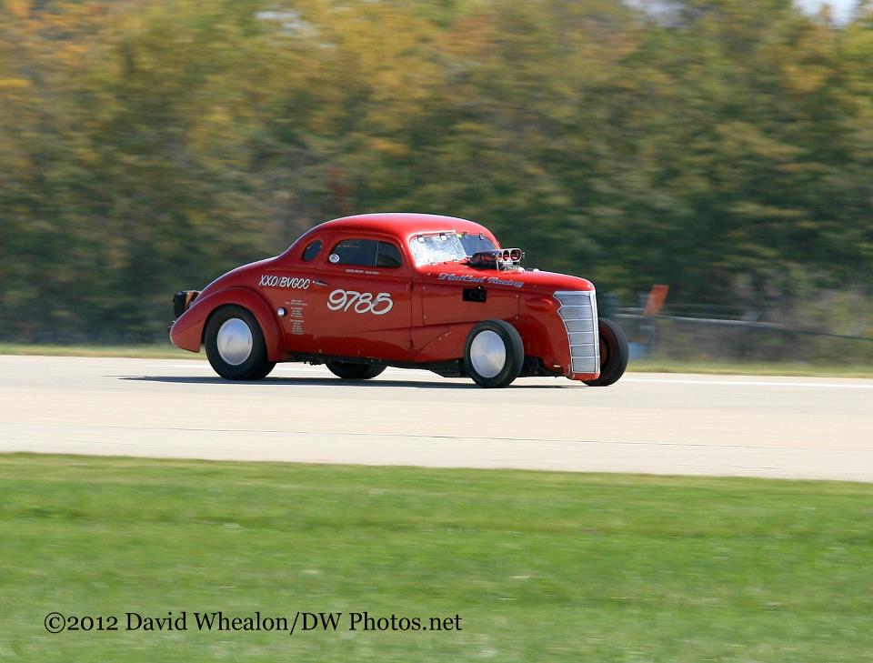

    Here are some more Ohio Mile pics by Woody!

  22. [​IMG]
    now that is one cool picture...................
  23. I agree Carl. ^^^^^
