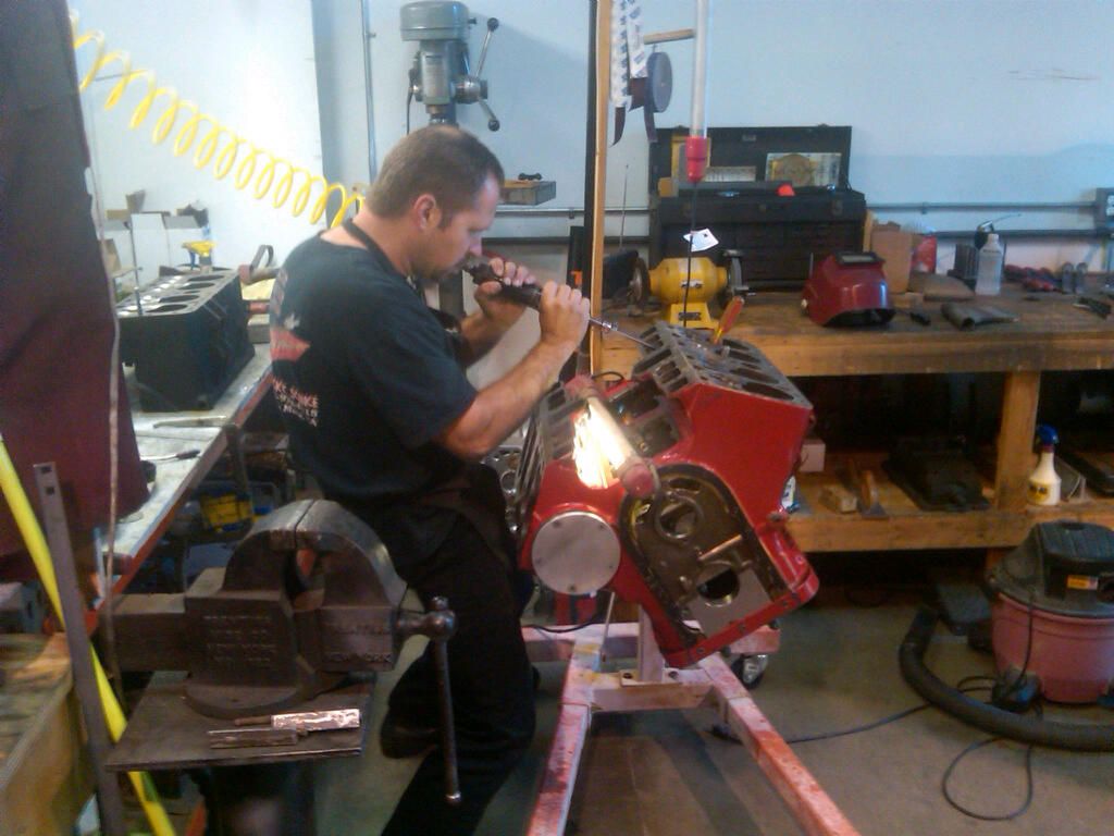

    I've just returned from 5 days In California, on a quest for more HP in the flathead- wow, did I ever get my arse kicked! More on that later!
    Tuesday morning, I met Rex Schimmer for breakfast, then we headed over to Dema Elgin's, and spoke with him about a cam. Rex, thanks for taking the time to meet with me-it was good to see you again!
    From Dema's I headed down to Rich Fox's, to pick up a tranny he loaned me. Always good to see you Rich!
    Then, on to Don's (Pops29) place, where I picked up the test chambers he cut, so that I could modify them, instead of our real heads. Don's always on top of this stuff!
    Tuesday night I was in Arroyo Grande, having supper with Garry Odbert. Garry was an immense help on everything- he even had his test block there, so we could compare the porting to his. Garry runs the Retarded Spark Special, a record setting Caddy flathead powered roadster. Thanks Garry!

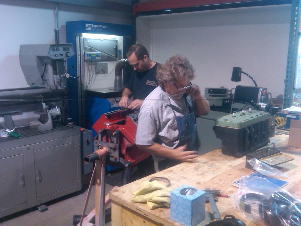

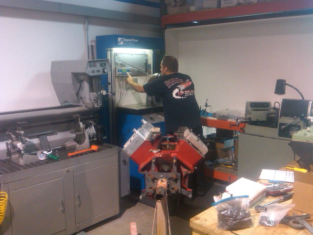

    Wednesday morning, Garry and I headed over to Race Engine systems, in Santa Maria, owned by Craig Gerfen. Craig was Alan Johnson's top fuel port and flow guy for 8 years, and had also ported Garry's Caddy flathead.

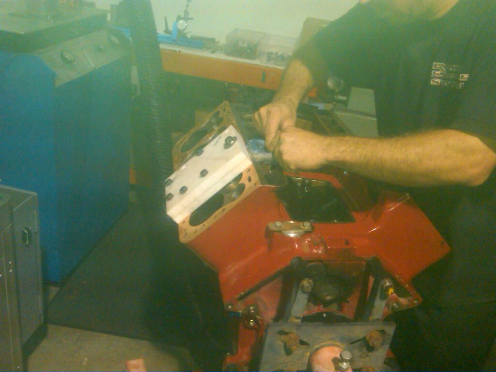

    Here is where the arse kicking started! I'm not going to post every number, test, and dye test we did, but I'll tell you what we found out. Plain and simply put, the ports are too LARGE, therefore velocity suffers, and they don't flow as well as they could. Across the board, we're down about 20 CFM from Garry's. We flowed my engine, then Garry's, back to mine, etc', so the data was current and reliable.
    After, trying everything to increase flow- different valve angles, different valves, different chamber designs, blending the valve guides, etc., to no avail, we tried a different approach. We added material around the short side radius. BAM- an instant 10 CFM gain! We played with this for a while, and determined we need to add material back to the ports, then do another port job. We also played with the relieved block, but that only reinforced my previous belief, and that belief is that it is a waste of time.
    So, I called Frank Morris with the Salt Cat guys, to find out what epoxy they had used on the Buick engine. Frank and Doug are great guys! Frank gave me the info I needed, sold me a set of 29" tires, so it was a win/win conversation for me! Thank's Frank!
    So, it can't get any worse, right? Wrong! We flowed the exhaust, and they sure do flow- too damn much! The exhaust out flow the intakes, and that is not good! That correction will come with the cam choice- my guess is we'll end up with a dual pattern cam.

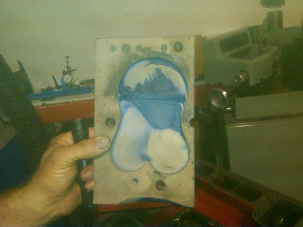

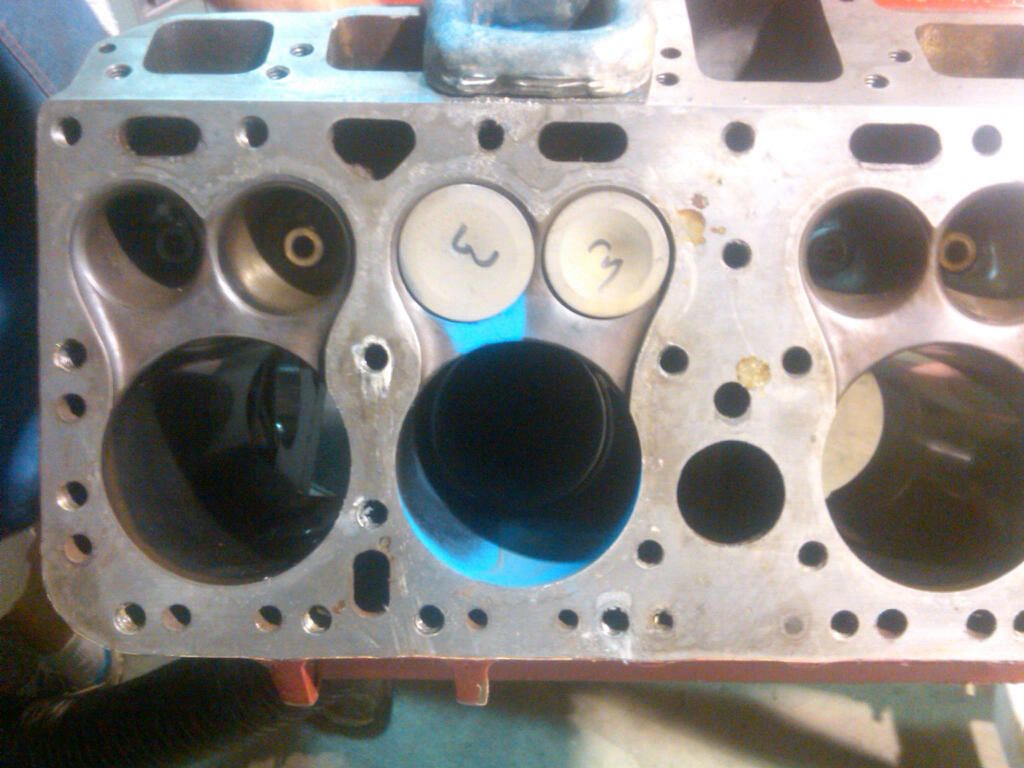

    We did a couple of dye tests, to see what was going on in the chambers. With our current setup, the A/F mixture swirls around in the chamber, running back into itself- basically creates a traffic jam in the chamber. We took the angled ramp out, and straightened that transfer area out. On my engine, we see a small inrease on flow, but a lot better flow pattern out of the dye.
    At the end of the day, the stock block, ported, with a stock 106 CC Caddy head, flows better than the FlatCad head and either of the 2 mods I made, better than Edmunds, and better than Cyclone! The stock head has several complex contours and ramps in it, and flows well- it appears the Caddy engineers really knew their stuff!
    So, to gain the CFM I went to California for, we need to add material to the ports, re-port the block, and change our chamber design. Here are numbers from the #8 cylinder, which is the best flowing cylinder on Garry's car- he flows 200 CFM on the intake side. Our best cylinder was # 3
