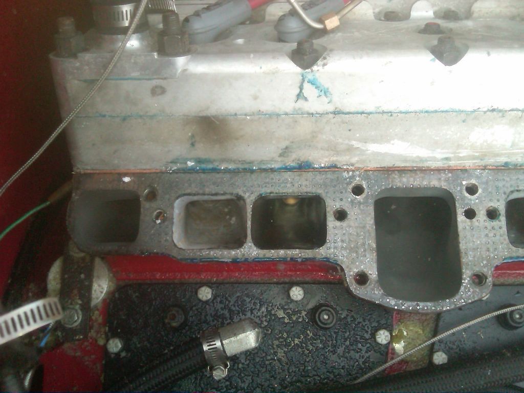

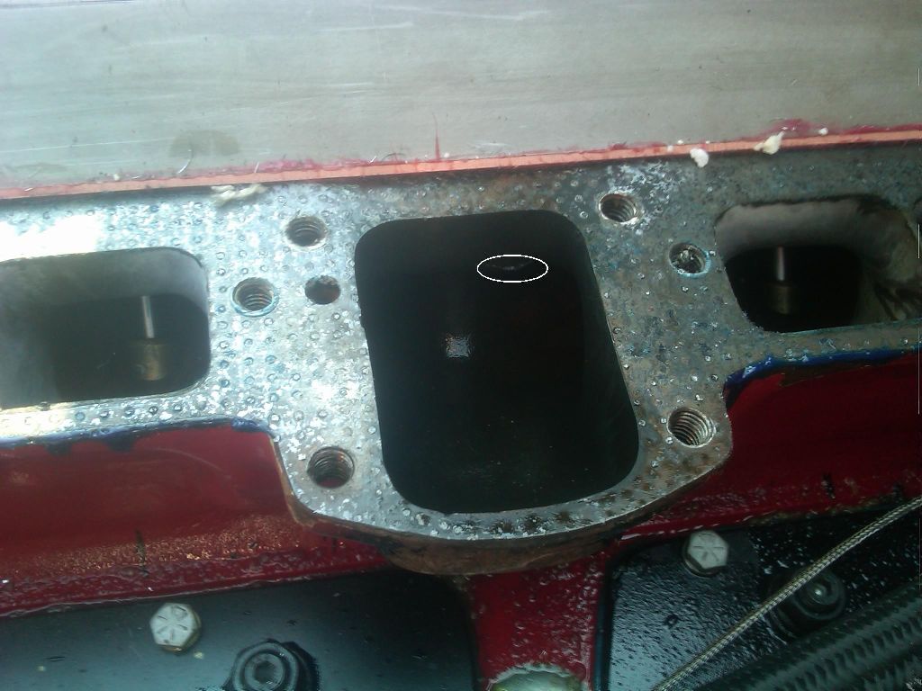

    Wednesday morning, everyone was excited. We drain the engine water every night, because I'm not comfortable leaving the block full with the copper head gaskets.
    Daaaamn guys, we have an air leak in the system-I can't get it burped! Double daaaamn, looks like a head gasket! We pulled the car out of impound, back to the pits, and swapped the passenger head gasket. Oooops-now it's poring water! Long story short, we had cracked the #6 exhaust port, so we loaded up and came home.
    I tore into the engine on Friday, and found the problem. Good thing is, that it's not too tough of a fix. I also noticed the #5 intake looks too clean, so we're going to have to investigate that for a possible leak.

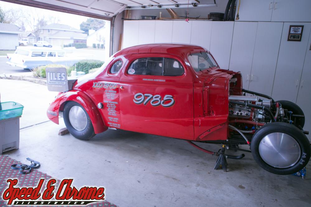

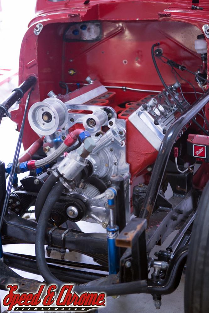

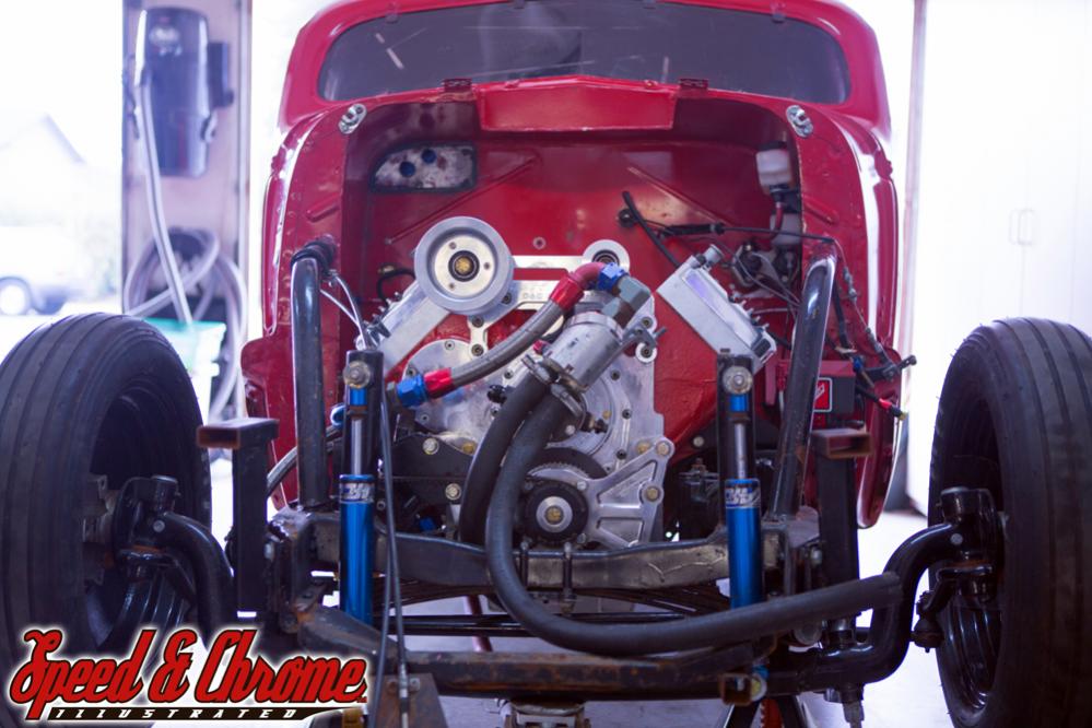

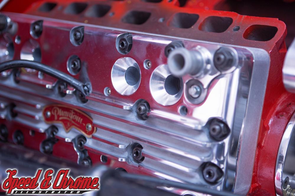

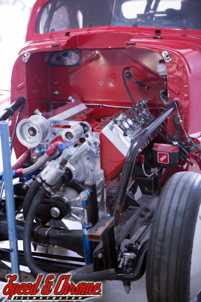

    Dropped by the FlatCad HQ today and grabbed a couple of shots as they were mocking up the new motor.
