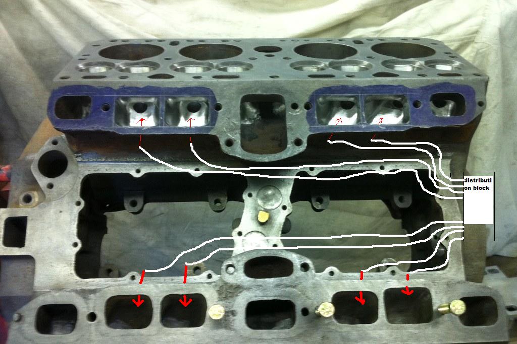

    Looks like the motor is an 1800 RPM deal, and you've got about a 3:1 ratio on the pulleys. Do you need to spin the pump at 5400 RPM?

    I'm not sure that we need to spin it that fast-I simply configured pulleys that would turn it about the same ratio we were turning the car dry sump. We'll have to experiment on the bench to see.
    First of, a few clarifications- the port injection will only be used for the alcohol/nitro mix. The gas classes will still just run through the hat. When we run alky, there will be something like a 40/60 split between the hat and port injectors.
    The port injectors will be low in the valley-closer to the valley pans than to the top girdle. The lines will all run out towards the front of the engine, to a second distribution block. I've kind of sketched one side in, in paint, but my artistic abilities leave a lot to be desired!

    Perhaps the fuel nozzles could be mounted in to an aluminum body resembling an EFI injector with on O-ring seal. The nozzle/ injectors could be hard mounted into a fuel rail making an****embly that may be (???) easier to hold in place. Looks like a tough deal no matter what. Especially if your looking to precisely aim the nozzles.

    Well, these were just our initial thoughts.
    We'll go back to putting the ports in the intake. It will be faster anyway, as we won't have to wait on the block.
    I just had a long conversation with John Beck about this .While he thought it would be a little better, power wise, to put them in the ports, he said it's too big of a PITA!
    He said the injectors need to be where we can easily access them, as we'll be pulling and looking at them virtually every run. In addition, he said make sure the distribution block is higher than the nozzles, with no low points in the fuel lines, for alky to sit in. We'll make plenty of power with the alky, and nitro if necessary, anyway.

    We needed to add 'down port nozzles' into the blower manifold - so we have individual port nozzles for alky and fuel. The primary purpose of adding the down nozzles is to enhance fuel distribution and keep it even. There will still be a certain percentage of fuel going through the Enderle Bug Catcher (the 'hat') - in that it is needed to cool the blower. A poppet valve with a pressure controlling spring will be used between the hat fuel distribution block and the down port distribution block. It will open at a certain PSI and direct a portion of the fuel to the down nozzles. John Beck will once again be our dyno/tune guru to help us get all this***** figured out.
    Chris and I met at his work place for a 'Sunday Job' - so we could use his big vertical mill to precision locate, drill and thread the 1/8 NPT down nozzle ports.
    We had to figure out how to mount/hold the dang manifold - and get the right angles (which we set at 45 degrees). The angles on the nozzles match the angle of the spray deflector shields - so this should direct as much fuel spray as possible down the ports.
    Anyway - now it is now onto making the lines and setting up the lower distribution block:
