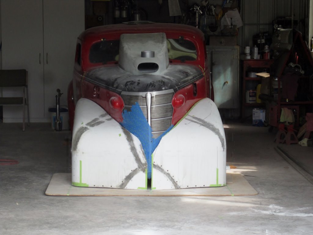

    John K has been working feverishly on the front aero mods. Randy and John set and checked the alignment last weekend.
    John is getting closer on the fibergl*** work. He says the is still a slight difference side to side, but he's gaining on it!
    Nice work, too!

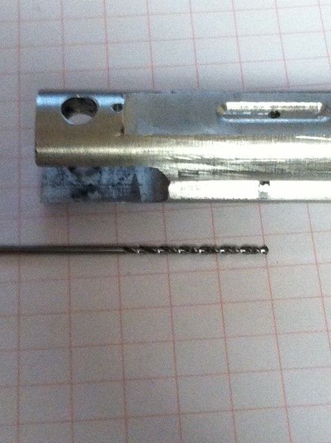

    Small update for all.. I set up the heads and removed the o ring we were using ( .031 ) so we can run a larger wire ( .041 ) with a receiver grove in the block . here is some pics.
    here is one small *** end mill
