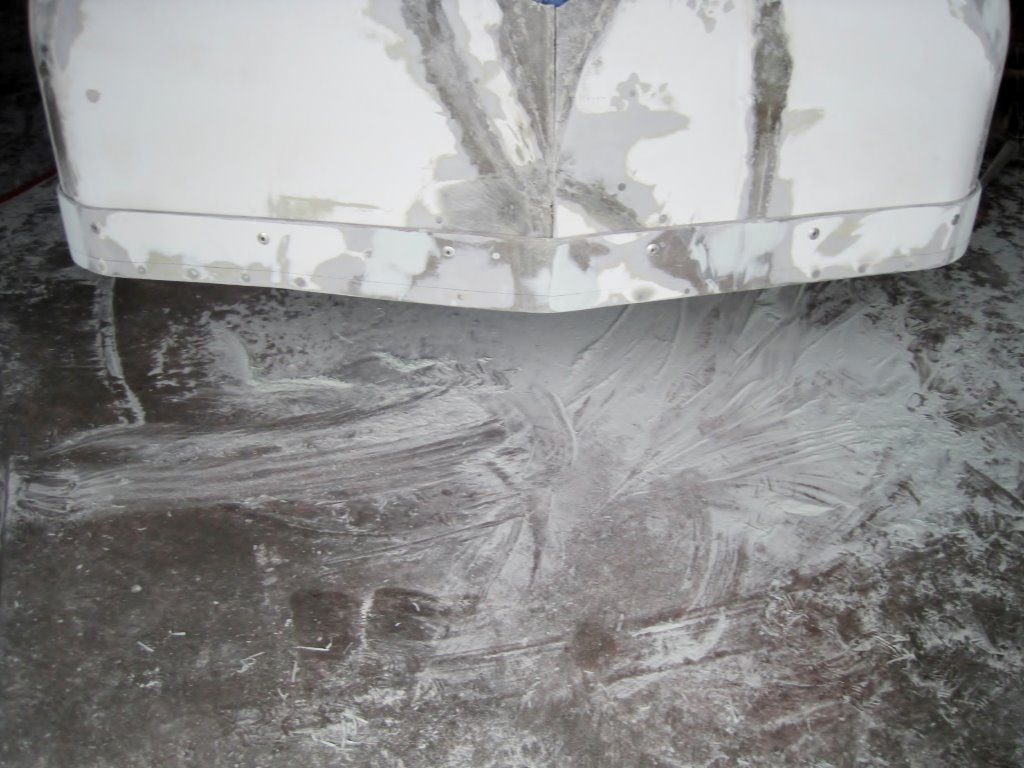

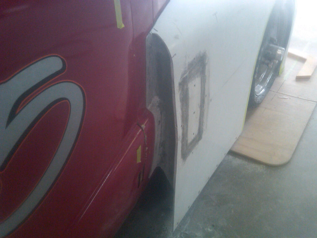

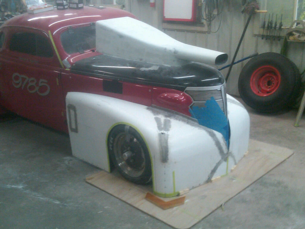

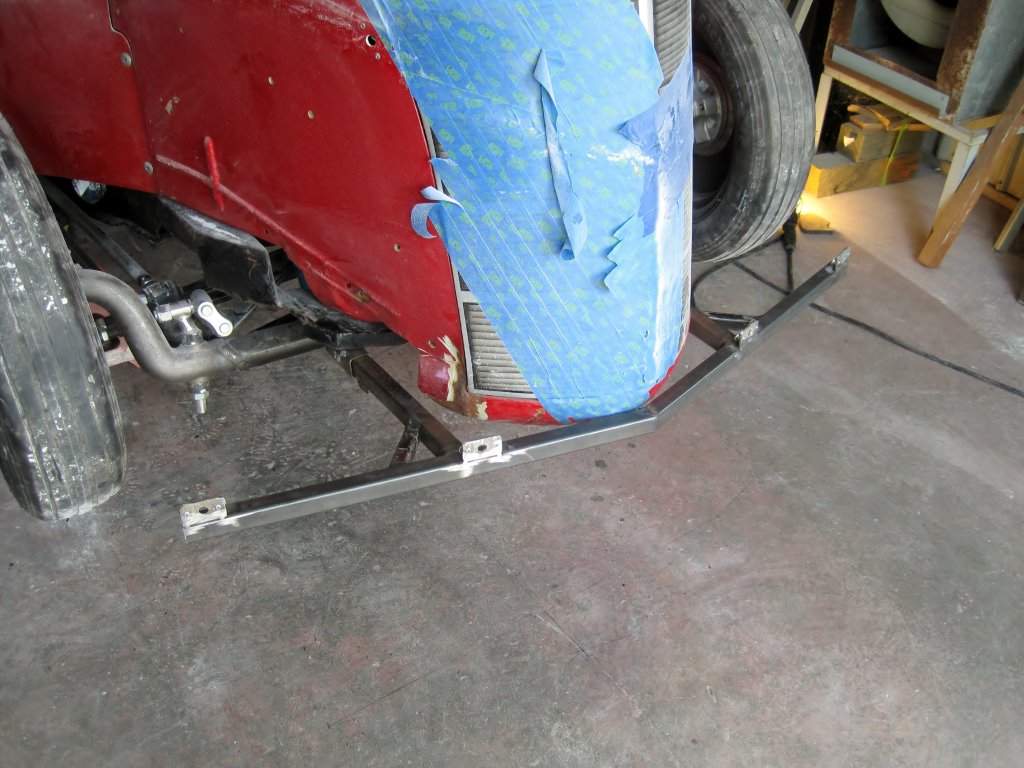

    From John K:

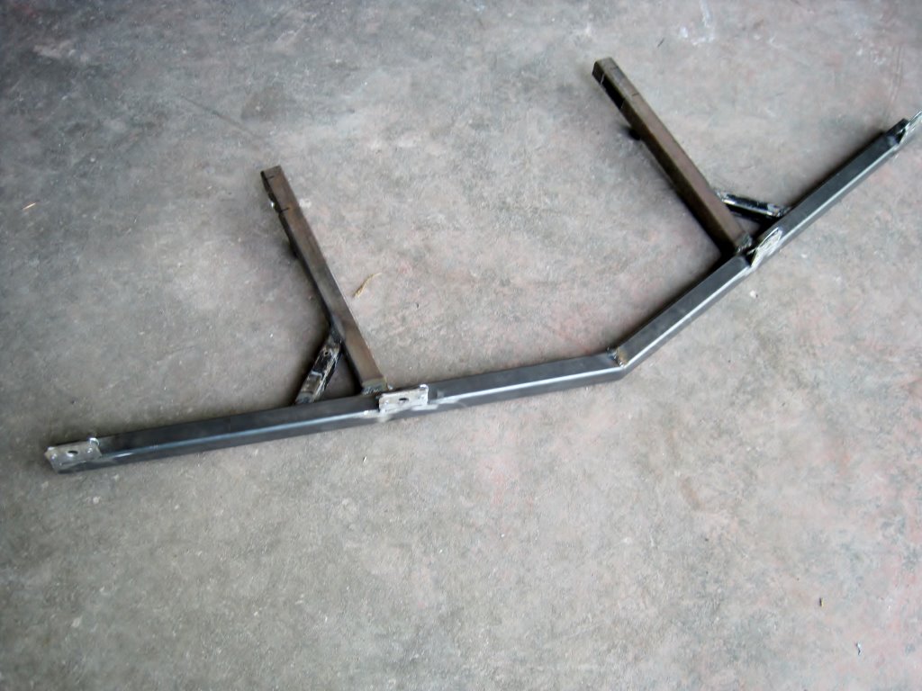

    I made the support for the front of the fibergl*** this morning. It slips into two receivers and is held in place by one dzus on each side.
    I will build the flanges on edges of the fenders where the meet the body tomorrow or Tuesday. This should be the last big fabricating process. I will also work on the removable panel at the lower front. I am nearing the end of the fibergl*** work. I will spend some time smoothing the whole mess out. I am going to wait until Randy gets all of the front suspension completed before I make the final cut on the front wheel openings.
    John, your aero mods are wickedly great! Thanks again!

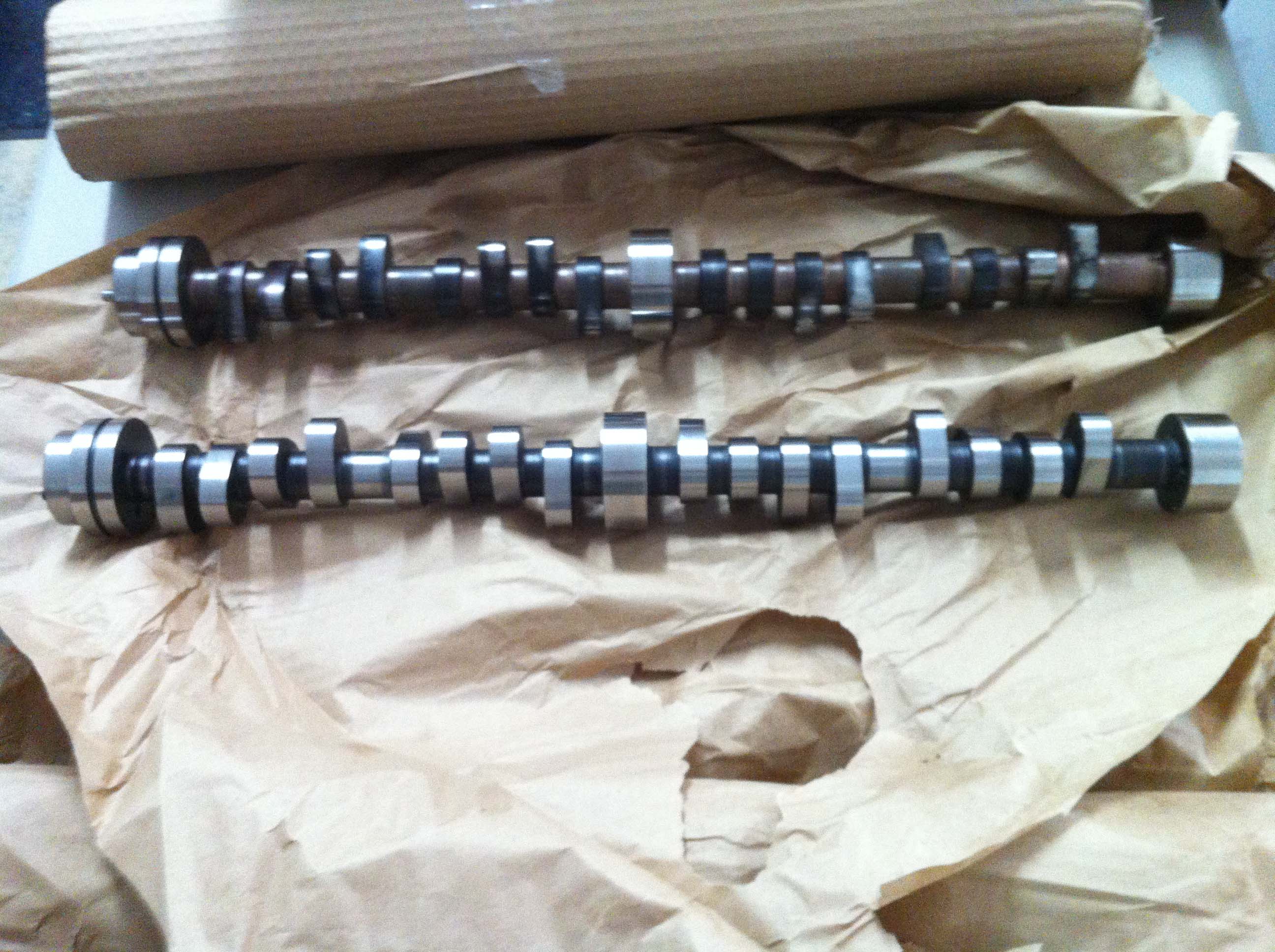

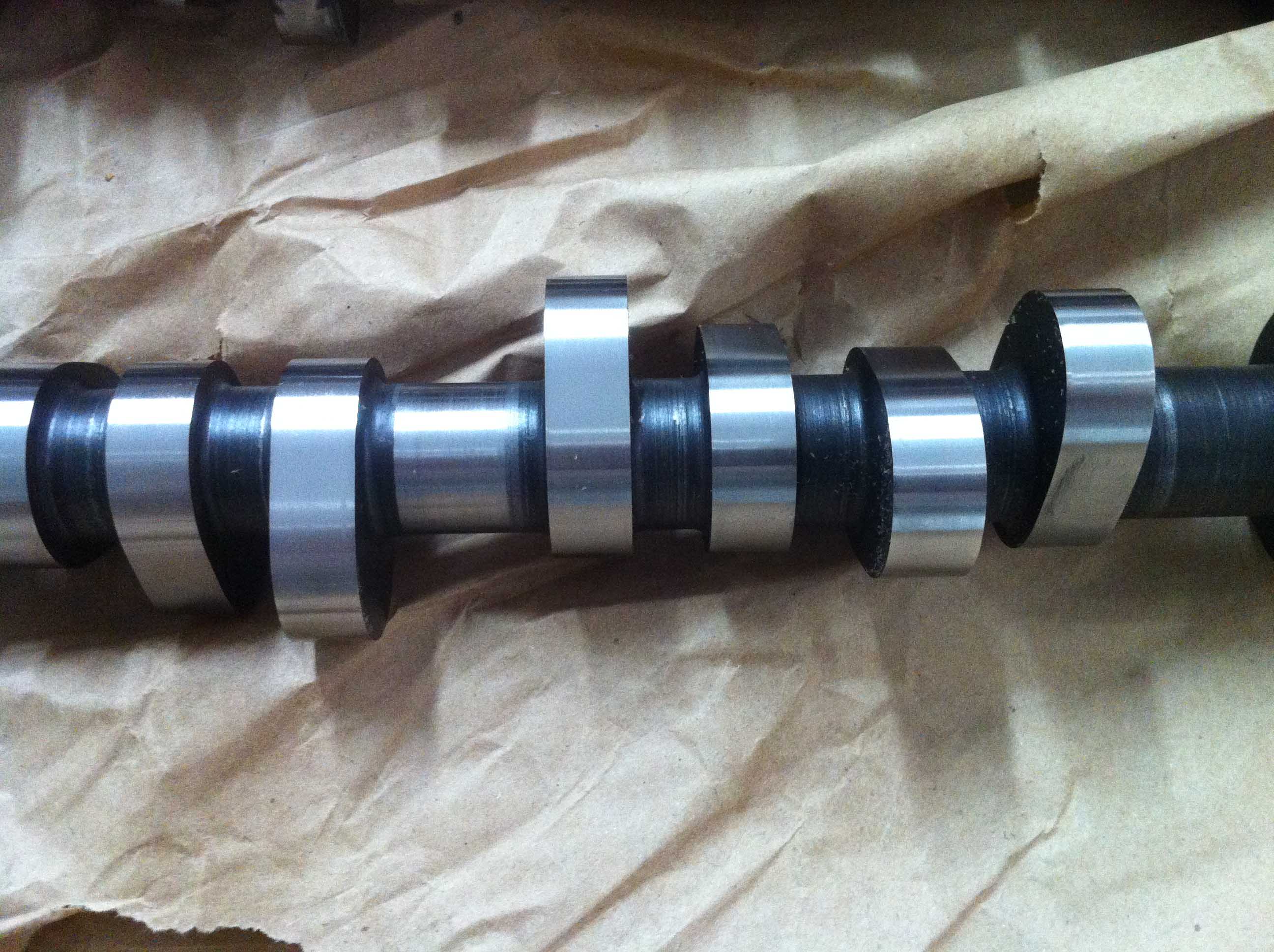

  17. Just received the new roller cam today from Dema - big ****er that it is! Don is busy on the roller lifters (our own design), he and Kevin are also working on the new cast iron lifter blocks (to index the rollers in), etc.. Lots of really tedious and precision work. I'm kind of like a kid waiting under the XMas tree for Santa to deliver all the presents!
    Here is the new roller cam - next to the flat tappet/mushroom one we ran last year:
    Here is a closeup of the lobes:
    There will be lots of engine and component pictures coming up - stay tuned!

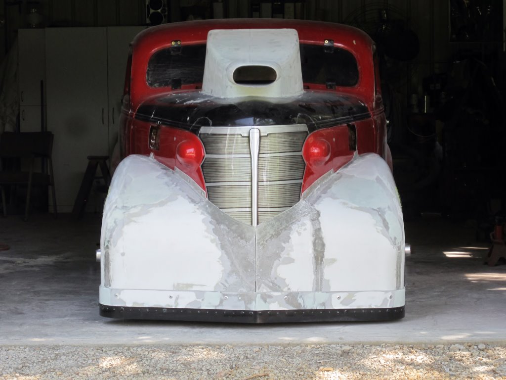

    John K.(WZ JUNK) Has been slaving away! From John:
    Front aero is done except for the black plastic on the bottom.
    I will work on the flange for the hood sides and the grille area tomorrow. This is nearly last area of fabrication. The fit around the grille will be the last big thing. It is all down hill now.
    Looking good, John!
  20. Why does the flat tappet cam look blue? or is it a OI....

    Good question-I don't remember noticing that when we took the engine apart, but it was after midnight! LOl! Dale?

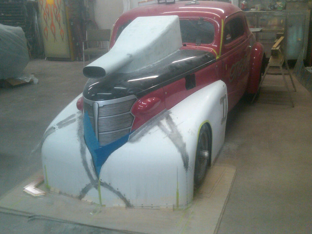

    From John:
    What the starter at the starting line will see.
    I will work on the fit around the grille opening and the front seam where the two fenders meet next.

  22. Ebbsspeed
    Joined: Nov 11, 2005
    Posts: 6,481
    Ebbsspeed
    What's your open valve spring pressure going to be? Those big lobes and that long space between cam bearings just creeps me out.

    Yea, but the 3 main crank creeps me out even more!
    We'll be about 155lb on the seat, and 330lb on the nose. Dema made the grind 'gentle, so we won't need as much spring pressure as I feared.
