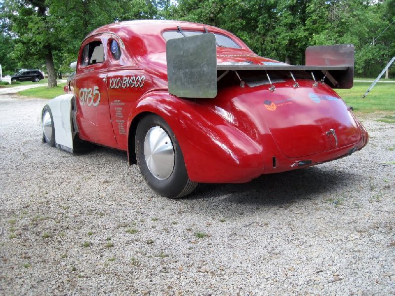

    The inside edges of the fenders have flanges made to fit the car. First the side of the car was masked off. Fiberglass was applied to the sides of the car and the fender was installed. Then the edges of the fenders were fiber glassed to the still wet fiber glass on the car. The fender was made to fit the car. Soft foam tape will be applied to the flange to seal the fender to the car.
    Randy just arrived to pick up the car.
    John

    Well I picked up the flatcad today from John (Wzjunk's) and I tell you what this thing is so aerodynamic I didn't even know it was behind my ol beater pickup I think I picked up at least a couple mpg and a good 50 or 60 thumbs up on the way home John sure does good work now time to get busy making this thing look pretty and have it ready for the engine install in July stay tuned for progress pics

    I made the side skirts this morning. Buddy stopped by for a short visit and picked up the skirts.
    As far as I know I have one last job on the car. When Randy replaces the front spring and adjust the front axle, I will mark and cut the front wheel openings.

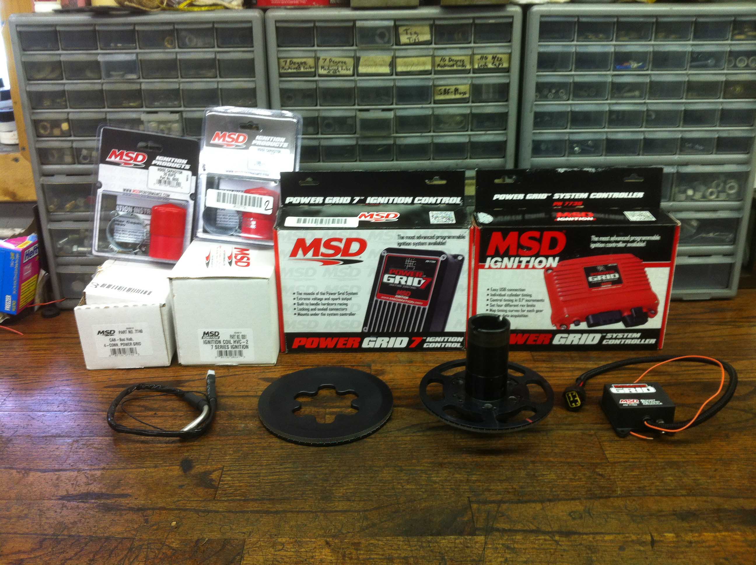

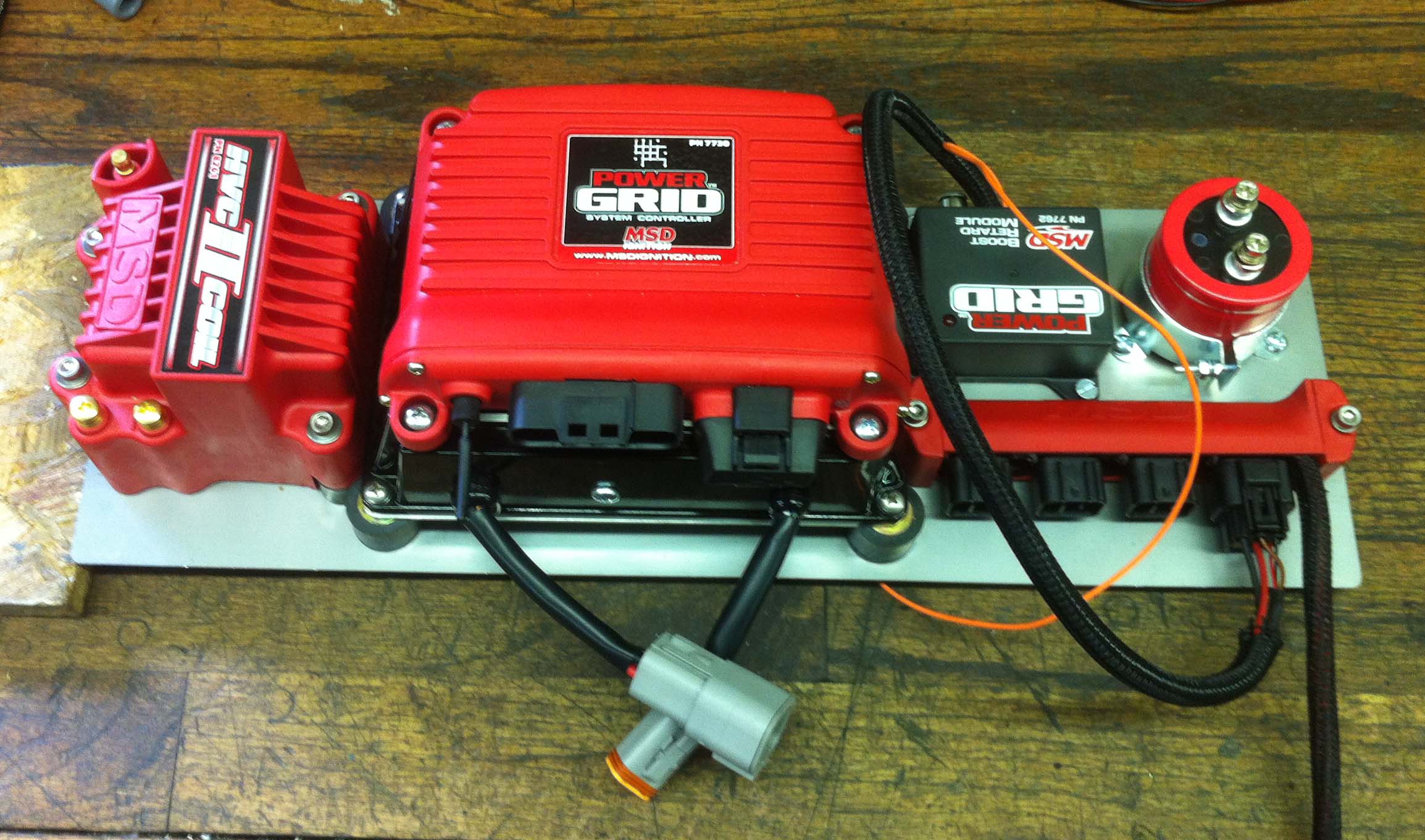

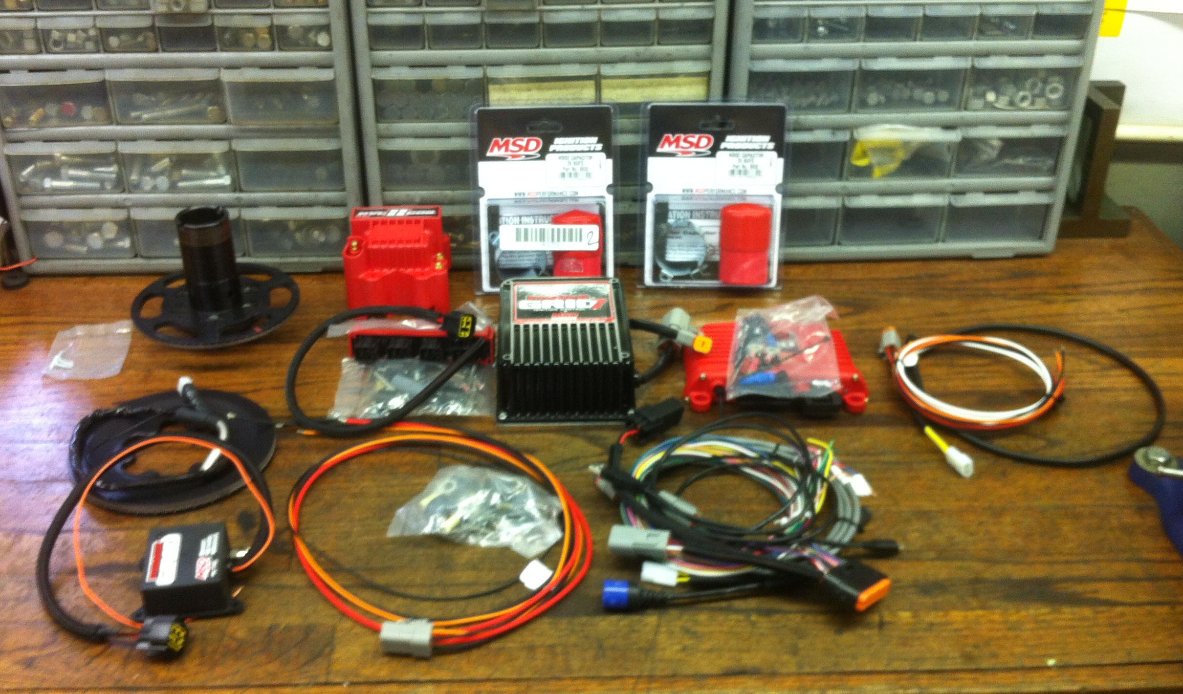

  22. Been working on the design/setup of a new ignition system for the FlatCad. We want to run in the modified classes as well as vintage, so we need to have some engine management to go to modified. The new MSD Power Grid system gives us computer controlled timing, boost retard, data acquisition (for advance), etc..
    I've not used the newer MSD stuff - really like what I'm seeing so far. Their software is fairly simple to use (for system setup and data*****ysis) - has a few quirks, but so does everybody in the automotive business. (It is not their strength!).
    Here are some pictures of the many boxes of stuff on my bench, all the components and the 'test board' that I made to mount/test everything.
    I setup everything and then use my distributor machine to test the ignitions, see how the software works, ensure that timing is coming in correctly, etc.. I've only just started to use it - still need to test the boost retard, rev limiters, etc..
    At the end of this post are four links to YouTube -- have videos to show the setup and actual running.
    I'm really looking forward to running the MSD - I'm very excited about how it has performed on the bench. :D
    Links to videos:
    1) MSD Power Grid Setup: http://youtu.be/EmVZZldLpiw
    2) MSD Power Grid Running: http://youtu.be/am3og4CkB9c
    3) Vertex Mag Setup: http://youtu.be/6XHHQctVTIc
    4) Vertex Mag Running: http://youtu.be/iYXQVS1_2VA
    Gotta love Ole' Sparky! Is always fun to fire it up!
    B&S

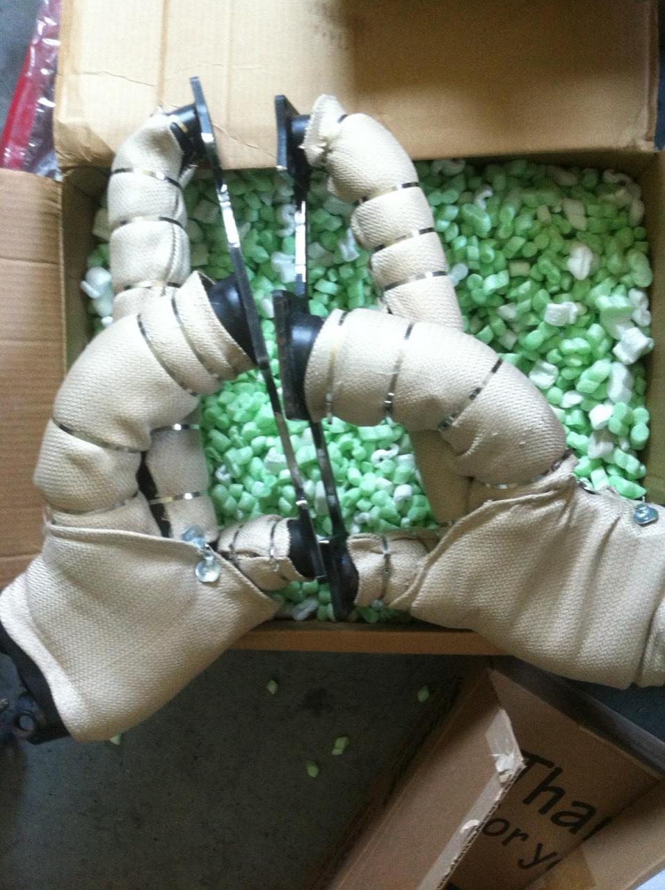

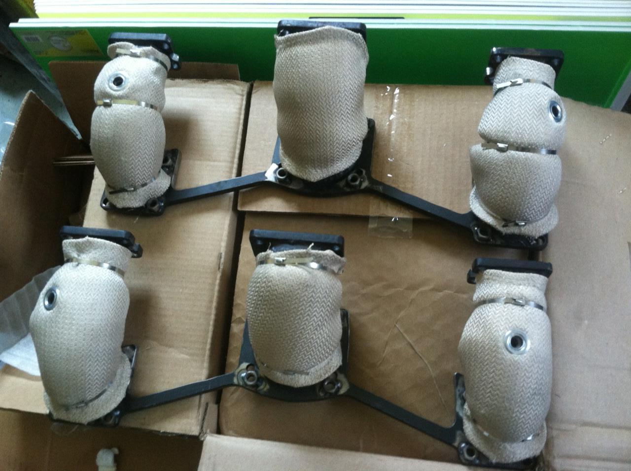

    Levi Lish of Turbo Performance Products, has just finished the blankets on our headers, and sent me pics!
    This should make things easier to work on after a run!
