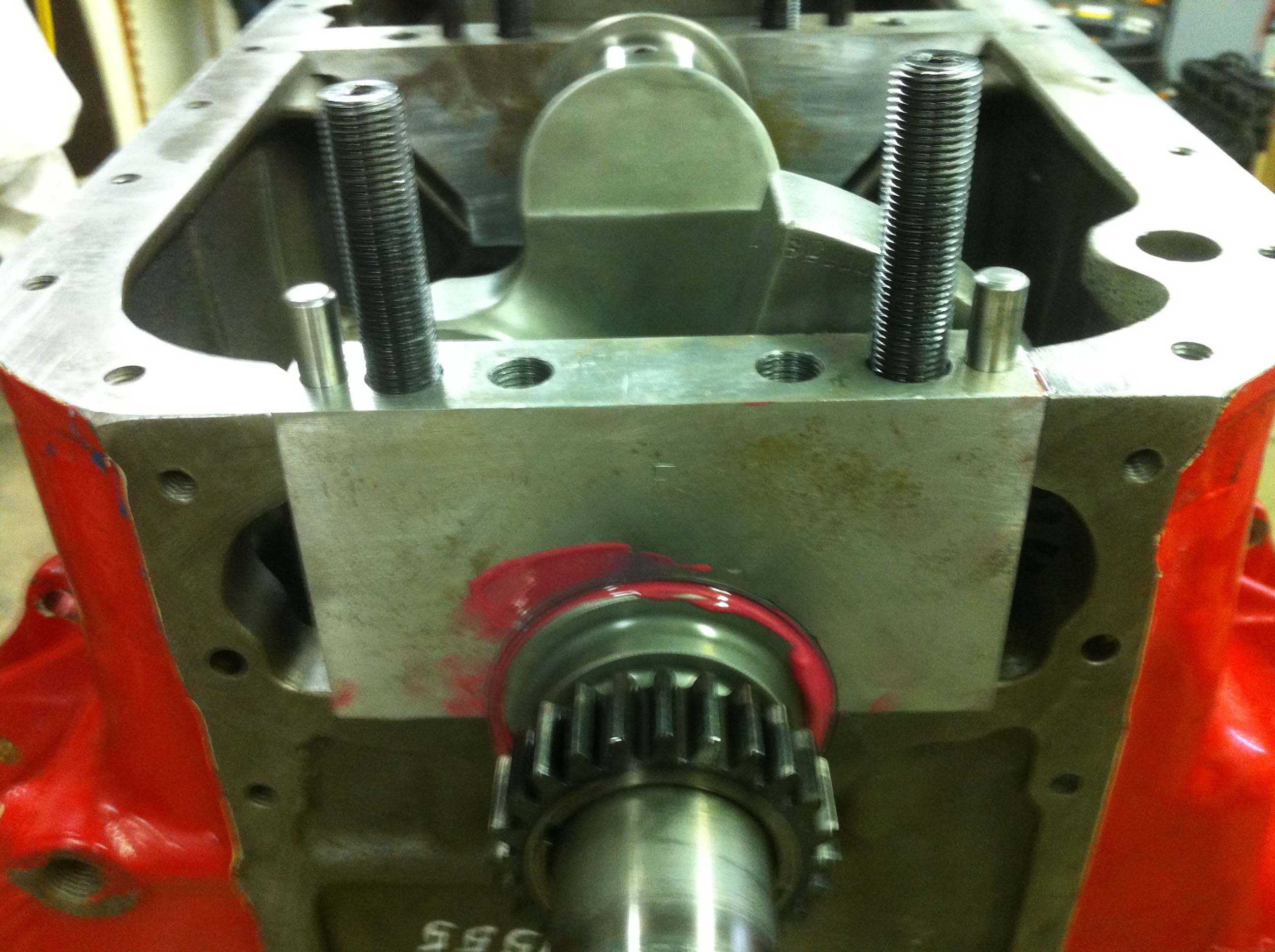

    Mains:
    Don and Kenny did one hell of a job on the new lower main and girdle setup. We created a splayed center main cap to replace our square one from last year and also a wider front main cap that picks up the sides or the block. Also, Don added dowel pins to tops/bottoms of all caps. This is about as strong as we can make it. Lets hope the lower end stays together.

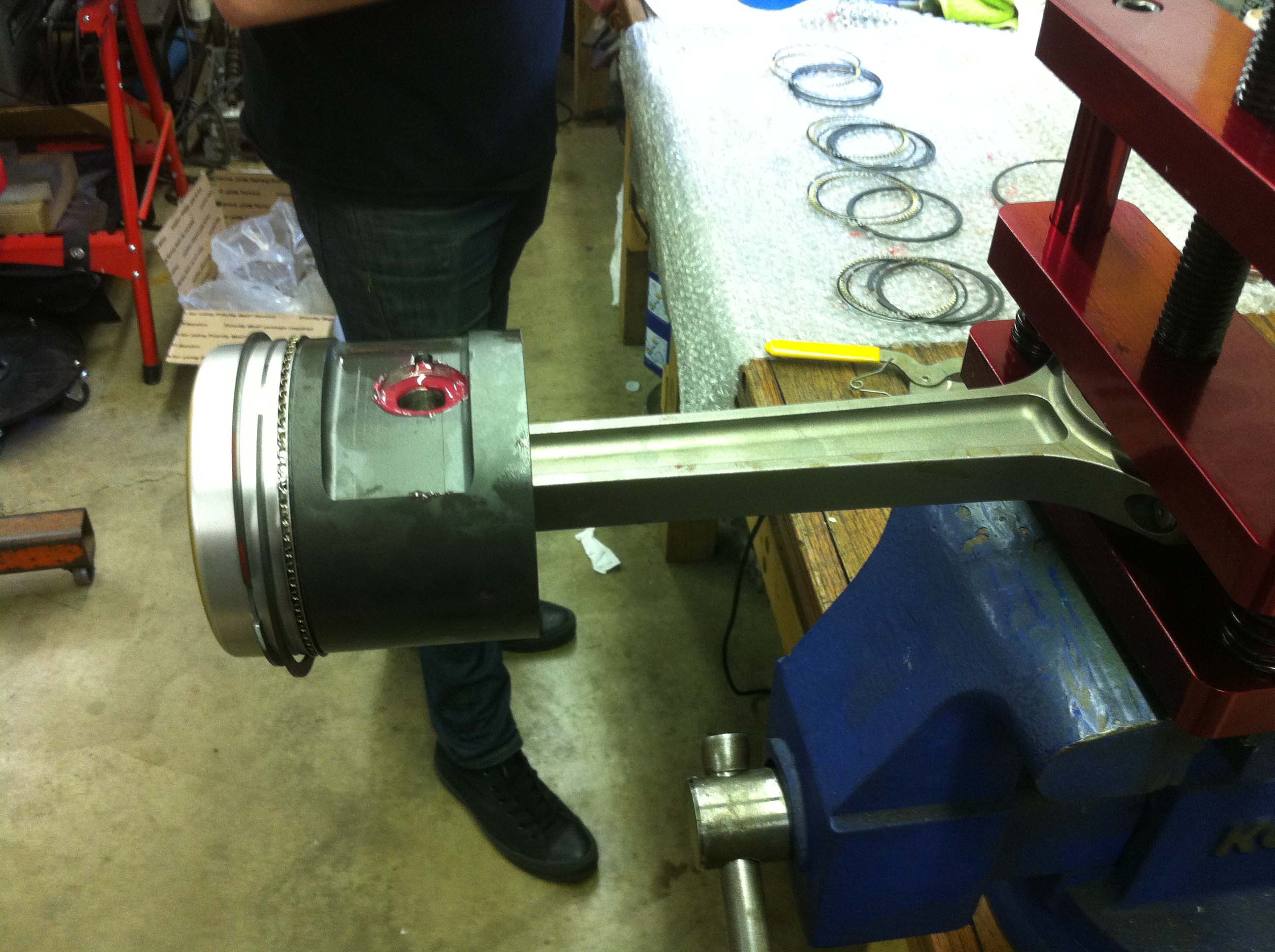

    Pistons:
    You'll see the purdy coatings on the tops, dry film on the sides and a heat shield coating on the undersides.
    Rings:
    We're running Akerly/Childs HTD 'hellfire' style rings. 1.5, 1.5, 3.0 mm stuff - all from late model Ford mod motors.

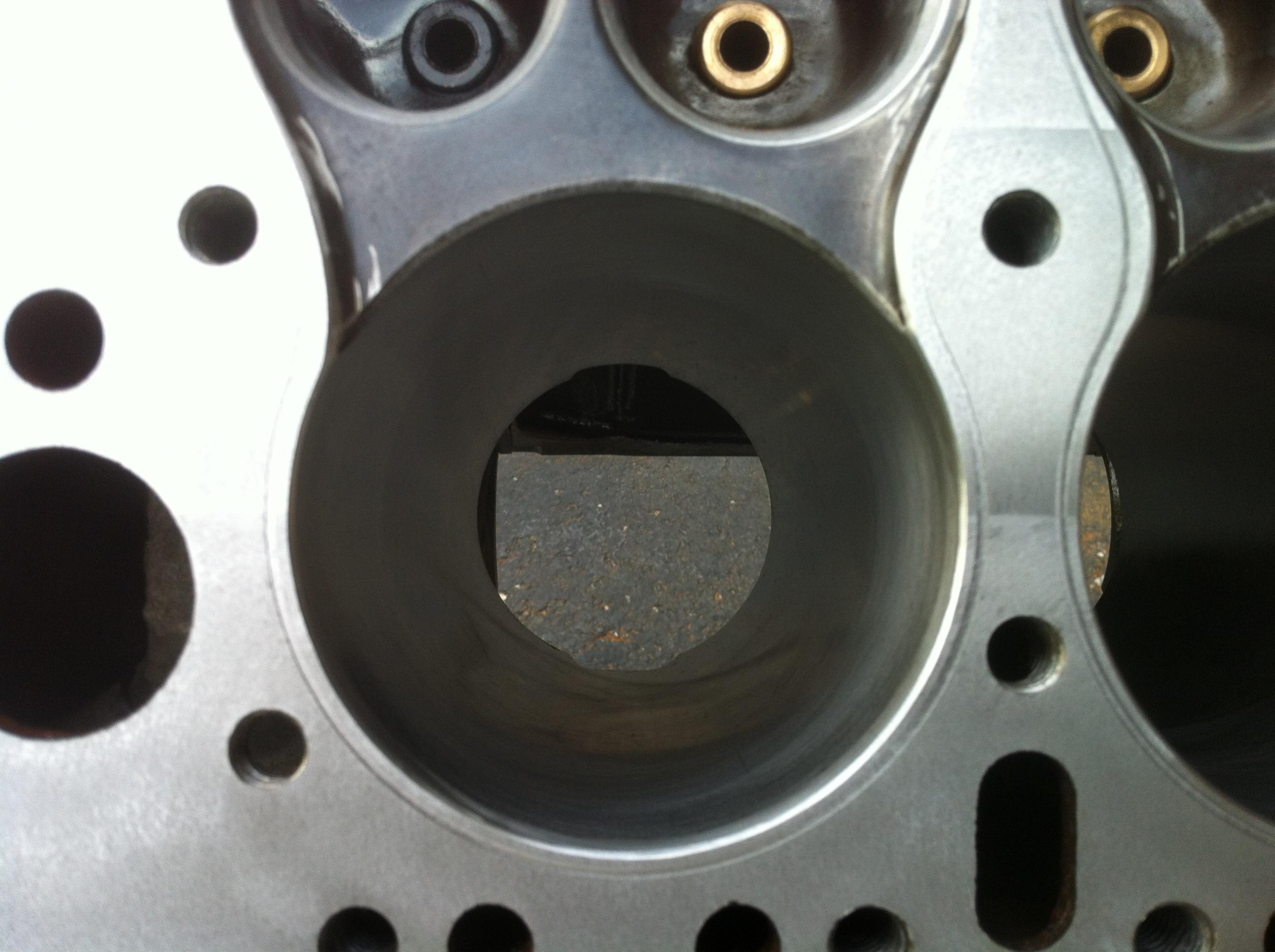

    Here are a bunch of pictures from when the block came home earlier this week and during the ***embly process - I know, same old ****.

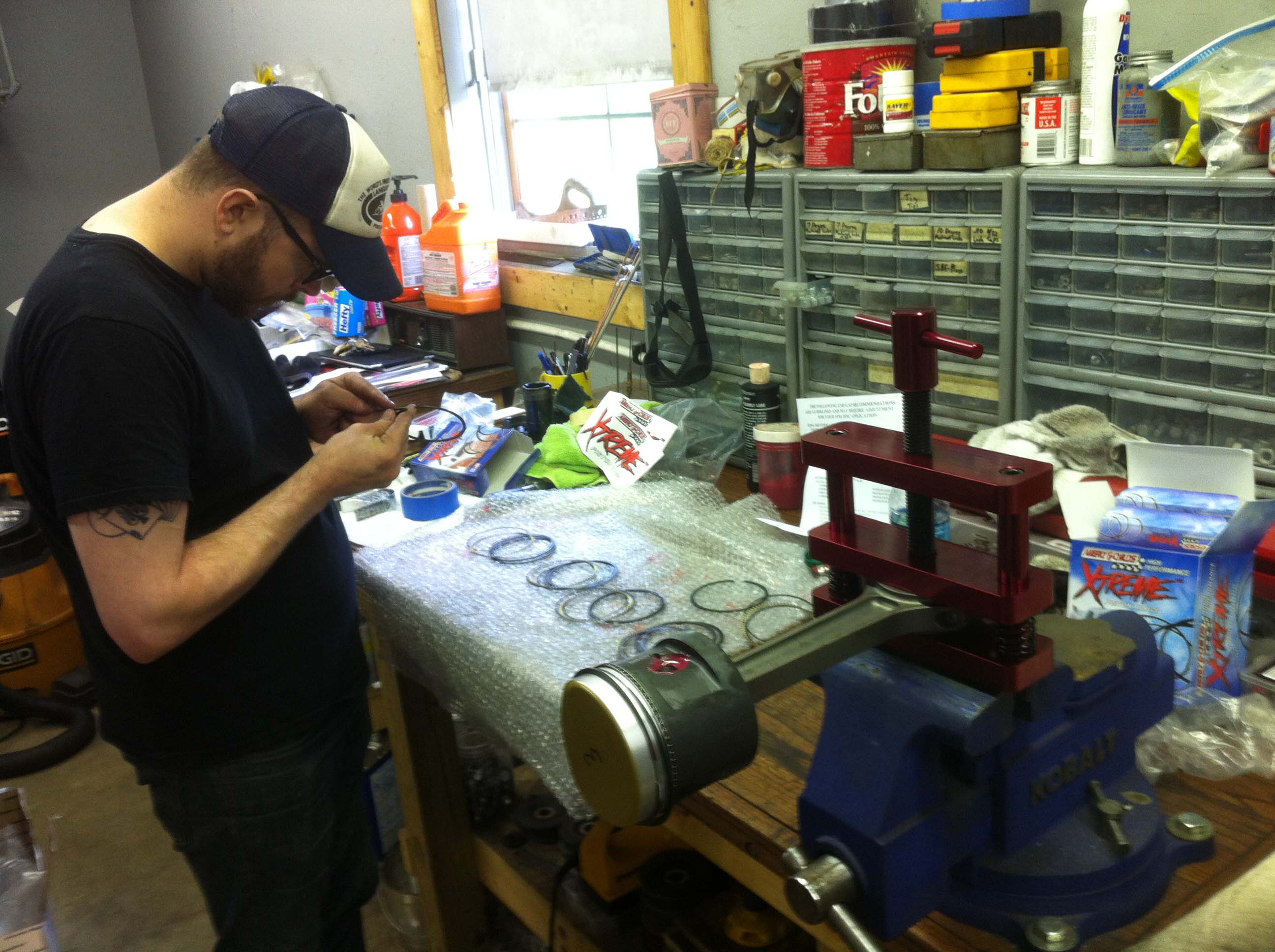

    Caught Chris Daniels in the act - of breaking the gap edges on the rings with a small file. He hates pictures . . . but not as bad as Buddy does! :eek:
