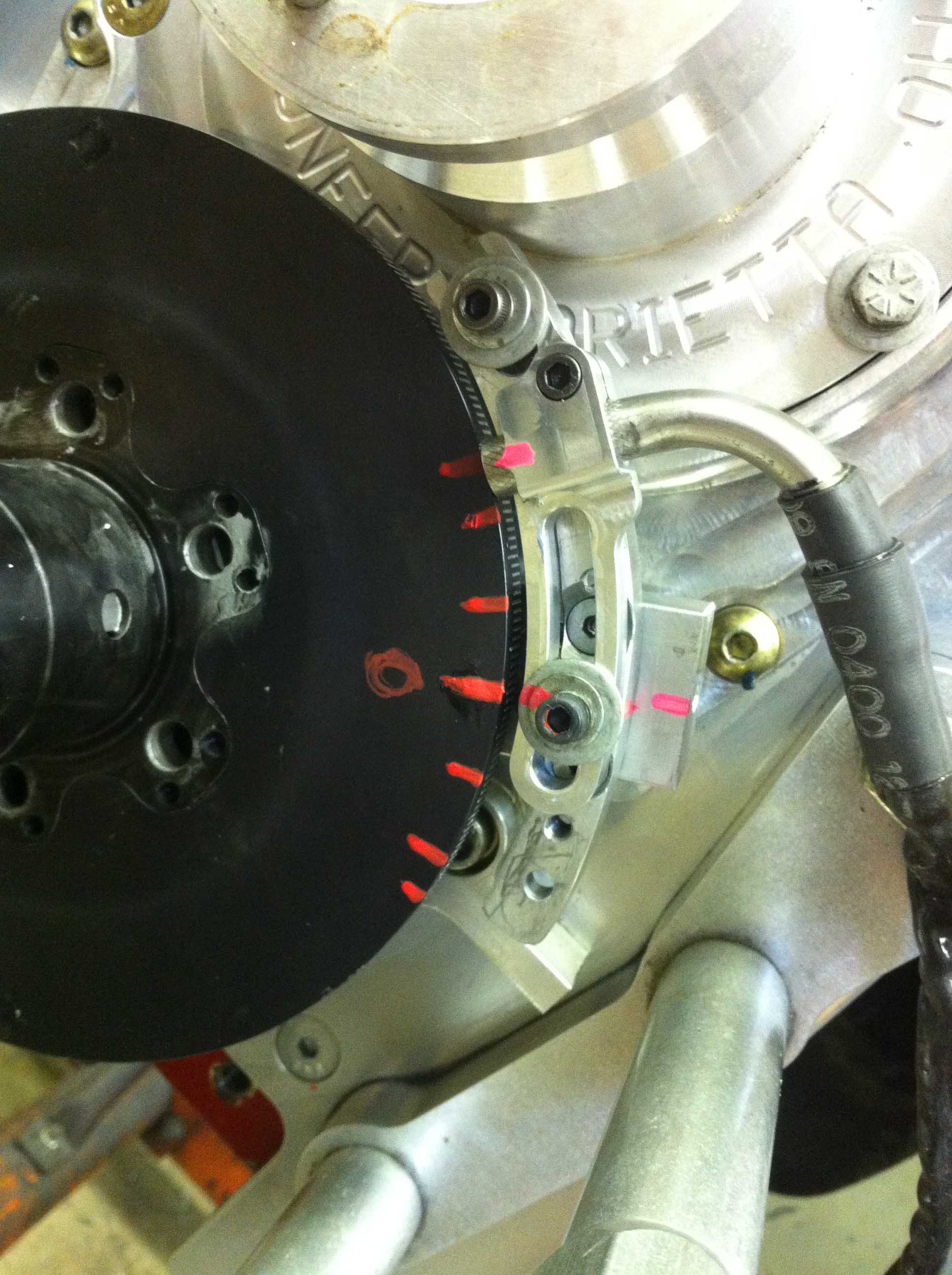

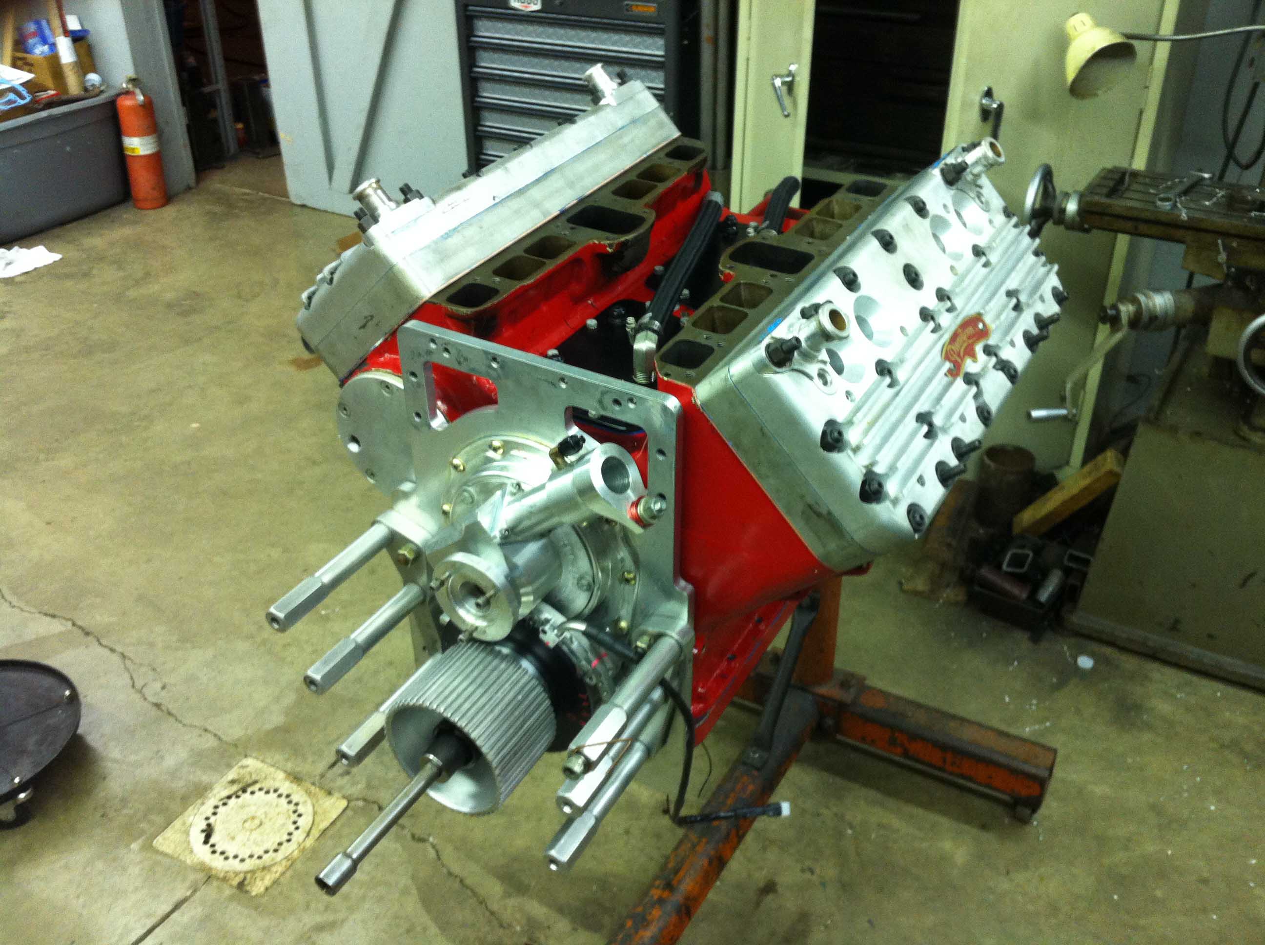

    Randy drove up, Mark came down and we were going like mad all day. The good news is that we all know the car and the systems, so we can get **** done without bothering each other too much.
    I'm not going to write a lot today - have too much to do.
    The ****** showed up in a big ole' box on my doorstep - looked like a big 'round' box due to the weight and shipping. The ****** looks really nice, turns over very smooth and we managed to find a shifter we believe will work. I hope if will get past the fat-*** seat we have . . . may have to rework some stuff on the shifter handle. All in all - I believe a GREAT last minute decision and execution Buddy.
    The engine is together - took a long time to make the custom crank trigger setup - had to make the mount, figure out how to get the trigger 25 or so degrees behind TDC, etc.. This is the first crank trigger I've setup, so was a bit to work out. I had it on the WRONG wide of TDC the first go, until Randy corrected my evil ways. Can't correct 50 degrees OFF of where you need to be with the MSD box! :eek:
    Today we plan to get the engine in the car - hopefully a few much needed parts show up. Had to pay $85 for a missing transmission centering ring - when yah need it, yah need it!
