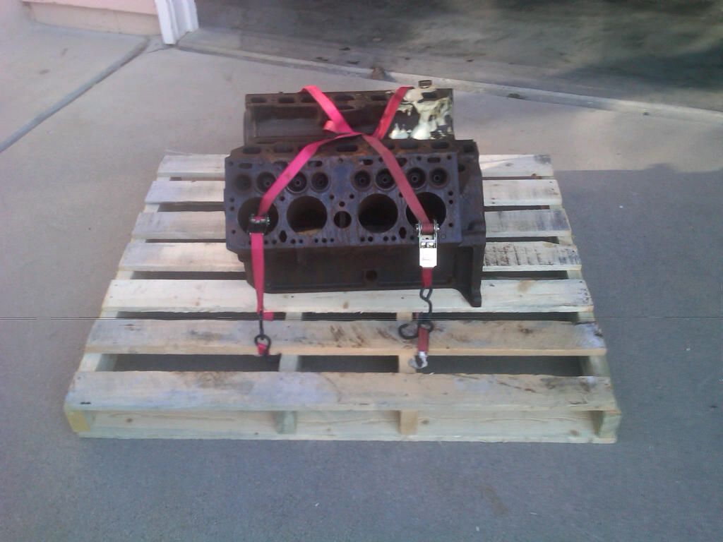

    This is how the new quest begins:
    I shipped the spare good block to Pops29 today, and the cam blank to Dema Elgin.
    Pops and Dale will start a new main girdle design, with the plans of being able
    to handle more boost and higher RPM's.
    Dema will grind a roller cam-I'd hate to lose a lobe or mushroom base off of our
    current cam!
    John K is starting his plans for aero-the Flatcad will look drastically
    different next year in comp coupe.
    Wrenchbender and I will get started on suspension-front axle and possibly a new
    rear diff, dry sumping the ****** and diff, body work and paint.

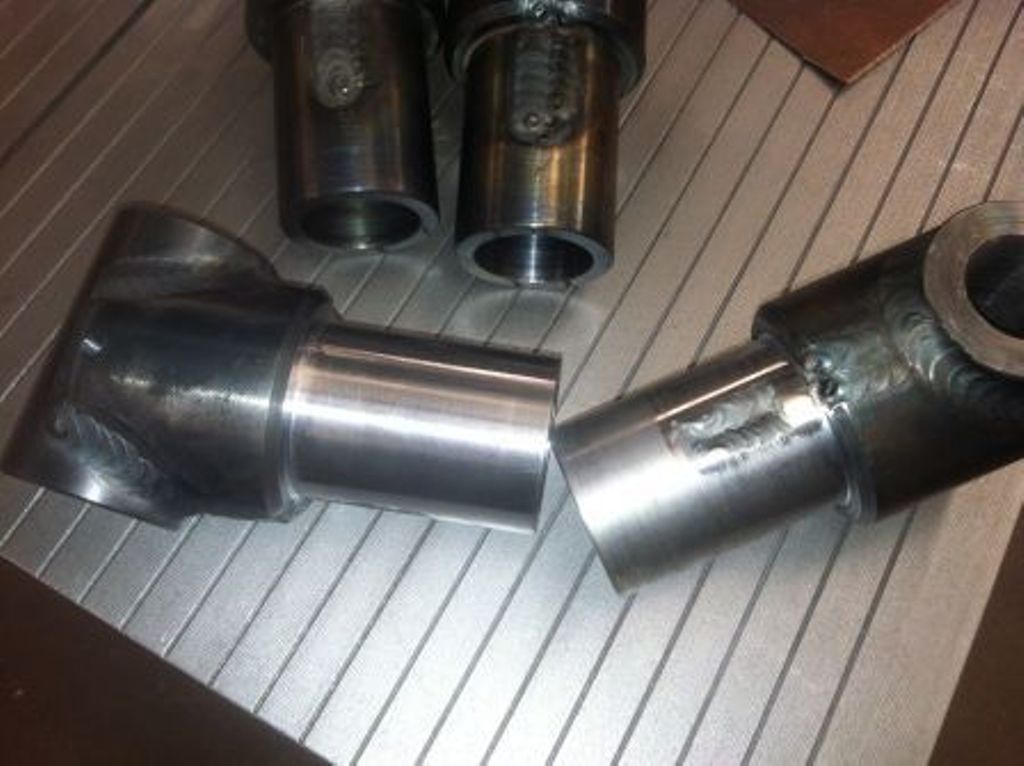

    BCCHOPIT is sending us a new straight 'setup' axle, and sent this pic of the ends he is fabbing.
    Once we know exactly what we need,the setup axle will go back to him, and he'll build the final axle.
    Thanks Bill!

    BCCHOPIT (Bill Carlson) has the axle ends trimmed and everything is ready to ship!
    I have to give Bill props-this guy is great! When he found out what we wanted the axle for, he offered to send us this setup axle, so that we could figure out exactly what we need. Not many guys go the extra distance for a customer anymore, but Bill sure does!
    Do me a favor, and give Bill a shout if you need any axle work! http://waccustoms.com or http://bcchopit.com

  24. BCCHOPIT
    Joined: Aug 10, 2008
    Posts: 2,604
    BCCHOPIT
    Hey Guys....
    Your set up axle should show up any day now. Shipped out UPS Monday.
    I add to your box one of my angle finder pads. With the g***er guys I tack them on when I build the Axle but with yours and my luck if I welded it on it would be in the way.
    So you guys will have to tack it on.
    Set the axle in a vice and set your king pin angle @ 0 and then put the pad on the tube and 0 it out and tack.
    Now when you have all your spindles and wheels on the car you will have a place to sit the angle finder. Takes all the guess work out where your Caster is set.
    This is a set up Axle the tube as been cut welded and ground on many times so have a blast you can't
    hurt it.

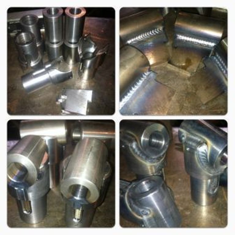

  25. BCCHOPIT
    Posts: 2,604
    BCCHOPIT
    Pics didn't want to post..
    Added one of my new stickers. Our very own Jersey Boy here on the HAMB took the **** floating around in my head and did his thing. Thanks Scott :)

    im not seeing any holes in your tube to plug weld those axle ends in there.... id put at least 4 plug welds on it, big ones.
  28. BCCHOPIT
    Posts: 2,604
    BCCHOPIT
    I think you missed the part of SET UP axle. The ends are only tacked in.
    When they get something they like I will make them a new one based of the set up axle. I will slide the ends into a nice new made in the USA 4130 tube and yes the ends will have
    plug welds in the real axle.

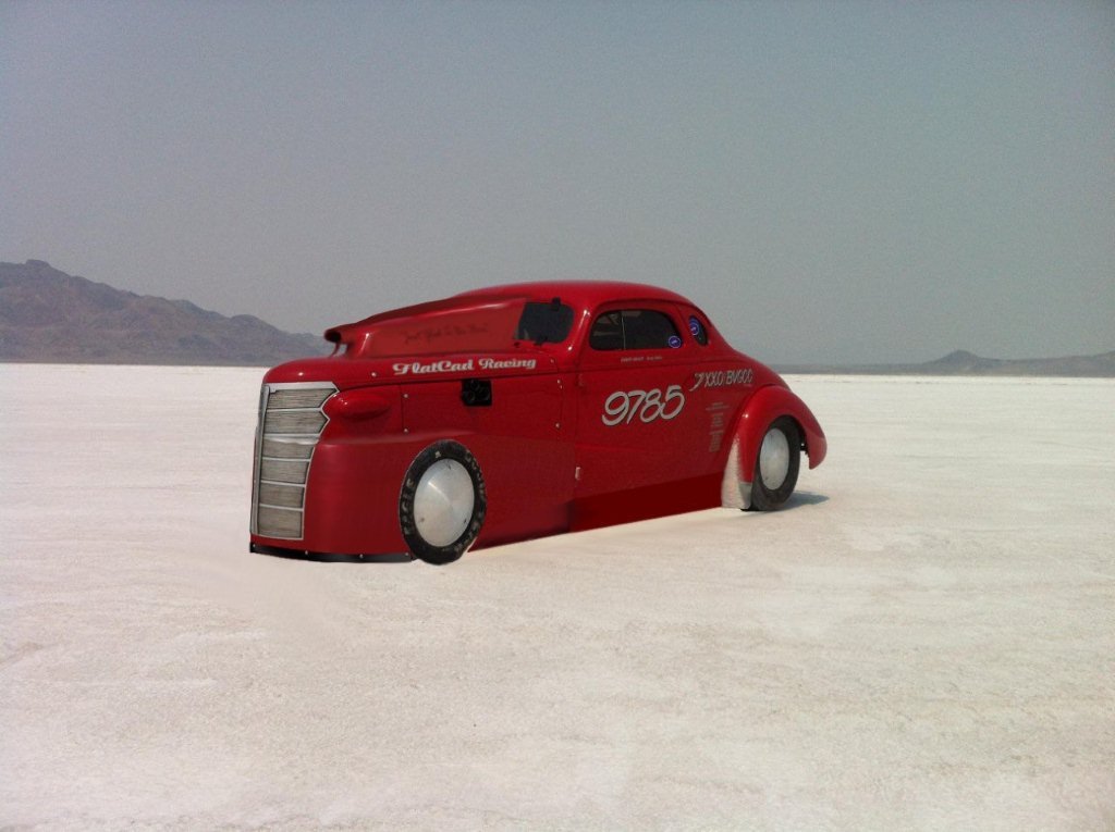

    Chasing record speeds with a vintage car is similar to nature, in the fact that there is a never ending metamorphosis happening. Much the same as a caterpillar morphs into a ****erfly, a cl***ic car changes into a sculpted steel contraption that looks as if it belongs in the movie 'Transformers'.
    It's really an evil necessity, because pure horsepower only goes so far, then racers are forced to make aero changes due to drag, lift, etc. Going fast may not look as cool as going slow, but going fast IS cool!
    Love it or hate it, this is a rendition close in appearance, to what the FlatCad will likely look like in our quest for 200 mph. Aero speed mods will be held on with dzus fasteners, so that they can be removed in the /BVGALT cl***.
    Photo-shopped by MOGuy. Thanks Steve and John!.
