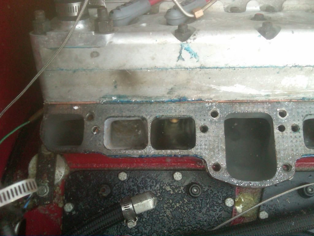

    I got a message from Randy that the block is cracked and they are done. I am sure there will be more details later. Good effort guys. I think we are starting to see the real potential of this car. The great white dyno is a cruel mistress.

    Wednesday morning, everyone was excited. We drain the engine water every night, because I'm not comfortable leaving the block full with the copper head gaskets.
    Daaaamn guys, we have an air leak in the system-I can't get it burped! Double daaaamn, looks like a head gasket! We pulled the car out of impound, back to the pits, and swapped the passenger head gasket. Oooops-now it's poring water! Long story short, we had cracked the #6 exhaust port, so we loaded up and came home.
    I tore into the engine on Friday, and found the problem. Good thing is, that it's not too tough of a fix. I also noticed the #5 intake looks too clean, so we're going to have to investigate that for a possible leak.

  26. just for my own knowledge, what would cause the port to split like that

    At this point I can only theorize. It's possible it was ported too thin, or that it had a weak spot in the casting. I wouldn't think we are stressing it there, but don't know at this point.
    Don, Dale, and I are getting together the weekend of September 21, to tear the bottom end down, and check everything out. We'll know more then, and will post our findings.

    You have one thing going for you now.... with the flow figures you had gotten and knowing where to grind and not to grind, you may end up with more strength in the runners than you had before.
