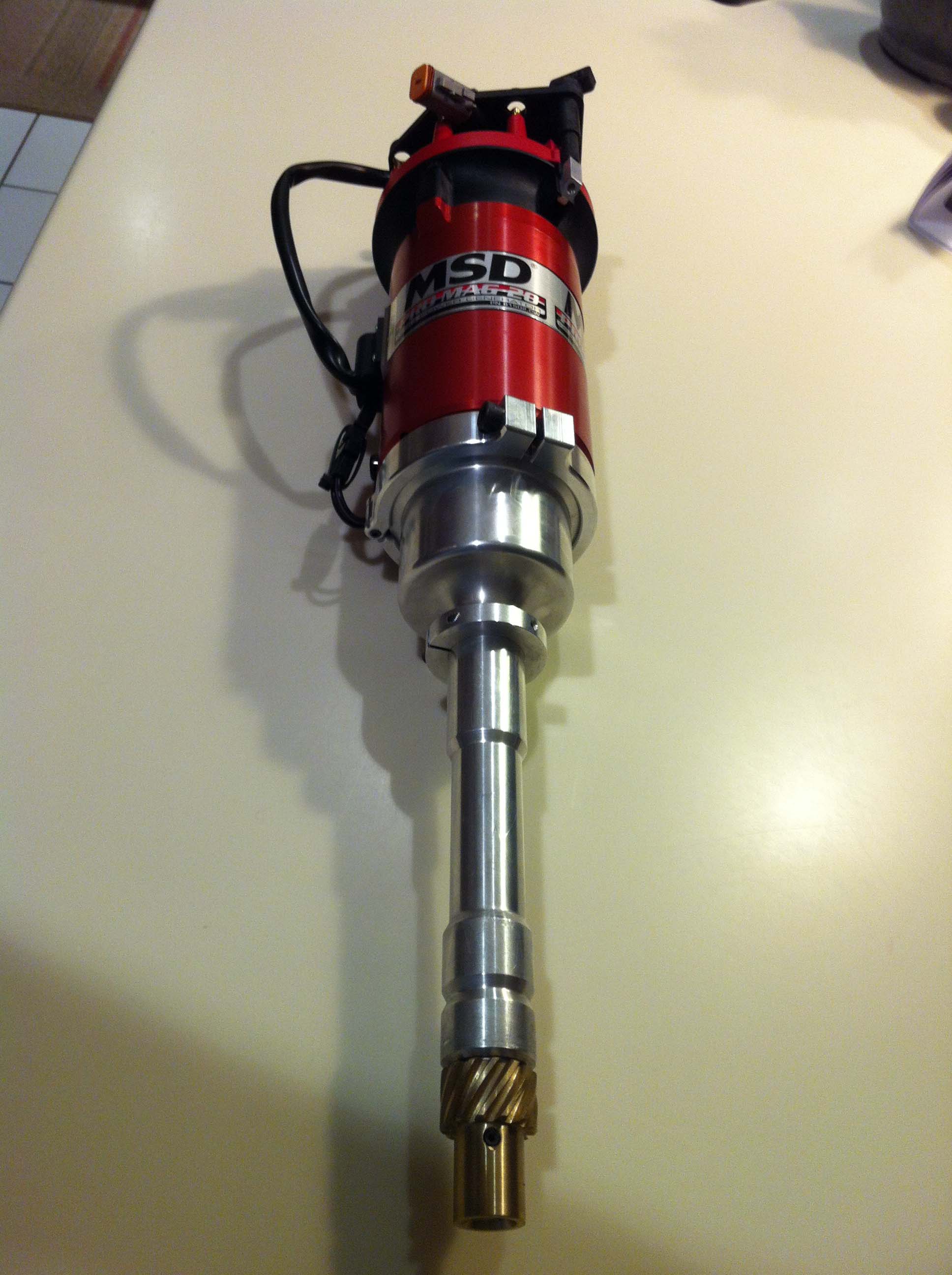

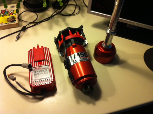

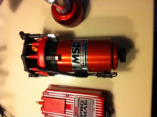

    I've been working to figure out our new magneto setup - decided to 'step up' with the Big Boys and run a high-amp ProMag from MSD. This is the ProMag 20 setup . . . can handle any amount of fuel that we'll throw at it. This magneto uses a magnetic pickup - we can switch between the crank-trigger and the pickup in the generator.
    These things are beasts! :eek: I can't even test it on my distributor machine - not enough HP to turn it. You can barely turn it by hand due to the super strong magnets.
    Will put a different 'band clamp' base on it - Fowler makes what we need. One thing is for sure, you won't adjust the timing with bare hands on this ****er - will knock you into next week.

    Here is the magneto mounted on the new billet base I picked up from Fowlers today - it is one purdy SOB . . . wish Santa had brought me the thing under the tree. I gave up part of my manhood to fund this beast :D - but from what everybody tells me, this ****er will really help us burn the alky and make horsepower. Also, it works with the ProGrid controller - so for the cl***es where we can run computerized timing control, we can run the same mag.
    Nice stuff - kind of a Christmas present to myself and the FlatCad effort.
