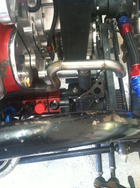

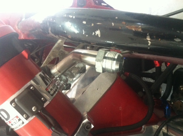

    Poppa Smurf (Pops29) has been busy, changing all of out 1" hoses and clamps over to AN fittings, cleaning up our plumbing even more!
    Poppa Smurf also did our discharge water manifolds!
    ......AND, the new steel came in for the upgraded chambers on the heads!
    Don also made a new water pump discharge manifold.
