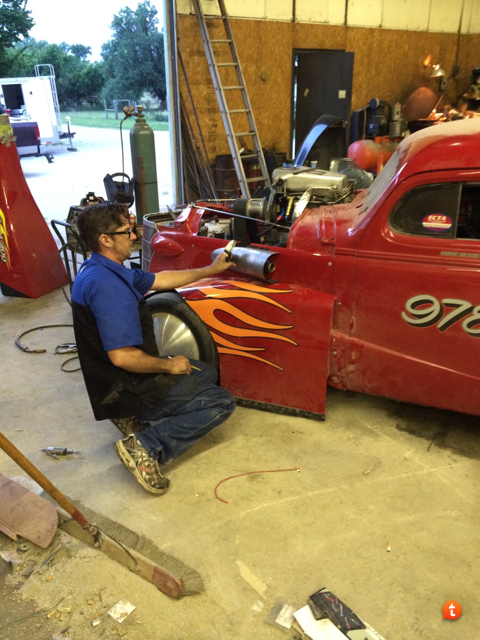

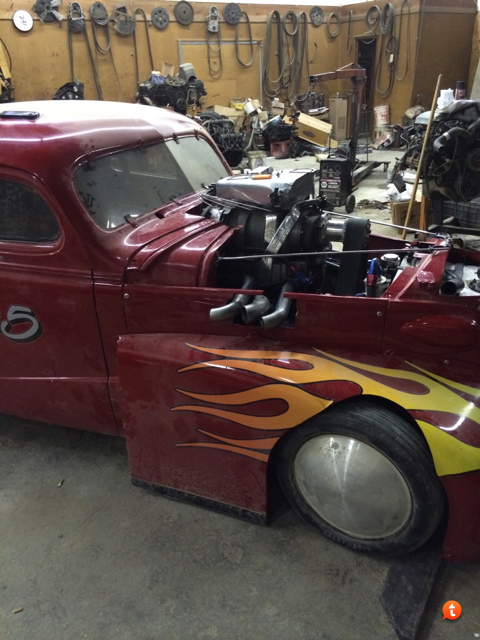

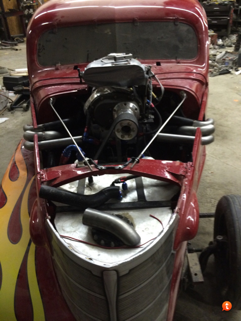

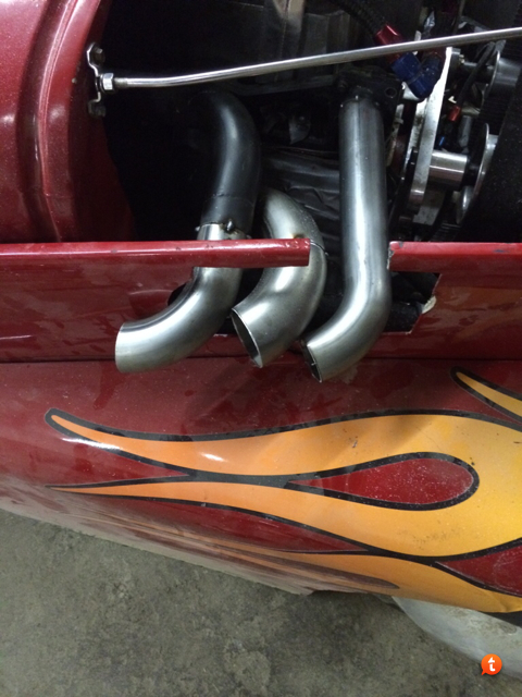

    We are getting ready for Bonneville!
    The heads are on Don's hands, so that he can deepen the chambers, so we can run thinner gaskets, and hopefully the o-rings and receiver grooves will seal better for us.
    John K has the fenders, to work some fibergl*** magic on them.
    We modified the exhaust, and added blisters, of sorts, over the exhaust.
    as luck would have it, I was able to pick up a really nice, rebuilt and running Caddy flathead!
    MODEX1.jpg MODEX2.jpg MODEX1.jpg MODEX2.jpg MODEX3.jpg BLISTER1.jpg BLISTER2.jpg BLISTER3.jpg NEW1.jpg NEW2.jpg NEW2.jpg NEW1.jpg BLISTER3.jpg BLISTER2.jpg BLISTER1.jpg MODEX3.jpg MODEX2.jpg MODEX1.jpg MODEX2.jpg MODEX3.jpg BLISTER1.jpg BLISTER2.jpg BLISTER3.jpg MODEX1.jpg MODEX2.jpg MODEX3.jpg
  9. I like the body fairings over the pipes.

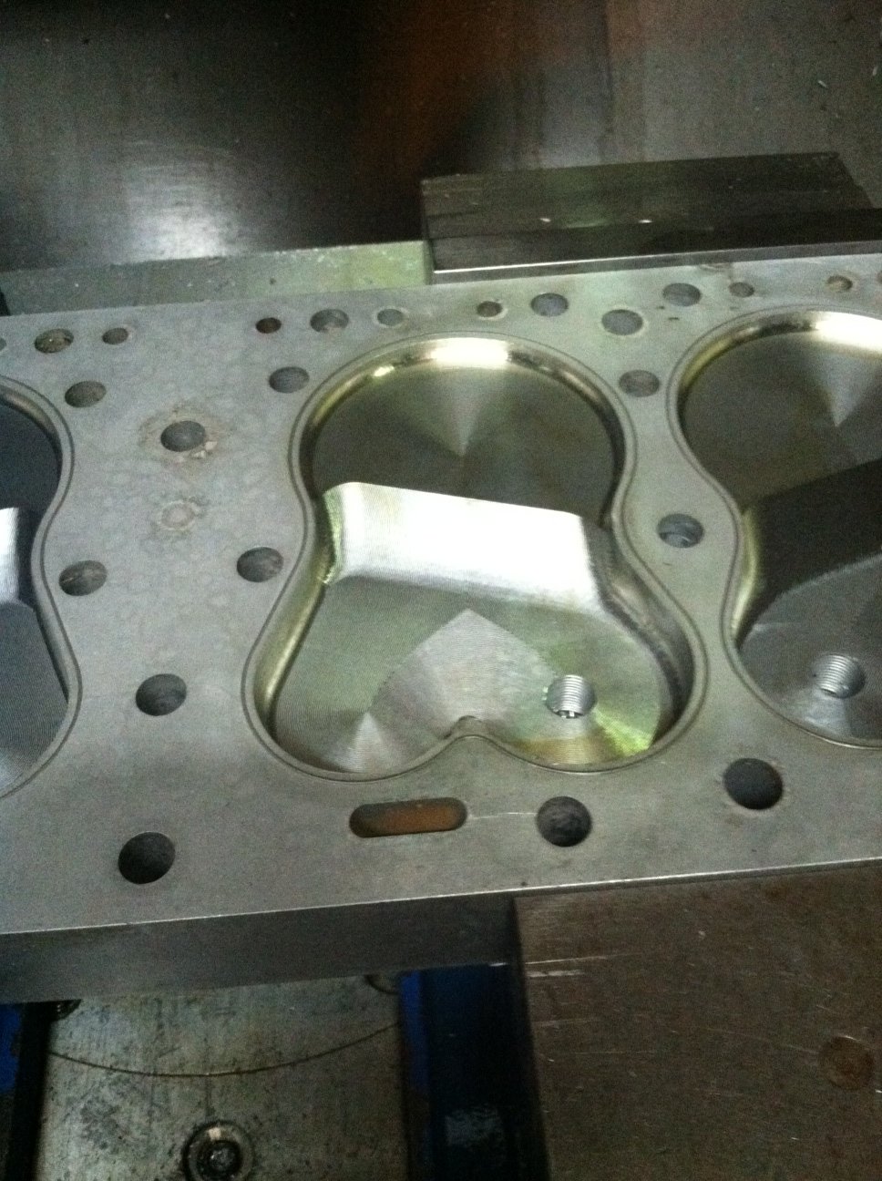

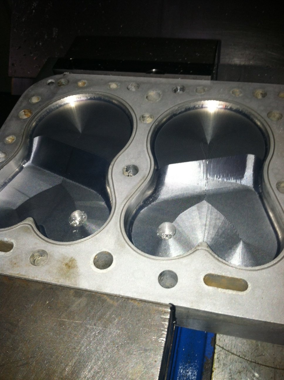

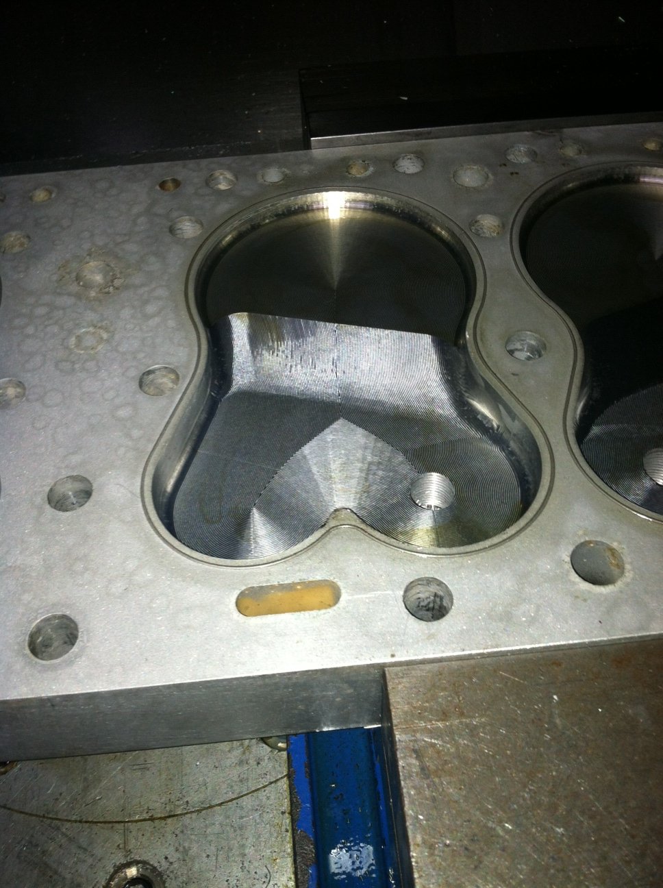

    Don is deepening the head chambers, so that we can run a thinner head gasket, and hopefully take full benefit if the o-ring/receiver groove setup. He still needs to polish the chambers.
    He has the first head done, and deepened it .050", so we can use .035" copper gaskets.
    John K is working on the front fenders, and Randy is working on the exhaust covers/blisters.
    I'm at work, and will install the heads when I return home. deeper chambers.JPG

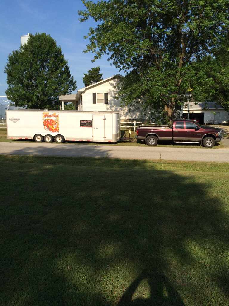

    Loaded up and on our way to Bonneville! ImageUploadedByH.A.M.B.1407288344.667948.jpg

    Well, things were going good until we got between Rock Springs and Evanston, WY. We broke a trailer spring and tore all of the wiring up for the trailer brakes.
