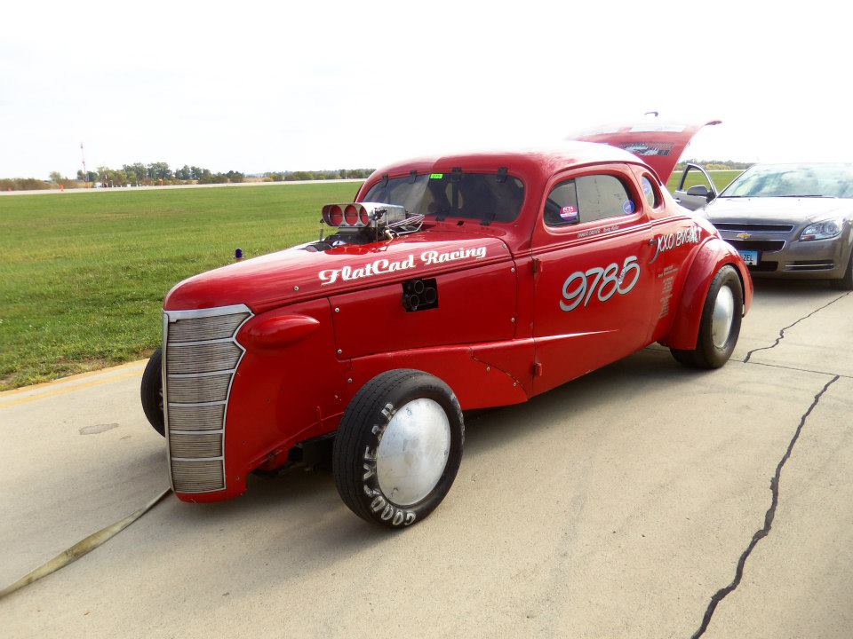

    Well, 2 records at the Ohio Mile, and a REAL test of the engine.
    I had been taking it easy on the engine, and decided we needed to know what it would do. 16lbs boost, spun 6000 rpm's, and was ***Y sounding!
    So, we have a solid baseline for next year.
    Don and Dale are going to work on the girdle, I'm attacking the flow with flowbench work, Dema's whittling a cam, and Randy and John K.are going to do the suspension and body.
    Quest 200, here we come!

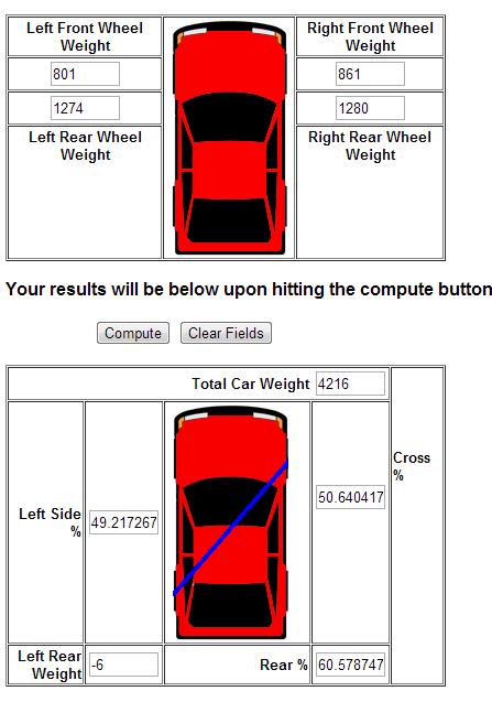

  11. Picked up a set of race car corner scales – from my circle track friends.
    Here is the setup:
    1. Radiator Tank – Filled about 1” above pressure caps: Water circulated through the engine
    2. Intercooler Tank – filled to 5” below the top: Water circulated through the intercooler
    3. Oil: Running levels (will measure later).
    4. Rear Weight Added (like the lead): 325 pounds
    5. Fuel Tank: ½ full
    6. No driver
    Here are the numbers with a grossly over-developed, muscular and very athletic driver . . . that would be ME! :eek: I have about
    15 – 20 lbs of clothes and gear (figure that was pretty close)
    Looks like we have about a 40 front / 60 rear weight bias. I would not have guessed that we had that much weight in the rear – but we do.
    I’ve been doing a bit of reading – seems that most folks DO NOT like to add weight behind the rear axle – very bad place to have it in a spin situation (acts like a pendulum). We currently have two 'racks' where we put in sets of lead filled 2" steel tubes - on the floor of the trunk (way to the rear of the car).
    We probably should move the weight to ahead of the axle and as down low as possible. Maybe some thick steel plates? Anyway, thought I’d send this your way.
    Time to start taking things apart!
    Pictures to follow for the details of what the motor looks like - after some seriously hard racing at the Ohio Mile.
    Fingers and Toes are crossed . . .
    B&S
  12. roseville carl
    Joined: Dec 29, 2008
    Posts: 5,213
    roseville carl
    old lead divers shoes, would help keep weight in front of axle and throttle down................. just a thought.......:D:D
  13. 38FLATTIE
    Joined: Oct 26, 2008
    Posts: 4,349
    38FLATTIE
    from Colorado
    Wow, the car weighs about 600 lbs more than I thought!
    The car is balanced very well though, considering we never had it on scales! Randy and I will bring the total weight to about 5000 lbs for next year. We may look at moving the rear ballast, if I can find some more used lead. I plan on adding some lead filled 'cross members' on both sides of the axle, and may even fill the axle cross member brace- this would move the weight directly over the rear axle.

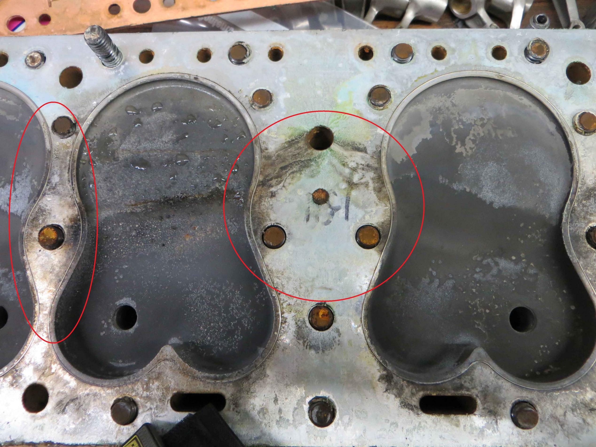

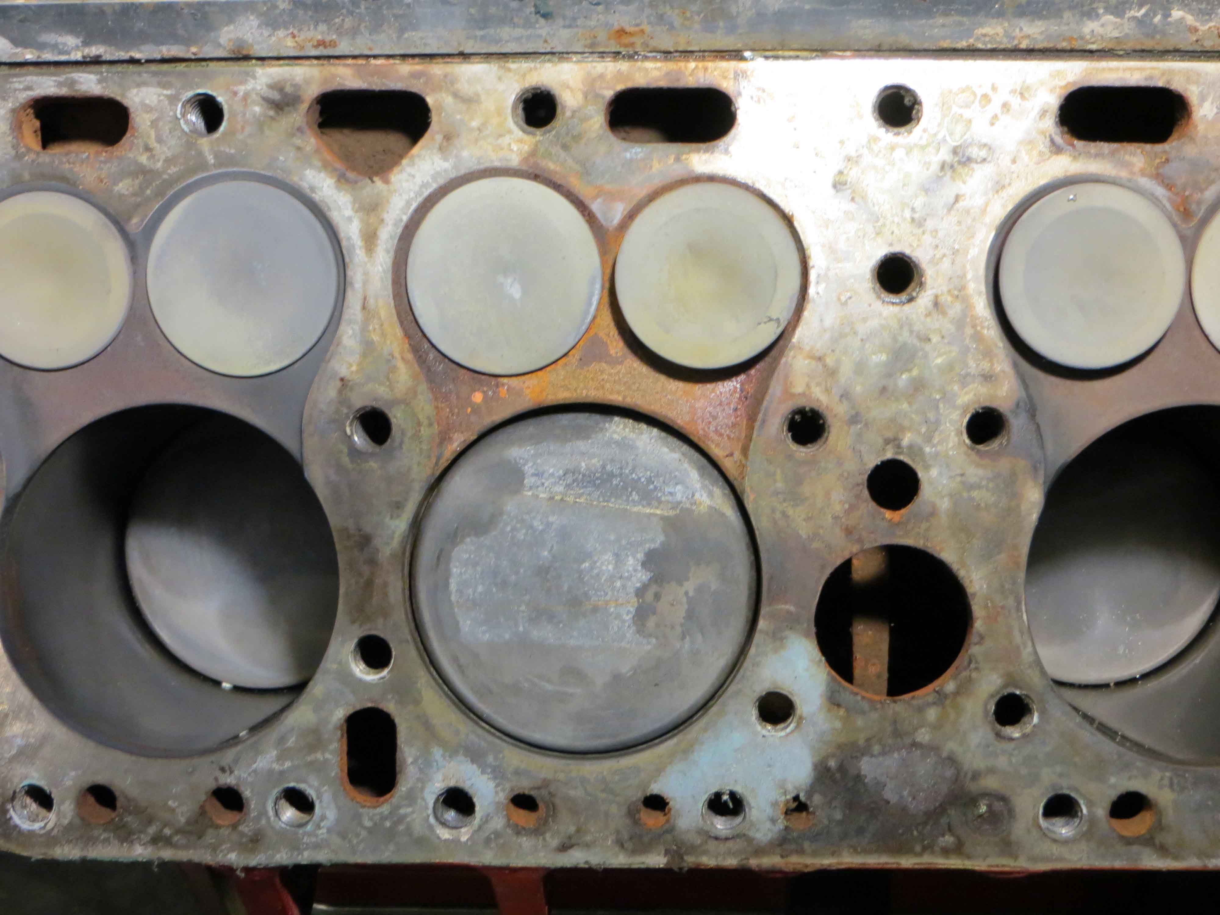

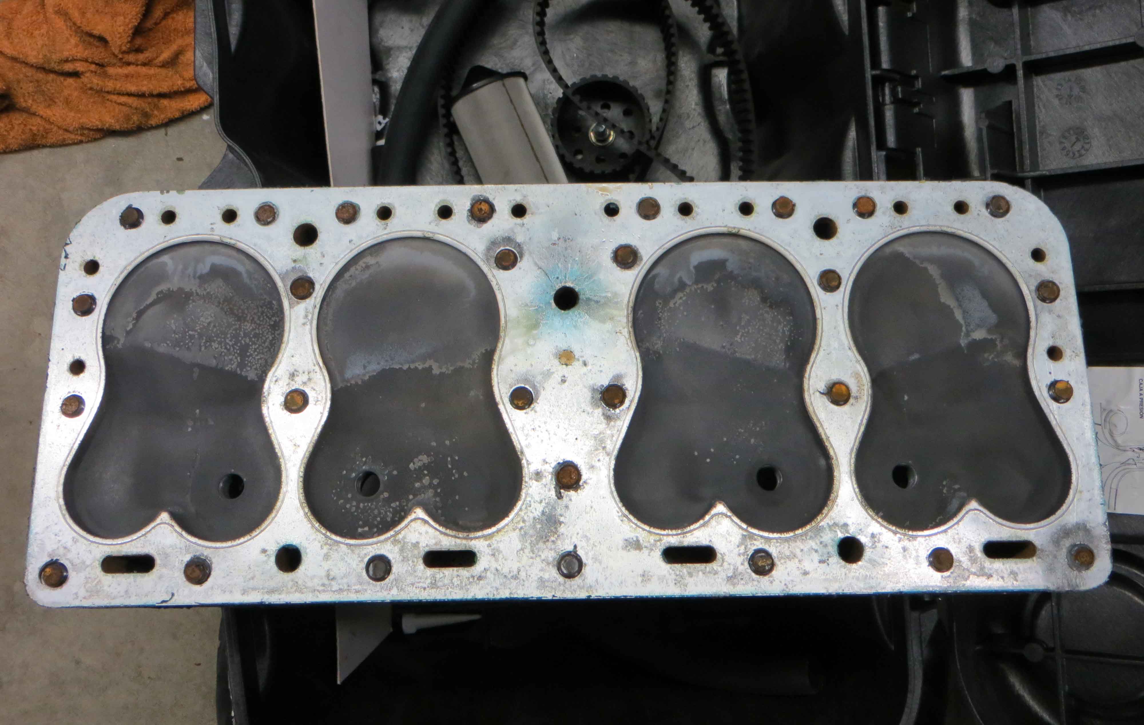

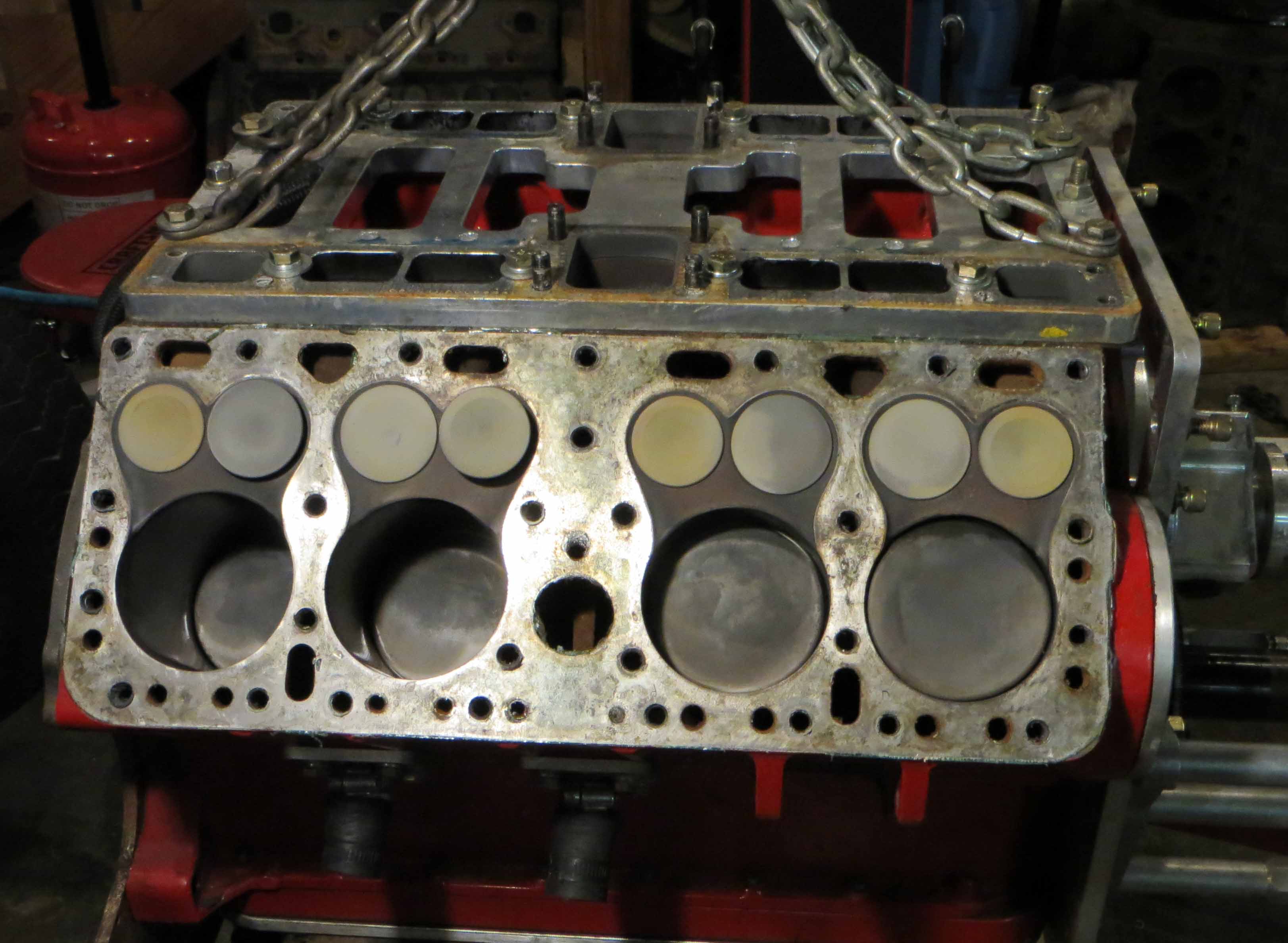

  25. Forensics: Taking the FlatCad Engine Apart - What Can We Learn :rolleyes:
    My wife Amy and I (yes, she's in the shop working with me on this) have pulled the FlatCad engine out of the car and started the dis-***embly process. I look at it more like a forensics process of paying complete attention to detail, looking at everything, suspecting everything and seeing what you can learn. If you take your time and really look for the minute details - they are frequently there. Sometimes you can make deductions (based on obvious facts) - other times you're applying all that you know in a creative manner to ATTEMPT to explain what you see.
    Background on a Couple Key Things:
    1) We have custom designed billet aluminum heads.
    2) Due to this, we have custom designed head gaskets - .072 solid copper with a rubberized coating to attempt to seal the water p***ages.
    3) Heads are O-ringed (not the block) - remember, this is a flathead.
    4) We fill the engine with water at the start of the race day - and drain the water EVERY night. This is for fear that we'll seep some water into the engine (over night) and ruin it the next day. This has happened to many guys in our situation, so we're very cautious.

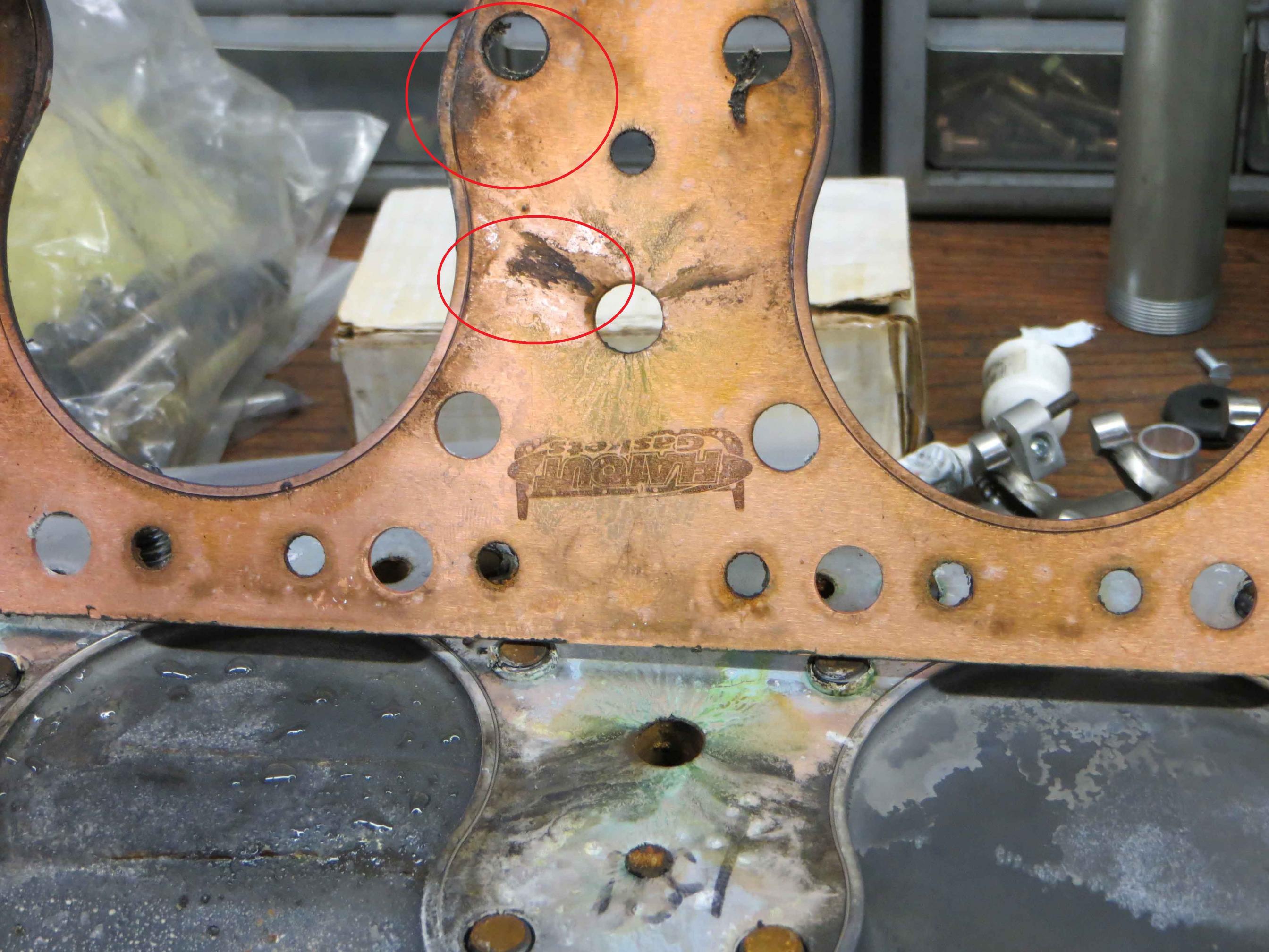

    When I pulled to top of the motor off (blower, intercooler, manifolds, etc) - noticed we had a teas**** of water in the bottom of the center exhaust port on the driver's side. This side did NOT have a new head gasket put on for the Ohio Mile and it was not re-torqued (as we'd torqued it at least 4 times before).
    Hmmmm . . . water . . . not good. Where did it come from? We didn't see anything on the dyno, Bonneville or the Ohio Mile. Did this concern me - hell yes! Leaking intake studs? Cracked block? What?
    I then pulled the plugs on all cylinders - notice a very slight amount of rust on one of the center cylinders on the driver's side. Hmmmm . . . that means that the water was also inside the cylinder . . . also not good.
    Then we pulled the heads and here is what we found - yes, now I see an explanation and also realized a couple new things for next year:
    See the rust in the transfer area - probably some on the seat as well:
    The head gasket was obviously leaking water into the cylinder - notice the discolored areas in the head and the gasket pictures (outlined in red).
    Now - look at the p***enger side (looks great!)
    So here is what I noticed on tear down - which is why I do this by hand and I DON'T use air tools:
    a) The torque on the driver's side was not what it should have been - was closer to 45 ft lbs, than 60. AND - this surely wasn't due to us not re-doing the torque many times (we did it 4 - 5 times at least) . . . during hot and cold cycling.
    b) When I put the p***enger head back on at the Ohio mile, I INCREASED the torque by 10 foot lbs . . . to 70 on the main/stock studs and 50 on the 7 that we added. This worked really well and the torque was maintained. The pictures show this.
    Conclusions and Plans for Next Year:
    1) Constant Re-Torque: No matter how many times you torque these heads - we need to check the torque after every run and ensure that the clamping forces are maintained. This also means that our new header design MUST be done in a manner that makes it easy to pull the headers. Currently, there is no way to retorque the heads with the engine in the car and the headers on.
    2) Higher Torque: We're very sensitive to how much torque we use as the decks are pretty thin on this engine. Also, the seven added studs cannot be torqued like the stock ones that have the big cast-in bosses in the deck. But, we need to use the higher 70/50 torque settings . . . as this head was perfect and I didn't see any signs of gasket failures.
    3) Heads - Some Rework: We need to rework the stud holes (too tight) and the stud washer setup. It is way too difficult to pull the heads - as there is too much binding within the stud holes, stud washers, thread sealers, etc.. I should be able to pull a head in about 15 minutes . . . currently it takes 3 hours on the car and over an hour outside the car. It is a TOTAL pain in the ****!
    4) Adding Deck Dowel Pins: If we're going to loosen up the stud clearances, we should add 2 dowel pins to the deck - to guarantee alignment and non-movement.
    5) Head Inspection: Due to the possibility of water with solid copper head gaskets, we need to pull the heads after EVERY meet - to inspect for water, oil the bores and valves, etc.. We can't afford to have even small amount of rust in the cylinders, valve seats, etc.. This needs to be a part of our standard operating procedures. It is also why it needs to be easy to pull the damn heads!
    More tonight - as I'll now take the lower-end apart . . .
    B&S
    Thanks for the help Amy! :rolleyes:

    What type of copper is used for the head gaskets? Do you think water got by the o ring on the head or just on the block side? Now this will sound dumb but I see lots of cyl pressure; Combustion, Exhaust, Intake [blower], Compression..I would think leakage into the cooling system would have been the problem!

    from Norway
    Where you got the leak, is also where we got the leak in the Sidewinder:eek:!
    As we whent to use Cometic gaskets, it looks of now to have solved the problem, also not needing to O-ring the engine.
    As you have DXF files for the heads, have you asked Cometic if they can make new ones for the Flatcad?
    This build is going to raise the demand for Flatcad parts!!:)
