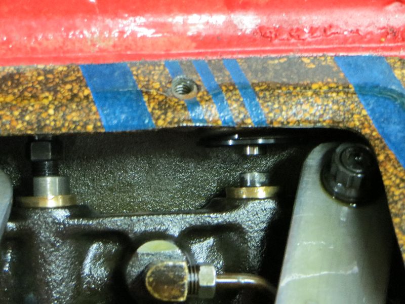

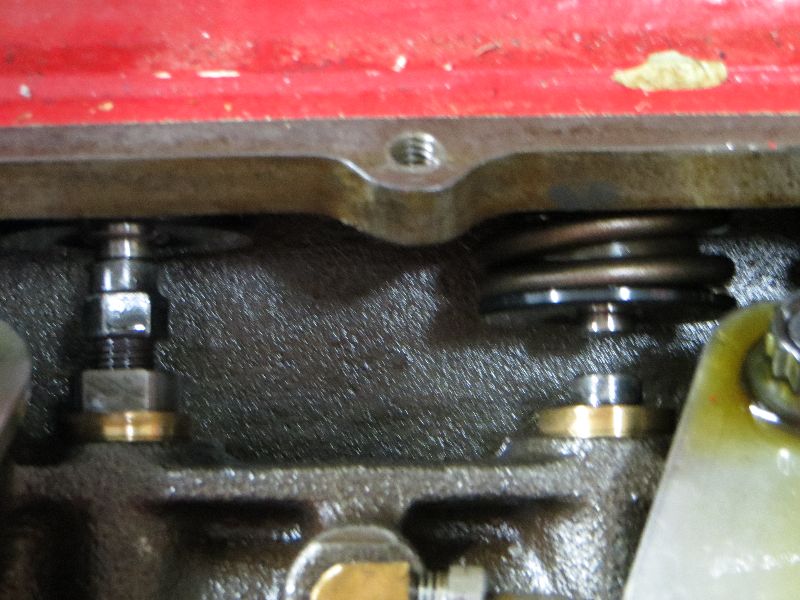

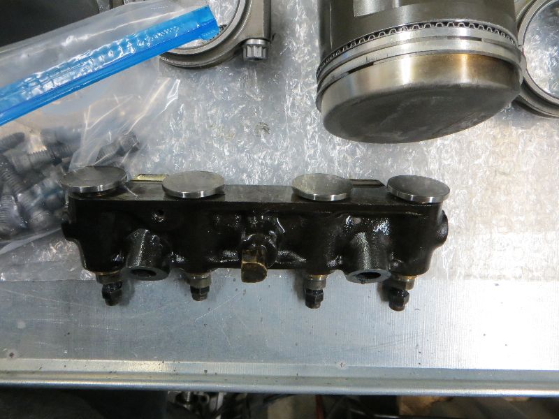

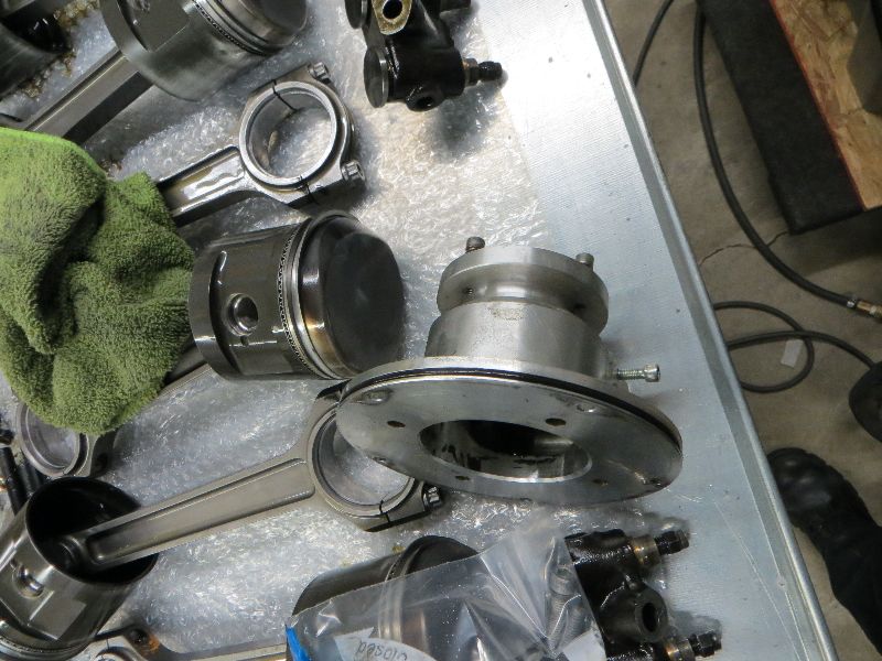

  11. What Shape Is the Patient In
    Okay, this won't be my normal babble with 10 pictures - you're probably all breathing a big sigh of relief. I'm in an airport bar - heading to Colorado for a short hunting trip.

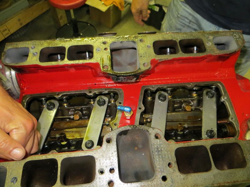

    Amy, Buddy and I tore the FlatCad apart on Wednesday evening - or maybe Thurs morning. Given that this whole engine is an experiment, we were all wondering what shape the lower end was in?
    Cam: When we pulled the valley covers off we immediately noticed that a bunch of the lifters had backed off. Hmmmmm - looks like the cheap repop lifters had **** adjusters, 5 of them had backed off until the lifter adjuster bottomed out. Essentially, they dejusted to about .250 open. That is 1/2 what they should be. So the FlatCad ran like a beast with 5 out of 8 cylinders only having .250 valve lift - with no duration. I can't wait until we really can run with 100% cylinder filling - will be a HUGE beast.
    Bearings: We were really curious about the lower end - with only 3 mains and big horsepower, what would they tell us? Well, they were all in fantastic shape. Even the center main was not stressed and didn't show signs of 'side wear' - which is a sign off a lot of crankshaft flex. The front had just a bit of side wear - due to the pressure of the blower belt, but really a small amount.
    All I all, we are extremely happy how the engine has held up - better than can be expected.
    Now, we're going to work some more design magic on the lower end - in hopes of making it even stronger. We want it to be able to handle 700+ HP - so Don and I have some more girdle tricks up ou sleeves. Is it necessary? We have no clue, but we're going to do everything that modern design can do to shore up the lower end.
    This engine can definitely make some very big power - even on gas, so hopefully we can make it live.

    Yea, with all the boost-17psi, I don't think we dropped much HP, and you're Right Mark, we got a new pressure check on the engine!
    Tim, we got lucky, and barely scarred 2 lobes, but nothing that can't be polished out.
    The Dodge/Chrysler lifters are good ones, but these are Turkish repops. If I was going to do it again, I'd use the original ones, with jam nuts.

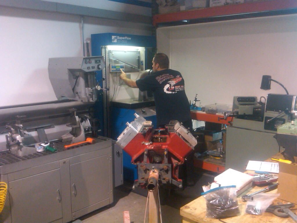

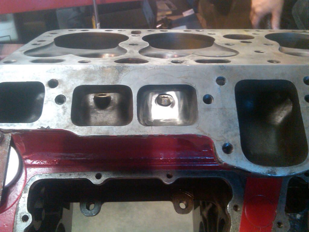

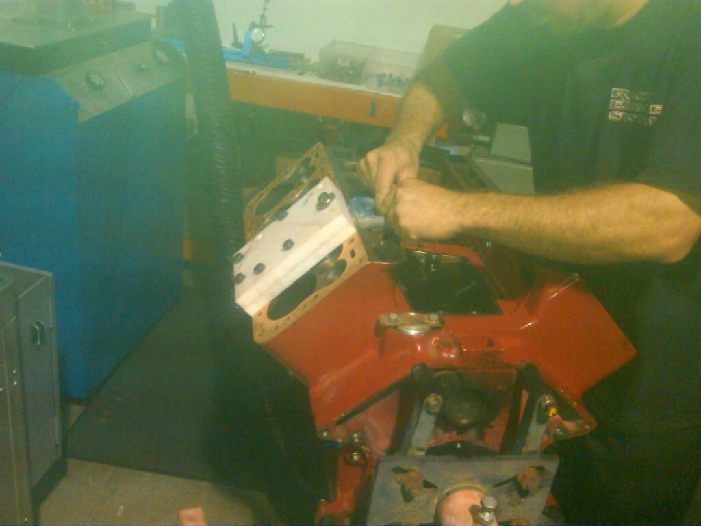

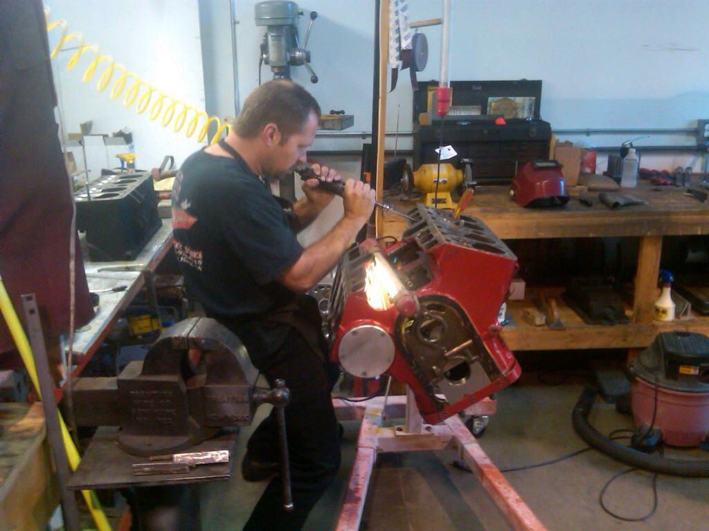

    I've just returned from 5 days In California, on a quest for more HP in the flathead- wow, did I ever get my **** kicked! More on that later!
    Tuesday morning, I met Rex Schimmer for breakfast, then we headed over to Dema Elgin's, and spoke with him about a cam. Rex, thanks for taking the time to meet with me-it was good to see you again!
    From Dema's I headed down to Rich Fox's, to pick up a ****** he loaned me. Always good to see you Rich!
    Then, on to Don's (Pops29) place, where I picked up the test chambers he cut, so that I could modify them, instead of our real heads. Don's always on top of this stuff!
    Tuesday night I was in Arroyo Grande, having supper with Garry Odbert. Garry was an immense help on everything- he even had his test block there, so we could compare the porting to his. Garry runs the Retarded Spark Special, a record setting Caddy flathead powered roadster. Thanks Garry!

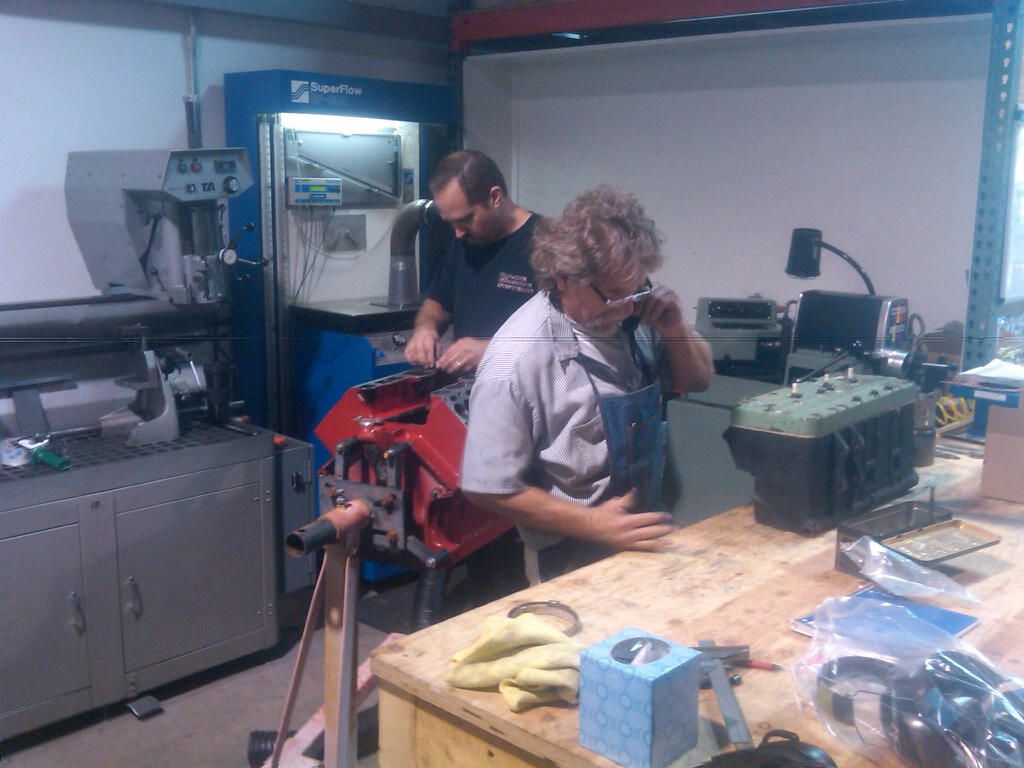

    Wednesday morning, Garry and I headed over to Race Engine systems, in Santa Maria, owned by Craig Gerfen. Craig was Alan Johnson's top fuel port and flow guy for 8 years, and had also ported Garry's Caddy flathead.

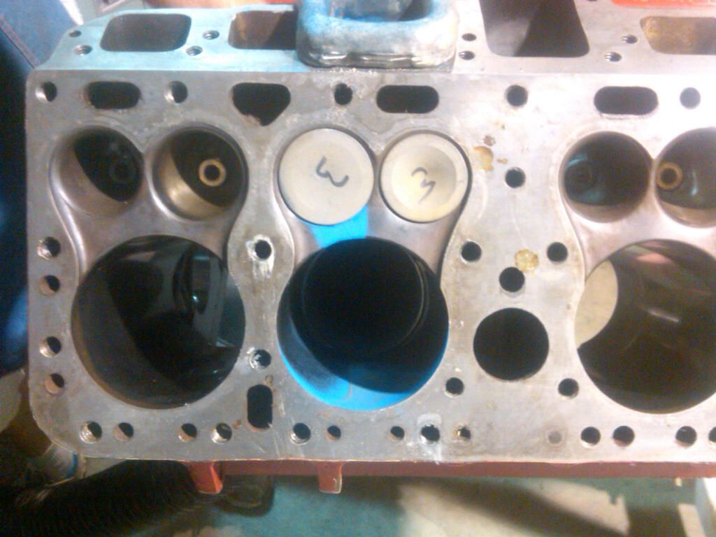

    Here is where the **** kicking started! I'm not going to post every number, test, and dye test we did, but I'll tell you what we found out. Plain and simply put, the ports are too LARGE, therefore velocity suffers, and they don't flow as well as they could. Across the board, we're down about 20 CFM from Garry's. We flowed my engine, then Garry's, back to mine, etc', so the data was current and reliable.
    After, trying everything to increase flow- different valve angles, different valves, different chamber designs, blending the valve guides, etc., to no avail, we tried a different approach. We added material around the short side radius. BAM- an instant 10 CFM gain! We played with this for a while, and determined we need to add material back to the ports, then do another port job. We also played with the relieved block, but that only reinforced my previous belief, and that belief is that it is a waste of time.
    So, I called Frank Morris with the Salt Cat guys, to find out what epoxy they had used on the Buick engine. Frank and Doug are great guys! Frank gave me the info I needed, sold me a set of 29" tires, so it was a win/win conversation for me! Thank's Frank!
    So, it can't get any worse, right? Wrong! We flowed the exhaust, and they sure do flow- too damn much! The exhaust out flow the intakes, and that is not good! That correction will come with the cam choice- my guess is we'll end up with a dual pattern cam.

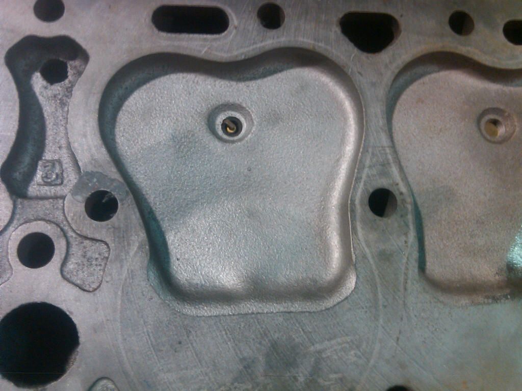

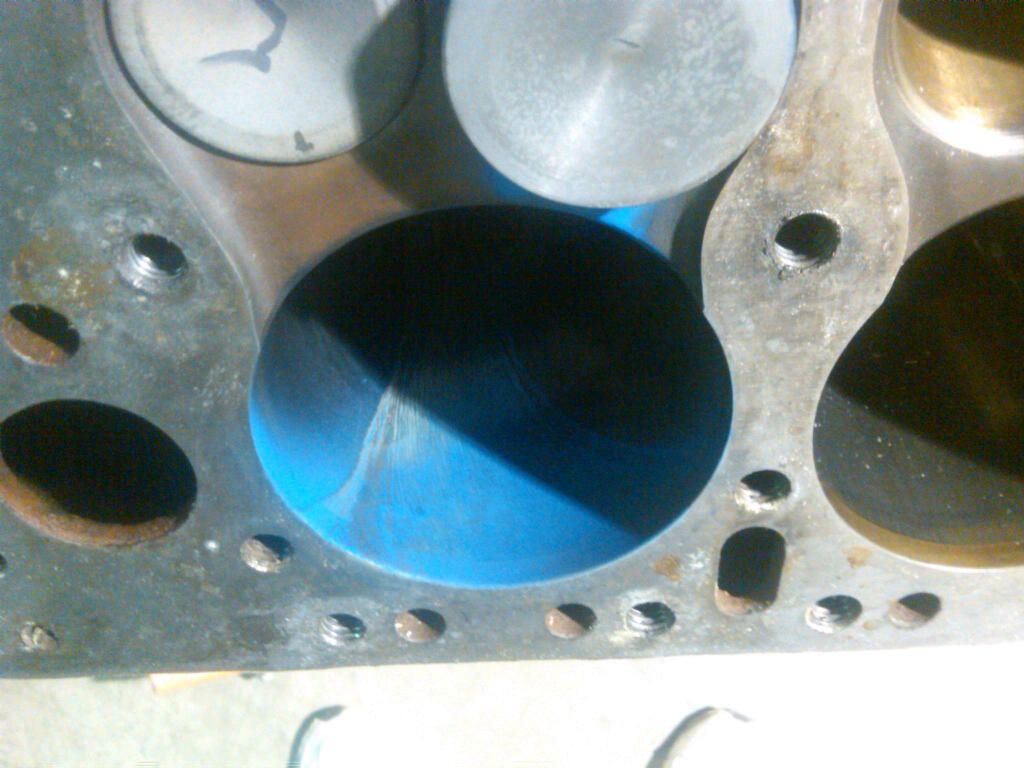

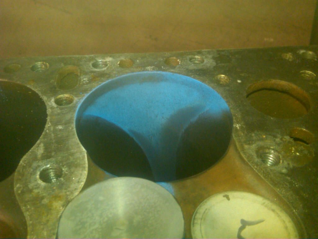

    We did a couple of dye testS, to see what was going on in the chambers. With our current setup, the A/F mixture swirls around in the chamber, running back into itself- basically creates a traffic jam in the chamber. We took the angled ramp out, and straightened that transfer area out. On my engine, we see a small inrease on flow, but a lot better flow pattern out of the dye.
    At the end of the day, the stock block, ported, with a stock 106 CC Caddy head, flows better than the FlatCad head and either of the 2 mods I made, better than Edmunds, and better than Cyclone! The stock head has several complex contours and ramps in it, and flows well- it appears the Caddy engineers really knew their stuff!
    So, to gain the CFM I went to California for, we need to add material to the ports, re-port the block, and change our chamber design. Here are numbers from the #8 cylinder, which is the best flowing cylinder on Garry's car- he flows 200 CFM on the intake side. Our best cylinder was # 3
    ................#8 intake ........#3 intake .........#8 exhaust
    .100 lift .........69 .................64 ....................73
    .200 .............121 ...............118 ...................120
    .300 .............154 ...............157 ...................145
    .400 .............175 ...............173 ...................165
    .500 .............173 ...............180 ...................174
    .525 .............173 ...............179 ...................176
    Here is what is typicle of our worst ports, intake only
    ...................#5 intake ..........#5 intake modified with clay
    .100 lift ............63 ......................60
    .200 ................114 ....................110
    .300 ................150 ....................151
    .400 ................162 ....................169
    .500 ................163 ....................174
    .525 ................163 ....................174
    At this point, I had the knowledge I had came for, and I loaded up and headed back to Don's place to spend the night. After a nice dinner, Don and I retired to the garage, to smoke, joke, and bench race. Don, as usual, it was great seeing you and Dar- many thanks!
    Friday I headed for the house, but stopped in Salt Lake City to visit Kenny Kloth, as I had some specific questions for him about roller lifters and his chamber design. Kenny is a great guy, and a wealth of knowledge, He was very helpful, and informative. I stayed a couple of hours, but easily could have stayed several days, had time permitted.
    So, the HP quest continues!
