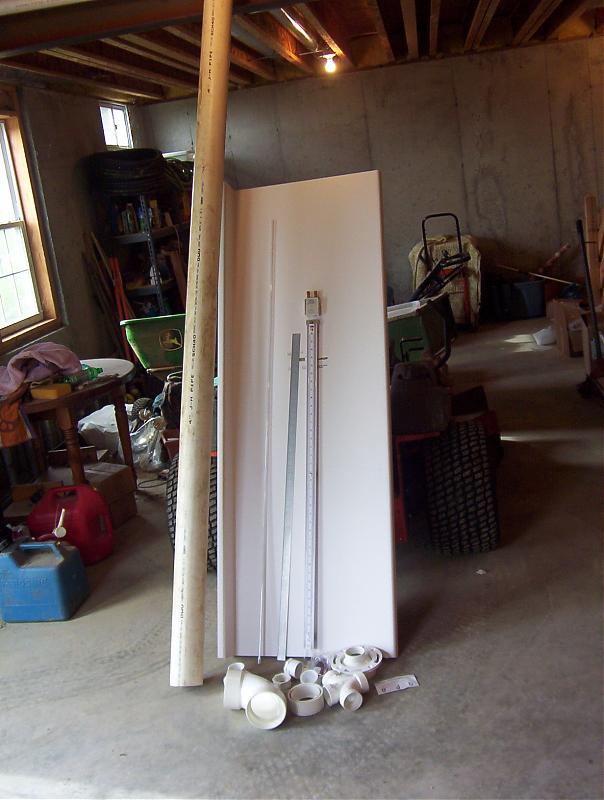

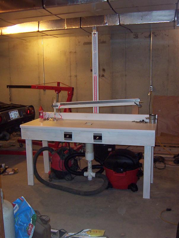

    I built my flow bench for about $200....I am a cheap******** :)

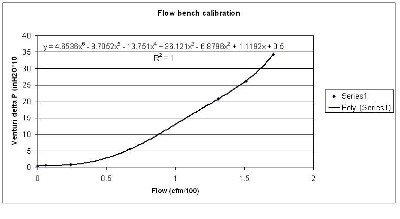

    Mark, I don't have much more in this one! I probably need to hook up with you, to make sure I use it to it's potential!;)

    You win if you didn't have to spend you time and it was still cheap! :)
    Everything you tested sounds right to me.
    I usually do the port size based on straight up math.....I want to see at LEAST 160ft/sec port velocity, but 190-195 is where everything seems to work best. I wan tthe peak velocity as close to the seat as possible then the port should taper larger at about 2 degrees going away from the valve to the carb/blower/whatever. That's my secret formula....oops, it's not a secret any more :eek:

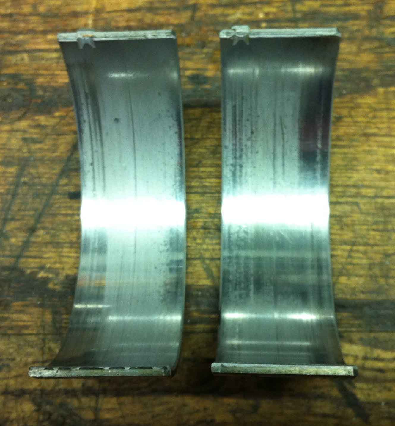

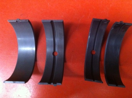

    Well - here are the pictures of the key lower end components - everything looks really normal . . . better than I had expected.

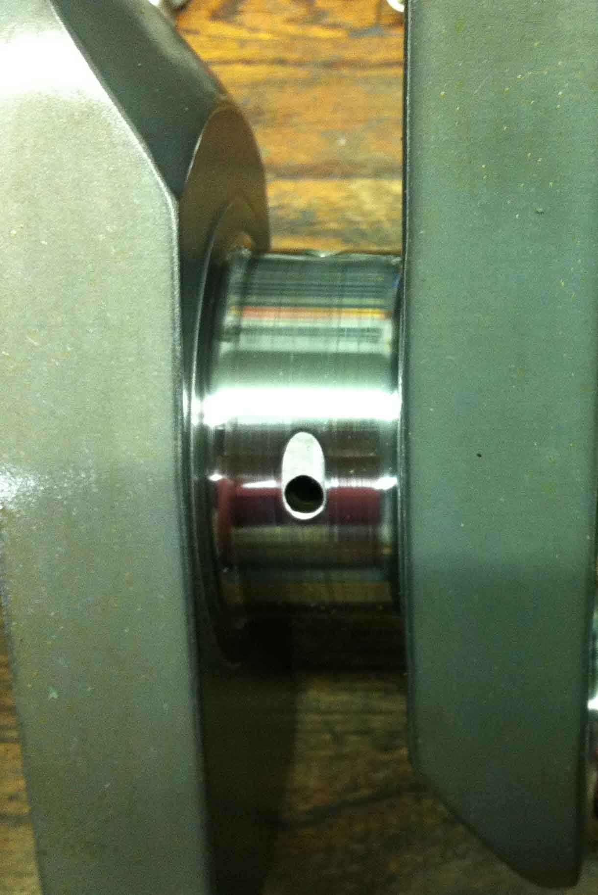

    Here is the crankshaft journals -- the mains are in good shape, the rod journals have a bit of wear on the back side. After close inspection today, I believe that they'll need to be ground undersize to .010 . . . as I can feel some grooves with my fingernails.
    Here are the bearings - in pretty dang good shape. Maybe our 'priority main' oiling system kept them happy? :rolleyes:
    A piece of***** went through the center main, but all-in-all, they were in nice shape for what they went trough.

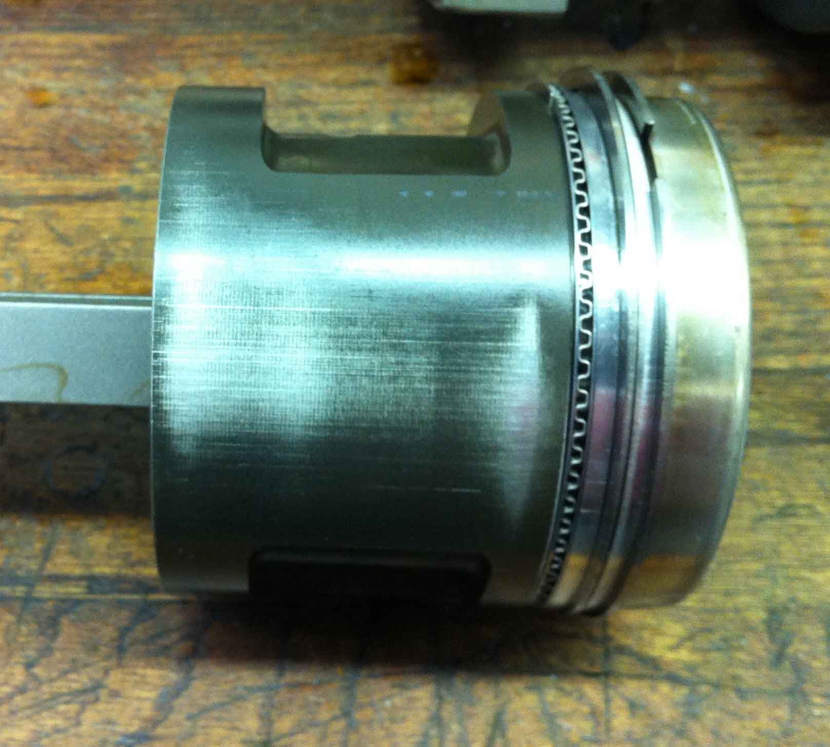

    Here are a couple pictures of the pistons. They were coated by our sponsor (Finishline Coatings) - with a ceramic coating on the tops, a friction reducing coating on the sides and a oil shedding coating on the undersides. Given the extreme piston speed we experienced, they look really good.
    Even though we're running a dry sump, there was plenty of oil up in the pins, the skirts looked really good and the HTD rings showed a really consistent sealing surface all around.
    Everything looked really normal/good - especially considering that this engine had quite a bit of time on it (for a 100% purpose-built race engine) . . . with no checks or freshening up since the dyno.

    [FONT=Times New Roman, Times, serif][quote author=BoredAndStroked link=topic=8271.msg208807#msg208807 date=1353802413]
    [FONT=Times New Roman, Times, serif]Take a look at the bearings - in pretty dang good shape. Maybe our 'priority main' oiling system kept them happy? [/FONT]
    [FONT=Times New Roman, Times, serif][/FONT]
    [FONT=Times New Roman, Times, serif]Even though we're running a dry sump and this beast has an extremely tall deck (8.75" rods), there was plenty of oil up in the pins, the skirts looked really good and the Akerly HTD rings showed a really consistent sealing surface all around.
    B&D
    [/quote][/FONT]
    [FONT=Times New Roman, Times, serif]The stock priority oiling system is very good, no doubt about it. Adding the dry sump and more volume only adds to the success of the design![/FONT]
    [FONT=Times New Roman, Times, serif]Even though we had plenty of oil to the piston pins this year, it doesn't make me feel warm and fuzzy about next year. We're discussing going to vacuum in the engine next year, so any benefit of 'splash oiling' we had will be lost. Even if we have adequate pin oiling, we can still benefit from cooling the pistons with oilers.[/FONT]
    [FONT=Times New Roman, Times, serif]I don't agree, however, that we need to run 100 psi in this engine, for it to survive-not even close! I think if we could enlarge our oil ports, thereby increasing volume while decreasing pressure, we would be more successful. It would be better for the engine internals, and take less HP to run the oil pump.[/FONT]
    [FONT=Times New Roman, Times, serif]Now, just like Paul Harvey- The Rest Of The Story![/FONT]
    [FONT=Times New Roman, Times, serif]For the amount of runs on the engine, the bearings look good. The front main bearing showed some crank flex, but I attribute that to the blower drive, since the front showed the most.[/FONT]
    [FONT=Times New Roman, Times, serif]I'm interested to see if the rod bearing wear is confined to a couple of rods, or the center ones. [/FONT]
    [FONT=Times New Roman, Times, serif]The pic of the rod bearing shows the effect of geometric irregularities. This could be because of crank flex, but there are other possible causes. A slightly bent rod, detonation, or rod journals ground with a slight 'hourglass' shape can also cause this wear. [/FONT]
    [FONT=Times New Roman, Times, serif]There is even more to this story though, and I suspect it probably contributed to the wear- We misused the rev limiter this year. Instead of setting it higher than we needed, and only having it there in an emergency, we ran against the rev limiter, using it to determine the max RPM we hit each run.[/FONT]
    [FONT=Times New Roman, Times, serif]Sparky Smith was kind enough to point out the error of our ways, and the explanation made perfect sense to me. What we were doing was having some pistons loaded, then randomly unloaded, in no certain order. I can't help believe that this probably added to our crank flex.[/FONT]
    [FONT=Times New Roman, Times, serif]The bearing clearances are one of those things that Dale and I have discussed in depth for the past year. I don't believe we can open the clearances up enough to not show wear from crank flex-the flex is bound to be more than the additional .002 or so that we would open them up. Nor do I think that it is necessary. The mains have the following clearances F = .0035, M = .0035, R = .004, and the rods have .025-.075. The Mains are 2.75", and the rods are 2.1"[/FONT]
    [/FONT]
    [FONT=Times New Roman, Times, serif]Increasing bearing clearances are not necessary in my opinion, but finding out why we have that wear is. I truly believe proper use of the rev limiter will help, but I have no doubt that we will still have crank flex with the 3 main bearing setup.[/FONT]
    [FONT=Times New Roman, Times, serif]GOATROPER02 , of Ross Racing Engines, is taking over our engine machine work. Hopefully, he'll weigh in here with his thoughts![/FONT]
    [/FONT]

    I'd like to see these bearings in my hand to look for things I can't see in a pic.....
    That being said,you are looking at some crank flex which I dont know if you will ever stop with a 3 main block.....does this engine now have some sort of crank support for the blower pulley? If it doesnt I would look into building one. (I looked back and I see It does.)
    Also I see a ton of trash having run through the bearings also.....alot of what you are looking at is dirt....that has nothing to do with stress.
    I see it in the skirts also.
    Tony

  15. GOATROPER02
    Joined: Mar 22, 2006
    Posts: 2,059
    GOATROPER02
    from OHIO
    Also your Crower billet is tough enough(heat treat) to stand abuse without scratching like that.....again I will say a lot of what the crank shows is debris.....Even when bearings are beat up and babbit is sqeezing out one edge from getting loaded.....you will see stress cracks in the babbit.....but the crank will look brand new.
    Coated bearings will not protect from debris.....keep that in mind.
    Here are coated mains from 2 different engines making over 800 HP each that have well over 1000 laps plus dyno time.......motors in for normal freshening..... They could have been put right back in.
    When an engine is cleaned properly at****embly time....and has a proper filter system...oil/and ventilation ..... This is what a bearing should look like.
    That's my thought looking at some pics....I'm sure we'll know more when I see parts in person.
  16. 38FLATTIE
    Joined: Oct 26, 2008
    Posts: 4,349
    38FLATTIE
    from Colorado
    Tony, On the pressure side of the dry sump, we have a Wix 20 micron oil filter. On the scavenge side, we have a 3 micron filter, between the pump and the oil reservoir.
    That is far more filtration than most engines have, so I'm guessing that filtration is probably not our problem?
  17. GOATROPER02
    Posts: 2,059
    GOATROPER02
    from OHIO
    That is good.....could be from****embly or ingesting though breathers?How is tank vented? Also dont forget.....if you go to a vacum system you can pull dirt inboard also....crank seals/ect.....and Im not sure how much you can ingest through the bugcatcher without an aircleaner....I need to see cylinder walls first.
    We will talk when I can look first hand....

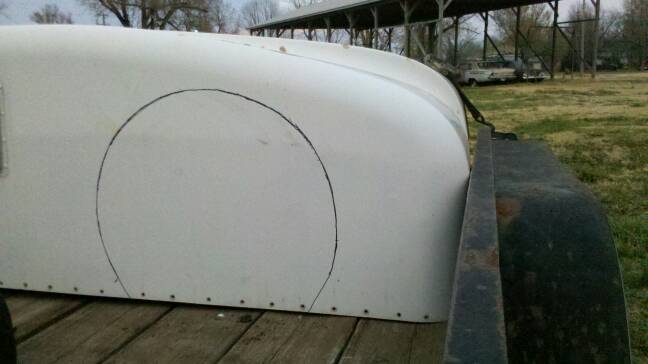

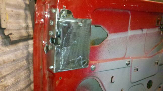

  22. wrenchbender
    Joined: Sep 5, 2007
    Posts: 2,469
    wrenchbender
    Well i am gonna give this a try to see if i can post pics and a little commentary as well if this dont work be patient ill send buddy the pics and he will post them. Anywho here is a few progress photos on the aero side of flatcad. Drip rails have been removed and are in process of being bolted back on. Door handles are gone as well. The*****py old wore out door latches went to file 13 as well. I have made new ones using some bear claw latches some recycled carb linkage and a door pin and bushing set. Normaly installing these latches is no big deal as most people use solenoids and such to get in but that is not really an option here so instead a mechanical push*****on will be used and no you cant buy the damn things so just like everything else on the flatcad it will be a one off custom made part. Also we have a new sponsor as well the chrome shop mafia has sponsored us an entire roof off a 379 peterbuilt truck yes i said a peterbuilt haha. With this roof and a bit of fiberglass work we will make the front air fairings for the flatcad. As you can see in the pic i have drawn the outline of the tire placement to give you an idea. Buddy had posted a pic awhile back of what the front fairing kinda looks like. Thats it for now all you flatcad fans stay tuned
    Sent from my DROID device using the TJJ mobile app
  23. WZ JUNK
    Joined: Apr 20, 2001
    Posts: 1,913
    WZ JUNK
    from Neosho, MO
    Wow, you are getting things done. I am anxious to see that piece of fiberglass. I am still making the plug for the inner part of the air scoop. I have had lots of setbacks but I am making progress.
    John
  24. 38FLATTIE
    Posts: 4,349
    38FLATTIE
    from Colorado
    Looking good Randy! Those bolt on drip rails will have a few guys scratching their heads! Lol!
    John, I can hardly wait to see the 'glass work!

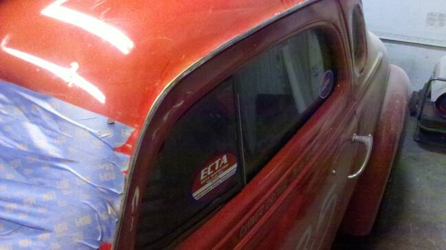

  26. joemac05
    Joined: Jul 29, 2006
    Posts: 503
    joemac05
    For some reason I got lost here. :confused: I don't quite understand the drip rail thing removing them and then bolt them on? :eek:
    Regards,
    -Joemac
