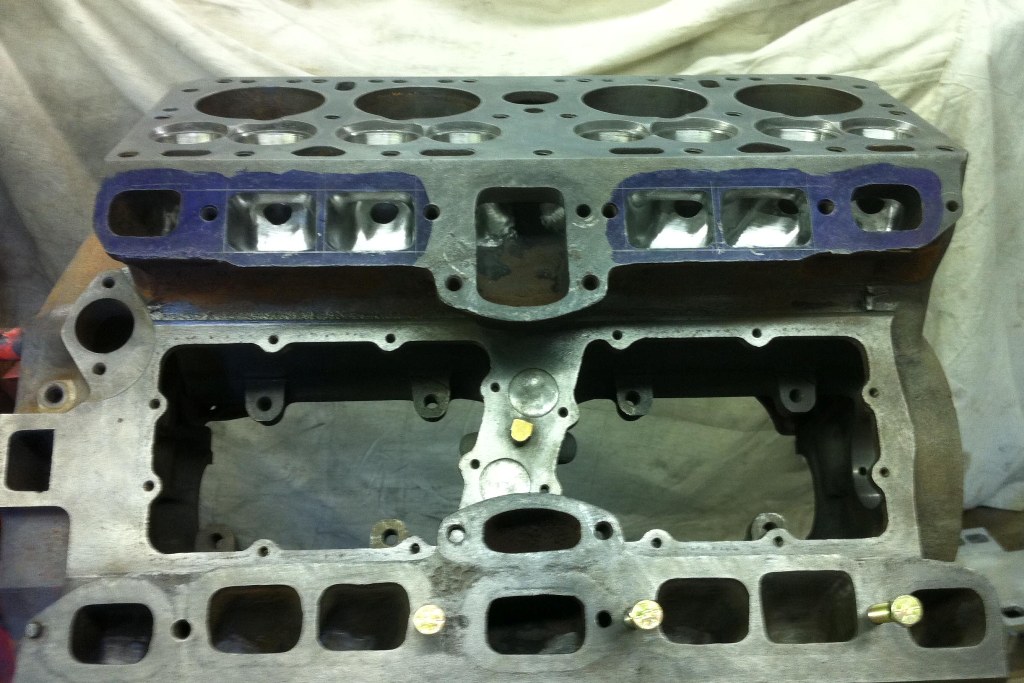

    Well, here we are at the last minute again, this time trying to figure out direct port injection, instead of intake manifold injection.
    Here is what we are thinking: have an aluminum block/plate that probably is mounted off of a valley plate -- it would be right against the port wall. These aluminum blocks would be 1/2" thick and tapped for the nozzle. The blocks would also be located/angled as necessary for port direction. Then, there would be a hole drilled through the cast iron into the port and if there was any material left to thread, then
    we'd thread it. If too thin, then we'd need to seal it with something that can
    take boost - like epoxy. there will not be much block material to use - especially on the angled ports (4 of them).
    Anyone got a different/better idea?

  26. dragsled
    Joined: May 12, 2011
    Posts: 1,975
    dragsled
    from Panama IA
    That sounds like it should work Buddy, Tim Jones

    how about o-ring sealing where you go into the ports
  28. O-Ring: Yeah, it will kind of depend on how good I can get the port plates to conform to the contour of the cast iron - might use an O-ring between the plate and the block (kind of a thicker rubber ring like you use on bulkhead stuff). I'll be designing the stuff this evening . . . we'll see how close I can get it and not make a machining nightmare out of it!
    Dale

  30. 64 DODGE 440
    Joined: Sep 2, 2006
    Posts: 4,433
    64 DODGE 440
    from so cal
    Why not just mount the injector nozzles in the ports of the manifold just above the block? Easy to weld in threaded bosses for the nozzles at whatever angle you want and the plumbing can remain ***embled as a unit when removed from the block.
