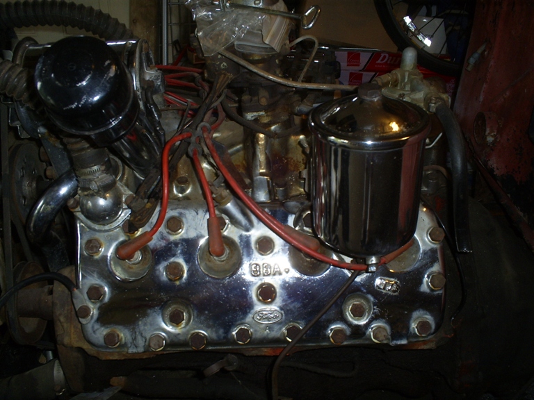

    I have a good running flathead that I pulled out of a shoebox 2 years ago, before I pulled it out the car had a 12v battery that the car was running just fine off of. I am getting ready to wire my new project up and have a question. I do not see a 12v marking on the coil, the generator has no marking on it either. this car ran with the 12v battery before I pulled it and I drove it. is there a way to positively identify the points in the dizzy as being 12v? I can replace the coil to assure myself there. What is the best way to test the generator as being 12v? I have never converted a 6v to 12v and want to make sure I go about this properly. It may already be convereted as I am assuming it would cook the points if it werent.
