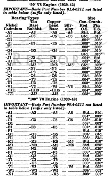

    I've got a set of NOS 21A rods and a set of NOS FoMoCo rod bearings. They are "A6" bearings. "Sil-Alloy" on the Ford chart.
    My concern is that they aren't a desirable bearing. There were 6 different full float factory bearings. I've read certain ones eat the crank. Cad-Silver being the best. Is A6 Cad-Silver?

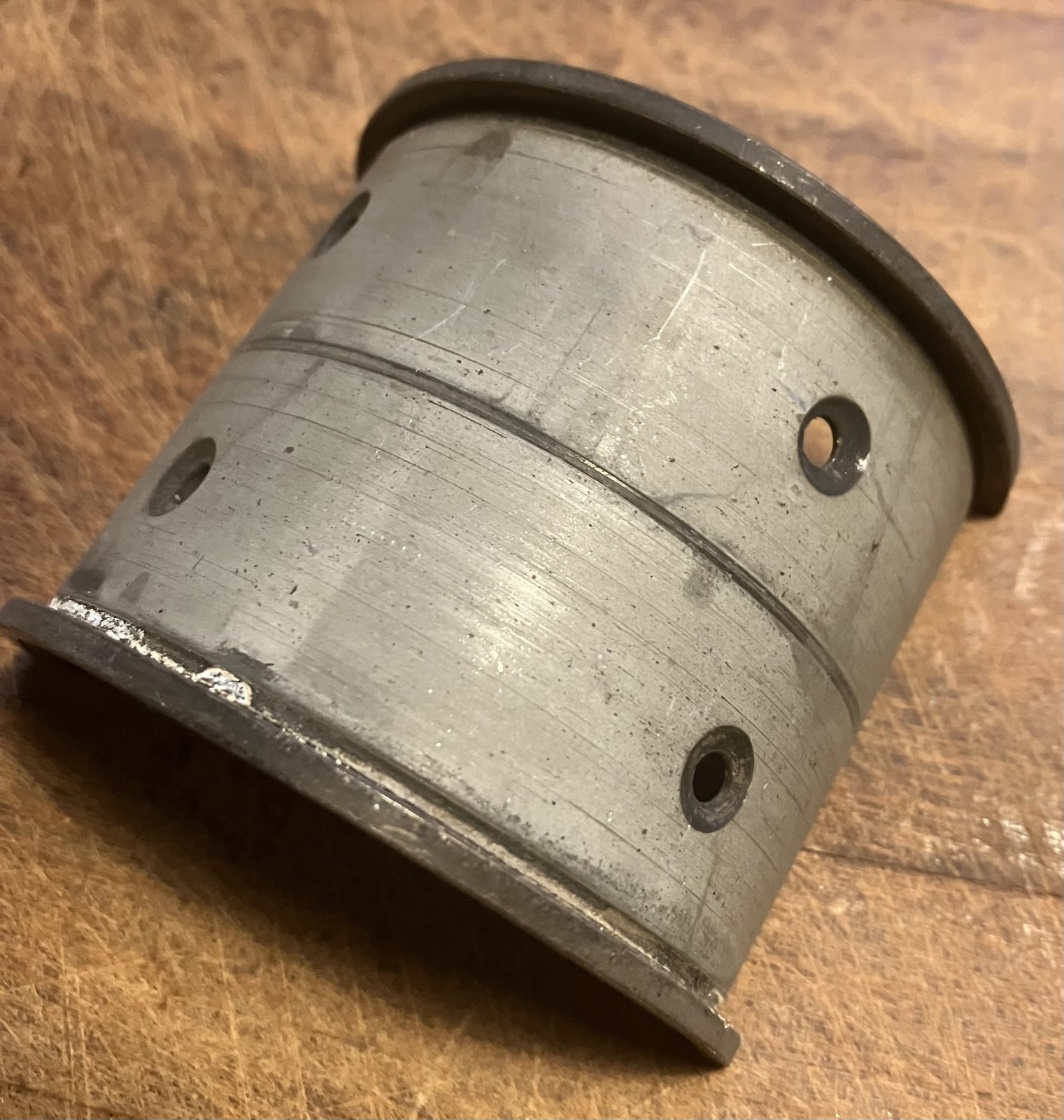

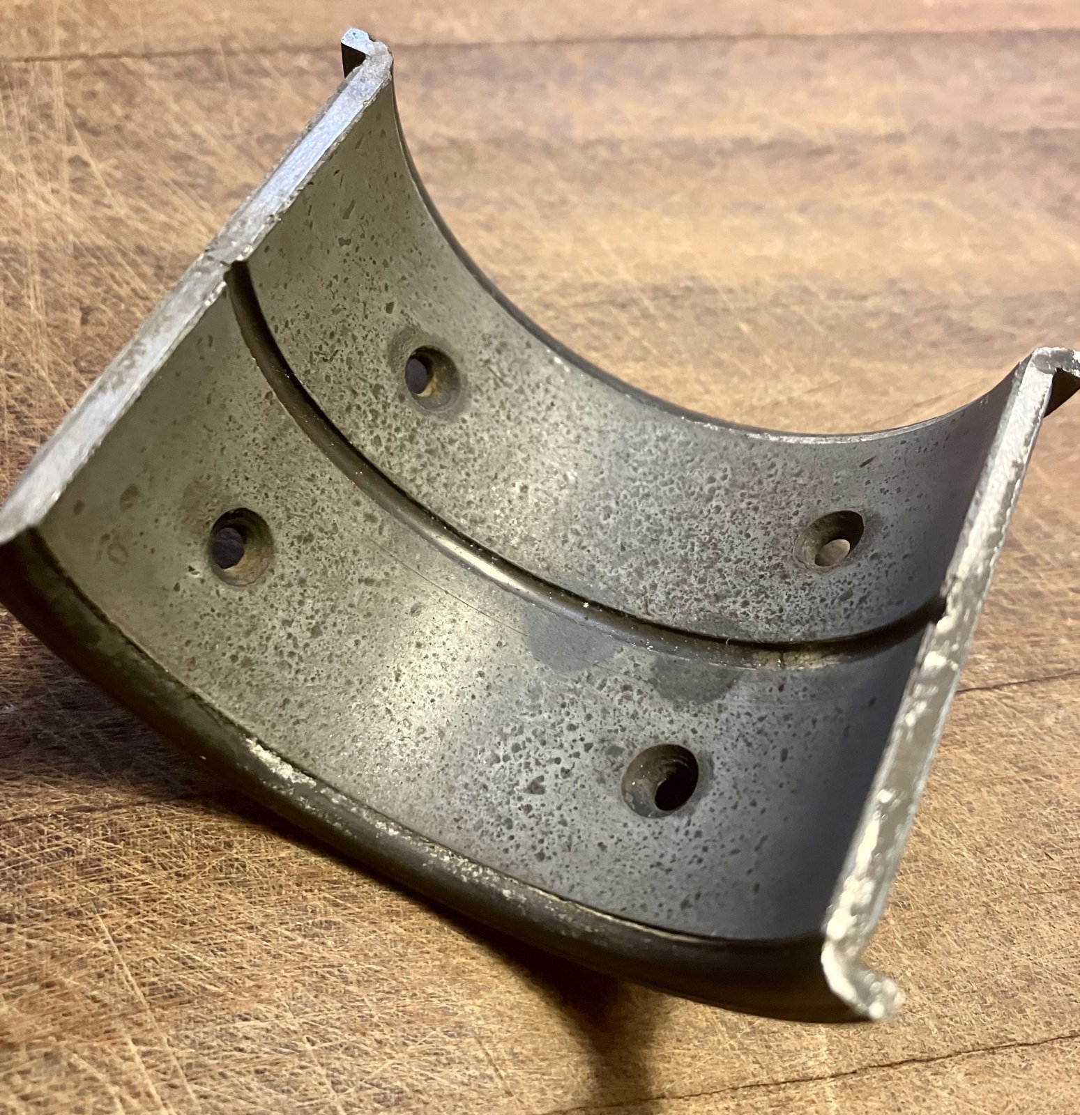

    A214CCC5-0D42-4D49-BE55-F3F2DA2E259E.jpeg 7ED426E5-C0DA-447C-8E15-56789CC096CF.jpeg Can’t really answer your question but these are the bearings from my’34
    Had a rebuild sometime back in the day crank ground.010” under mains and rods
    Everything still measures within spec but recently found out that the rods could also be honed oversized so will have to go back and measure rods

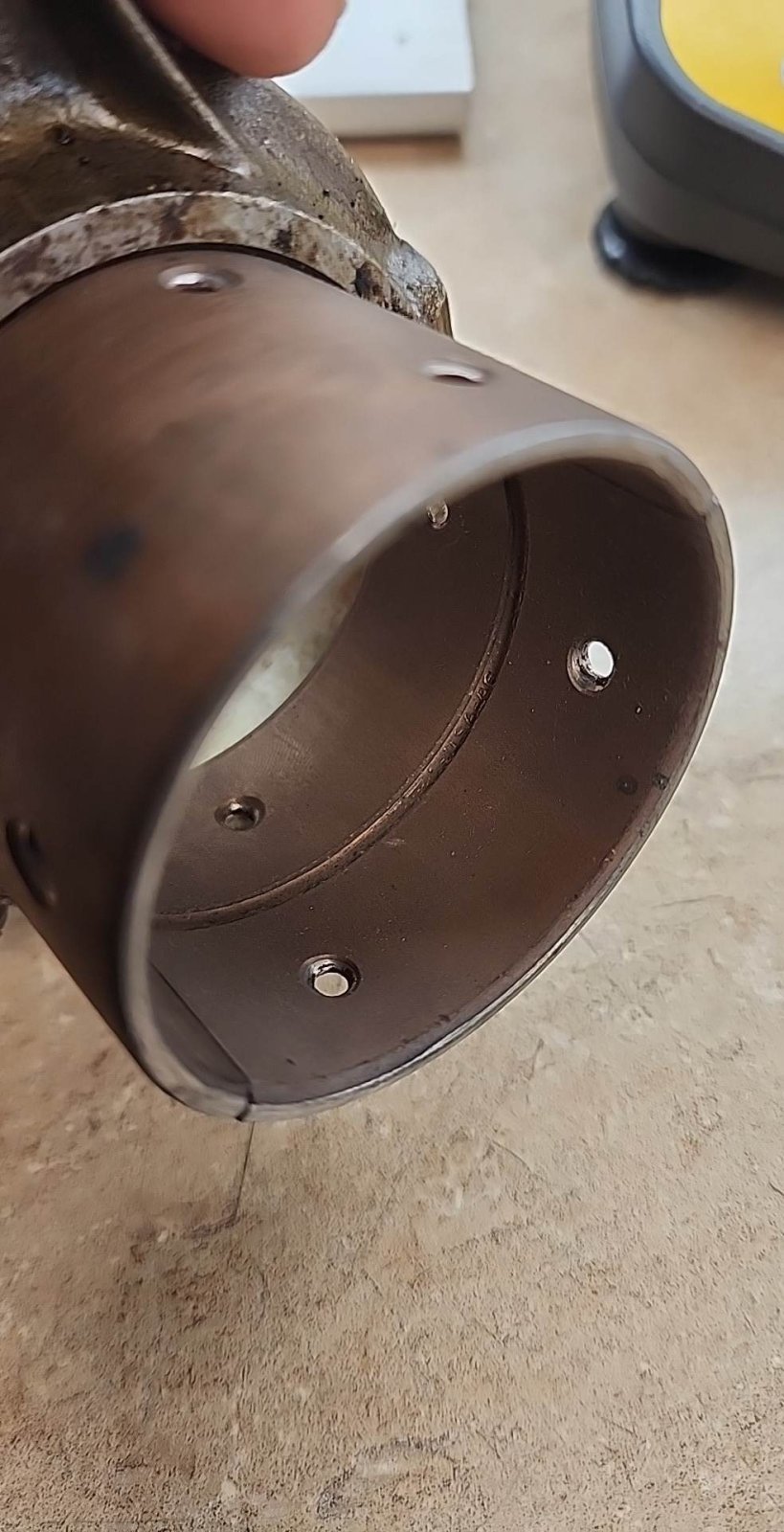

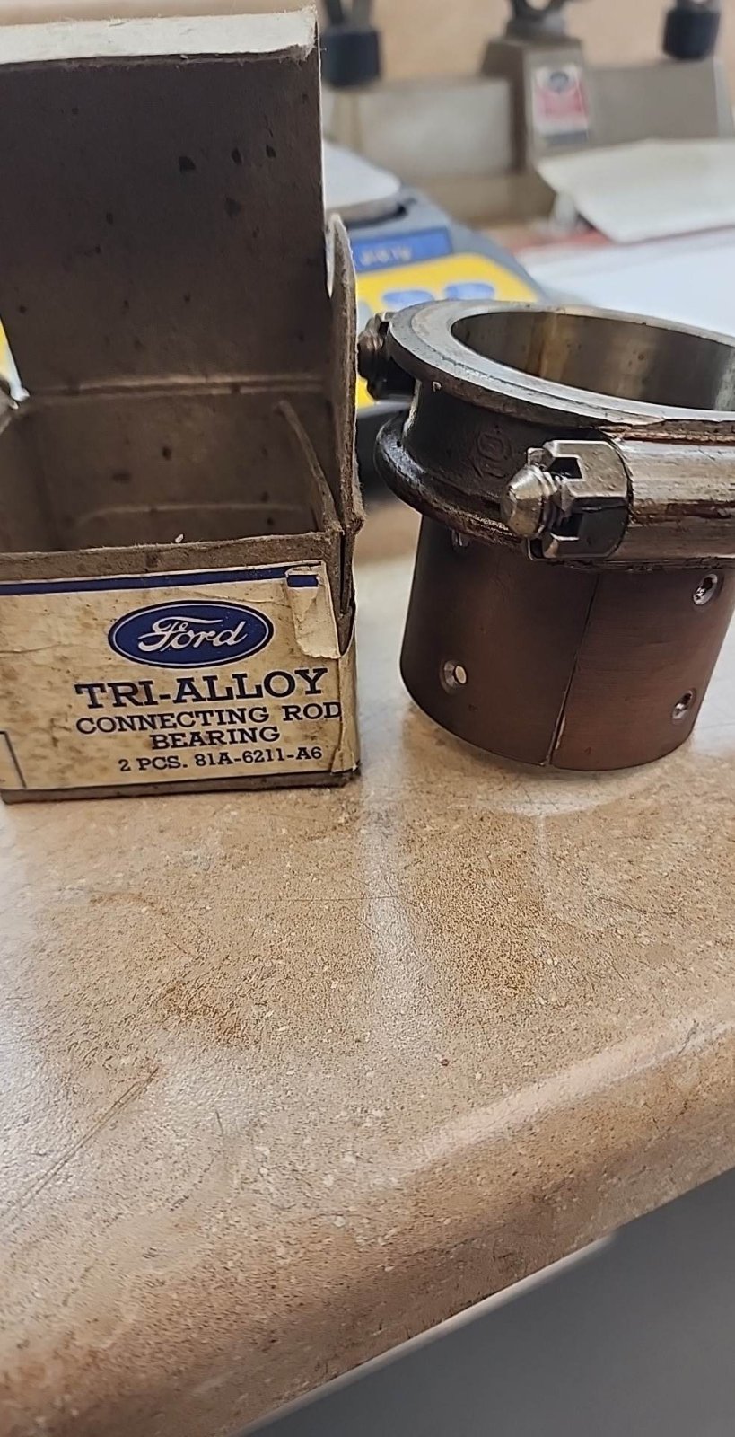

    It looks like we have the same parts and looking to have the same application. I have the 4 1/8 offset Merc crank along with two sets of original NOS 21A rods and two sets of original NOS 81A-6211-A6 Std. connecting rod bearings. One set of bearings look to be the same as yours, namely the Ford Tri-alloy connecting rod bearings. The other set I have are are in Ford boxes as well but are marked "Silvaloy" on the box. The box is blue and white with the blue Ford oval all over the box and by the Silvaloy name on the box one has to ***ume that these connecting rod bearings are a silver alloy. I have opened up both boxes and both sets of bearings look to be identical.
    I have a an excellent 100% crack free 59L block and fully intend to use the crank, rods and bearings in the rebuild of this engine. No China made parts for me. I'm wondering if the bearing failure or the crank eating up the bearings was due to lack of bearing lube or improper ***embly to begin with. I can't see original Ford bearings such as these prone to failure. These NOS sets of bearings in original Ford boxes are next to impossible to find.
