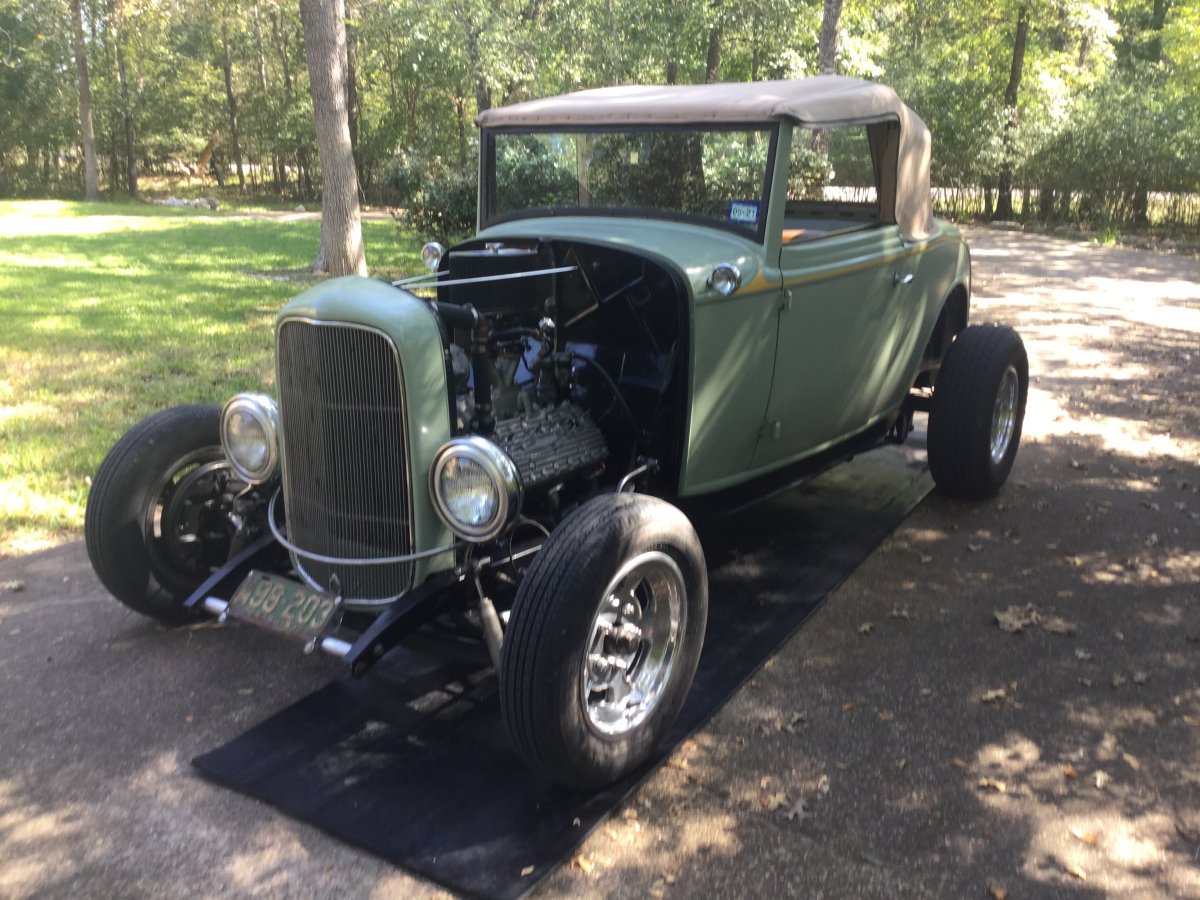

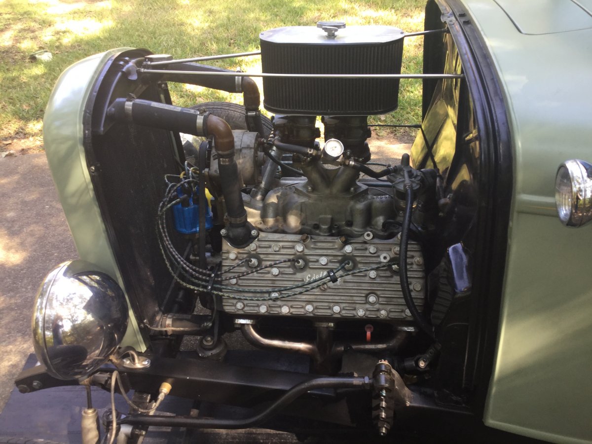

    D6C67856-3ABC-4BC2-81E2-574C4F528133.jpeg 3E04B7DC-C84B-437E-8EB9-47D775F9FD7C.jpeg CE7C3DB9-0970-44B9-AF60-A00494ECB08B.jpeg Have put together many flathead Motors over a 55 year period——probably 20 or so for myself——noticed a large amount of “drag” if using all 4 rings——also noticed I don’t get 10,000 miles out of those engines b4they start “smoking” pretty bad and time to tear down and re-do over. This latest engine was a .020 bore and 4 in crank—-thought I would try using all 4 rings—-best running engine with 160 psi in all cylinders. I think 4rings definitely helps to control “piston rocking” which in theory will wear the bore quicker if ***embled using only 3 of the 4 rings.. note I am 73 years young and run my hot rod “pretty hard”——so hard I gave up using early Ford trans and banjo rears over 35 years ago.My heavy foot requires Chevy 4 & 5 spd trans and 9 in Ford exclusively! Generally 3 ring pistons are for racing—-Jahn’s & Ross come to mind. My 32 Henry cabriolet runs 80 in the 1/8 but is driven nearly every day because of mild weather in s. Texas.
