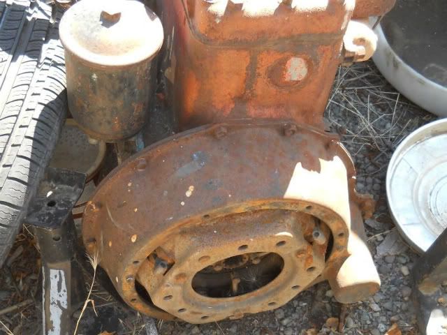

  2. 51504bat
    Joined: May 22, 2010
    Posts: 5,572
    51504bat
    six.JPG V8.JPG Different
    Edit:
    Photos from the Wilcap site.

  3. ActionYobbo
    Joined: Mar 28, 2022
    Posts: 336
    ActionYobbo
    V8 and L6 are different and dont interchange

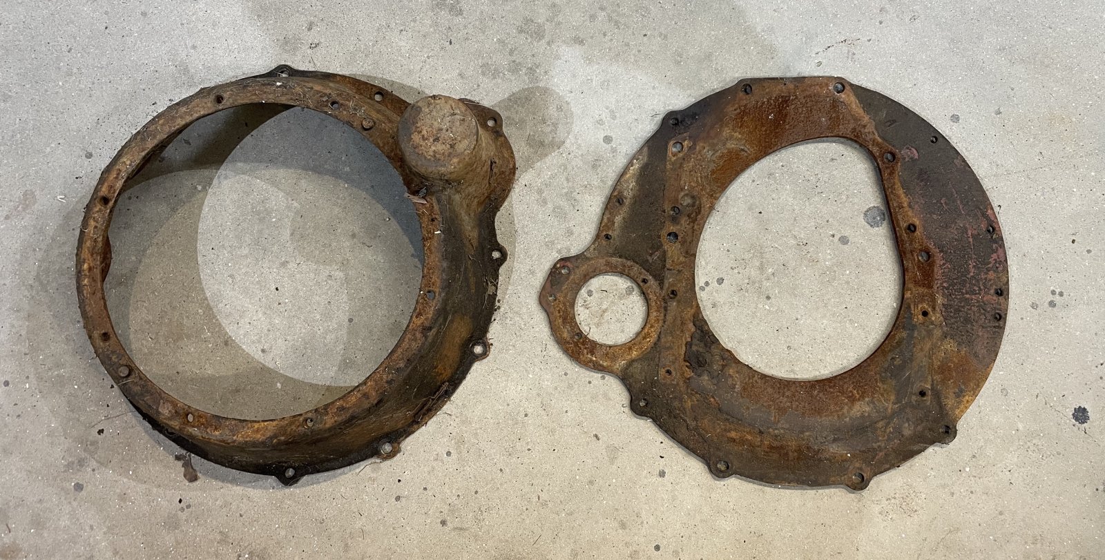

  5. Chop50
    Joined: Jan 16, 2006
    Posts: 226
    Chop50
    I see what it looks like now, is that the starter plate behind the bottom picture? Looks like a full plate.
    Thank You for posting -Steve

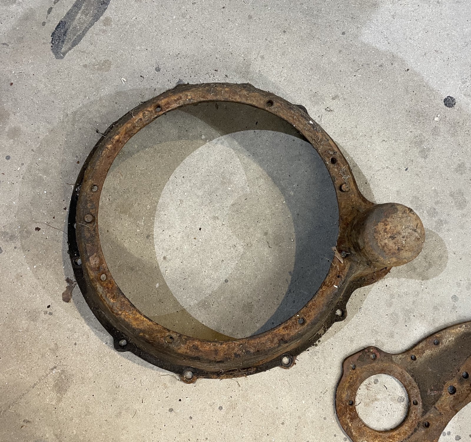

  6. Glenn Thoreson
    Joined: Aug 13, 2010
    Posts: 1,017
    Glenn Thoreson
    from SW Wyoming
    The same on the transmission side, but different on the engine side. It's a no-go.
  7. Mr48chev
    Joined: Dec 28, 2007
    Posts: 35,849
    Mr48chev
    I can get a photo of just the plate if you need it. That setup is for the six going into my speedster.

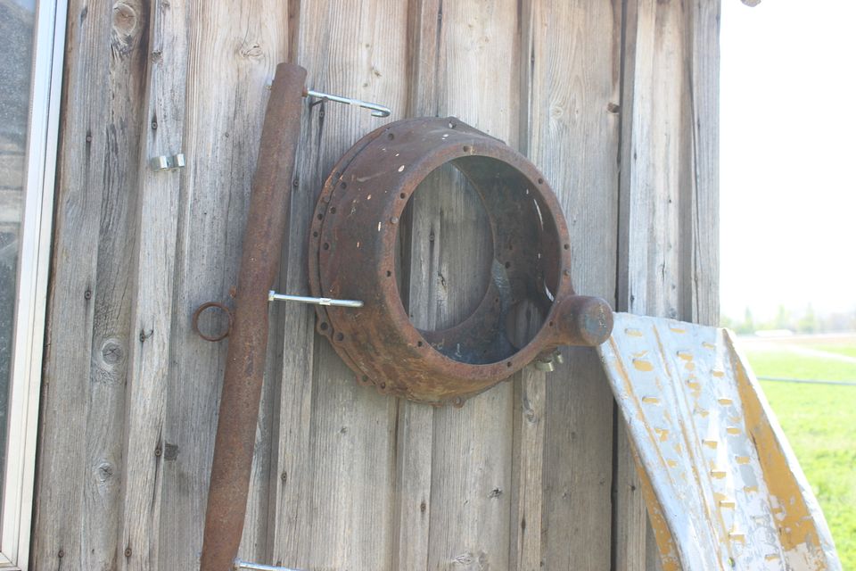

  8. hotrodarchaeologist
    Joined: Dec 4, 2007
    Posts: 657
    hotrodarchaeologist
    from Maine
    Approx 1950 to 1952 Ford pick up six cylinder…
