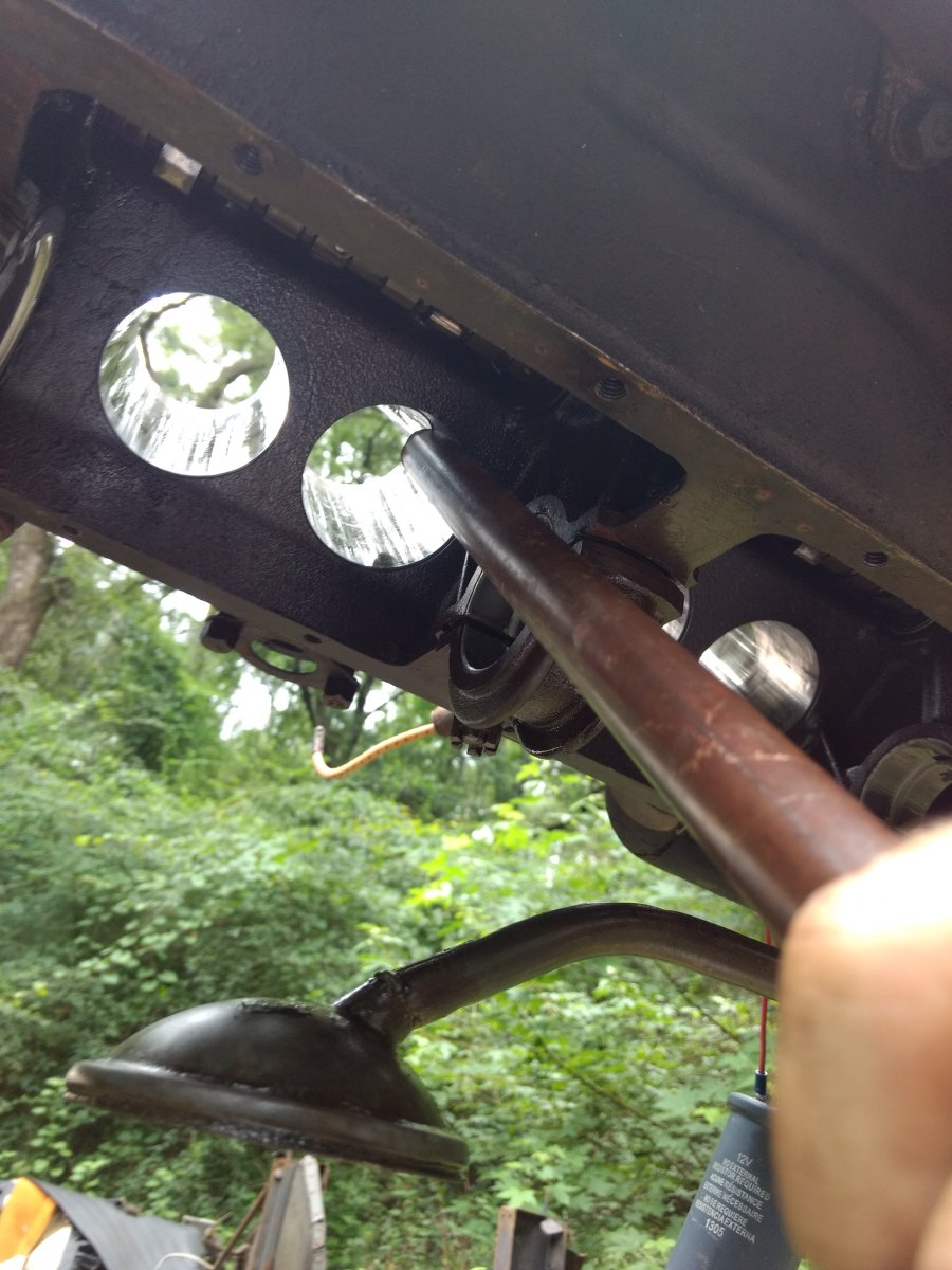

    Well, I should have known better. Turns out they do come out from the top, it's just a very tight clearance with the big ends. Lying on my back looking up, I couldn't see that one side of the rod was catching on the little lip the sleeve makes. Like I said, I was planning to drop the crank, anyway, I'm glad I did. Everything looks pretty good, to me. I haven't mic'ed anything, and don't plan to (no offense, but this is kind of a poor boy deal). Cam looks new. Rings look fairly good, too. Even the ones that were in the pitted bores. It must have never run much after that water got in there, maybe only my 10 seconds? Here are some pictures. Don't fuss at me for doing this outside, I don't really have another option.

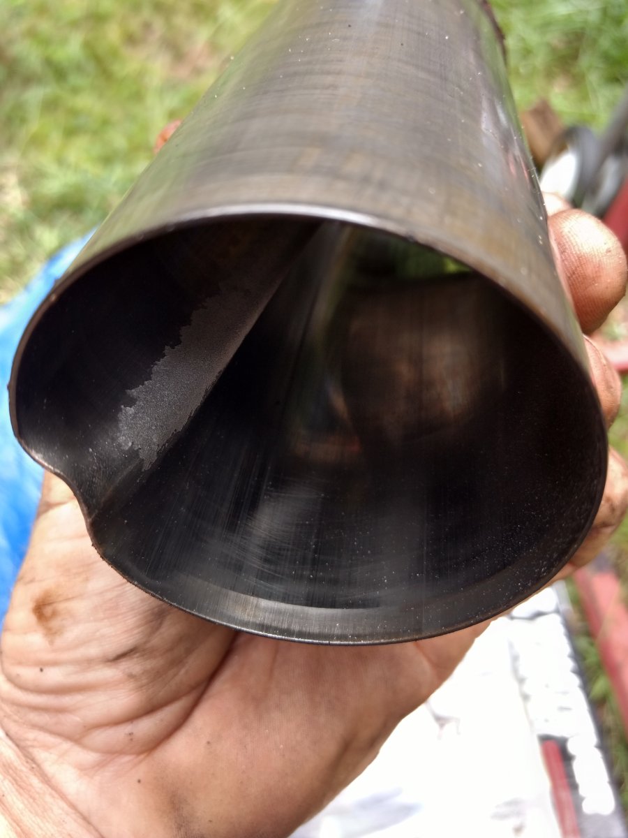

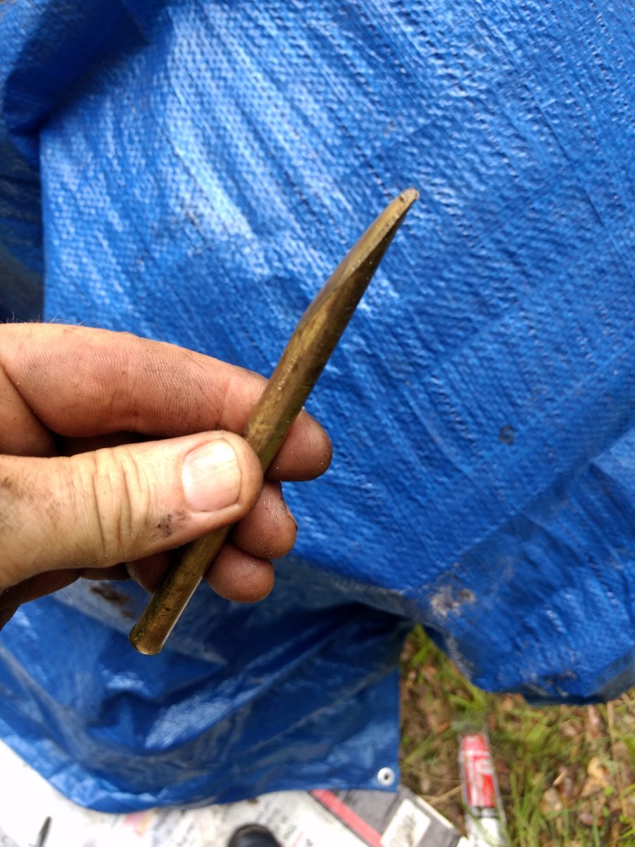

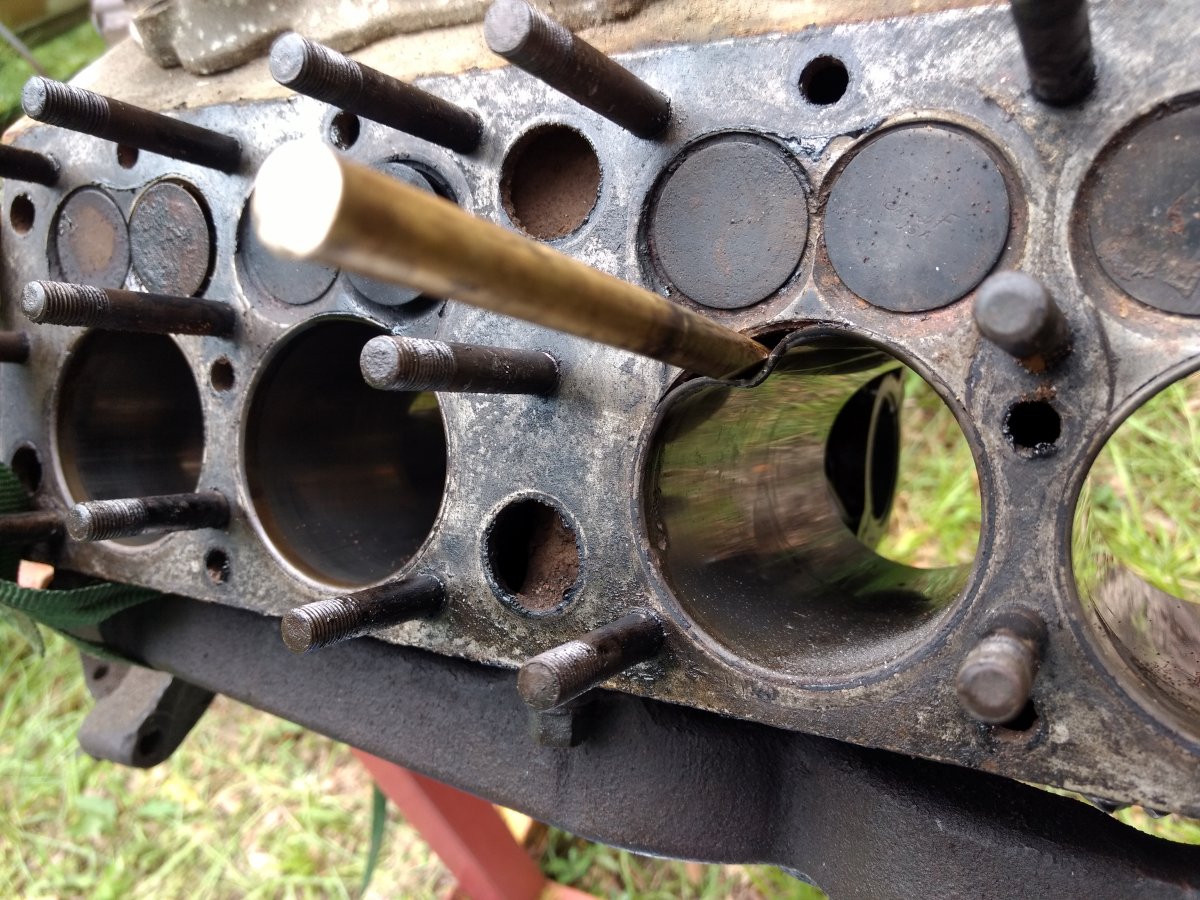

    I've done outside rebuilds before, just not on a flathead. You can keep things clean with a little foresight and effort, especially in a limited job like this is. As long as I don't introduce any comtamination, I don't think I'll harm the value of it.
    I removed the three liners I'm replacing. Made a little drift from bronze so I wouldn't scar up my cylinder walls. It was really pretty easy. drove the drift though and then drove them out from the bottom with a section of copper pipe, again to protect the cylinders. I was worried that that worst pitting had penetrated past the sleeve into the cast iron, but I got lucky and all three bores are clean. I'm including a picture that shows the bit of cross-hatching still visible in the liners. I'm thinking this is a pretty low mileage engine. Haven't seen any signs that anyone has been into it before me.
