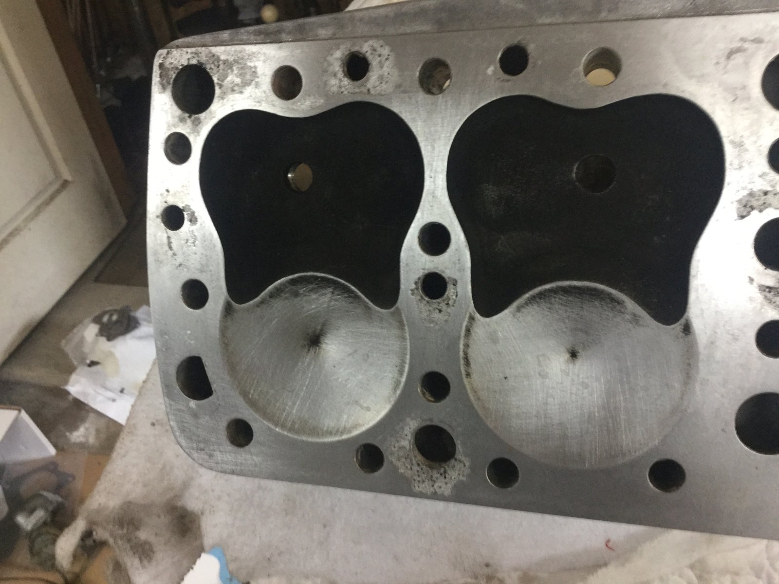

    All the normal mods will give more power.
    The one must,,, is to be certain that the heads fit as close as possible ( .050 - .048 )
    Best way to measure clearance using little balls of tin foil to cleck clearance.
    Done right, one gets max lower end torque.

    I was actually only checking for enough clearance in the past. So is the 400jr still the right choice? or can I do better?

    In my opinion, ANY lift above 370-380 may cause interference with the spark plug and exhaust valve especially if the “hook” on the plug extends too deep in2 the chamber. Try and find a plug that fills or nearly fills all the threads in the head with minimal “hook” extending in2 the chamber. Newer heads are generally better than used heads because used heads MAY have been “cut” to maintain their straightnes(perfectly flat”) and could cause a problem regarding spark plug selection. Yes, the Isky 400 jr is a gr8 cam but could be troublesome because of the .400 lift. Also, be aware there is not 3-4-5 h.p. Difference between the more expensive finned aluminum heads and Henry cast iron. Yes, I prefer the alum heads because of looks and they are lighter than cast iron. If u choose aluminum heads, make sure u go to a boat shop and purchase a sacrificial anode that will minimize the corrosion(electrolosis of aluminum) when placed in the water supply system of your flathead. If not used, your heads will suffer extensive corrosion within five years. The anodes can be cut down and holes drilled in them with a 12-14 gauge wire to retrieve them from the water supply to s****e off the(barnacles) offensive corrosion and return to their place. IMG_2200.jpeg IMG_0272.jpeg IMG_1943.jpeg IMG_1901.jpeg IMG_1759.jpeg IMG_1621.jpeg IMG_1608.jpeg IMG_1609.jpeg IMG_1611.jpeg IMG_1493.jpeg IMG_0848.jpeg IMG_0723.jpeg IMG_0648.jpeg
