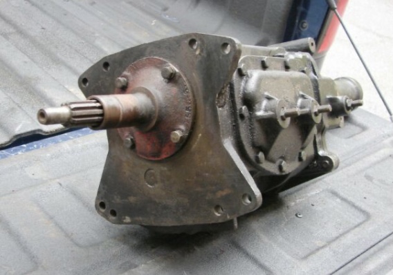

    That red transmission that you posted above with the integral mounting plate... Will that somehow bolt to an 8BA?
    EDIT: I think I just answered my own question. That red ****** will bolt up to an 8BA if I use the truck bellhousing...the one that looks like just a big ring... Correct?

    If I understand your post you believe the transmission with the integral bell housing as shown below is a T-85. AF6AFF65-EF10-498D-8EDA-70D03D574D45.jpeg
    That transmission was used in Mercury’s from ‘49 - early ‘51 and while I do not know what designation that trans had I do know it is not a T-85 and the OD it uses is the lighter duty R10. Ford and Merc R10 OD transmissions used a side cover that was rectangular.

    Ok, got it now. Thanks for getting me straightened out. I have a line on the Merc version (the red one above) which I think will actually work just fine for what I'm doing. The R10 doesn't bother me since it would be going behind a mildly built flathead in a really light car. The Merc ****** is more period correct too...

    I believe the Lincolns from ‘49/‘50 used the T-85/R11 trans with the “large flat plate” case, looks like the Merc unit pictured but is the desirable heavier duty unit. I MIGHT be mistaken about that, but I think what I said is correct.
    So, if you were told the original unit you spoke of in your first post was a T-85, you may want to double check before you dismiss it. As stated in a prior post, the quick ‘tell’ is the side cover with the bottom side curved.
