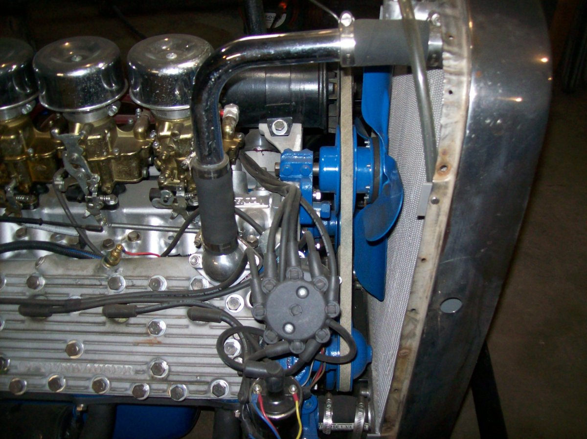

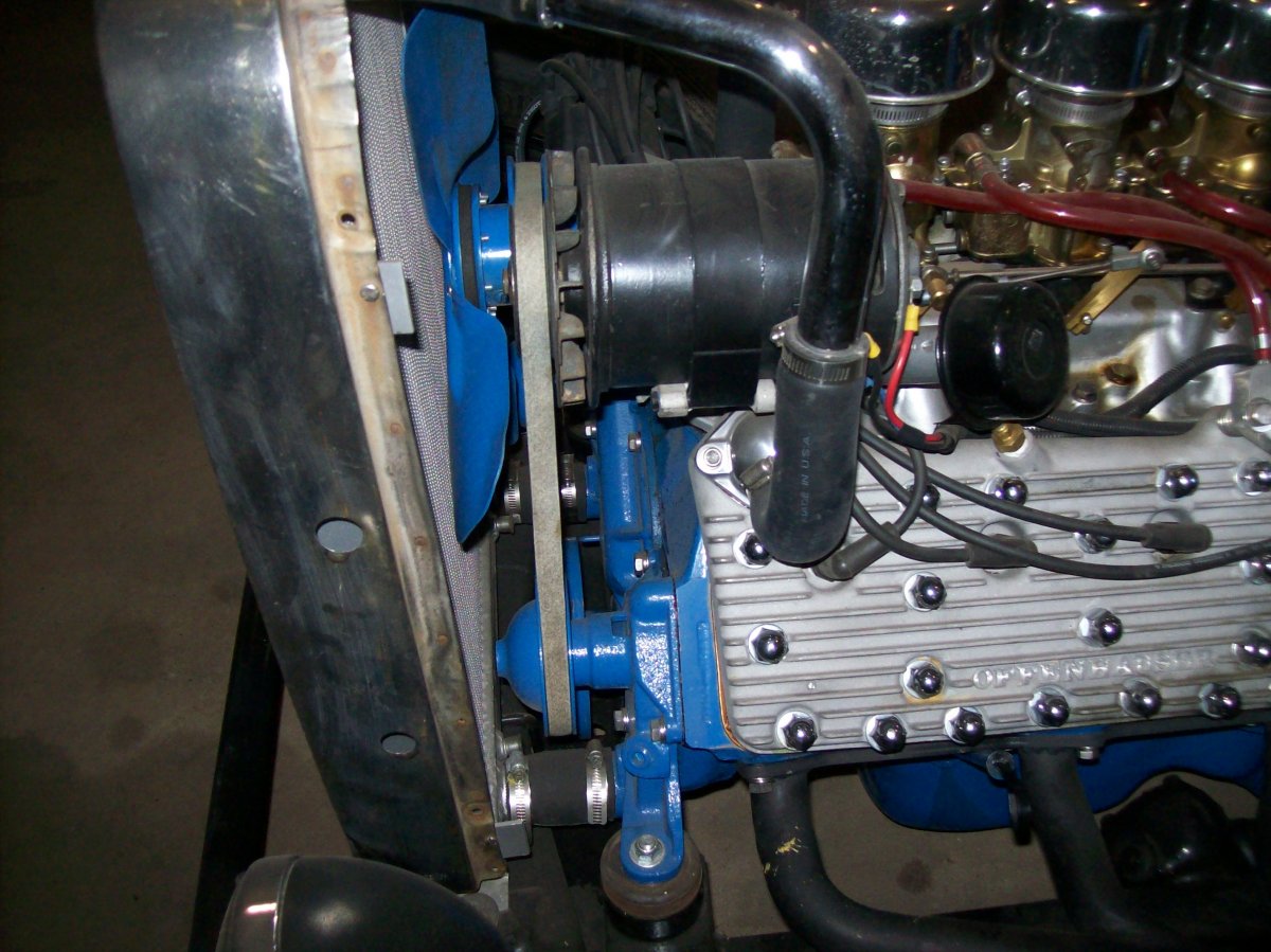

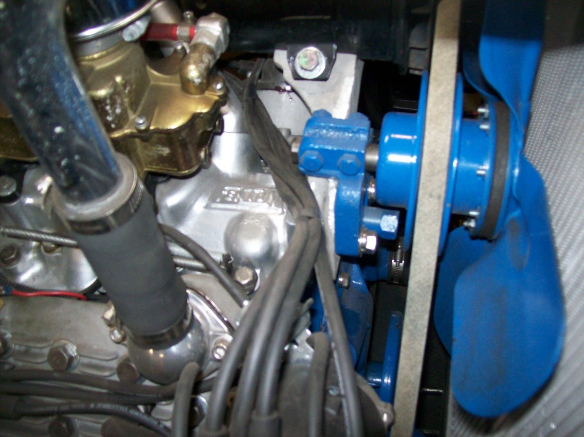

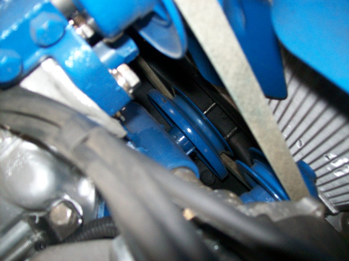

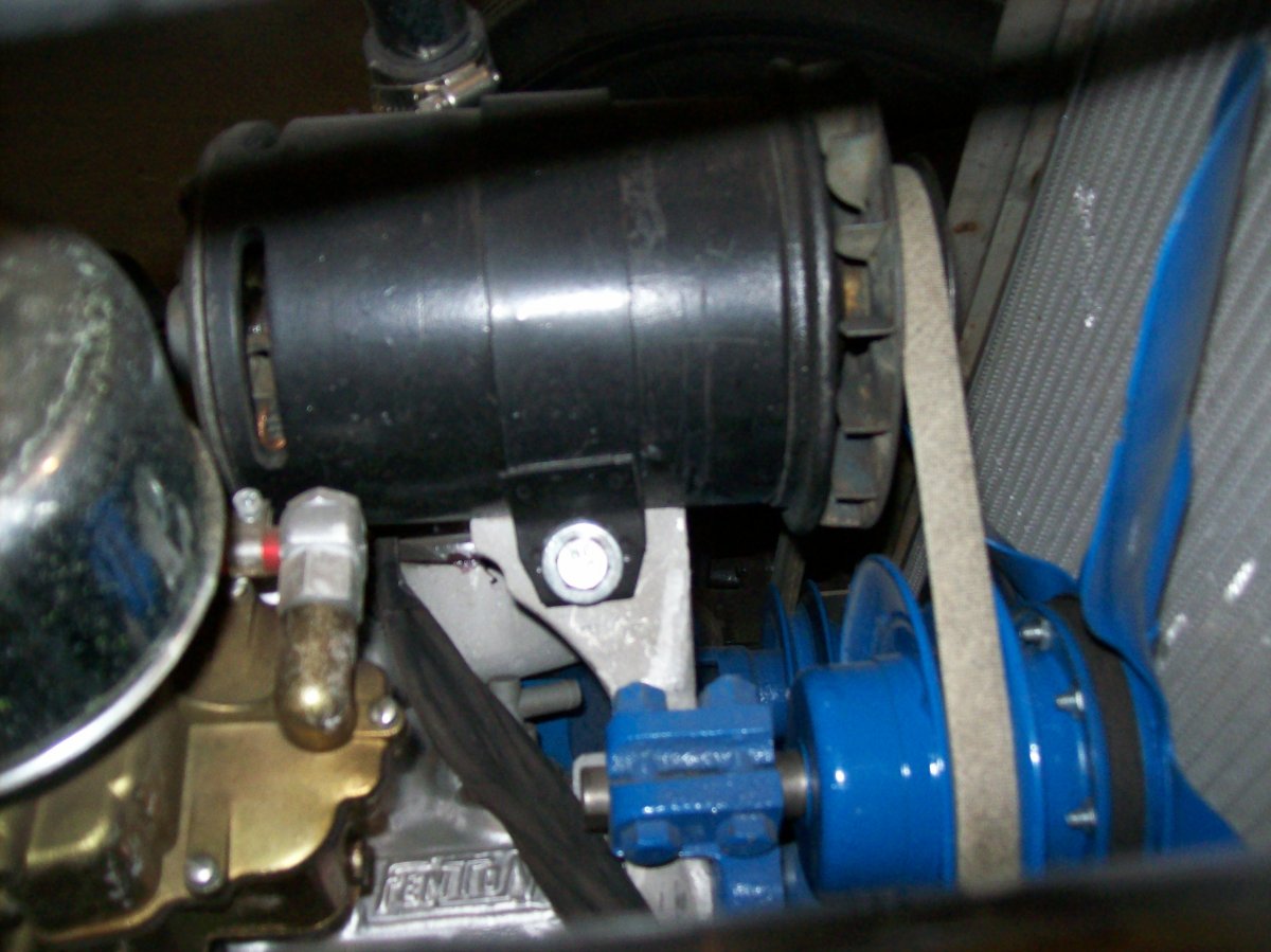

    Not sure if these pics will help (if I get them to post) but this is what I did on my 8BA. Cut the front pulley off and reverse the fan shaft bracket (a little grinding required) and it all fell together. 102_0085.JPG 102_0086.JPG 102_0084.JPG 102_0086.JPG 102_0084.JPG

    Great photos and a neat install. Do you have a shot of the alternator mount? It would help to envision the complete set up. Thanks

    The generator is stock converted to 12 volt and on an offset mounting bracket. Nothing fancy there.

    Thanks for posting the pics. I’m going to have to wait until I mock up the parts. I like what you’ve done and will try to do something similar.

    Very nice solution. Clean and simple.

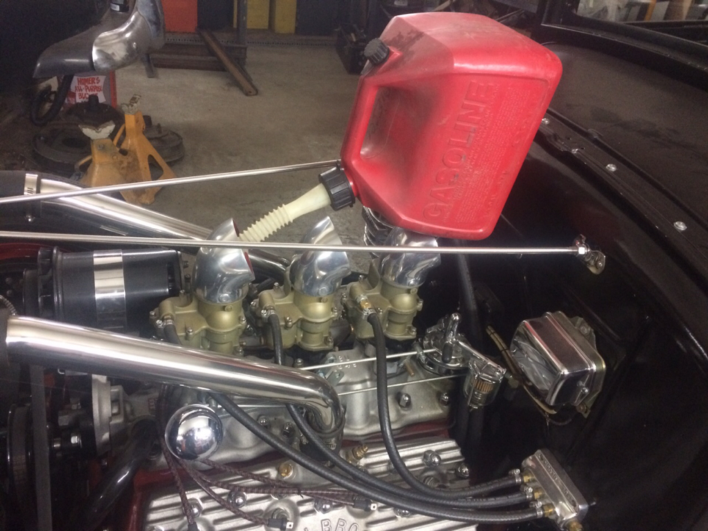

    0914160726.jpg The offset gen bracket like Tractor's & T's should work.There's another style that mounts on the head using the head bolts for an early motor. You would need to use spacers and longer head bolts to clear the water outlet.

    I don’t see an issue, Edelbrock with three chandler groves, offset( to right) gen bracket. Fan bolts in stock location.
    Oh, and just ignore the redneck fuel induction system.

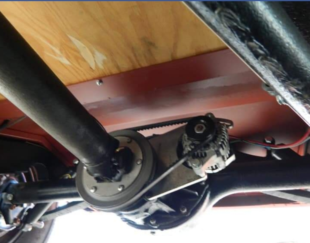

  15. Good idea, but use an old starter-generator from a International Cub Loboy and you would have the best of both worlds!!

    That is slick! Is that in a model A? If so, did it save you from having to notch the firewall? I'd love more photos of your whole engine install. Perhaps by PM as note to hi-jack this post.
    Thanks,
    Carl

    Just am FYI...that's not my car, just one I saw for sale around here
    This is the rest of that car
