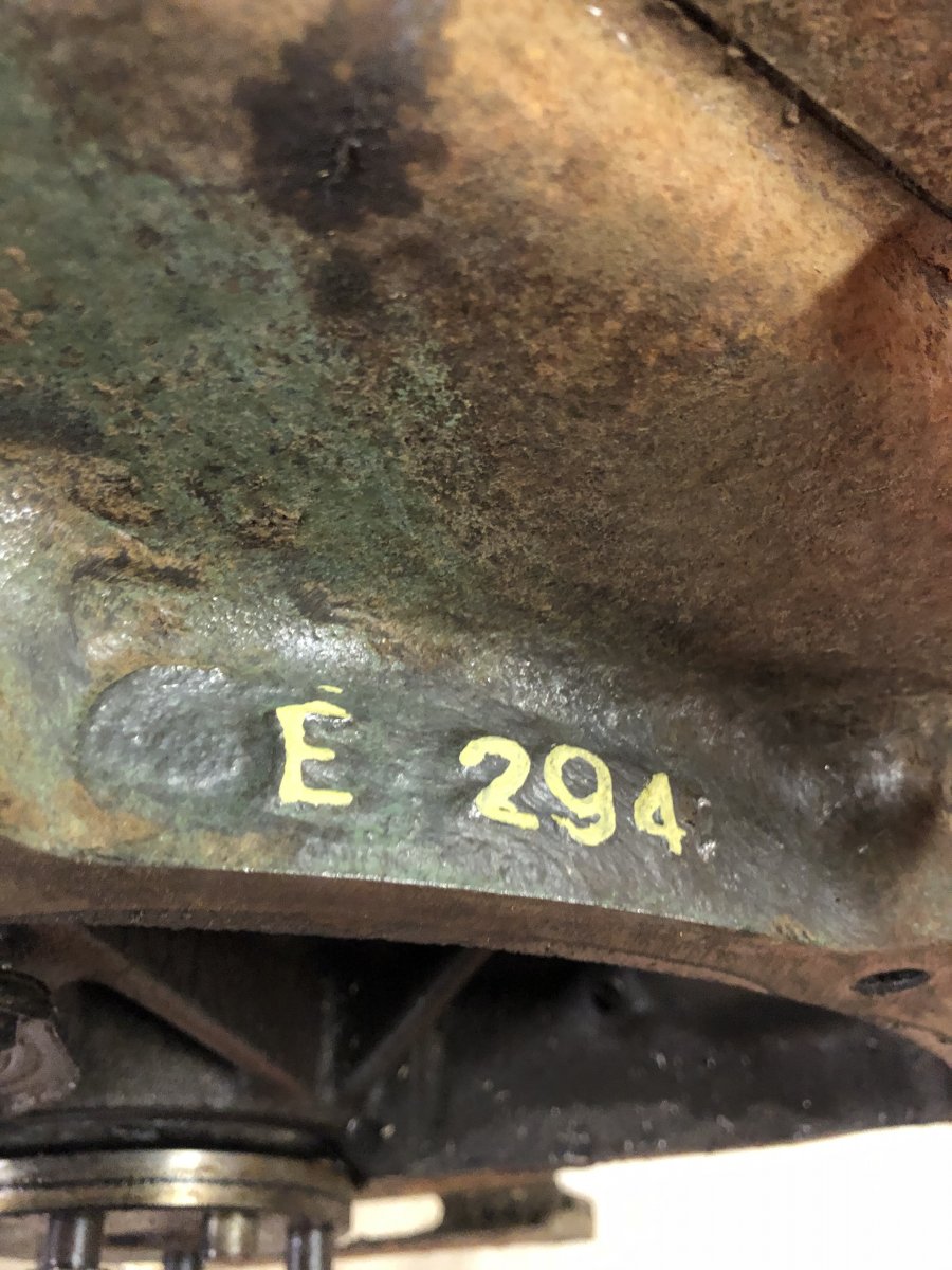

  14. Yeah I have been to Vanpelts site already,,,,,a lot of cool knowledge on there.
    I need all the help I can get,,,.

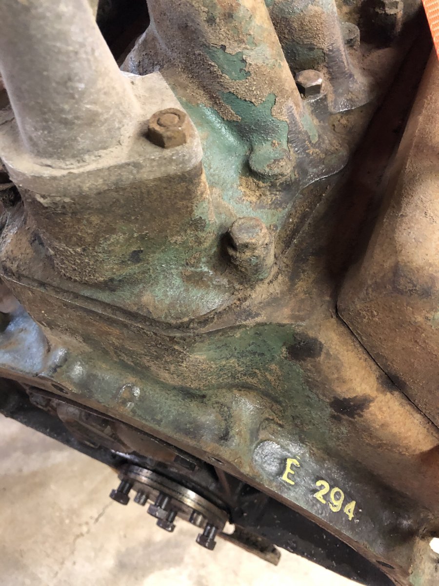

    It is supposed to be a 49 engine.
    The casting # on the back of the block is E 294 .
    The heads have D149 and D4 9 on them,,,with 8CM,,,,and Mercury below that.

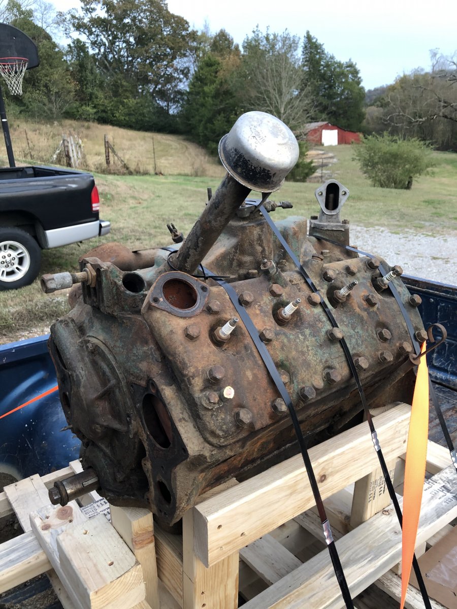

  18. The engine still has some green paint on it.
    Part of the intake,,,,,most of the timing cover,,,,about half of each head.
    A strip of paint a few inches wide on the sides of the block,,,and a strip of paint on the rear area,,bell housing area.
    It is kind of a faded green,,,not dark,,,almost like a light green cast.
    The rest of the engine is rusty and dirty,,lol.
    Although,,after 70 years,,, I can’t believe it still has any paint left.

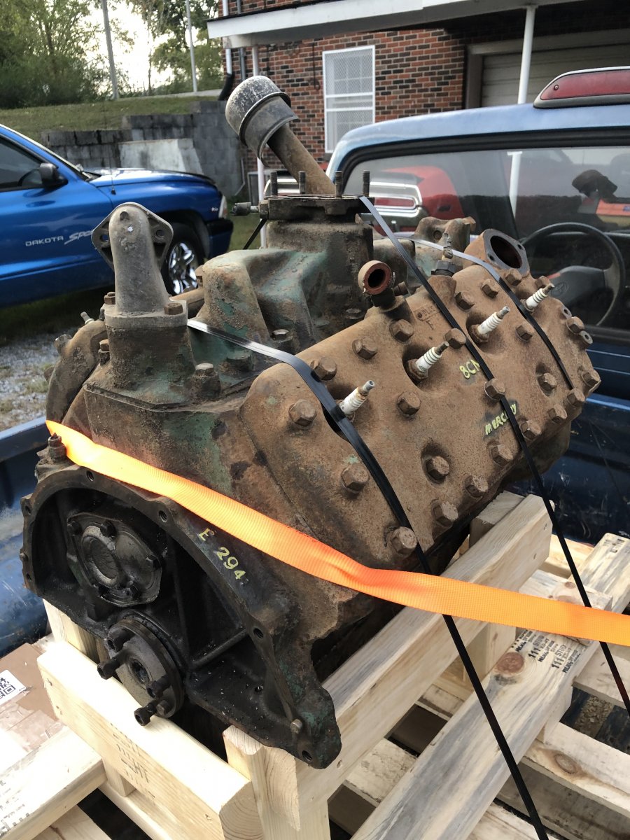

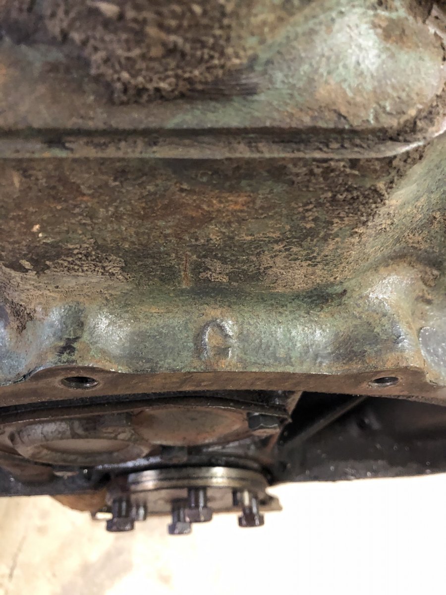

  24. 6FAA77A7-C599-482A-B1F3-2267B3595406.jpeg 9784AEB0-A3AD-4820-8EEF-CC4C3BC08D69.jpeg 12AE73D6-6C13-4814-B39D-8346EE3C6093.jpeg Just got my Flathead this evening,,,took a few pics before unloading.
    I will begin the dis***embly tomorrow after work.
    Send all the luck my way in hopes of a good block.
    It turns over effortlessly,,,smooth as silk.
    I will take plenty of pics and post as it goes along.
    Tommy

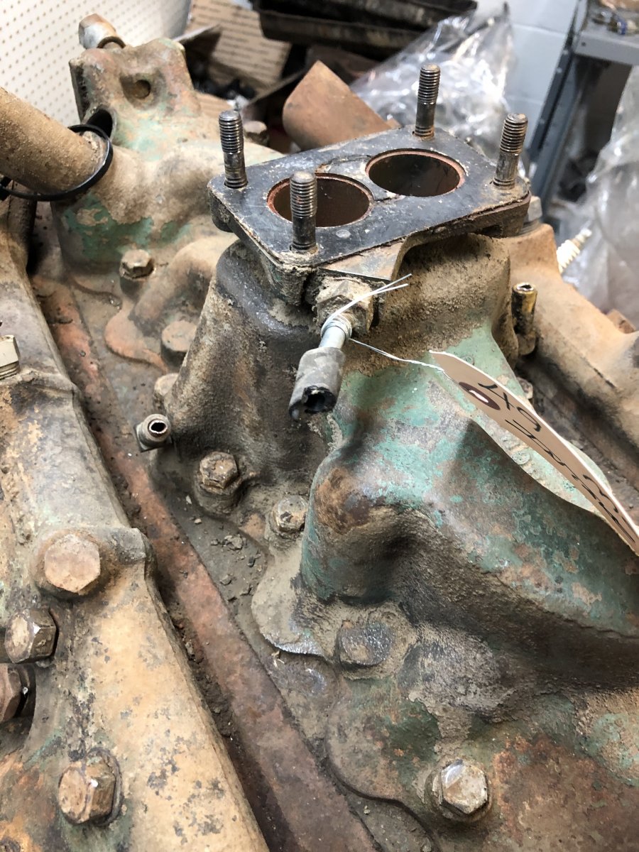

    The four-bolt manifold, the 8CM heads, and the remnants of green paint on the engine are all real good signs. Over the years, I have found that truck engines and Mercury's are more likely to be un-cracked than most 8BA's. It may have to do with larger radiators on them, or maybe better maintenance when they were getting "long in the tooth". Or maybe it's just plain old chance.
  27. tubman
    Joined: May 16, 2007
    Posts: 8,677
    tubman
    Oh yeah. And keep the Mercury manifold if you are going with multiple carbs. They can be bored out and a small base 2GC will bolt right up. From my experience, that combination makes for the best street induction system for a flathead (in cars with hoods:D).

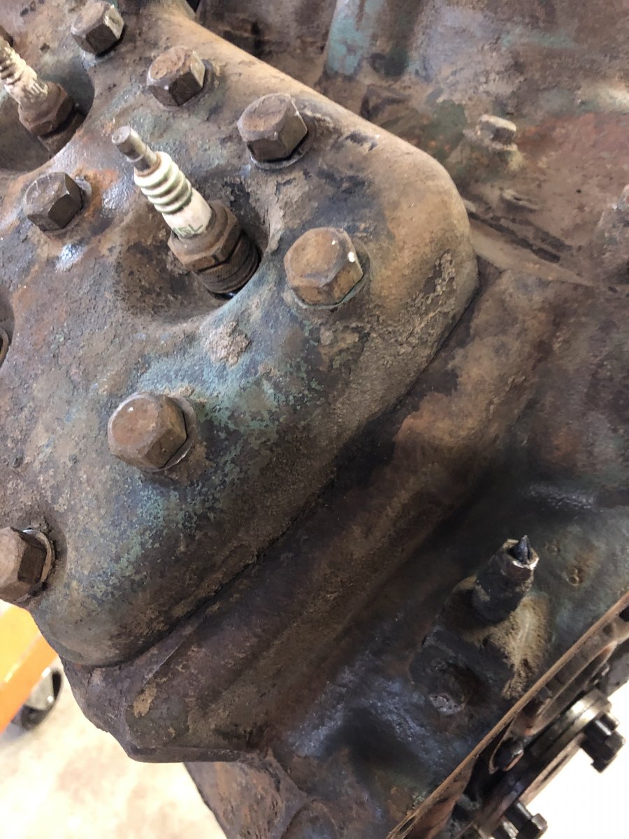

  29. B7EE5A61-2F6C-46AC-BC5C-A2E3C80C6964.jpeg 17F7D502-17C7-4567-A2E9-87ADCDF8A94F.jpeg 8C5890A6-C3EB-4C8D-8A83-95587F8857AB.jpeg C795988C-584C-4627-8E87-A5BB1F03E40D.jpeg BC74FE60-1E35-4AE3-823C-DD613A84AF07.jpeg 6F1FA758-25F7-4DB5-A319-54F24E9DA846.jpeg CE76BFB9-6AC0-4F51-B4E1-313F4090C86F.jpeg 19ECA320-987A-4746-AF3A-45278EB41466.jpeg Here are some pics from tonight.
    I took some pics of the outside and rear bell area,,,it seemed to be reasonably good,,,and looks like it had just been pulled from the car,,,that was one of the reasons I bought it.
    I removed the intake and the heads,,,I will try to narrate as I go.
    I might be wrong but the intake looked like it had never been off before

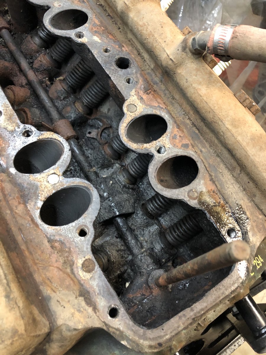

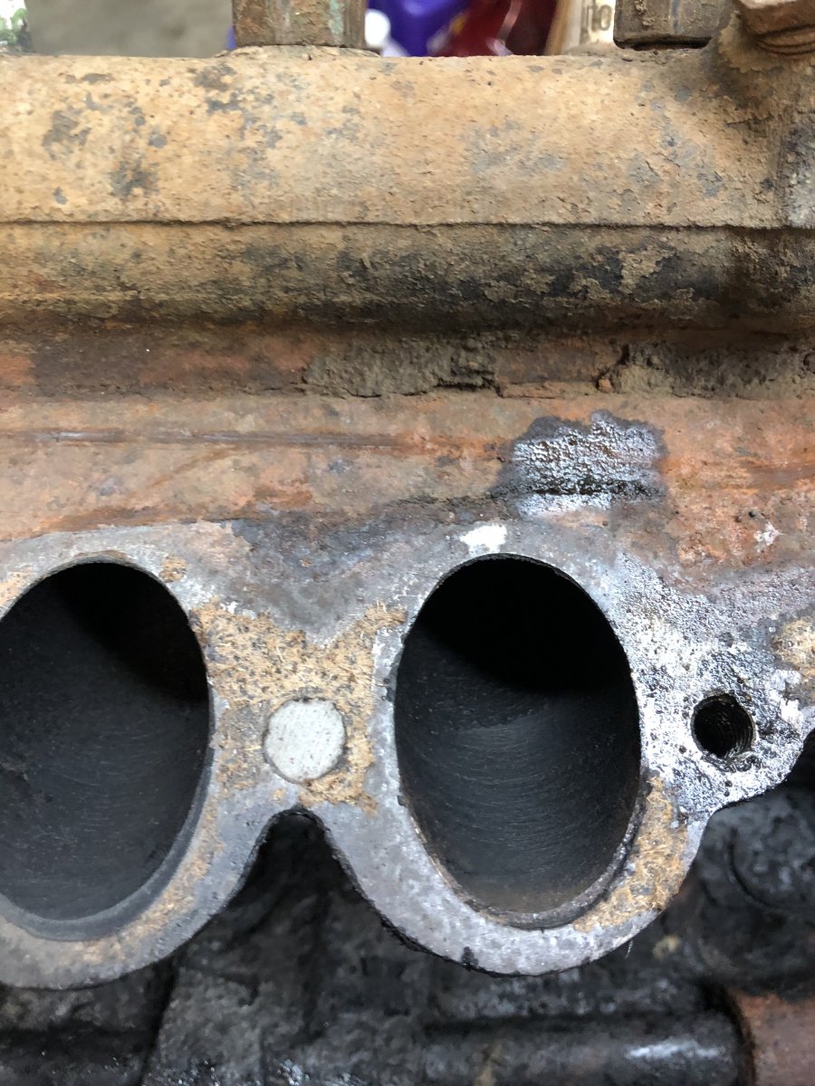

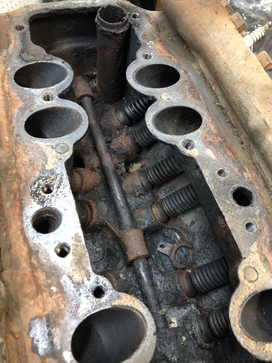

  30. E4E6A84F-E023-4FA1-9F5E-29CAA5AA9C6A.jpeg 159D21C9-7B71-41A8-B3FD-BFEB1601249A.jpeg FDC80217-9938-4419-BE9C-0BC6FDD3AF84.jpeg C7BFB31A-252D-4996-9466-816F29C75E97.jpeg 482F1FED-B9FD-4B0A-8110-382A68521241.jpeg 4088F2B3-8E3D-48E8-9B7C-EC910C74B185.jpeg The lifter valley looked really good.
    It had a rats nest of old cotton fibers in there,,,,looks like they had got in around the fuel pump opening.
    I shop vacuum,,,and got the junk out.
    Other than that ,,it looked very good.
    I found a horse shoe clip loose in there.
    It came from number 1 exhaust guide,,,so it had a dead cylinder there.
    The intake ports all looked awesome,,,had carbon in them,,,no rust.
