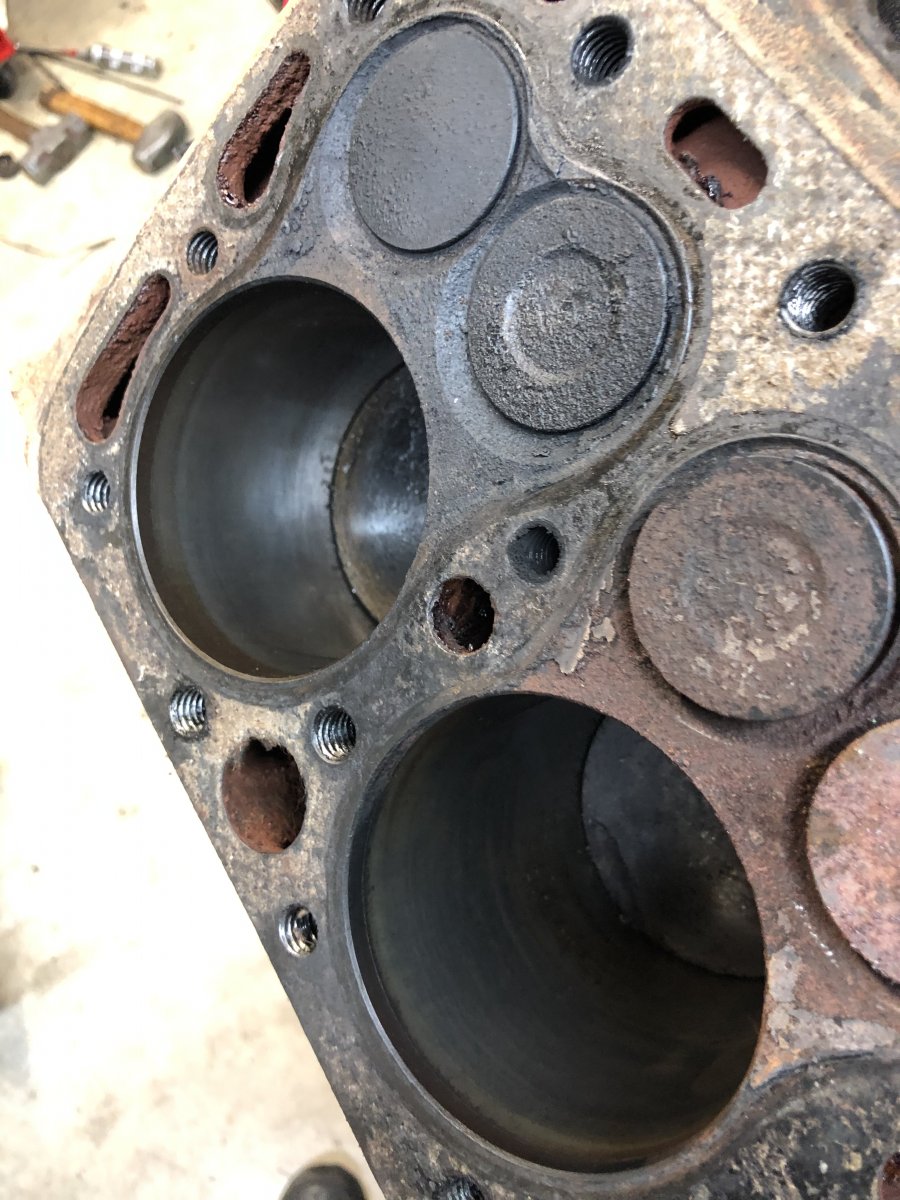

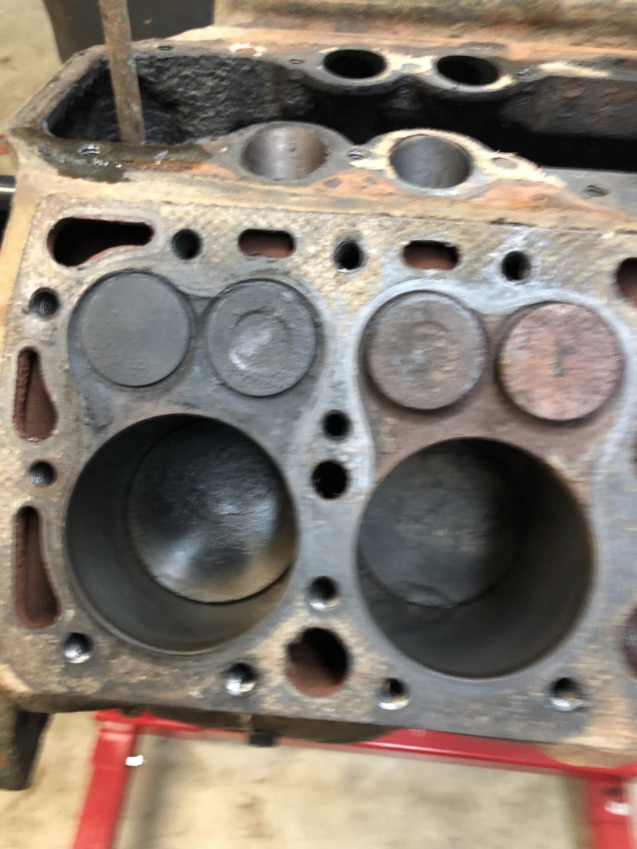

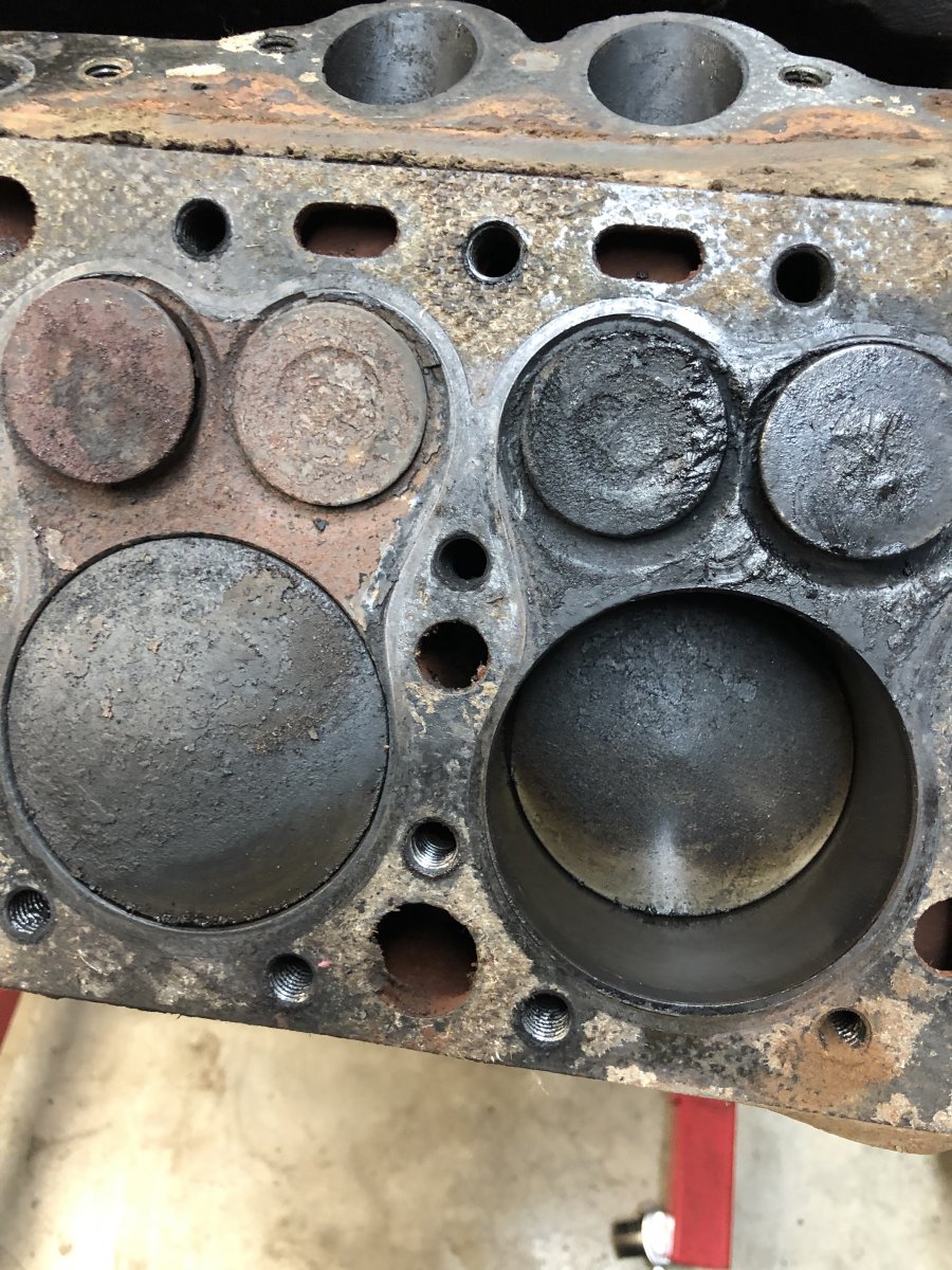

  1. B5261545-9723-4092-8FA8-8406ADF47D3F.jpeg B9772FA2-6103-4FBE-A969-3A968F65AEC5.jpeg 6DD88594-33B3-4BDC-8A6E-A60130065A6F.jpeg 43941179-EEFA-404B-AB0F-B3D25F488ED3.jpeg 2483F40D-71D1-4037-99BF-E20F5C159667.jpeg 97EF19C6-1788-4BDB-954A-CA7A0B41713A.jpeg 24A74D81-277C-4F84-AD7B-EA7185041C2C.jpeg 59D05079-62BA-49DB-B23E-48FD8D303C58.jpeg 276CA191-40BA-4A96-9678-AECF12BAA1A1.jpeg Then I pulled the p*** side head.

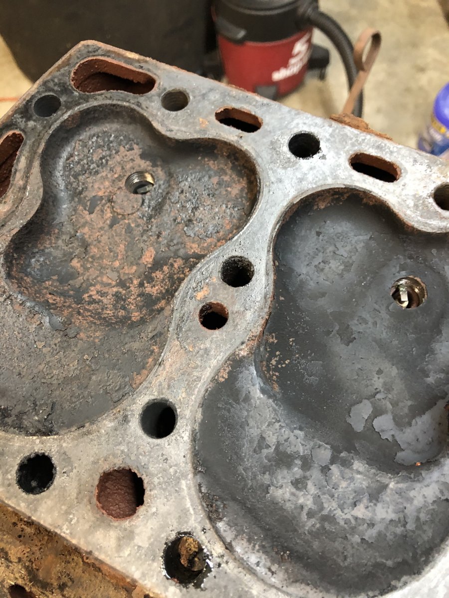

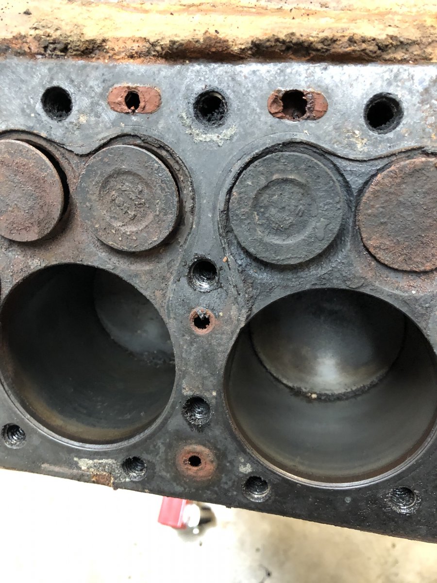

    The bores are sweet,,,I can’t believe how good they look.
    They all have a ridge at the top,,,but no rust,,,,very nice.

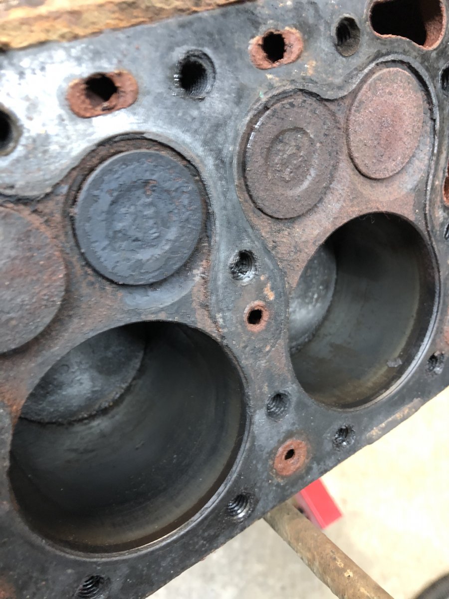

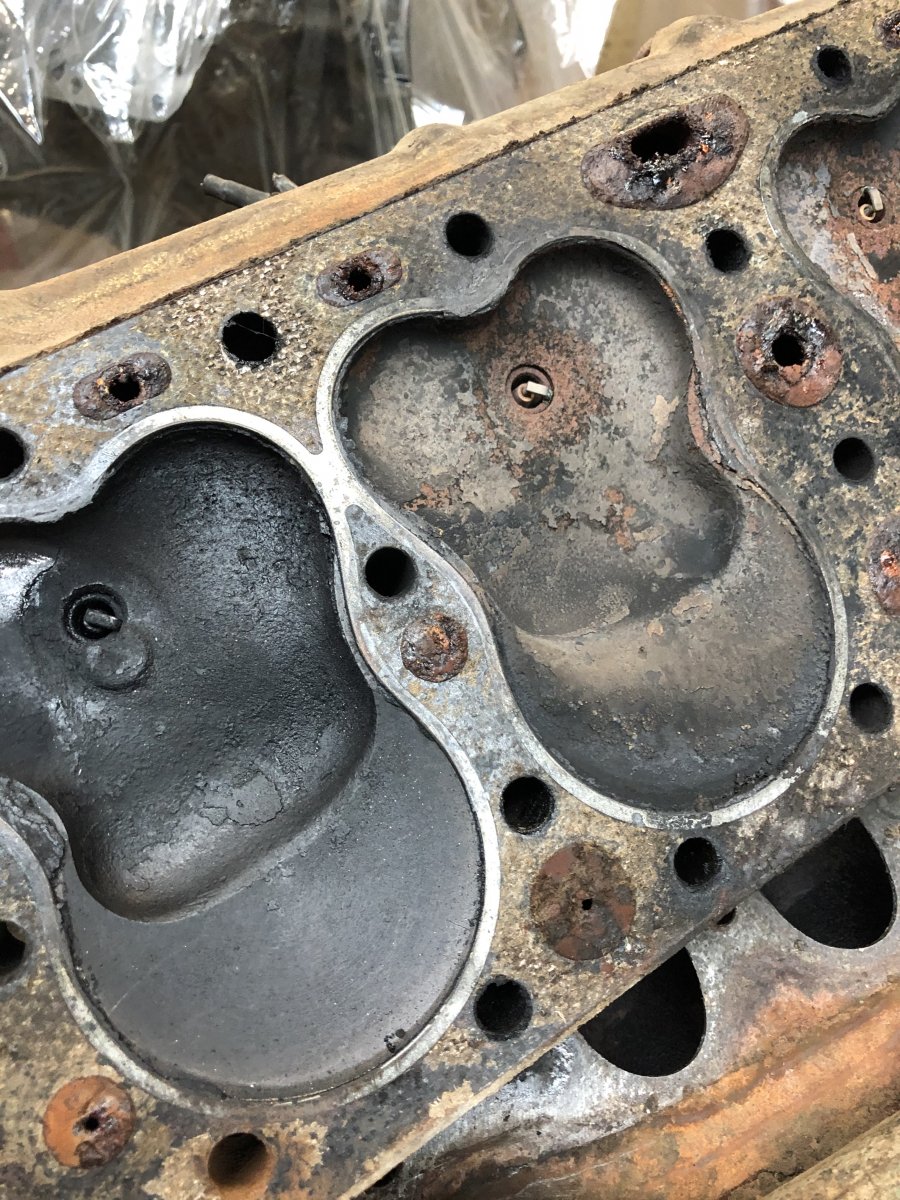

  2. 68AD3C35-7A5C-4A19-ACD7-97BBF84D7995.jpeg 042CE998-60A6-4F26-92CC-20A85FD553E4.jpeg 6C03359B-4C7A-42C8-A5BD-ABAAE5C77496.jpeg CEC33846-FE4C-40A5-8F34-34988A2F10CC.jpeg 57C02B5C-0ECC-42CA-81F9-3346F49429CA.jpeg 6FA4559B-9944-4CD1-8AB0-36608864CF58.jpeg Then the left bank,,,,they looked great as well.
    The same ridge,,,but no rust at all.
    I took pics of all the bores and the chambers of the heads as well.

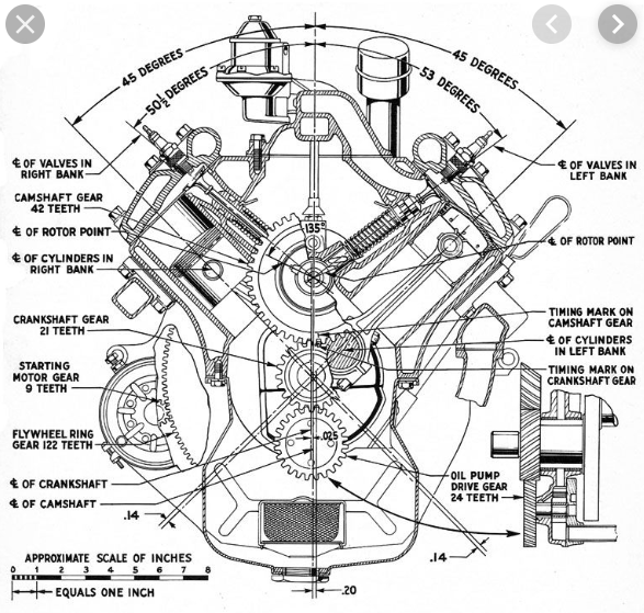

    I really like the schematics,,,those are very useful ,and will come in handy.

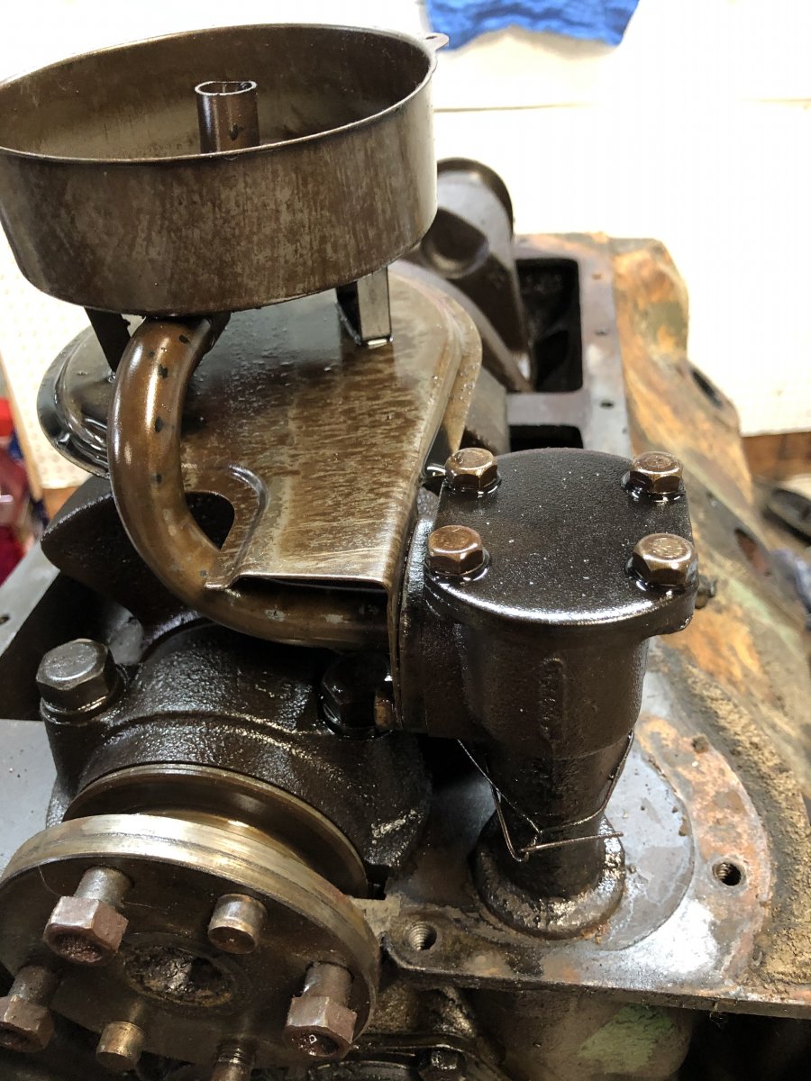

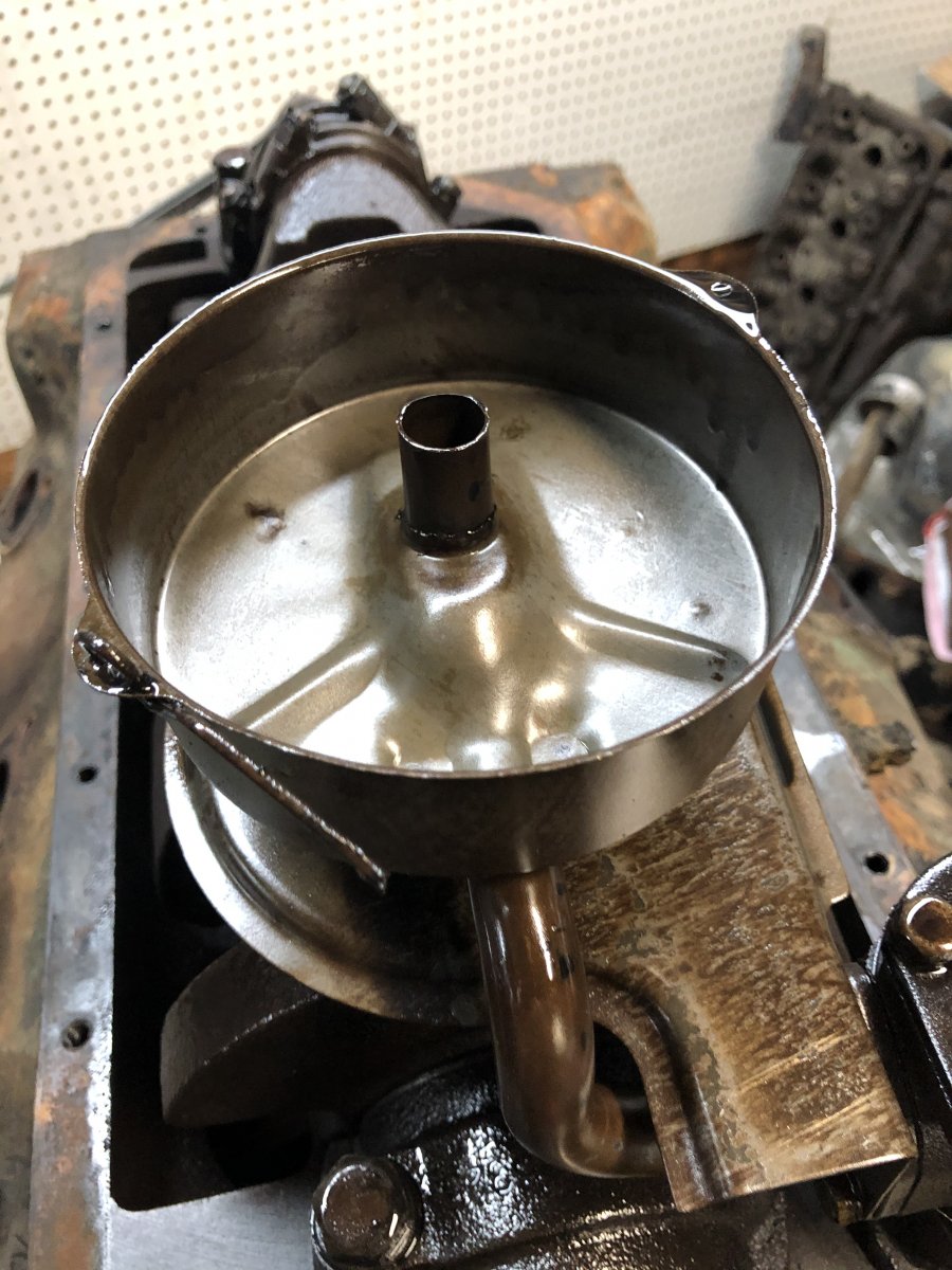

  14. 6E5BE6E1-2561-4392-BDC8-3CE0E4DEC699.jpeg 67C7C14B-A05E-45AC-8178-BBC15D9C3A7F.jpeg Okay,
    I got home today and went back to work on the Flathead.
    Removed the oil pan,,,,that is one more robust pan,,,,it must hold a lot of oil?
    It has a nice baffle in it,,,I ***ume it handles the oil sloshing okay.
    When I got it off,,,I noticed something unusual in the bottom.
    The screen for the oil pick up was loose and had moved around away from the pickup.
    Then I got worried about the condition of the bearings,,,and if the crank was hurt.
    Here are some pics of the pan.
    You will notice the screen in the bottom.
    Tommy

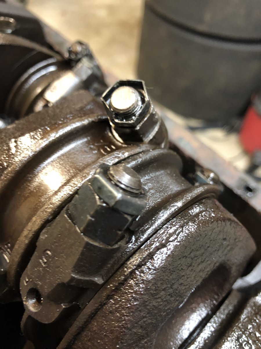

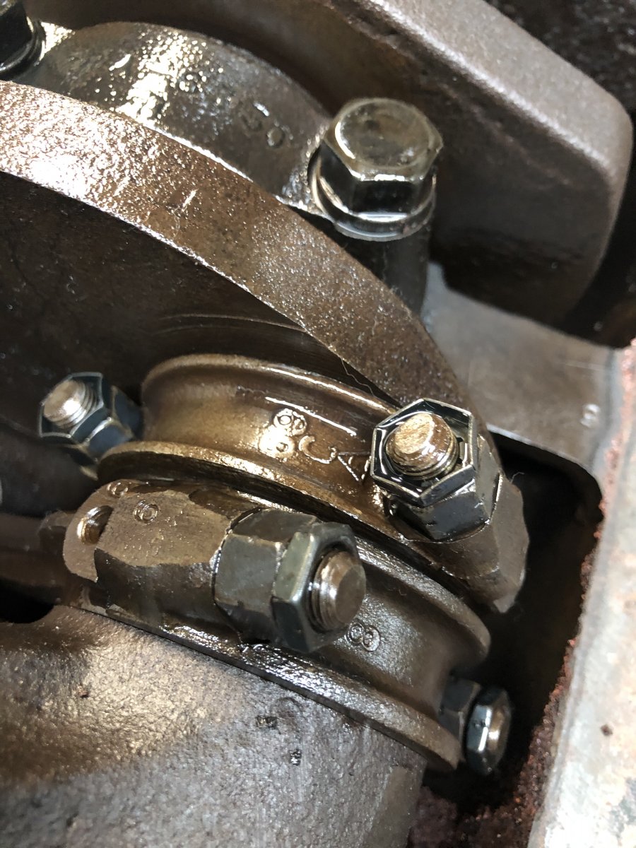

  15. 4C765153-8E80-45A8-8F32-612E6CD40E6B.jpeg 035471A1-06BA-40DD-AA4E-0BE79C5203E1.jpeg 02AC100A-9133-4648-8721-B9CD35C05837.jpeg 5D79BA5B-AE11-4FE5-A13C-8FF7757B36AF.jpeg D2DFEA96-8237-4612-95BB-B230C7032CF3.jpeg C5A3C5A2-DE5C-4187-B78D-945D64392964.jpeg I felt like I was opening a time capsule ,,,the bottom end looks like it has never been open.
    The rod bolts still have the little metal locks over the rod nuts.
    Here are some pics and also the pickup is clearly visible where the screen came off.
    It looks like the spring clip broke,,,,part of the clip is still attached.

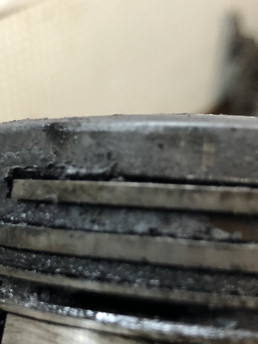

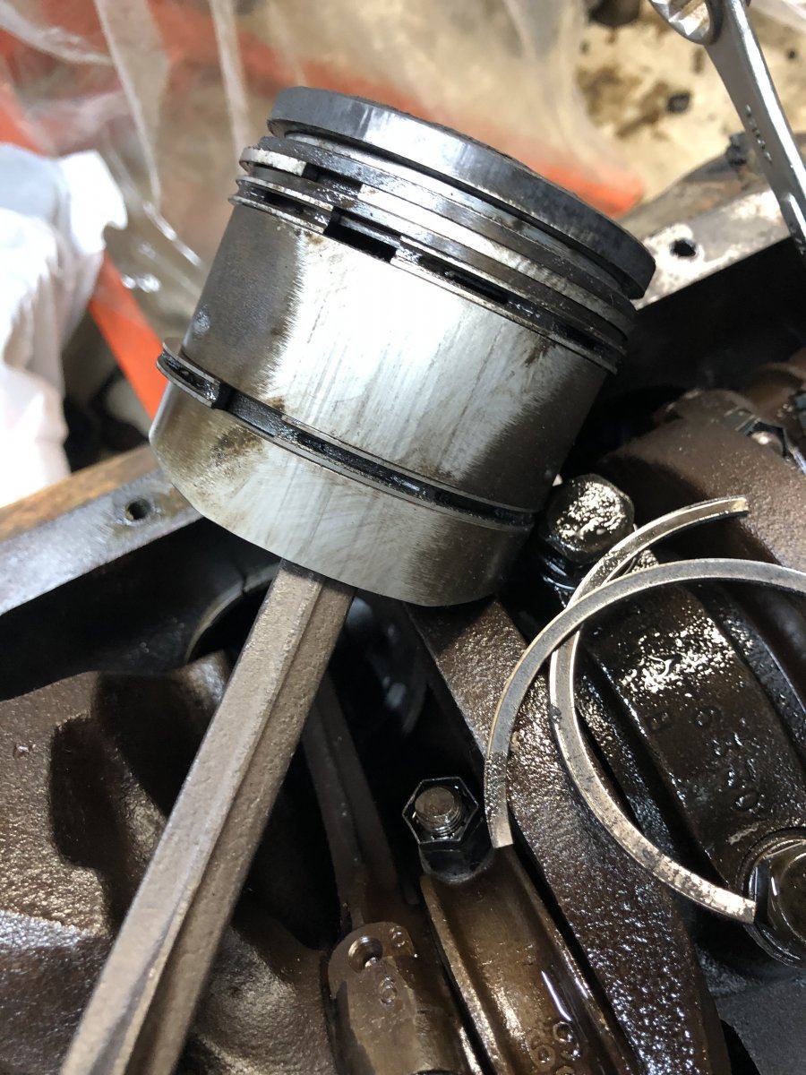

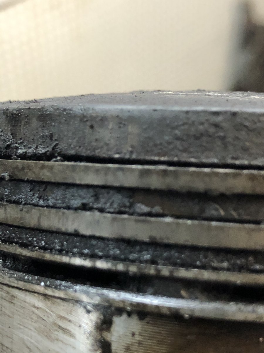

  16. 9D692ED1-6ED7-4BA9-9F9F-7945816EE761.jpeg 91CF7D59-7338-4BC5-BA17-09101F084D07.jpeg 5E4B6690-C08D-4390-9E2E-F86F1D51653E.jpeg Next,,piston removal.
    Number 1 came out,,,and really didn’t look bad at all.
    Then number 5,,,,it looked really good,,however the top ring was broken on it.
    It was obvious it had been broken for some time,,,,the ring land had a lot of wear in it.
    The rest of the pistons were typical of these,,,so no more pics of pistons.
    Also,,,number 4 had the top ring broke as well.
    With the exhaust valve in number 1 out,,,,and the broken ring on 5,,,and the broken ring on 4,,,I bet this little engine was way down on power and using a fair amount of oil.

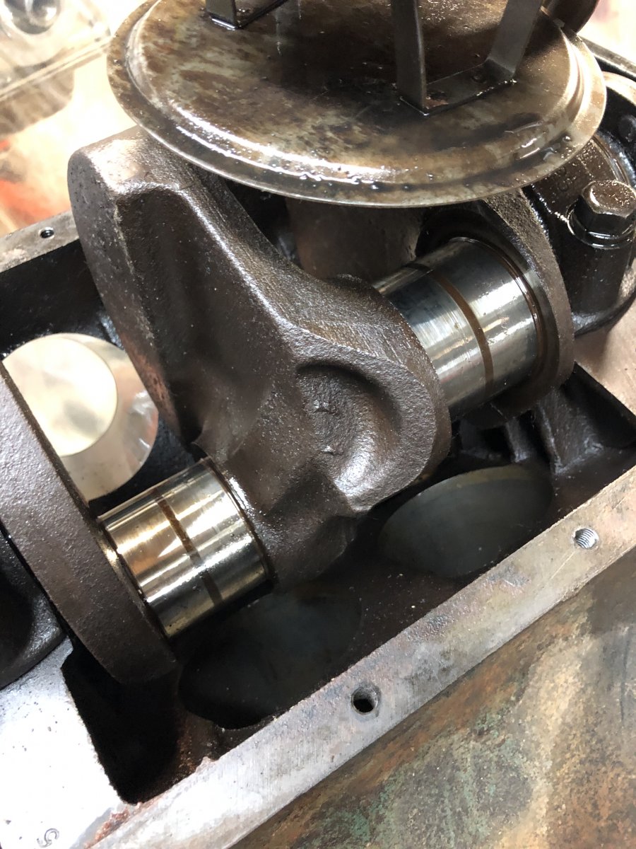

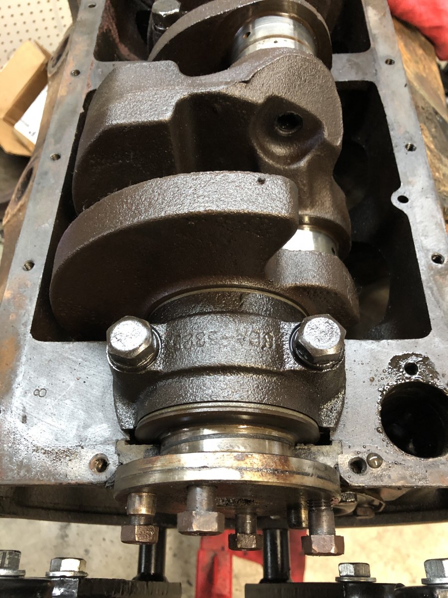

  17. 1C422FAD-F4B7-430B-8143-2A4027465E98.jpeg 0A1CB4B3-6E6D-4FCD-891B-C7A4742719E1.jpeg 960FAF67-F05B-4531-A89F-A202EBB40972.jpeg Here are pics of the rod journals.
    I am tickled with the way this looks so far.
    The crank looks great,,,,and the journals are nearly perfect.
    I don’t know what the diameter is supposed to be yet,,,I will check that soon.
    I was really worried about the crank,,,where the screen had come off,,,I wasn’t sure if it had starved for oil before .
    I plan on removing the mains tomorrow and then mic the crankshaft.
    Keep your fingers crossed for me.
    Tommy

  20. You may have noticed that the connecting rod bolts are not serviceable, they are actually forged into and part of the connecting rod. Try not to damage them as if damage occurs you will need new conrods.

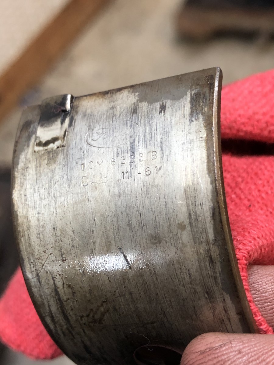

    Any dates on the back of the bearing shells?
  23. E337083D-C155-4871-9A80-B3D54022514C.jpeg F5DA3C44-4566-4224-A436-05797B00A2A4.jpeg Hi Guys,,,more coming tonight.
    Johnboy,
    I had thought about the rings as well.
    But,,,the breaks were old,,,had some old oil residue in the break gaps.
    Also,,,the top ring land on number 8 was very worn as well,,,it was probably not sealing as well as it should have. The pics show the lands on #8 piston,,,worn badly.
    Tommy

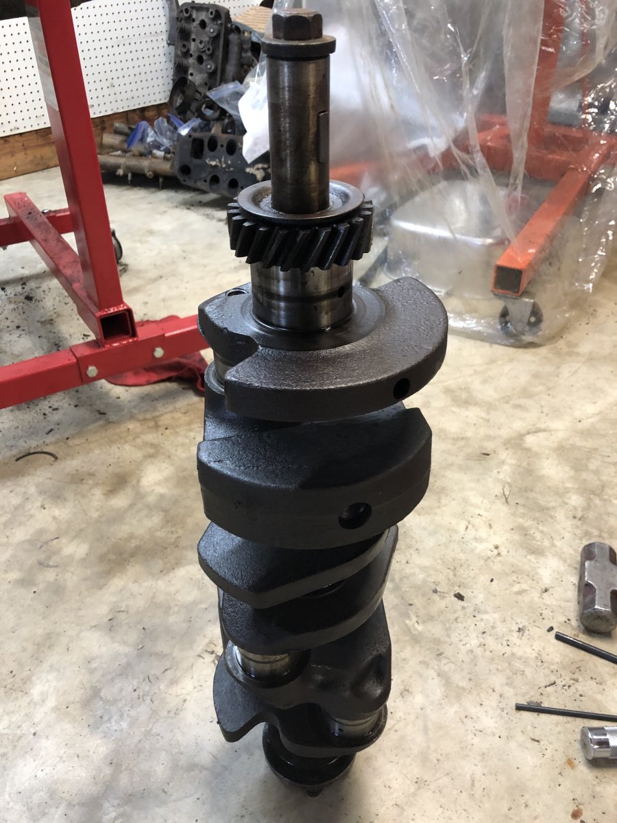

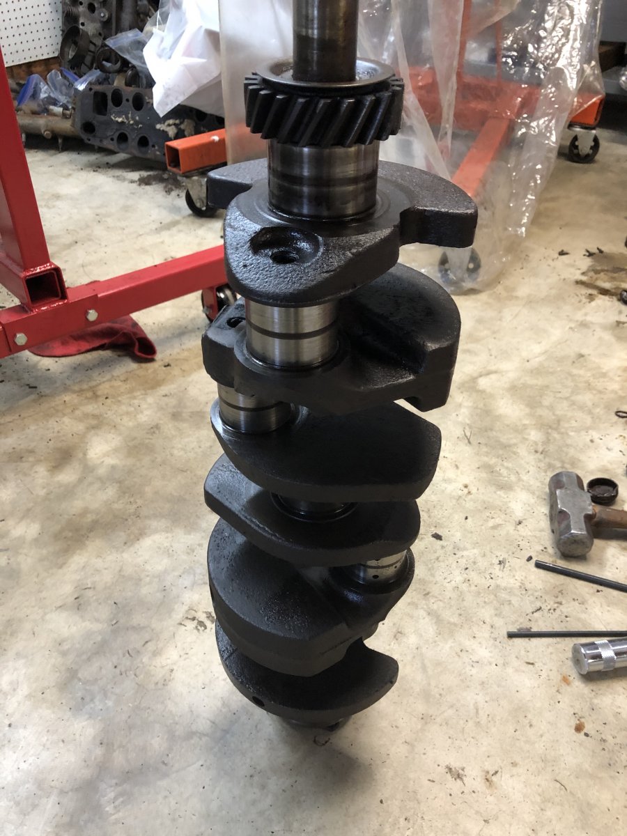

  24. 667CE7F6-7DFC-431D-A73F-AC00D7FD1775.jpeg E49EAF12-5574-4F41-9717-6D91BE1AB055.jpeg 1FD457B2-8731-4EA4-B756-C39654E95A41.jpeg F4B13830-8AE5-4F9D-A23D-4284ECECA028.jpeg 9487E437-5C21-4058-814F-82AFC58F622B.jpeg These pics are the oil pump,,,,it seems to be in fine condition
    It has a fair amount of varnish on it,,,but it is all intact,,,and turns very easily by hand.
    Also,,,some pics of the crank.
    Tommy
  25. 48309AAD-EA30-4256-BD5D-24B9AB698D43.jpeg 8BBCC50D-B270-4CED-BD4E-6AC01444E466.jpeg 7B0E1D5A-E9C0-4C69-BE92-963118E011EB.jpeg 0B86F610-ADE1-4AB1-93D2-20AE5A502F1C.jpeg 99232A41-7B9F-4E03-BFD1-FE75B472804E.jpeg CD939004-2949-4DB3-B6F4-497E66E7B81D.jpeg 6B6DDB27-07C2-4877-AD8B-6DD03708B7C9.jpeg I removed the crankshaft and these are the bearing shells.
    They really look much better than the pics represent.
  26. 834781C9-26EA-4A56-B32A-0C0FAAD3C96C.jpeg 1D3F91FA-C4F1-4F00-8787-5F70CC0AACB9.jpeg This is one sweetheart crankshaft.
    It seems to be in fantastic condition,,,worn somewhat,,,but in all,,,in fine shape.
    All of the rod journals mic’d at 2.1355,,,,all of them,,,the center between where the bearings ride mic’d at 2.138,,,dead on,,,so it has approximately 2.5 thousandths wear on the rods,,,,or there about.
    The mains are supposed to be 2.499,,,the journals all mic’d at 2.497,,,,except the rear main,,,it mic’d at 2.498. In the middle of the journal where the bearing groove does not touch,,,it mic’d dead on 2.499. About 2 wear on the mains,,I guess not too bad.
    Tommy

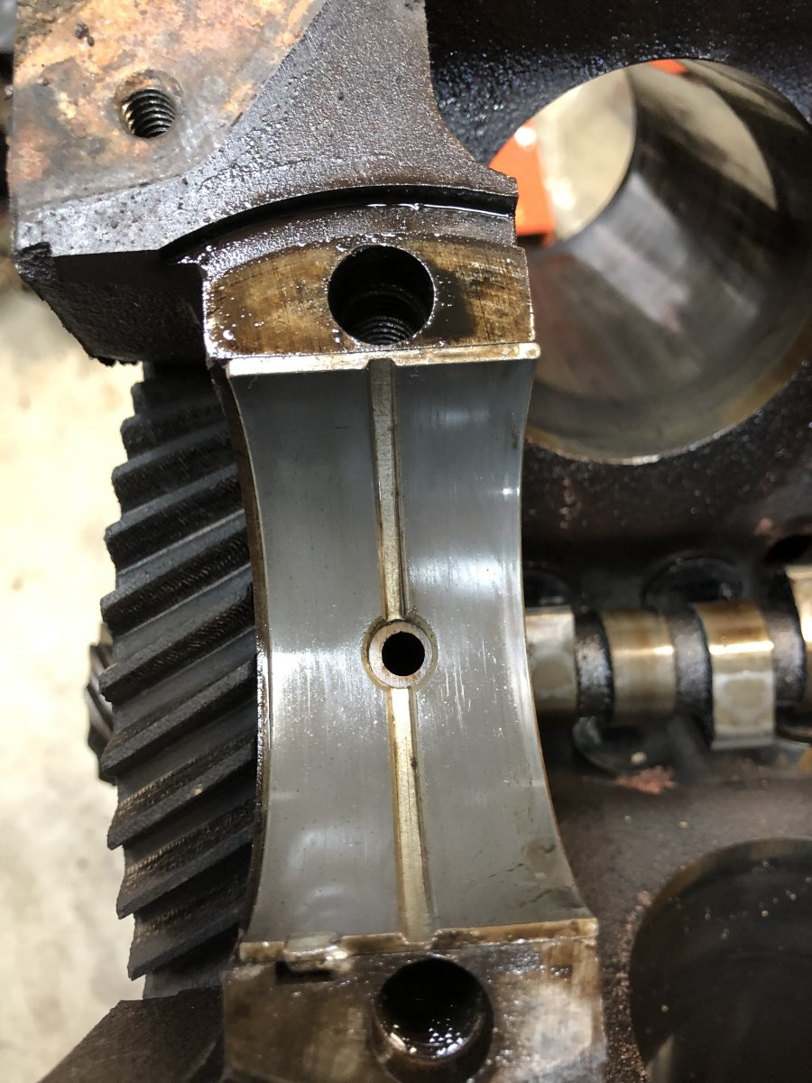

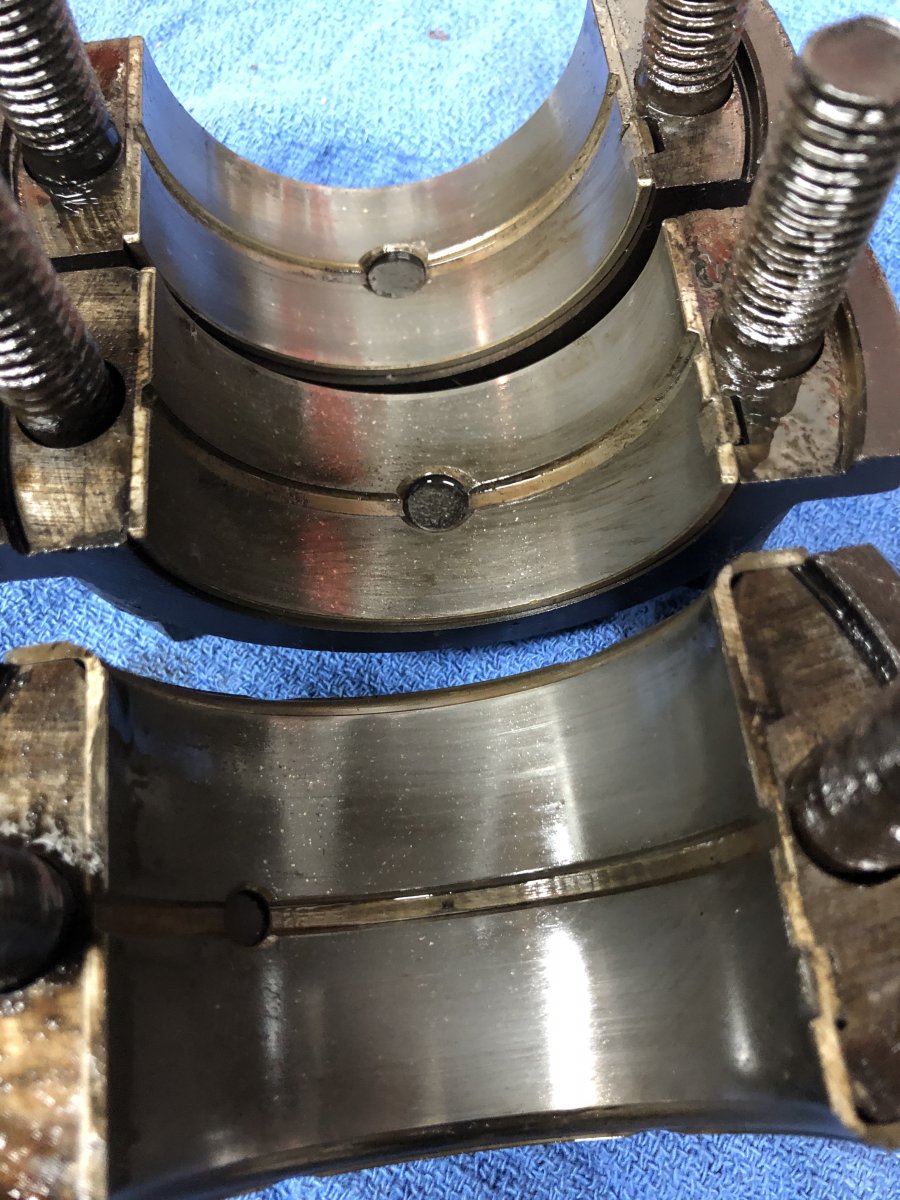

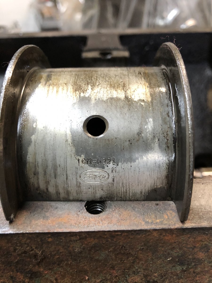

  27. Earlier Warbird asked about markings on the bearings.
    I have some pics of them.
    They all had Fomoco in old style cursive ,,,,and also marked DAB on the mains.
    I got some close ups of the markings the best I could,,,some were stamped deeper than others.The rod bearings were marked OBA.
    I have never seen the old cursive script like that.
    Tommy
    warbird1 likes this.

    Just making sure. You know that you got the stroker merc crank right?
