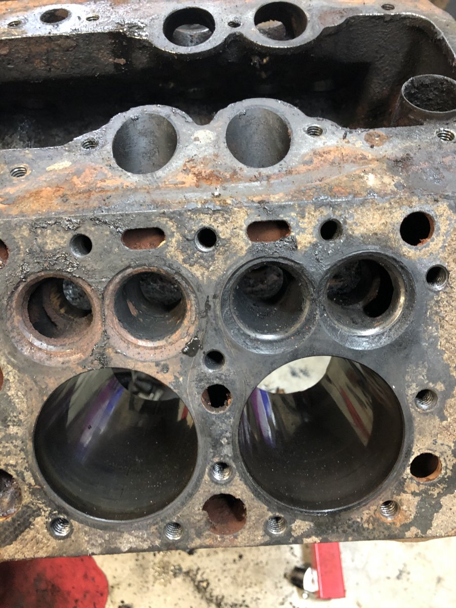

  6. 18118636-028F-43A1-BC33-845BA32AC954.jpeg 9CA02085-D7F4-44C5-A7EF-7BF0705D2D6E.jpeg E357BCAD-D360-4A01-9513-51FB3513A468.jpeg 3F43581E-3EB6-4DDB-8489-448D0C3046B0.jpeg 436069E8-A692-4762-B321-D12E603532A4.jpeg Well,,,I got some more done on my Flathead.
    I got all the valves out and the lifters,,,,it took about 2 hours all together.
    It is new to me,,and the first ones came kind of slow,,,I didn’t want to do anything to damage the block.
    I got the hang of it after the first 45 minutes,,then it went much quicker.
    The lifters came out very well,,,a few were tight,,,,,but none were really stuck.
    I haven’t put a wire brush to the decks yet,,,but they seem to be very well.
    Tommy

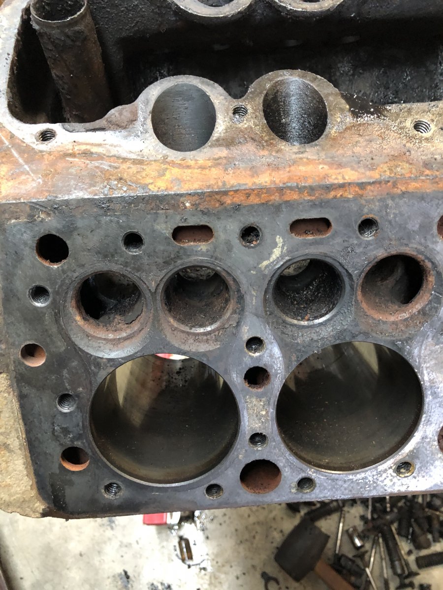

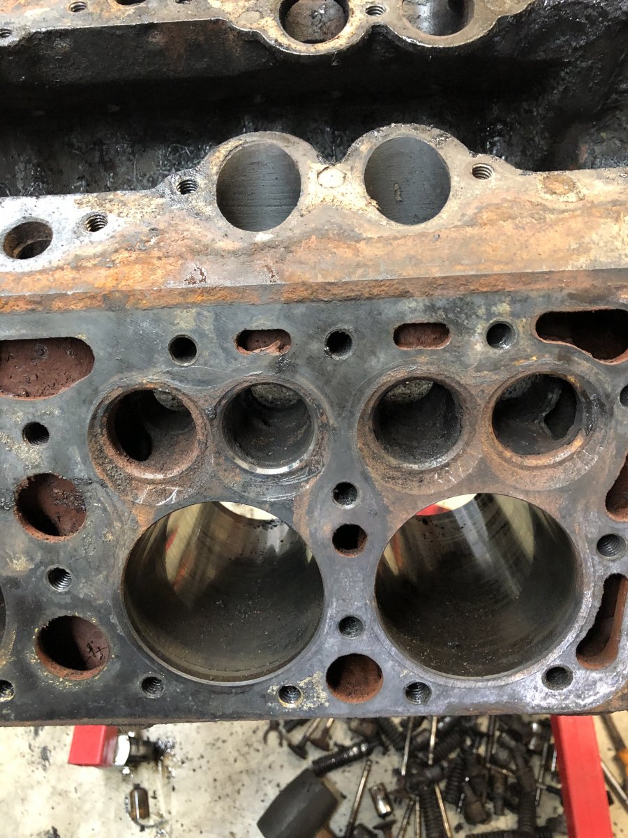

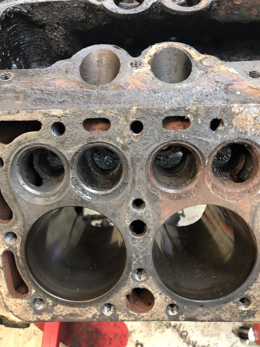

  7. 80911A7F-5B1D-42C4-80BB-61DC4BB8AD6D.jpeg 9904CE04-DA50-4B5F-8382-F499A8C86D9C.jpeg 0CD5783F-37AB-45AE-BD13-930A65BB79BF.jpeg 8A34ACDD-EEA0-4B34-B913-3DD9E18FA716.jpeg 796F07EC-277A-4C2D-98D0-6F3D1D47B371.jpeg 1FBC7AF3-24F1-4546-B912-CE35AB94E452.jpeg Here are some pics of the cam area and the camshaft itself.
    Seem to be very decent shape.
    Tommy
  8. tubman
    Joined: May 16, 2007
    Posts: 8,678
    tubman
    My eyes aren't what they used to be, but I can't see any "part number" cracks.

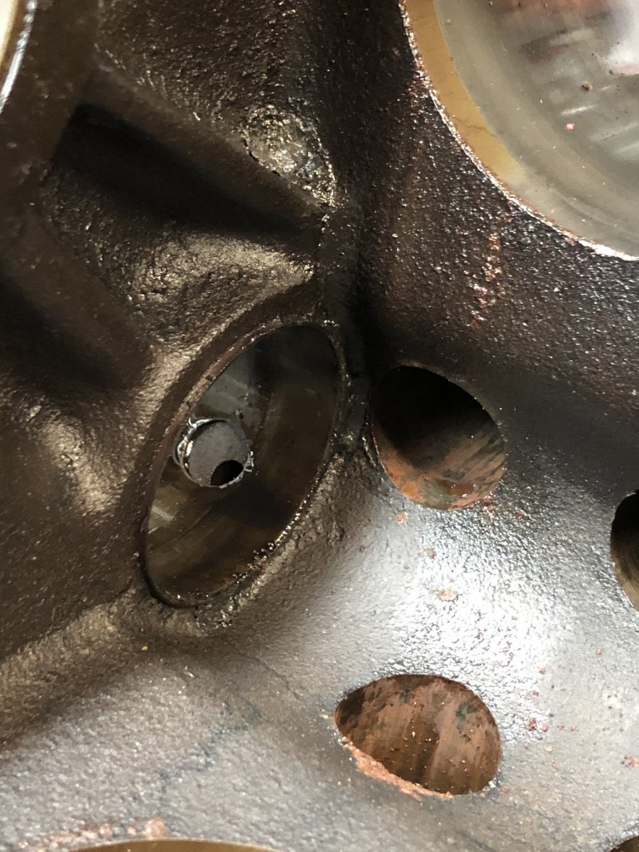

  9. 914B1C05-5060-4794-8F29-69992A80D72B.jpeg I did find something unusual,,,and I wanted to show you guys and ask about it.
    Some of the valve guides were different.
    Some had a solid body and some had a groove machined into it and had a rubber seal in the groove.
    In the pic the rubber seal is easily visible.
    It has square corners and is still pliable,,,the I.d. is square as well.
    It might have formed into a square shape after 70 years ,,I’m not sure.
    Some were on the intake side,,,some were in the exhaust.
    There is 9 with the rubber,,,7 with the solid body,,,,,any ideas?
    Tommy

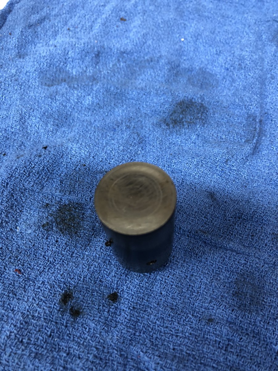

  10. 43B80184-D29E-4923-8FD2-DC3A138A358F.jpeg C3C44096-18BD-4BA1-8B1D-A24064579048.jpeg E9453B4B-C73F-41E8-9B6A-014849F910BA.jpeg Here are pics of a lifter.
    This one is typical of all of them,,,they all seemed in about the same condition .
    Not much wear on the top,,,or sides.
    The bottom has typical wear just like any old lifter would be.
    What amazed we is they are hollow,,,,I always ***umed they were solid !
    The bottom is a hardened insert,,,,really sound design.
    Some really good engineer work for back then,,,,really better than today’s in some respects.
    Tommy

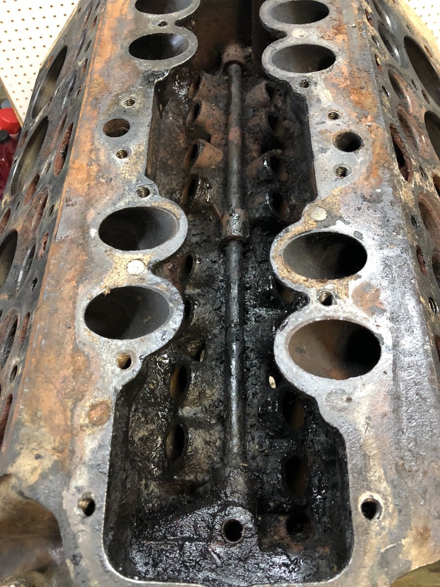

  11. I still have a few other things to remove and then it is off to the shop to be checked for any cracks and such.
    I am not gonna bore it yet,,,,still deciding how far to go.
    I was thinking about .060,,,,but,,,,.125 sounds good as well.
    I just want to make sure it has plenty of meat left in the cylinders.
    Tommy

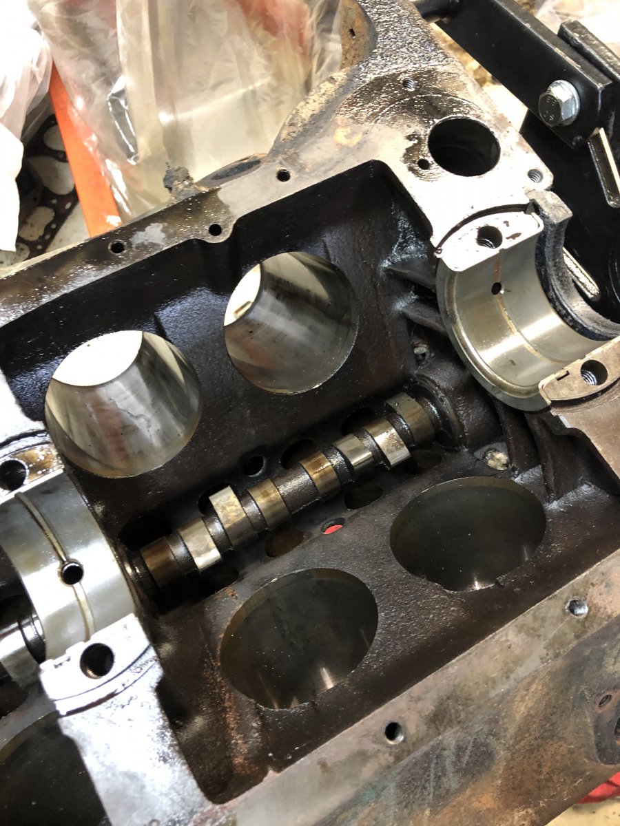

  13. 7636A14B-B22F-4399-A4EB-DAE85677561C.jpeg B099C123-5CE9-4495-8804-6DD8BCBD818D.jpeg 92759E1A-FD44-43FD-90AF-94C067ACEDC3.jpeg Here are pics of the cam bearings.
    The number 2 and 3 bearings are perfectly aligned with the oil galley.
    The number 1 was just barley over the hole,,,,but I guess they don’t need a ton of oil
    But,,,,is that where the front main bearing gets its lube from?
    Either way,,,the bearings still looked great.
    And I don’t think it had tried to spin either,,,,the cam journal is perfect and so is the cam bearing.
    Tommy
    Aaron D. likes this.

    Whilst you can have the rubber seals on inlet and exhaust guides lots of Flatheads don't have them on either. Guys that put them on usually only do so on the inlet guides. And yes square sides are correct for the seals.

  23. Now let me get this clear.
    The valve seal is in the valve guide body,,,not on the valve stem.
    The valve guide has a groove on the body o.d.,,,,and the seal goes into that groove,,,there is no seal on the stem itself? Correct?
    Tommy
