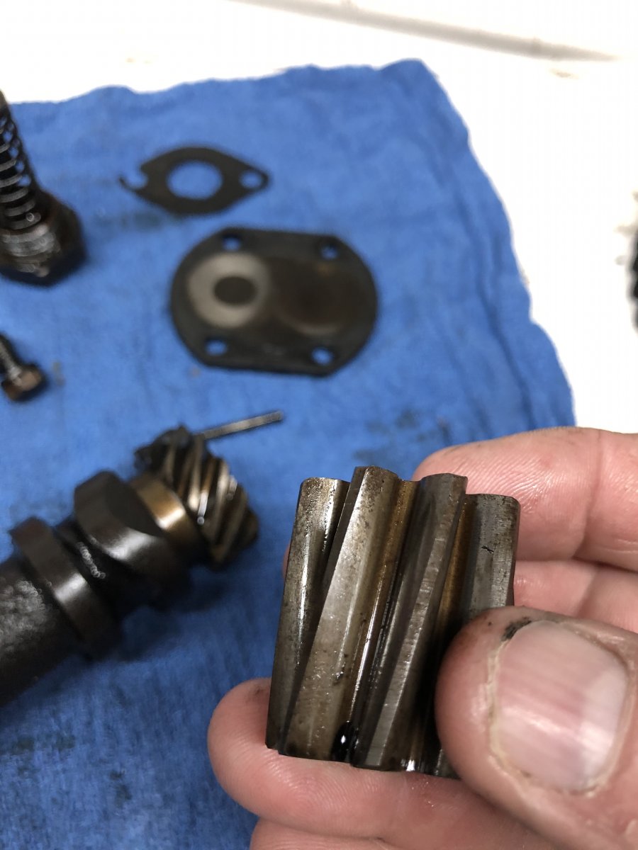

    Here Is the oil pump drive gear and cover plate,,,they also seem to be in excellent shape.

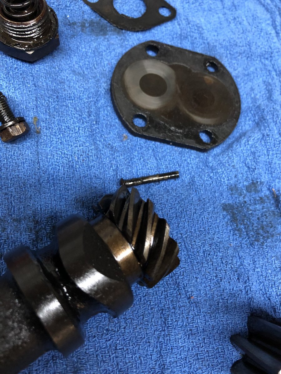

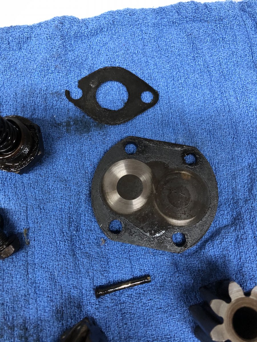

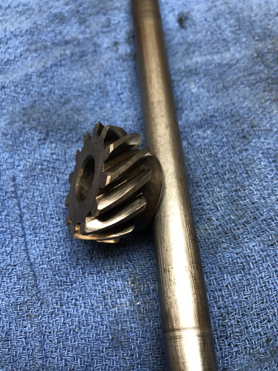

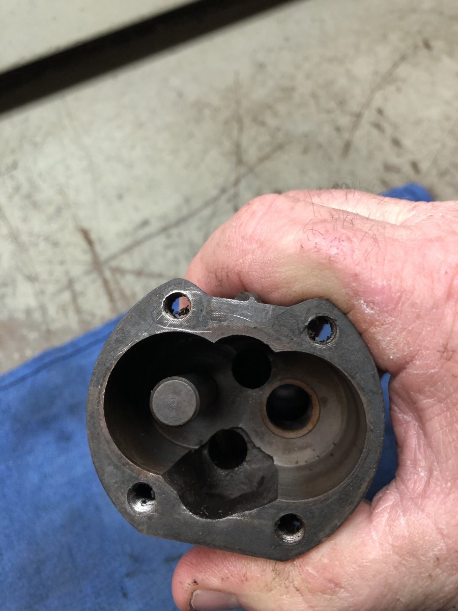

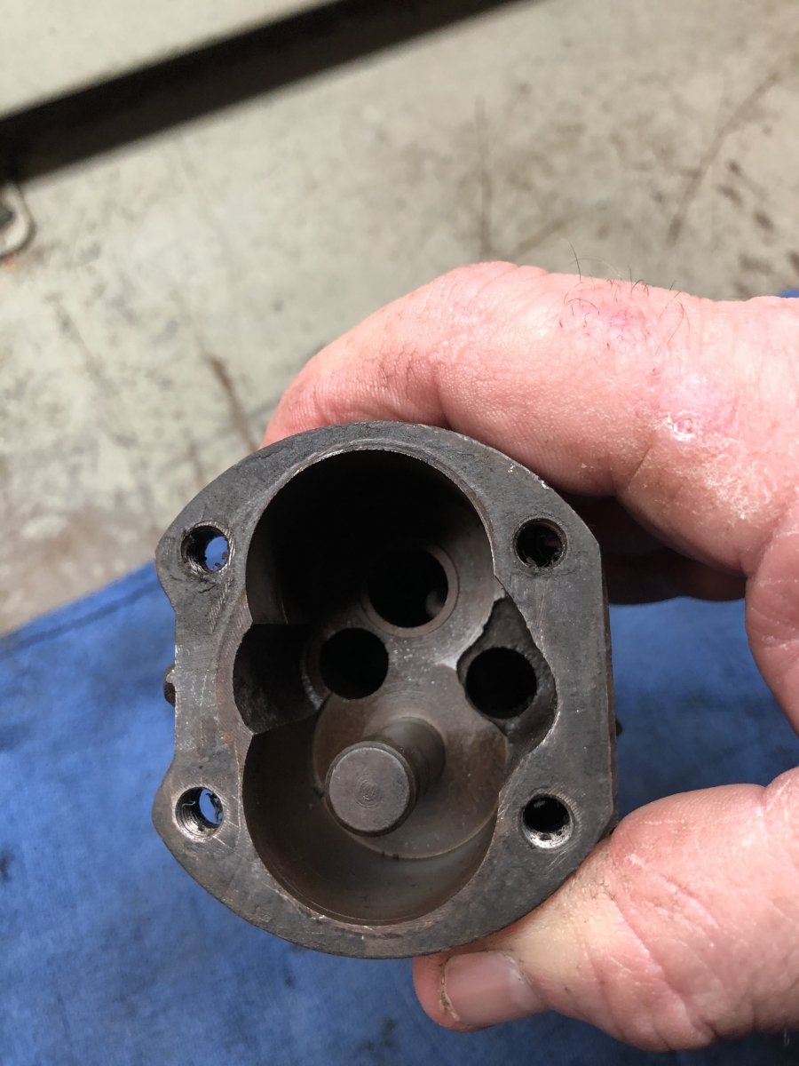

    Back on post 63,,,you asked about the oil pump.
    Here are some pics and it really is in great shape.
    The gears are almost perfect,,,they have no gall marks,,,,and the housing is the same.
    The top cover has a wear mark,,,it is about .0015 deep.
    The top can be surfaced like new again.
    The cam drive gear is in excellent condition,,,,the gear to end clearance is .021.
    That seems a little high,,,, I am still waiting for my Motors manual to show up,,,it should be here in a couple of days. The specs are usually in there.
    That is why I think the oil gear wore on the cover plate somewhat ,,,excess clearance at the top allowed the gear to ride lower.
    I will have to mic both oil gears too,,,the height,,,,and then cover clearance.
    The pickup is fine,,,gonna replace the screen,,,and the spring hook latch.
    Anything else to look out for ?
    Tommy

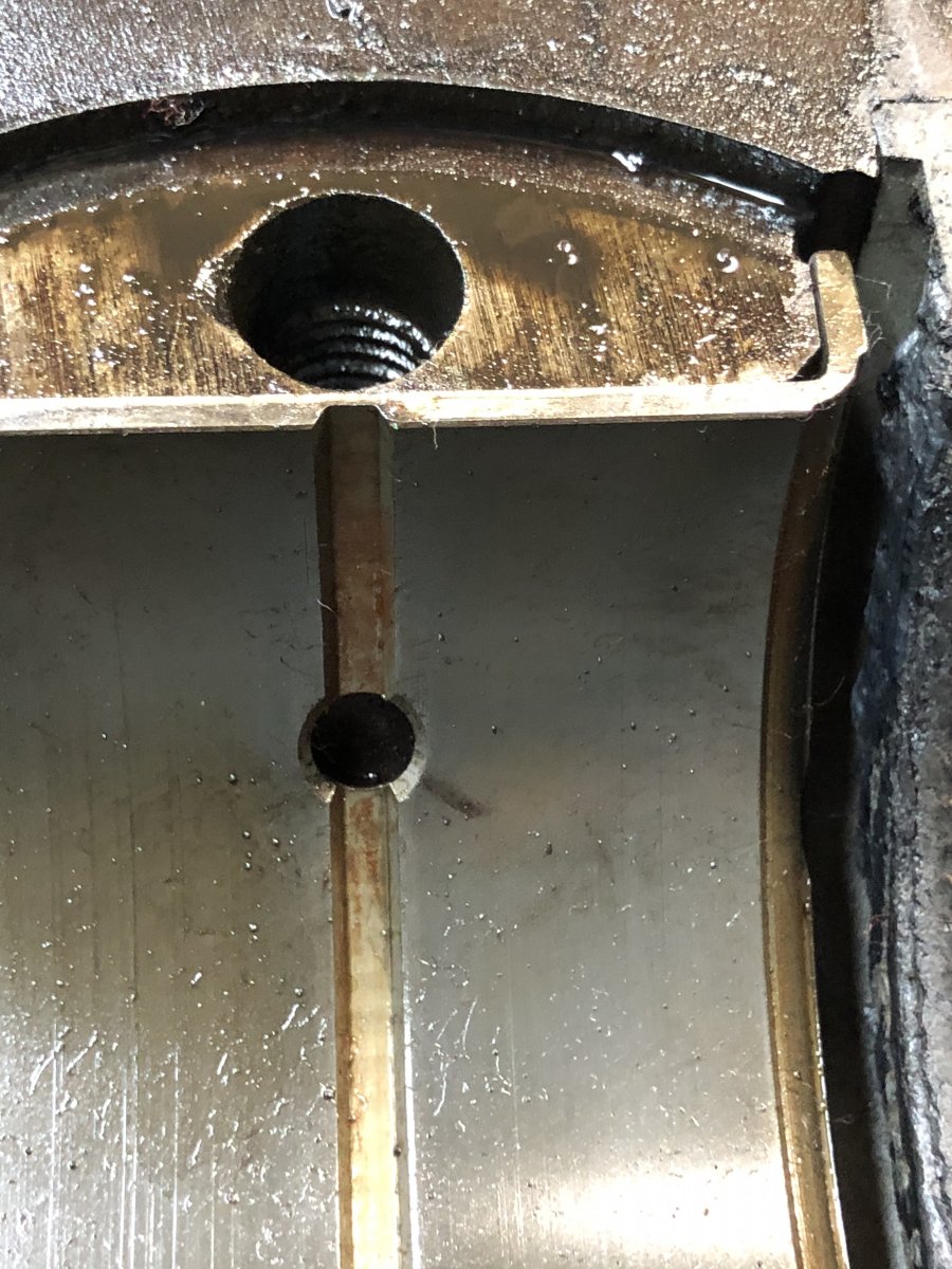

  16. 001393E4-95CB-4BC5-93BB-59CC3E9B146B.jpeg 5D6DEE04-8303-4E1B-BB00-7AA223EDB480.jpeg I removed the cam bearings,,,,they had some wear.
    The rear bearing was worn the worst,,,,it was worn in the direction away from the oil pump drive gear.
    I ***ume the thrust of the oil pump pushes away from the drive gear ?
    The bearing o.d. Measures 1.930,,,,I ***ume that is standard size?
    Tommy

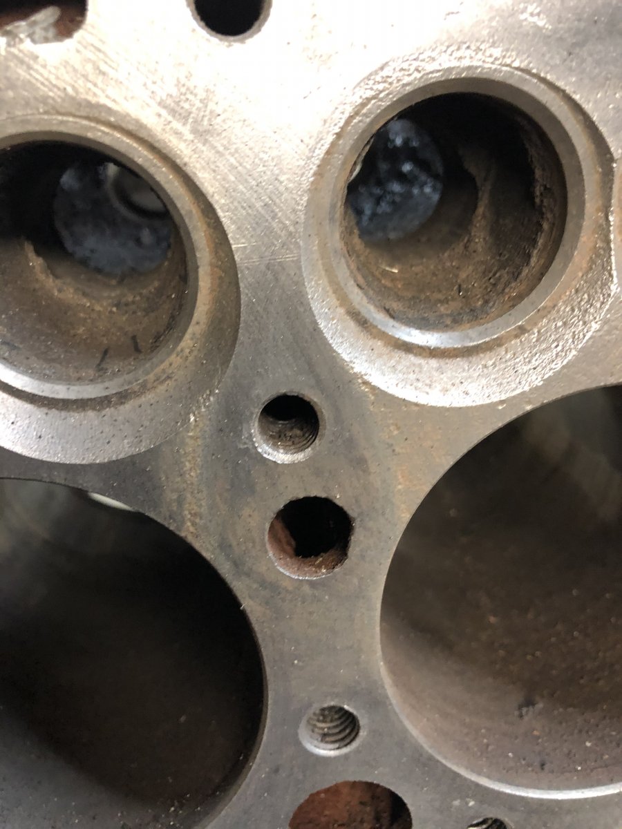

  22. D712D337-B441-4A60-BCA1-1182271C435F.jpeg B37BD56C-AD70-4A44-8602-56AB49018DC8.jpeg 135341DE-ABF9-4F6B-9669-A01EA2BDF6B3.jpeg DB0D8AA3-0AAC-4939-9A1C-157A92FEB1E5.jpeg Here are some pics of the valve seats.
    It looks like it has hardened seats on the intake and the exhaust?
    Am I wrong?
    The other bank looks the same as this.

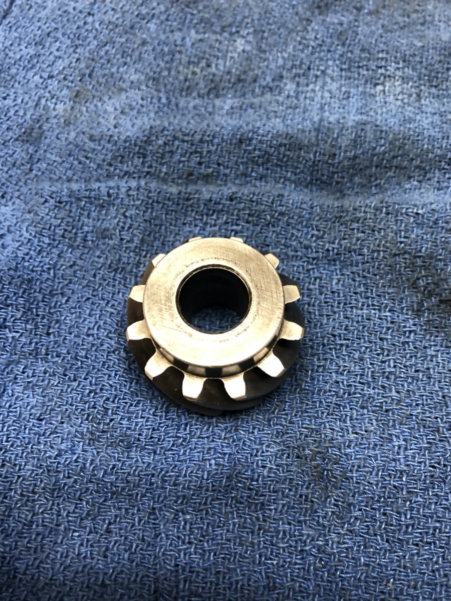

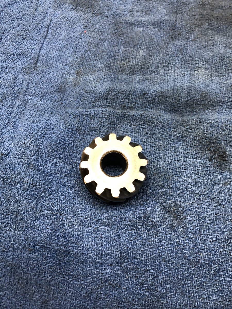

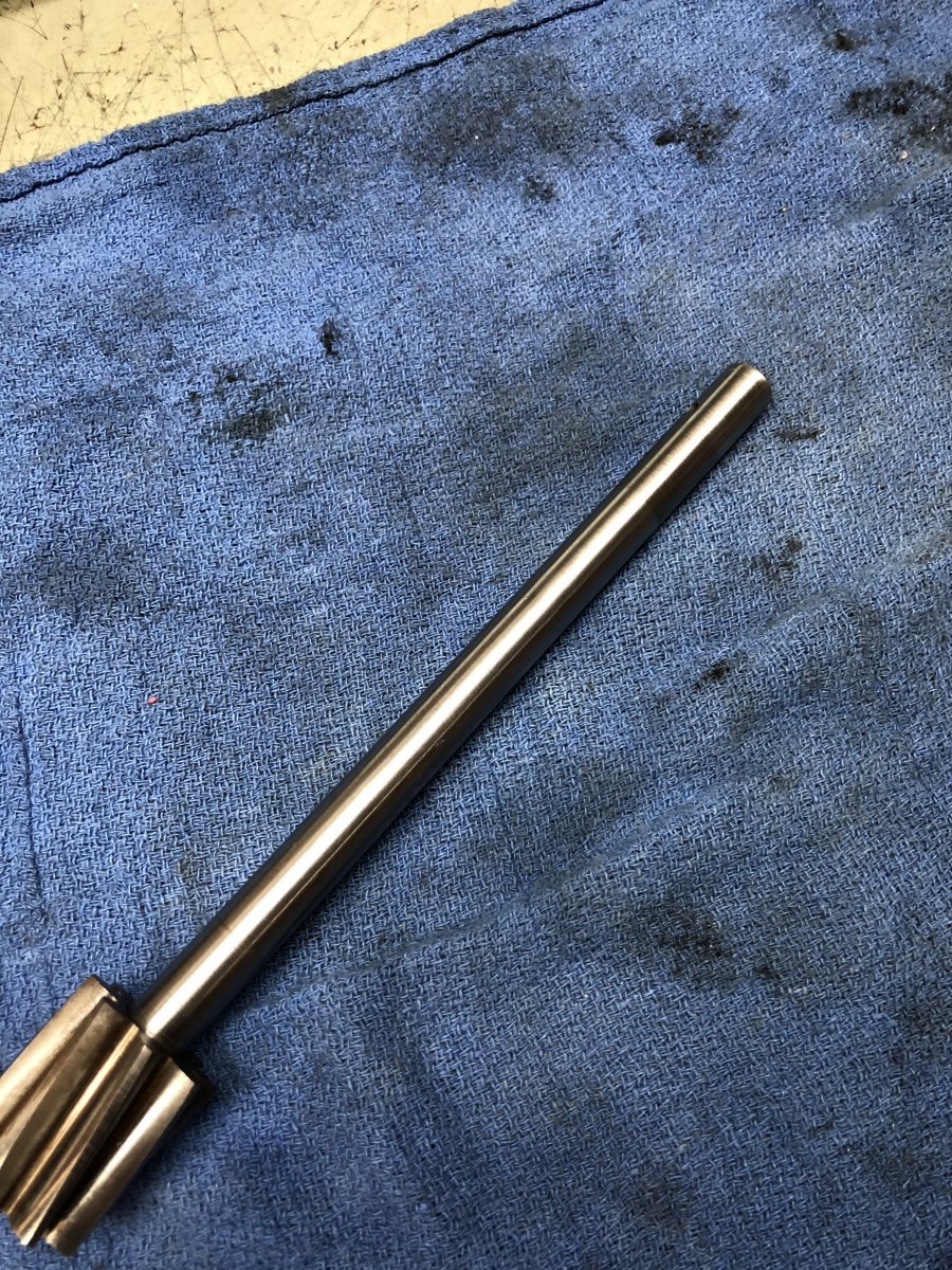

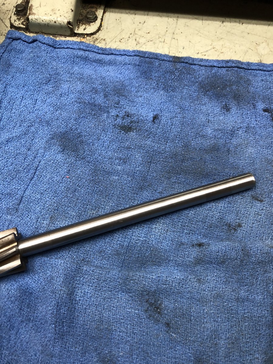

  26. 0393BCCB-6B26-4DF7-97A1-A272F9FFAD1A.jpeg E7EB7514-6C03-4168-8F18-12A8EA77B5A9.jpeg C4038A89-6D5E-4805-AC48-11BE843EA871.jpeg BC7635F6-EAC9-421D-938C-3EB4CE7A2850.jpeg ABFD85DF-92E8-4909-9E28-C5950FC9F9F8.jpeg The shaft has .001 wear on the top and bottom bushing area.
    The bushings themselves have right about.002 wear,,but,,,only in the thrust area from the load.
    Here are pics after I polished the shaft with 400 Emory,,,and the drive gear after Scotchbrite.
    I am very happy with it so far.
