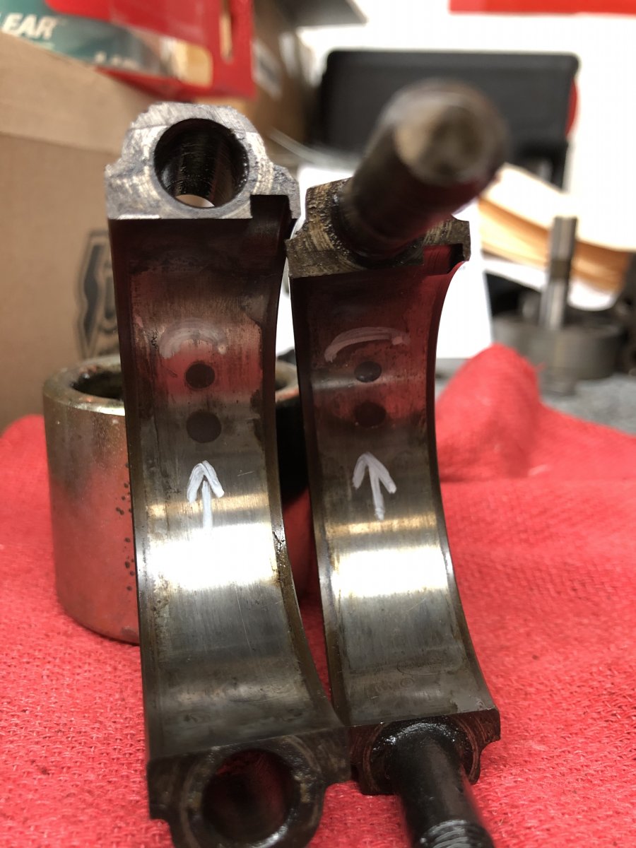

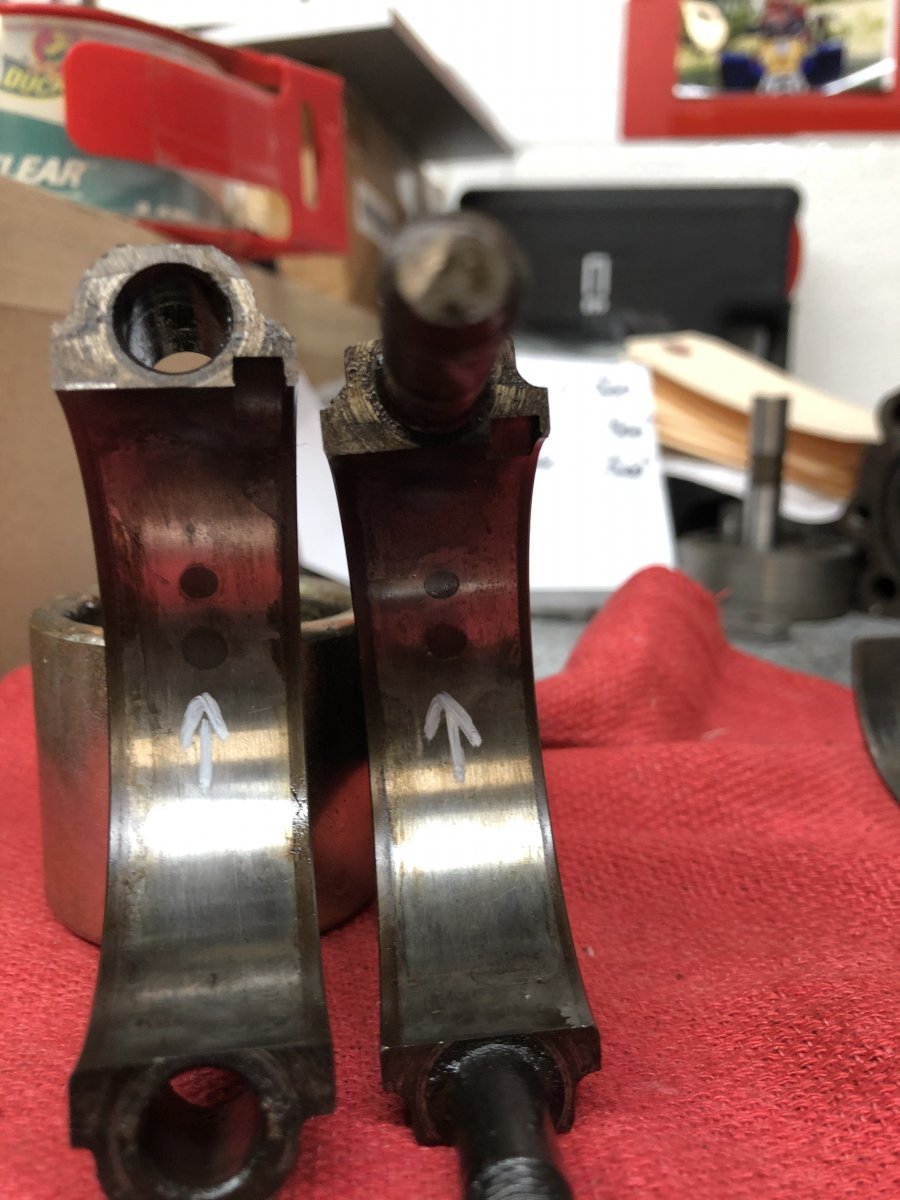

  2. 6C149026-E689-4C61-81D7-BA1FA6D617AA.jpeg A64309C2-BB8D-40A2-8F99-879662B4575C.jpeg 61F9262B-BA99-46D8-9617-7D244943B9C6.jpeg 0A81C614-B260-4235-9EDE-3A6888672689.jpeg Hey guys ,,,here are some pics of the rod bearings.
    I am really happy how it has all come apart so far,,,,not bad at all.
    After some checking on the bearings I am sure it has at least had the pan off and the bearings replaced.
    In the first pic,,,,I placed a paint mark arrow where the oil hole is in the bearing.
    The second pic shows the witness mark from the oil stain on the rod and cap with the bearings removed.
    It has a nice black varnish built up on it.
    The third pic shows where I placed an eye brow mark above the second oil stain.
    There should not be a second oil stain on top of the lower one,,,,these bearings have been replaced with a different kind with a different oil hole location. The witness marks prove it.
    The fourth pic shows the side of the rod where I placed an arrow near the bulge on the rod.
    I ***ume these bulges were forged in the rod to give enough metal to drill an oil hole when used for a different ,earlier model?
    I know the mains had been replaced,,,and the rod bearings too looks like.
    What do you guys think?
    Tommy

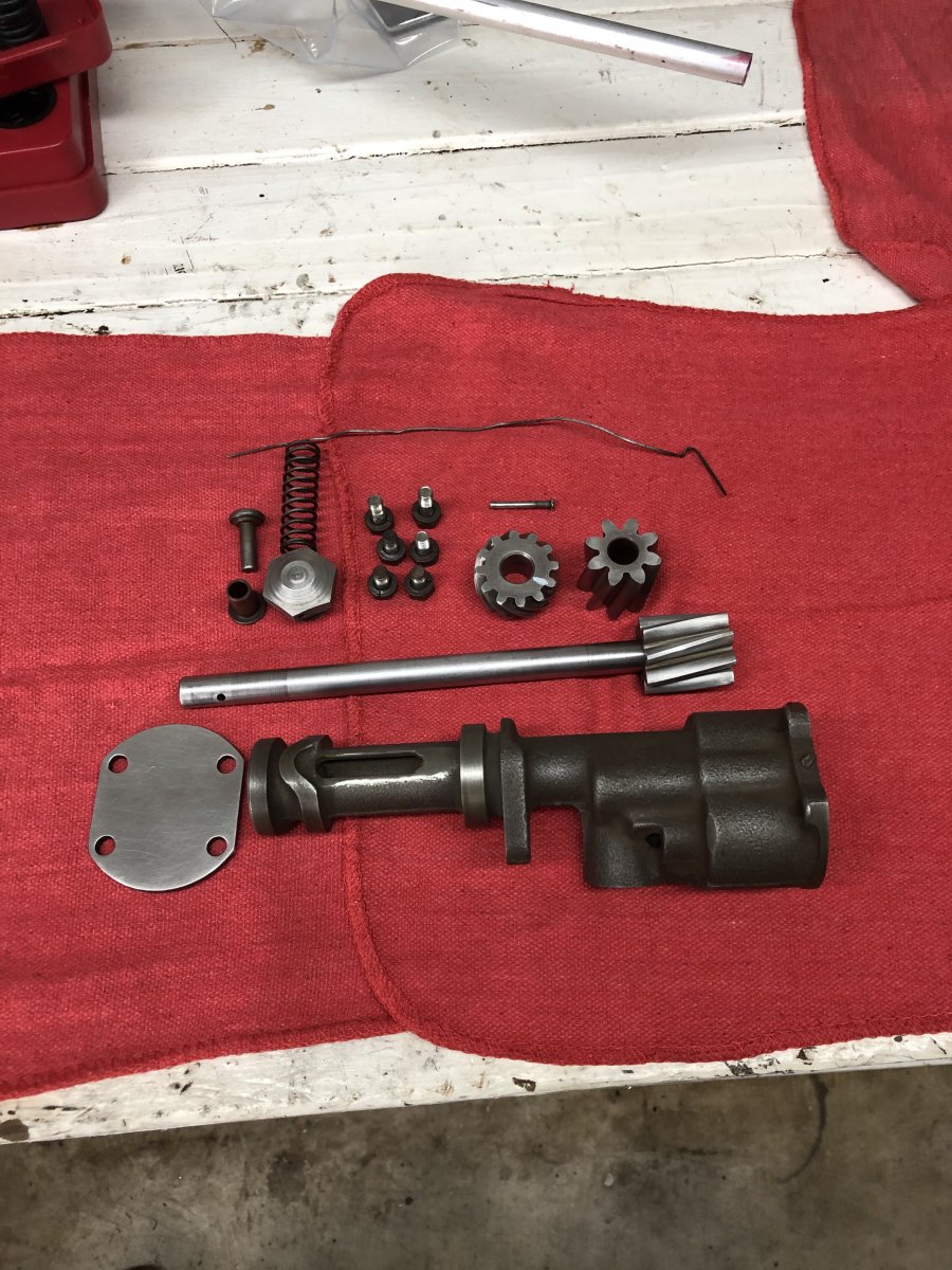

  3. 01BF17AC-3EA0-468D-A8FF-634869F570AA.jpeg 5FE66215-EF66-434E-BBAC-FEE6C2033495.jpeg E2061615-D9DF-4B3F-AD51-AD808F45208D.jpeg Okay,,,now I need some insight from some experts
    Here is my oil filter,,,,it is all there,,,and I need some coaching.
    The first pic is all the components.
    The second pic is the pressure switch and the fittings,,,all seems well.
    The unit has 80 stamped on it near the bottom on the br***,,,,I ***ume it is an 80 psi sender unit?
    Now the third pic.
    I had read that there is an orifice that controlled the flow through the filter.
    There is a small hole about.063 thousandths ,,(near the paint marks),,in the housing tube and another hole 180 degrees around on the other side of the tube..
    That is all the flow that it gets !
    Did I miss anything,,,surely that is not all there is?
    Tommy

    That's why it's called a partial flow, even with that orfice there is more oil than you would think moving under the pressure. I'm not sure on the sender but 80 psi doesn't seem right. A lot of motors back in the old days had no filter and ran non-detergent oil! Lots of them are full of sludge when taken apart.

    The two holes in the center tube are how the oil drains back to the pan. The br*** fitting on the inlet side of the filter is where the restriction is that regulates the oil pressure. Make sure you tighten that top bolt down really tight before firing it up or the top will leak. I found that I needed to use two gaskets under the top to stop it from leaking. Much more pressure in that filter than you might think.

    I was always told the oil filter restrictor was in the fitting on the "in" side of the canister. Basically a 1/16" or so hole to slow the flow and keep the pressure up in the rest of the system.
    ******* Research that hole size before anyone takes it as gospel.

    On my 59AB, it's on the outside. Because the threads of my original restrictor were damaged, I had to source a fitting from NAPA with the right size hole, then add a flare nut adapter so I could fab my own lines. The restrictors are in different spots depending on the model year. There are many threads on the topic over on The Ford Barn, here's one example: https://www.fordbarn.com/forum/showthread.php?t=195393&highlight=restrictor.

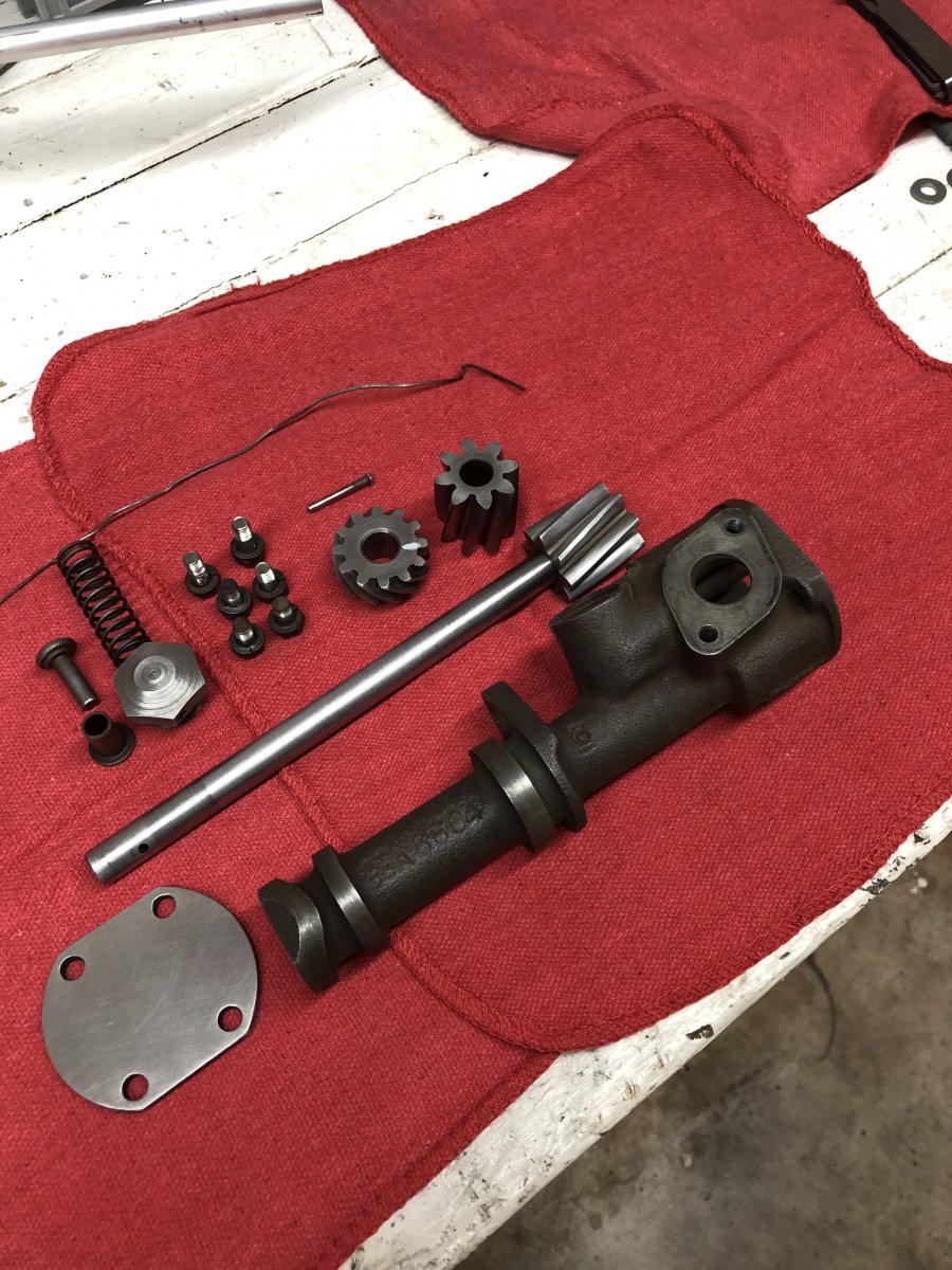

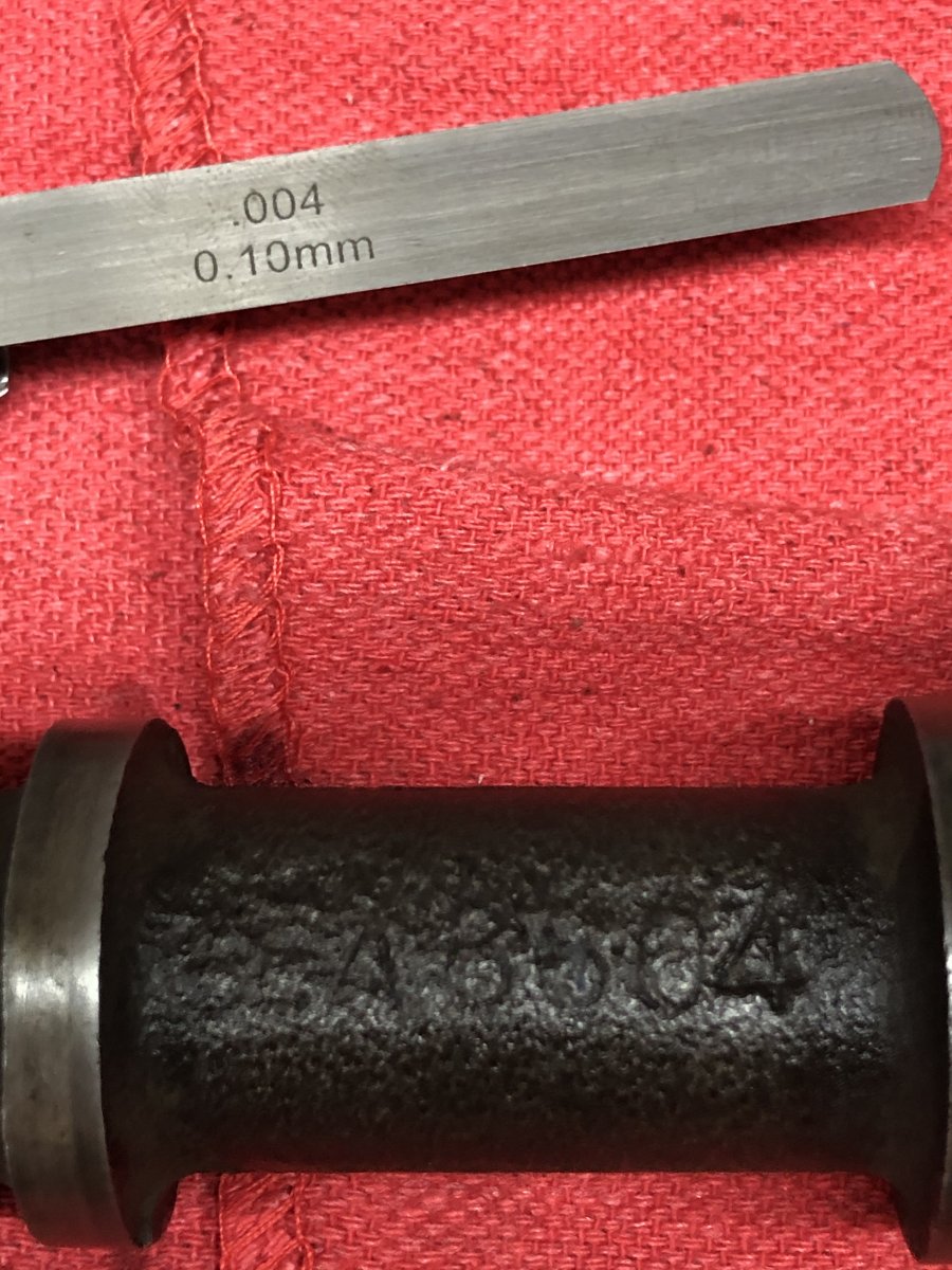

  10. 43A99947-718C-4D21-9D0F-83F6EE8155AF.jpeg ACEF48C3-1443-411D-A6AC-629DFF43B9DE.jpeg 5259928A-C98F-4380-99A5-B41090F38E8C.jpeg Here are pics of my the oil pump,,,before ***embly.
    The parts all cleaned up nicely,,,and check very good on the clearance side.
    Also,,,I relieved some casting flash from the body at the opening near the drive gear.
    I have a gasket kit coming,,,but I decided I could put the main pump ***embly together.
    All I will like is the adding the cover plate and the pickup.
    Also,,,I see some casting numbers on the body,,,they look like 8BA 8604.
    Tommy
  11. 8D0603D3-6D1B-4A5F-ADD1-003CE6F12851.jpeg I lubed all the bushing and shaft,,,and fitted the gears to the housing.
    I use ***embly lube and oil,,,,red ***embly lube on the bushings and plenty of oil on the gears.
    The drive gear to housing clearance checked out at .012 thousandths,,,I had about .020 to start with. I realized the shaft had moved in the gear a little.
    I placed the shaft and gear in an arbor press and gently reset it. Then restaked the lockpin in the shaft at the top .
    The gears to oil chamber clearance came out to about.0035. A 3 feeler would go,,,a 4 feeler would not. Very good in my opinion.
    The top clearance will be about whatever the cover gasket thickness is,,,,the gears are basically flush,,if not .001 above the surface.
    I am amazed at how tight the tolerance was held back then.
    These clearances are tighter than modern day checks are.
    Most pumps service limits are more than twice the gear clearance that I have.
    Tommy
    Johnboy34 likes this.

    >060 orifice and 80 lb sender are correct. The spring in the pump is usually set at around 50 - 55 lbs. I built a rig to test the oil pumps and check the relief pressure.

  13. Thank you Flatjack,,,from what I had read,,I thought that was correct.

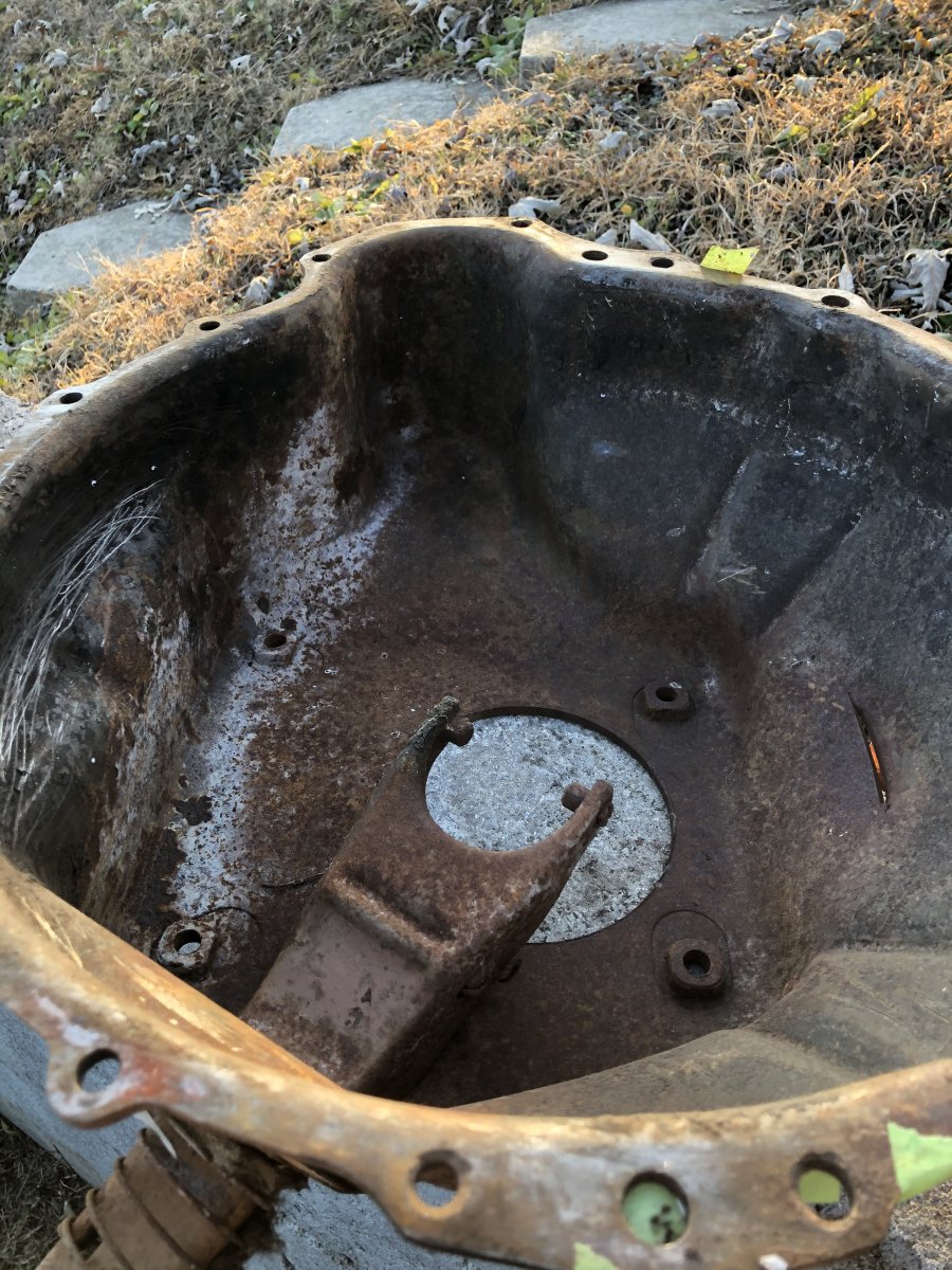

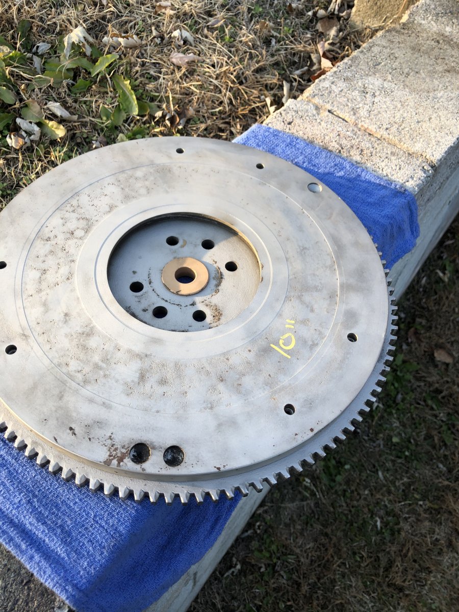

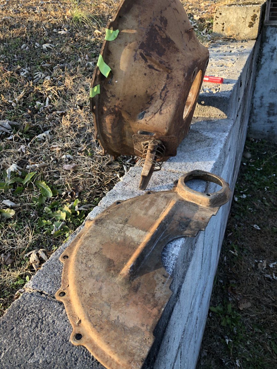

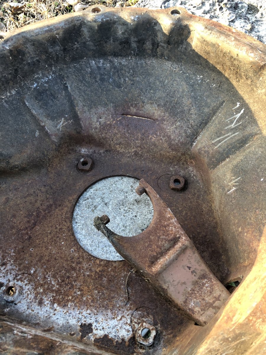

  14. DB0AF485-5709-4A7A-8007-00F1FEFC3C5C.jpeg FE3C2FB8-6479-40C3-9767-ECB06EC25912.jpeg F557145D-6A05-4186-93ED-0402577090DF.jpeg 38882A4E-FC7C-45BA-BA00-C569C5A6C639.jpeg 86BAC47A-0D4D-4106-8865-E797EE564A3F.jpeg 1352EDFC-CF7B-4566-AFD1-0347BC24C61A.jpeg B935E754-F2FD-4470-812B-0D9ACAC38817.jpeg 3E828E95-1D86-4C83-A9FF-788CDF7DDCF9.jpeg Back on the previous page John Lee asked about my bellhousing.
    I didn’t find any numbers on it,,,,,59L or 59Z,,,,maybe I need to clean first.
    It is from a 50 Mercury,,,,the flywheel too.
    The flywheel is very nice,,,,has a wear pattern about.010 - .012 deep from the disc.
    I plan on having it surfaced and redrilled for a B and B pattern,,,,probably use a 10.5 diaphragm for ease on my leg.
    Or I might use a Long style pressure plate and use a slave cylinder to rest my leg ?
    Any ideas on that ?
    The bellhousing is in fine shape as well,,,I was lucky to get them both when I did.
    Tommy

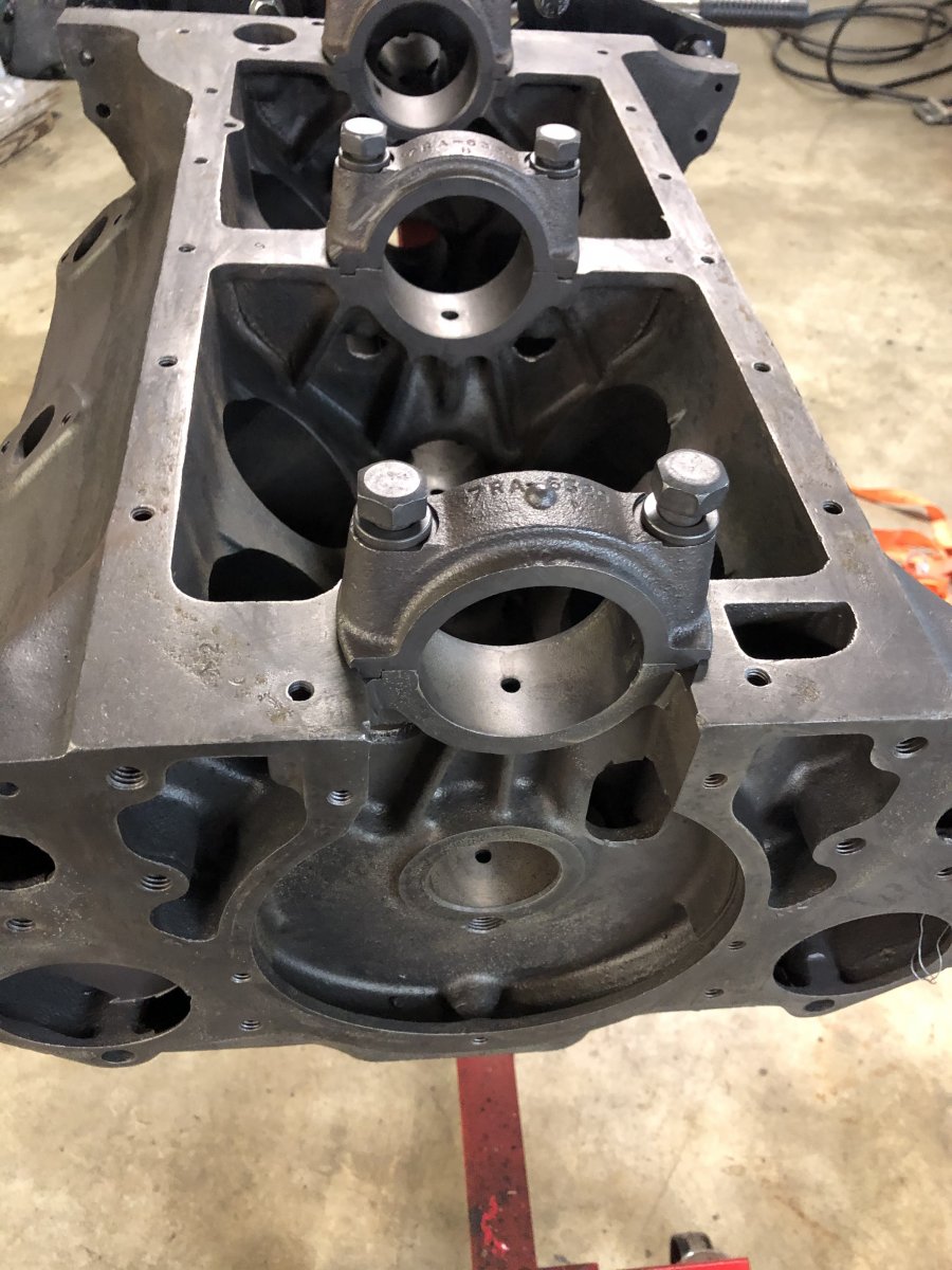

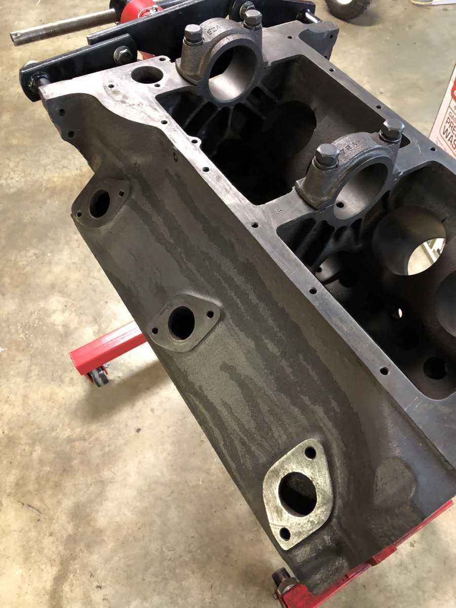

  20. 1A59940D-2E87-4EA9-8E3A-5C494F097253.jpeg 755074CB-EA90-4CED-8718-9440295DA7BC.jpeg 9BA6630D-0700-427C-B9D0-BE1FE21691C3.jpeg 0EE17268-945D-450A-8A61-A3236B444A10.jpeg 6DF4D4D6-FF77-4B94-90CF-DC9FDCE17FCC.jpeg E91FEEA1-464D-4A2F-92A4-E35C3FFB7723.jpeg 32988D6D-811E-40DB-BB42-95A5FC6F25D5.jpeg Brethren,,,,,,
    Congratulations are in order !!!
    Got the block back tonight,,,it got a clean bill of health !
    No cracks and it looks awesome after being cleaned.
    Here are some pics.
    Tommy

    You did great! Cleaned up very nice, and no cracks is just mind numbing for your first foray into flatheads! I don't know if it's just the early ones but a lot of folks don't recommend it be on a motor stand that way. Most use the exhaust bolt holes.
    Sent from my SM-G900V using The H.A.M.B. mobile app
  22. Thank you Johnboy,
    It came out of the mid west,,,,when I saw the pics from the seller,,,I just had to take a chance.
    I am really excited about what I can do with it.
    From what I have read,,,the stock rods are very capable of being used again.
    I would like to use them if at all possible.
    The power won’t get over 200 at the most,,surely they should stand up to that?
    To be honest,,,150 or so might be closer.
    Tommy

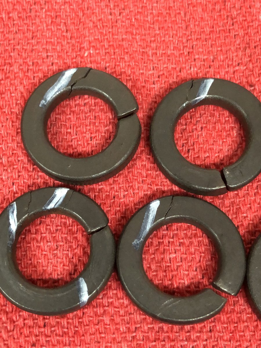

  24. 5ABEA9F3-1C8A-4052-97B8-12B8D2576E2B.jpeg E758B32F-EE65-4894-B561-943DB96201B9.jpeg Okay,,,,opinions on main bolts and washers.
    Here are some pics of my main bolt lock washers.
    Out of 6 washers,,,4 were cracked.
    I marked the cracked areas with a paint marker,,,,one has three marks because it has three separate cracks.
    I don’t want to use studs in the mains,,because for my application it is overkill,,,,and added expense.
    I would rather use the stock bolts if at all possible.
    Should I use a hardened flat washer,,,or just buy new lock washers and go with it?
    Tommy
  25. Aaron D.
    Joined: Oct 27, 2015
    Posts: 1,038
    Aaron D.
    Just get 4 new lock washers for the back two main caps. The front cap is installed without any washers. (oil pan clearance on 8BA)

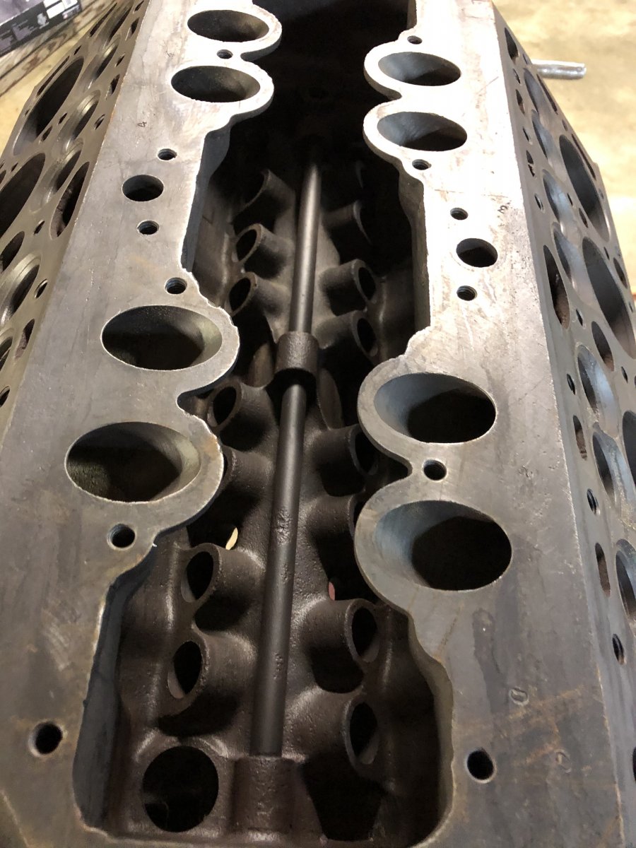

  28. 327C2AF1-364C-4738-9B8E-33C233CA5057.jpeg 060A175A-07CF-4612-AC61-016BDFB12C42.jpeg Okay,,,for you veterans of Flatheads,,,,you already know about this,,,this is for the new guys to Flatheads,,,including myself.
    This is the vent tube in the tappet chamber,,that connects to the intake and the road draft tube.
    It stands upright,,,and is pretty tight in the block,,,it doesn’t really want to come out after such a long time.
    I wasn’t sure how to remove it without possibly hurting it.
    Then I decided to insert a large screwdriver handle and wiggle it back and forth.
    After 10 or 12 wiggles and rocking motions it came free.
    I know this sounds silly,,,but I wanted to hand this on to the new guys.
    Tommy
