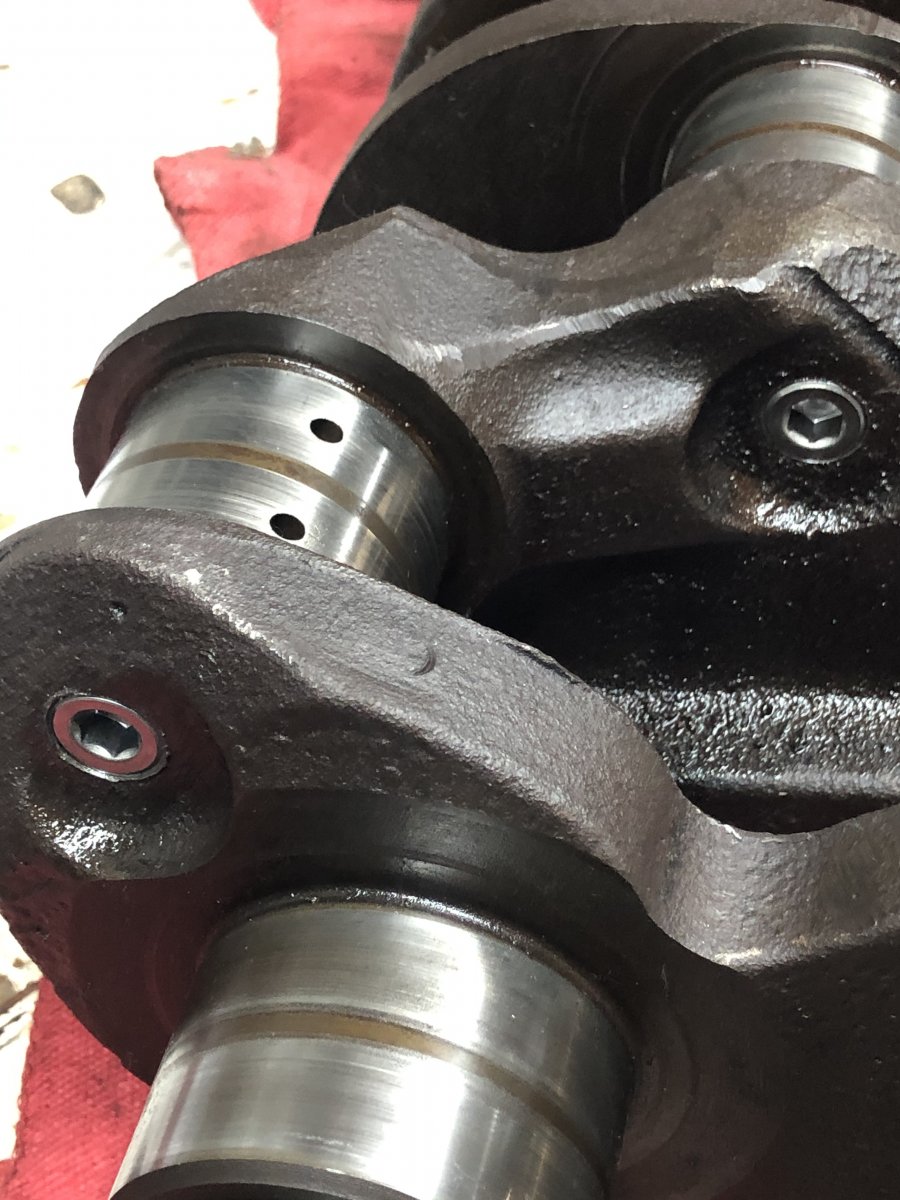

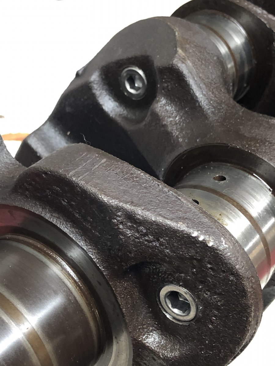

  4. F3DDB250-146B-4C44-919B-1FC2C6E445F3.jpeg A4D27AFE-589B-49F9-864F-055B421C5310.jpeg Here is an update on my crank.
    I have read where some builders remove the sludge trap cup plugs and tap the holes for threaded pipe plugs.
    So I thought I would give it a try.
    As t turns out,,,it was really easy.
    On the Mercury crank,,,the holes are already the right size,,no drilling to do.
    You just have to tap them with a 3/8 pipe tap,,,it turned out great.
    Tommy

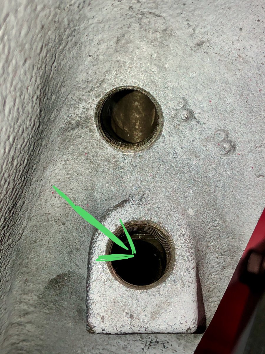

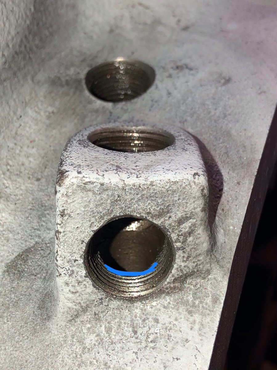

  5. C7BD0ED8-5A3C-48E8-80E9-1A25D7D84480.jpeg A151FF79-A902-4D37-863D-5499EF20D900.jpeg Okay guys,,,,I have been reading about the oil filter upgrades to Flatheads.
    I was gonna just use the factory model,,,,but after reading about the needed mods,,,,I decided I could just do this myself.
    Here are some pics of the method I used to do it .
    First pic is stock holes .
    Second pic (green arrow ),,,is vertical oil galley from pump,,,I enlarged it to .500 inch,,,,the reason being I had to open the holes for the larger pipe plugs,,,,and I wanted all the volume I could get to the filter,,,I didn’t have to open it much .
    But,,,I was very careful on drilling it,,,keeping it straight and true .

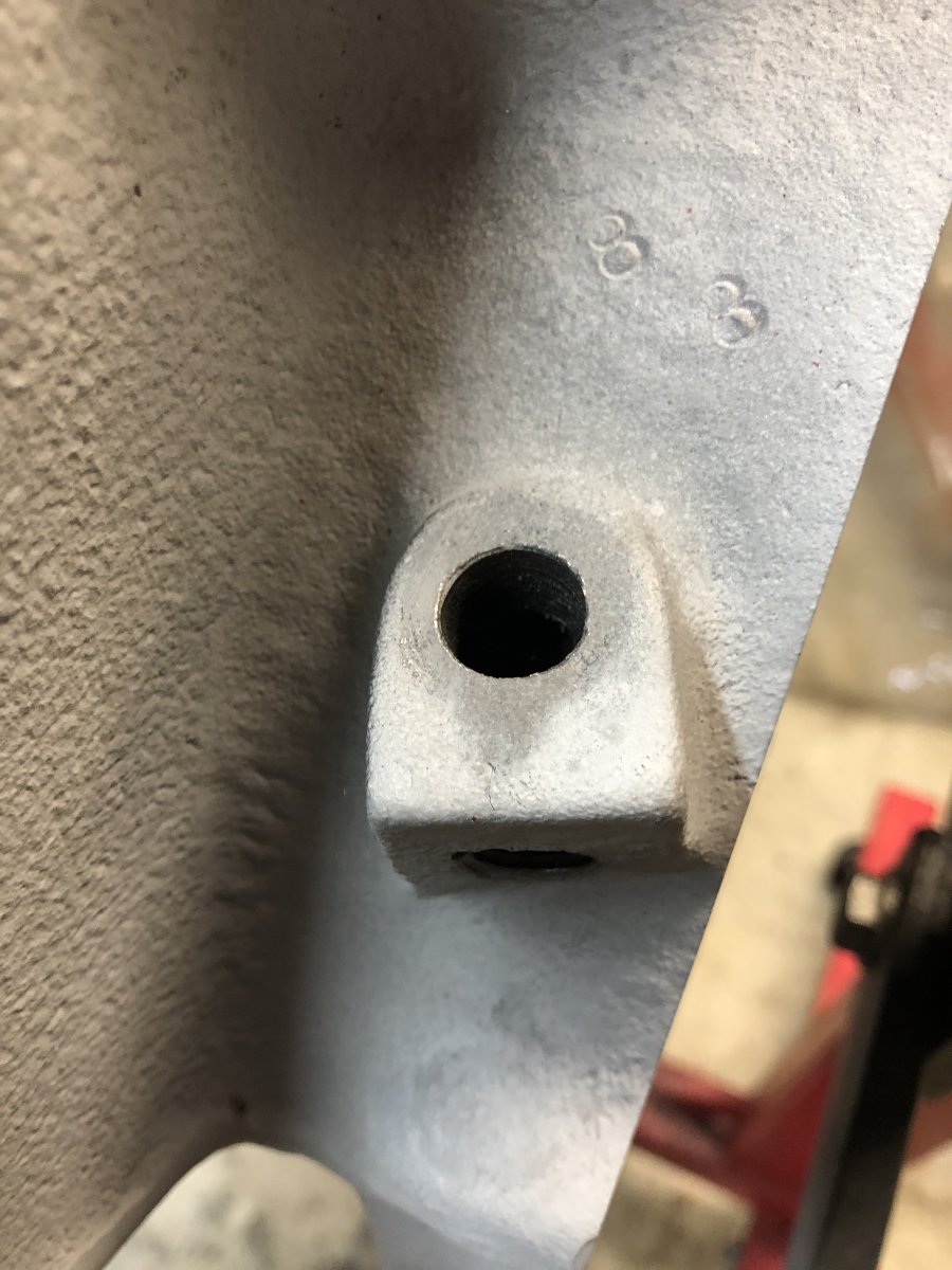

  6. The next pics are after I added a radius to the oil p***age to blend the flow from the vertical galley to the line to the filter ,,, (the radius is in blue ). CEB030BB-87A4-43BE-8662-946FF7089962.jpeg 38690055-75F4-403F-8BD7-F9EFC6FE45E3.jpeg
    I believe it helps maintain good pressure and keep the oil flowing smoothly.

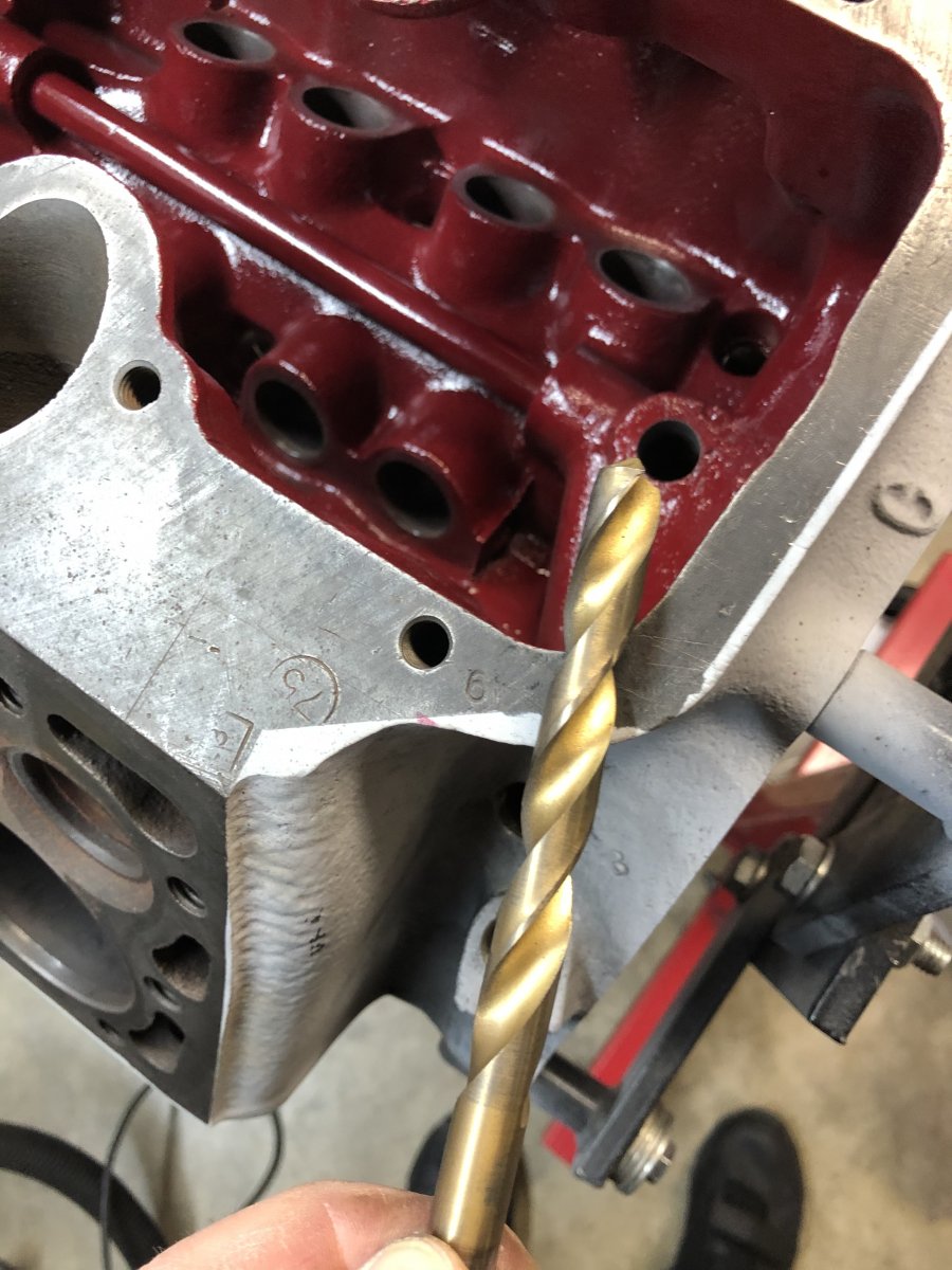

  7. 2873F3CA-4216-4F1F-BAFE-BB11073FF4D3.jpeg 18C933EE-82FC-46AA-B9C2-AA5274D2E187.jpeg 36C358E4-CC73-4537-B484-4ACEFA6E0F30.jpeg The next pics are of the transfer galley,,,where the oil goes from the vertical p***age to the main galley .
    I enlarged the p***age to .465,,,,i only took it about half way the length of the galley.
    I inserted the bit to show about the distance I covered.
    The reason being,,,I knew I would enlarge it to tap for the plug,,,so why not.
    I did blend the point where I stopped the drill to match the original size galley.
    And I went to a 1/4 pipe plug instead of a 7/16 screw,,,I just felt better about the pipe plug staying tight .

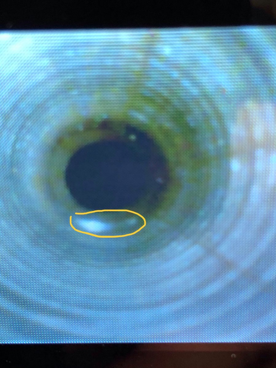

  8. 230049C6-69C1-4A13-A478-411E74348455.jpeg The next pic is the hole for the return line from the filter .
    I shifted in inboard,,(toward the front ),,,about .050 thousandths just to be safe and leave plenty of meat around the casting .
    I marked it in red to show where I shifted the hole.
    The hole was gonna be larger than the transfer p***age anyway,,,,so I blended it all together to make it match .
    It turned out very well .
  9. I finished these holes by drilling them all to .575 and tapping to 3/8 pipe .
    Again,,,I blended all p***ages in the direction of flow,,,,to aid the flow of the oil to and from the filter .
    Tommy

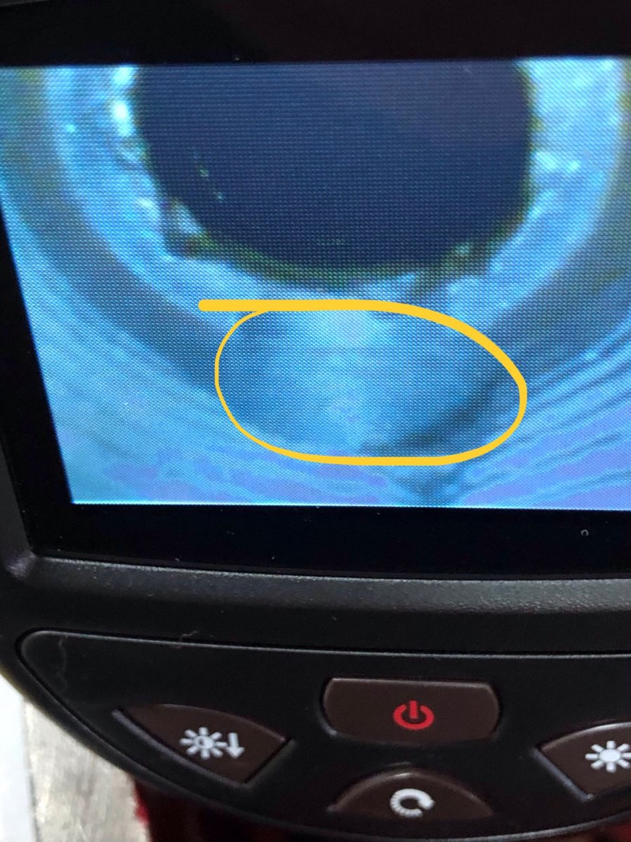

  10. A44219C1-C920-4A2E-8325-88F4206888E9.jpeg ECD03D07-F7FC-4BF4-A617-C58F7897867E.jpeg 12DE80DD-E96A-4254-BDAC-74519C89DAA4.jpeg I opened the feed hole for the rear main to 5/16 .
    The rear main has its own dedicated oil p***age,,,and receives oil directly from the pump.
    Since the main bearing is 2 inches wide and 2.5 inches diameter,,,I felt it needed all the volume it can get,,also,,,it feeds the two rod bearings at the back .
    I then relieved the transfer slot and added a radius to aid the oil flow to the bearing .
    One pic also shows where the oil p***age is located in the block directly beside the oil pump.
    I had read where it said to open it to 3/8,,,,but I felt that 5/16 would do just fine for my use .

  14. If you choose to do this,,,,just take your time,,,drill slowly .
    I would drill about a quarter and then remove it and make certain I was straight,,,then drill another quarter and double check again .
    After about and inch,,I knew I had it aligned well,,and then went further,,,nothing to it .
    Just be careful and take it easy,,mine turned out great .

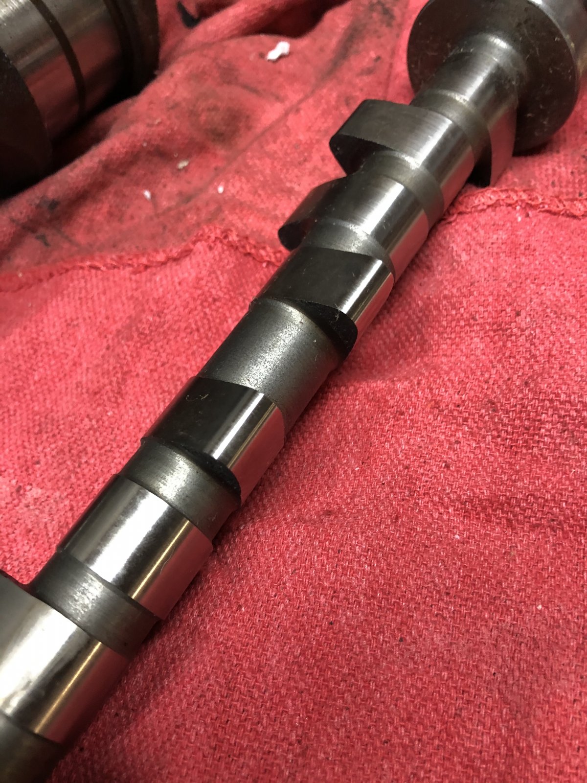

  23. Hi Fellas ,
    It has dawned on me that I haven’t added any pics in a while ,,,,,sorry .
    I went to my library and here is a little progress .
    This is my cam that I received from Pete1,,,,,it is a regrind with a 3/8 Potvin profile that he does .
    It looks awesome and was very reasonable money,,,much cheaper than a new cam .
    He also relief ground the shaft between the lobes,,,it should be a very strong runner.
    Tommy

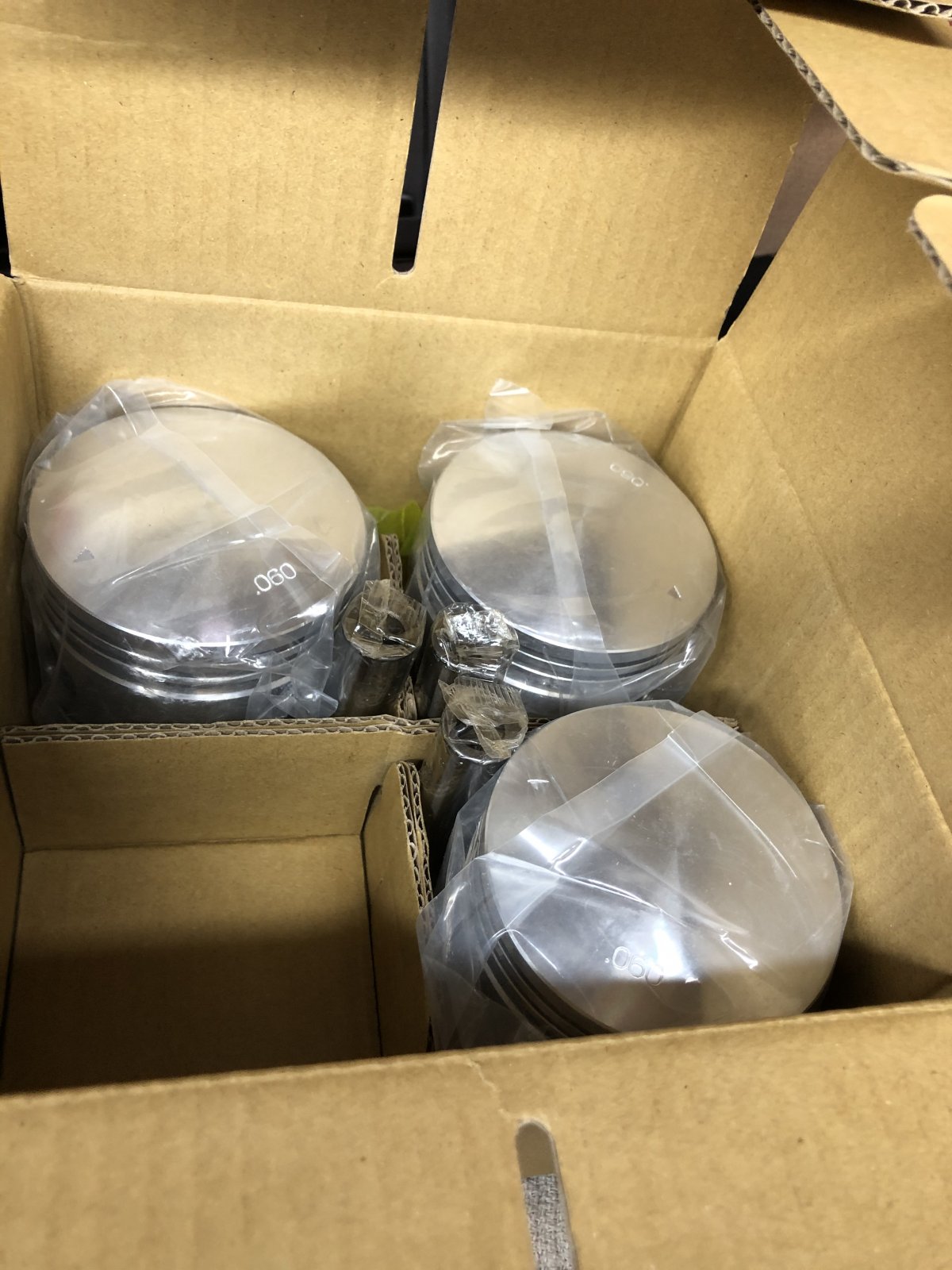

  24. Okay,,,,here are some pics of my pistons I received a few weeks ago .
    I was going to go with Ross forged pistons,,,,,they are excellent,,,,,but I had a change of plan .
    After some careful soul searching , and coming to the realization that I am not made of money,,,,I decided to be realistic on my goals .
    My engine will be a nice hot street engine,,,not a racing mill .
    The top HP might hit 200,,,,I’m hoping,,,but probably a few short of that ?
    So I decided to go with Egge cast pistons,,,.060 over ,,,,the pistons and rings were less than $300 total.
    They are an excellent piston,,,,made in America,,,,and will hold up to more power than I will ever apply to them .
    So,,,I saved about 200 bucks and am really pleased with my purchase!
    They are 4 ring pistons,,,weigh just a few grams less than stock,,,,,and I plan on using just 3 rings and not the fourth one .
    I had decided to go just .060 ,,,,instead of .125,,,,,to save the bores a little bit ,,,who knows ?
    Anyway,,,I am very excited about the quality and appearance of the Egge pistons,,,,I think I made a good decision.
    Tommy

  25. Cliff Ramsdell
    Joined: Dec 27, 2004
    Posts: 1,382
    Cliff Ramsdell
    Tommy,
    Nice to see you posting again. What are the specs on the camshaft and is this something he’s doing these days? My 276” could use something a bit hotter.
    Cliff Ramsdell
    Desoto291Hemi likes this.
  26. Hi Cliff ,
    My grind is a 3/8 Potvin profile,,,,,the lift is .375,,,,,that’s where they get the 3/8 designation.
    I can’t remember the duration off hand,,,I have the card downstairs,,,,,,I will try to look it up .
    Yes,,,,Pete1,,,in Washington,,, does this work,,,,,and it’s excellent work .
    He can give you as much as your engine can handle .
    I sent him a PM,,,,,,I gave him my engine plan details and what I was going to use it for and he recommended this profile .
    I’m very pleased with it .
    Tommy
    Cliff Ramsdell likes this.
