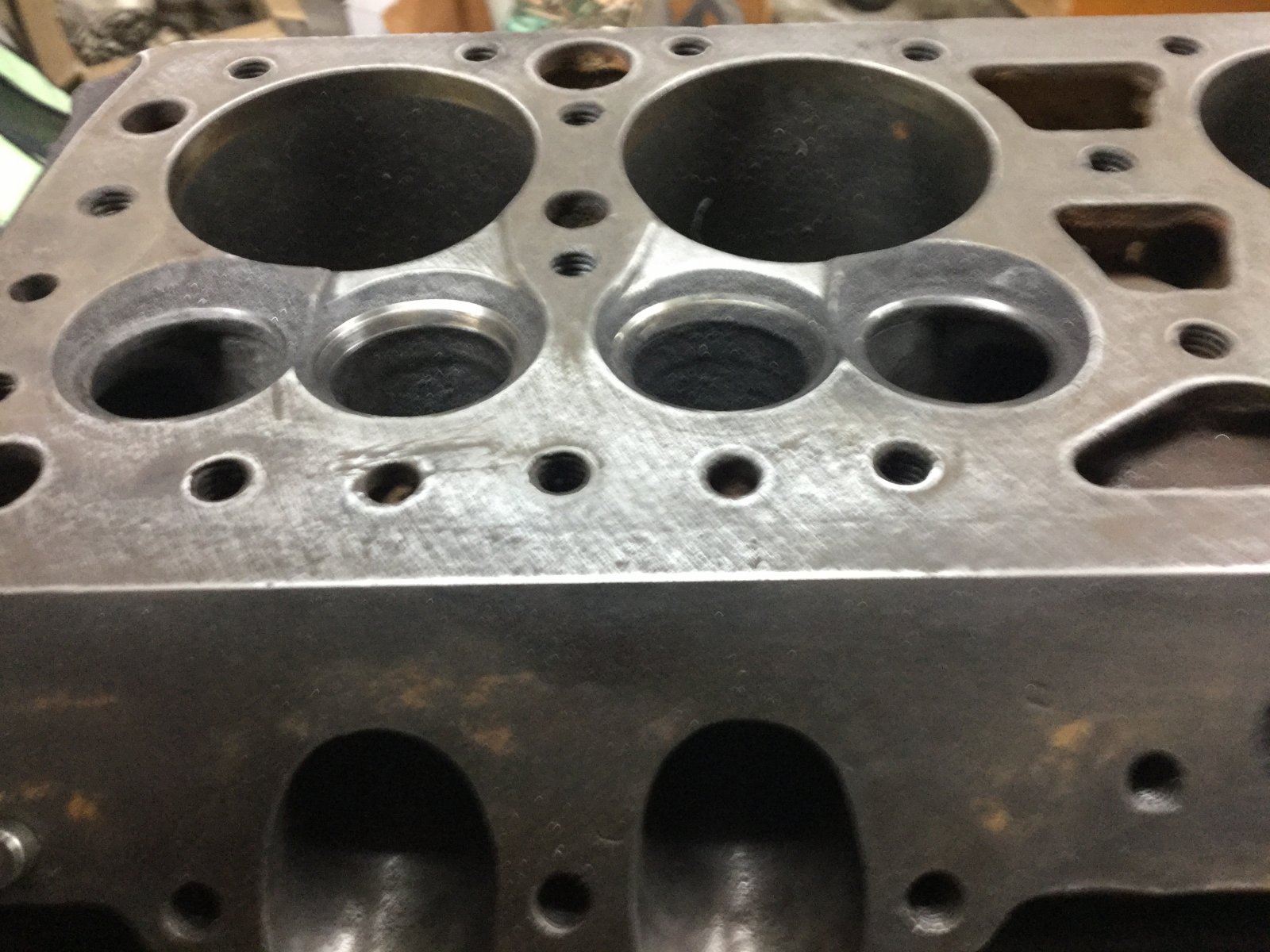

    This is the motor:
    First question: it looks like one of the studs around cylinder #4 is broken. How will this run considering? Do I need to fix this before I fire it up, or can it wait?
    Second question: this relates to the two green pulleys driven from the crankshaft: my understanding is that the inner one drives the water pumps and generator. What does the second, outer, one drive?

    One thing; I wouldn't run it until I had the head stud problem corrected. (And check every thing else out carefully, as a broken stud is not a good sign.)

    I see that you have a combination of studs and (probably) later 8BA head bolts. Is the stud just missing or broken off in the block?
    I will say that the mixture of studs and bolts along with the missing stud don't instill a lot of confidence in the person who put it together to me. I believe that at least a partial disassembly and good check over is in order.

    I shined a flashlight into the hole today and I didn't see any threads. It looked liked a broken stud.
    Should I remove the heads and inspect + try to drill out the broken stud?
  7. tubman
    Joined: May 16, 2007
    Posts: 7,967
    tubman
    I think the heads should come off to check the stud out and a general inspection. Do you have a welder or access to someone who has? There are better ways of removing broken studs than drilling and (not so) E-Z-Outs.

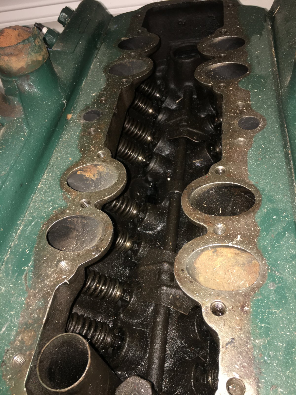

    It looks like the manifold is just sitting on the block, held down only by the strap. It should be a simple matter to remove that too and get a gander at what's in there. If it has adjustable lifters, that would be nice to know, as well as the general condition and cleanliness.

    @tubman, I have a Miller 140 MIG unit, open to tips/tricks on how to use it to extract the stud. Here are images of the intake well. The motor has adjustable lifters. I will need to blow off and clear off the verdigris. IMG-0826.JPG IMG-0827.JPG

    Basically, best method of removing broken studs and bolts is to weld a washer on, then weld a bolt on and rattle gun it out when it cools. Here's one of many links to the process : http://www.fordgarage.com/pages/studremoval.htm. A search will provide many more. A MIG welder will work for this process; just be careful.
    The heat "shocks" the bond between the stud and the block, breaking it loose. Most stud extractors (E-Z Outs) are made of very hard (brittle) steel, and if one breaks off in the stud, you have a real problem.
    In my opinion, the condition of the engine valley indicates that that is not a fresh rebuild. I have to agree with "leon bee" that a complete teardown is the best way to go. Does the engine even turn over?

    I'm anxious that if I start pulling off heads and breaking studs that I'll get in over my head. What if I go ahead and complete the build and check compression, verify oil pressure, etc and try it out first?

  20. Here is my 2 cents worth: flat heads are notorious for having stuck/frozen studs. You may want to pull the heads and fix any that are frozen with new ones and use anti seize. Also, I am working on a y block now and was hoping to get away with just a refresh and stuff-nope. If I would have fired her up I would have had to pull the engine back out for bad cam bearings, namely the center one that supplies oil to the heads. Since the engine is out and you have easy access to it now you may want to check it over. This way you do not risk damaging anything getting it out after you build the car. Just my thoughts and nice looking 64/65 bug.

    If it looks like the stud is broken at or below the deck surface, get yourself a drill bushing that slides into the head hole and allows you to drill straight through the broken stud. If it's broken above the deck, then try the "weld a nut on" thing.

    Well your gonna have to fix that stud. If it were me id start it up. If it burns oil like a freight train then your definately tearing it down. If it runs ok then pull the heads, adress that broken stud and the other ones you break and reseal it. Can always get crazy with it later.

    Flatheads are also notorious for cracked blocks. Take the heads off and inspect. It may have run when crated but perhaps not well.

  26. If it has been sitting, like it looks to have been - I'd not start it.
    It looks like it may have had water down at least one intake port - so guess what the cylinder walls probably look like? Also, it was probably ran with non-detergent oil - so the pan may be full of a bunch of gooey shit, dirt and other stuff. You really can't clean the valley without a bunch of crap engine up in the pan . . . so the problem is now even worse.
    So, if you start it . . . guess where all that crap ends up? Well, it gets pumped through the bearings . . . and if they are good, now they are not. When you have an engine out of a car - especially one that has a bit of "sketchy" work done to it (bolts, studs, broken stud, etc) - then pull the engine down and mic and inspect everything. If you're lucky, might only cost you a gasket set to get a "runner" out of it . . . so why gamble.

    I would not run that engine until I cleaned all of the crud out of it. If there is sludge in it, and it looks like it does, it may have a crack somewhere. Pull the pan and get all of that crap out of it. Lots of diesel fuel and an assortment of brushes combined with plenty of elbow grease. When it's nice and clean inside start looking for cracks around the valve seats, across the pan rails, in the valley and cylinder walls. One thing that can cause problems when starting one of these that has been sitting a long time is flakes of carbon and dirt in the crankshaft oil passages. It likes to come loose and tear up the crank and rod bearings after sitting for long periods. Check to see which engine you really have. There are two in the 59 series. 59A has 2 inch rod journals and the 59AB has larger journals. Don't remember the exact diameter off the top of my head. 59A has a 3 1/16 cylinder bore and the 59AB is 3 3/16. The intake valves on your engine have relieved ports. If original it would likely be a 59AB truck or bus engine. The heads on those have a lower compression ratio so you might take that into consideration.
    You can buy a kit from Macs auto parts to get the broken stud out safely. It has a drill guide bushing to insert in the head and should include the proper drill bit. You then can drill and tap the hole for a threaded insert to bring it back to the proper size. Be sure the head is bolted down securely before you use this kit. Personally, I would at least grind the valves while the heads and manifold are off. Be advised these engines have pretty low oil pressure, which is normal. 30+ pounds cold is okay. There is more to consider but this will keep you busy for a while.
