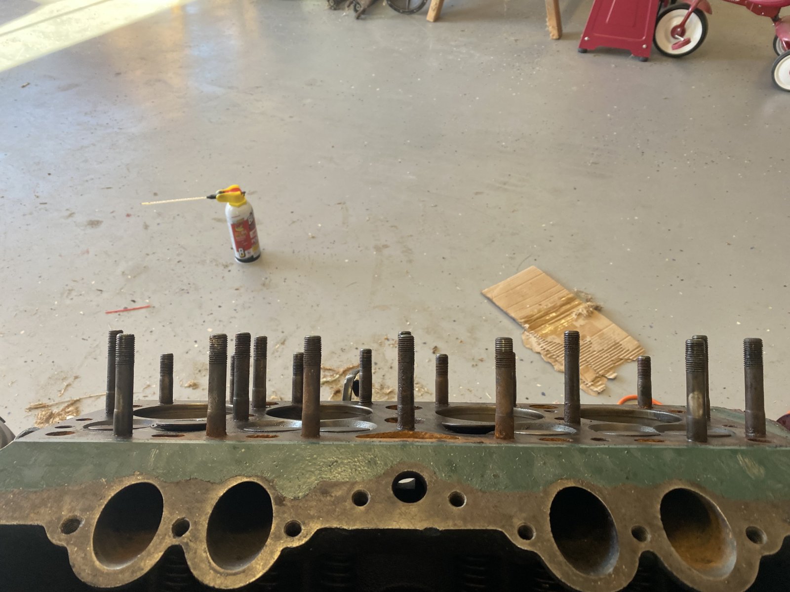

    Roger on the stud. I was going to follow the guidance in this motor trend article.
    Should I go ahead and remove all the studs and replace with new ones? Here is a pic of the mismatch going on: IMG-4782.jpg

    Two things you should know before you start. First, stud kits are expensive (if you want to, you can spend $500). Second, if you decide to remove the existing studs, you will probably break off several more. I believe this needs to be evaluated to a greater degree. Pull the pan and check for sludge and general condition; pull a couple of bearing caps and use "Plasti-Gage" to check clearance on a couple of bearings (make sure to scrupulously clean the bottom end before doing this). If things are "iffy", a rebuild is probably in order, at which time the studs should probably be replaced. If it turns out to be in usable condition, I would check the studs carefully, and replace the broken one and any that appear suspect. You should be able to find enough individual studs (used would work) to replace those and the bolts that were used. Clean everything, ****on it up with a new gasket set, and see what you have. One note of caution : contrary to what that article says, do not use a regular tap to "clean out" the bolt holes in the block. Ford used a special thread specification for these and a regular tap will alter it. Rather, use an existing Ford stud with grooves files or cut into it in an effort to preserve any of the Ford threads that are still there; you will have a lot less leaks that way.
    In my opinion, this is not a fresh rebuild, but a used engine that has been messed with by someone of less than stellar ability, which adds even more questions. Ideally, it should be torn down, the blocked thoroughly crack checked, and then rebuilt. However, I have been through this several times over the last 60 years, and have built my share of "patched together" flatheads, and all turned out to be successful endeavors some extent. A hone and re-ring may also be in order depending on existing piston, ring, and cylinder condition. If done carefully, you can end up with a good running engine at a minimal cost. At this point, it is your choice.

    One area I would be concerned about is the condition and mismatch of studs. I know they can get spendy, but I would sure consider replacing them... you don't want to risk breaking more when you re***emble your pride and joy. I'm not familiar with who the various suppliers of flathead studs are, but I've seen pictures here and elsewhere of some pretty low quality repops. On any replacements you may get, check the threads carefully... look for rolled, NOT cut threads, and compare the fit in the Ford tapped hole to insure proper grip and seal. And don't forget to seal the threads where needed. And, as noted above... DO NOT use a standard tap to clean out the holes!! Use an old stud, or a thread chasing tap IF you can find out what thread cl*** Ford used (thread cl***es specify the size, tolerance and fit of threaded fasteners, and there are several cl***es).

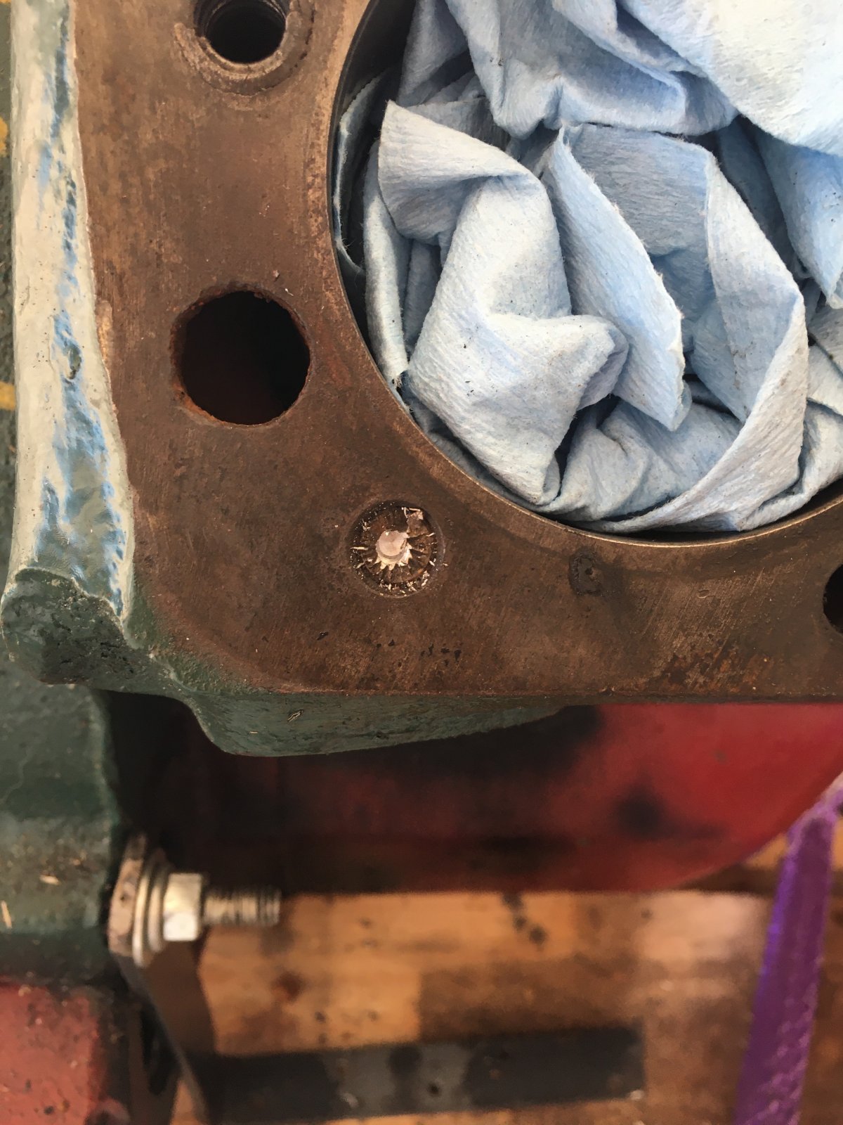

    I worked on removing that stud this weekend, with mixed results.
    The stud is out, but about the top 30% of the threads were damaged in the process. I followed the MotorTrend article linked above and I can say that the 3/8 bit is too big. I wouldn't go larger than 11/32.
    When I thread a 7/16-14 bolt into the hole it threads in fine but there is some play. I'm wondering: play in the threads is not ideal, but will Permatex on the stud result in a satisfactory outcome? Do I need to go ahead and do a time-sert?

    Thinking I will do a time-set insert for this stud. Does anyone have a leftover/throw away 59ab head they're willing to part with? I plan to ream out the corresponding stud hole to 1/2" and use it as a drill guide and guide for the tapping step.

  10. What’s wrong with just a heli coil ?
    It’s only one,,,,and it should hold fine .
    Tommy

    I’m not familiar with heli coil. Easier to install? Could you point me to a good source.
    btw, just ran an ARP chaser through the hole and threading a bolt in seems to be tighter.
  12. Heli coils are available at just about any local parts store .
    If they don’t stock your size at the moment,,,,,order,,,,,have them the next day .
    Tommy
  13. I wouldn't waste a head on making a drill guide.... Just use a length 1 inch cold rolled steel, pick an adjacent hole to bolt it to, drill your pilot hole and the stud hole (keep it a close fit to the stud siz, bolt it on.... and Bob's yer Uncle...
