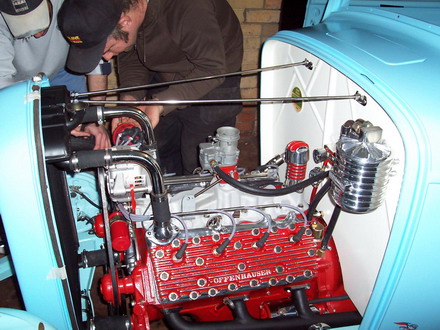

  10. Baron...Im running a full flow filter sonversion as well, and have the Hidebrandt cover mounted on the firewall like.
    The oil lines are high pressure designed for the job and the fittings I used make it almost impossible for the lines to come off. So I hope I dont have to go thru any **** like you did.
    Mind you, theres only 50 psi or so going thru the lines so we should be OK !!
    Rat
  11. Heres a pic of Loquire and me dialling in the dissy. You can see the remote oil filter set up with the oil lines...
    Rat

    Damn man, that thing looks good enough to eat! Sahweet.............
  13. Sweet... much purdier than my setup.
    Have you taken it for a spin yet? It's ******* down up here and I'm hanging to take my car out.
