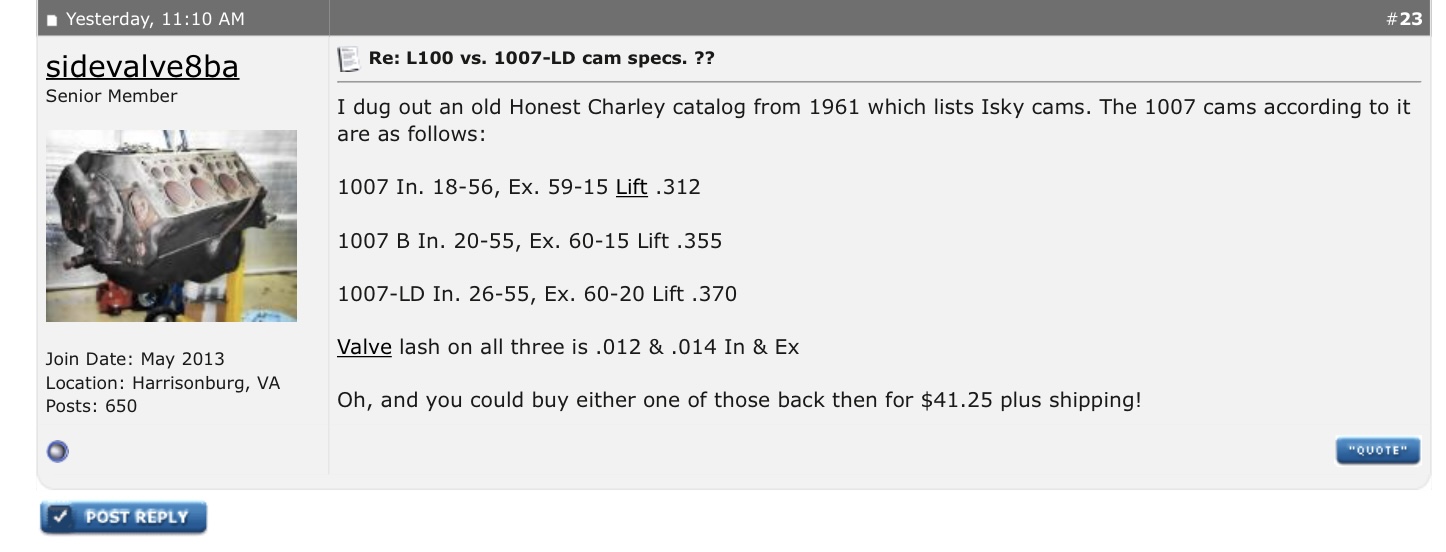

  29. Ziggster
    Joined: Aug 27, 2018
    Posts: 2,951
    Ziggster
    I have the 1007B grind from Pete as well. Still haven’t fired it up yet, but came across this screen shot I found in my Flathead album.

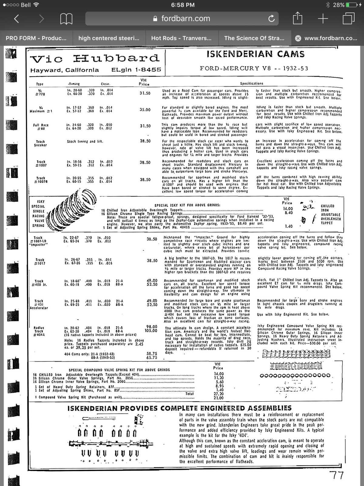

  30. Ziggster
    Posts: 2,951
    Ziggster
    More info I found in my album. Lol!
