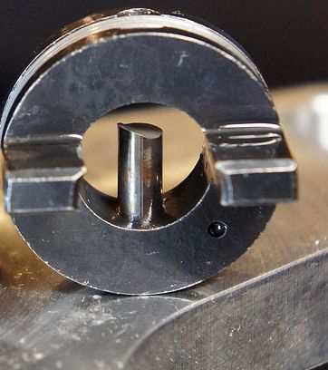

  5. Petejoe
    Joined: Nov 27, 2002
    Posts: 12,544
    Petejoe
    from Zoar, Ohio
    Thank you Bruce. You know, now that you brought that up. I do remember reading about this.
    Boy am I glad you have a mind like a steel trap. Thanks for adding your info for future generations.
    On the MSD distributors the (cam) contact end is removable and made of steel. I plan to either remake the snout or extend it to reach the cam face.
    Rick
