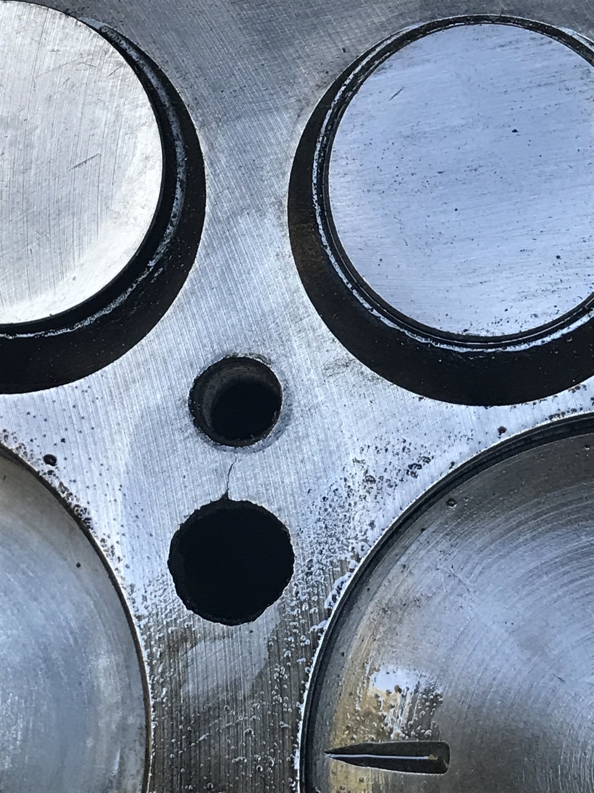

    Thanks Glenn, I agree on the lifters for sure, but was thinking maybe I could avoid a full tear down. The cylinders piston fit seems fine, I have oil in the cylinders and so that may reflect in the photos. The crack is between cylinders 7 and 8:

    Yup, factory crack right there!

    Common crack. Both the crack, bolt and the water p***age go into the water, so this crack is not a problem. Be sure to use a sealant on all the bolt threads. All but a couple of them go into the water jacket. Teflon pipe dope or plain old plumbers pipe dope work just fine. Just don't over tighten the head bolts. Do not use Teflon tape. Put a dab of gasket goo over the crack before installing the gasket. You'll be good to go. :)
