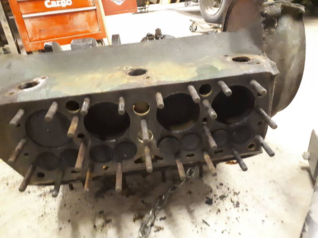

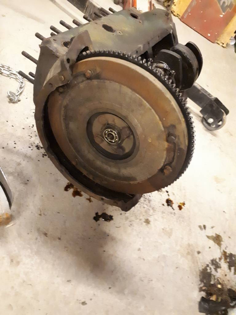

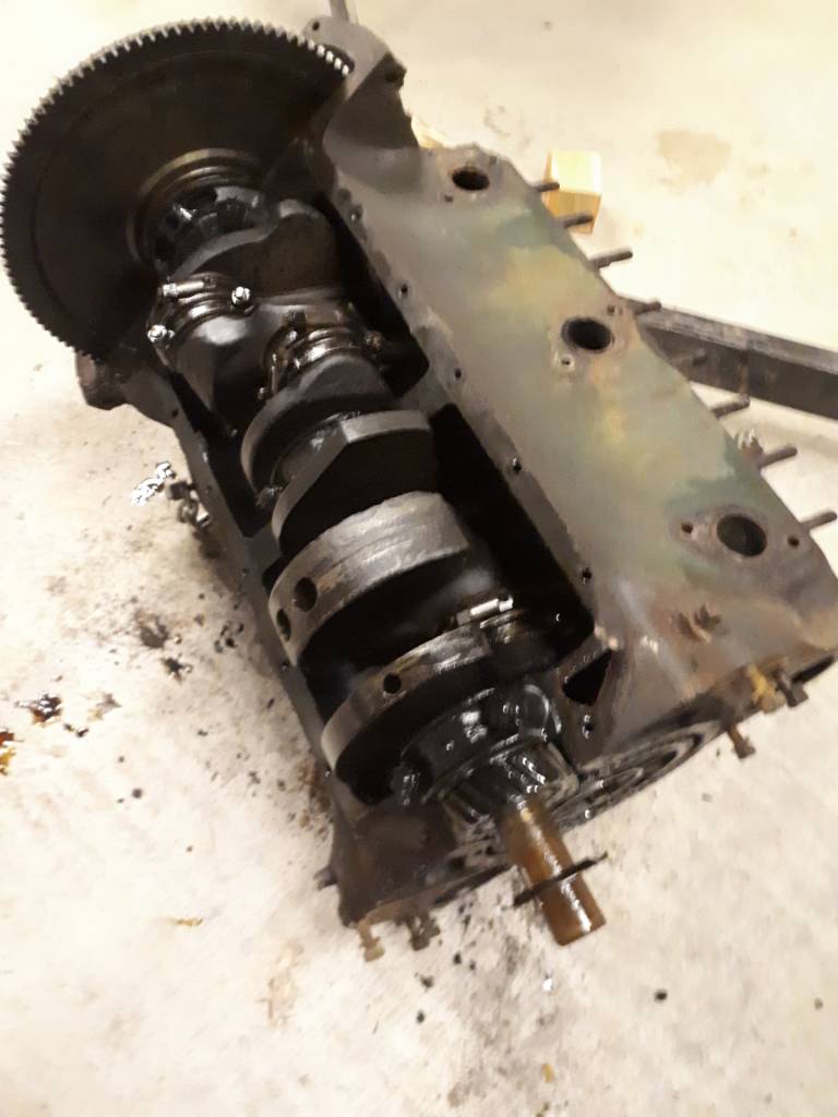

    So, been tearing into the flathead this afternoon. 59AB lump. All seems pretty good so far. Got me thinking about how to wake it up a little. Deuce carbs and a mild cam with a little porting work is what I'm thinking ? What cam would you guys recommend for street use with the odd trip to the strip? 20180819_140638.jpeg 20180819_140647.jpeg 20180819_140656.jpeg
