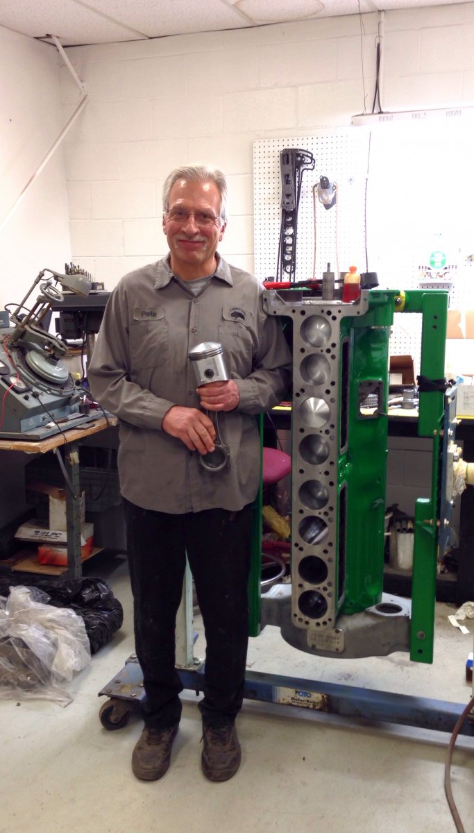

  27. Pete F
    Joined: Feb 12, 2017
    Posts: 40
    Pete F
    That's a good question
    For some reason I thought he was being conservative in the grind.
    And with no experience with flatheads I have read tons of blogs and everyone's opinion as to what works is all over the board so I questioned the combo.
    If you came to me with an overhead valve engine I could give you my opinion from experience but since I never build one of these crazy flatheads I looked to read as much as I could and man nobody agrees on to much.
    Hey I was only asking to learn not trying to cause any confusion.
    And one last thing this my site ,I build anything from race engines to Duesenberg engines so it's not like I'm trying to BS anybody just trying to gather info.
    Thanks again
