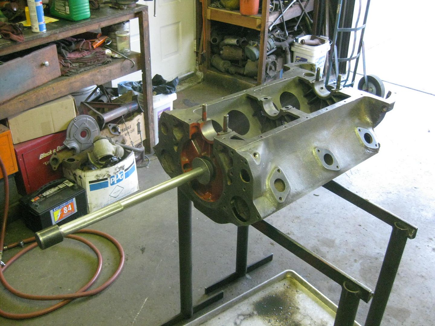

    OK, on to other things, heres a sneak peek. I went to my Dads tonight as he is helping me get this thing together. My Dad has built hundreds (if not thousands) of flatheads over the years. He is a true master! He machined it a while back, and we cleaned it up, got the lifter valley and timing srea coated and the cam bearings in. That was all I had time for tonight, hope to get back on it later this week.

    the new block looks beautiful,
