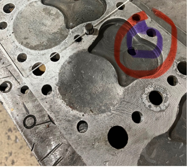

    I’m taking about the pointed protrusion or lack of one circled in purple compared to the one I originally posted circled in red. The key to any combustion process using a liquid fuel and air is to atomize the fuel with air as much as possible and to ensure the fuel/air mixture is mixed evenly. To accomplish this you need maximum turbulence.
