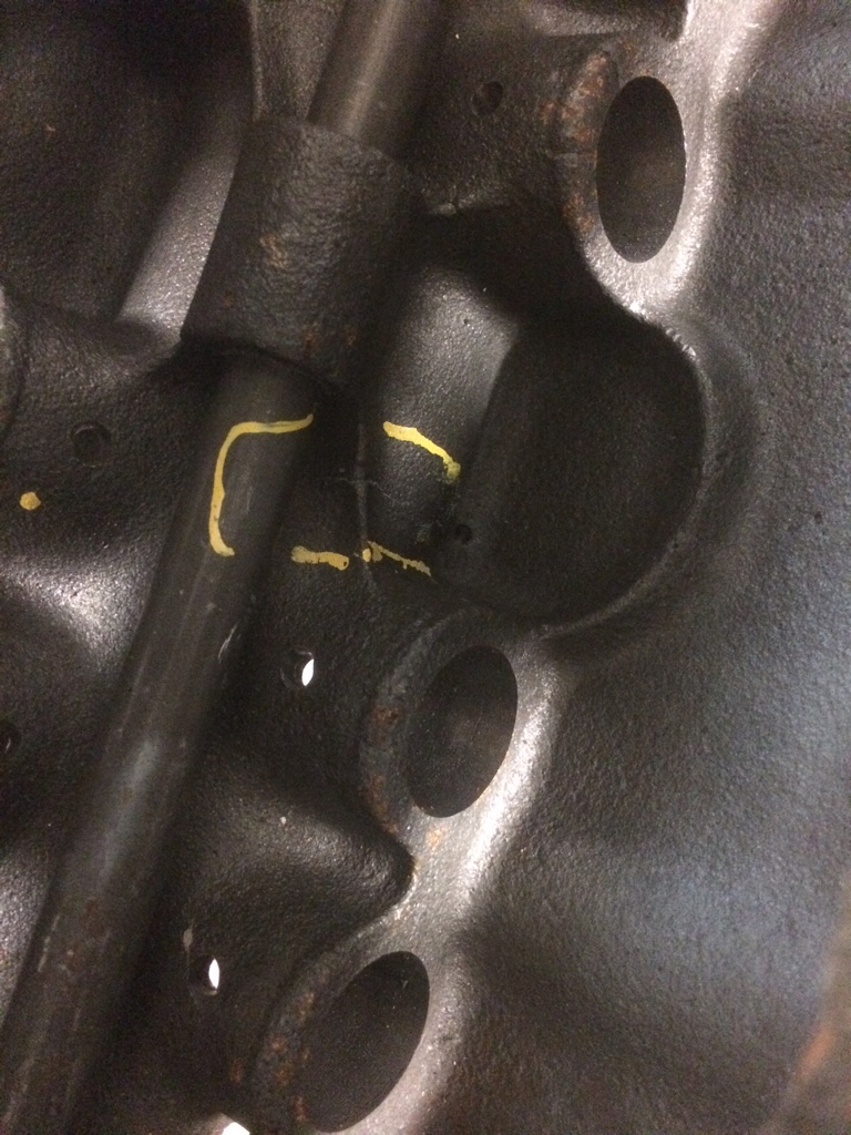

    I picked up this 8BA block at an estate sale a while back for $100. It had just come back from the machine shop after being cleaned up and having new cam bearings installed. The block is marked “v. Good” but then I noticed this crack in the lifter valley...
    Recommend repair? Or is this something that you forget about and run anyways?
    I appreciate any advice from the flathead experts out there

    That can be drilled and plugged...
    Maybe...????

    I'd have the block magnafluxed and see what turns up. If that is the only crack and it's not near anything vital, I'd run it.

    Drill both ends for the crack to keep it from growing It doesn't look like the holes will hit water or oil.

    Agree, small holes on each end, dremel a groove between the two, clean and clean again, blow w air, fill with metalized epoxy

    I would take it to a shop. Like RMR said, have them magnaflux the block. Let them determine if it can be pinned or machined for you.

    I believe it was magnafluxed. They've marked this one crack in the valley, and those two typical cracks between the water jacket and bolt hole, that's all I can see. I'm guessing the shop didn't see a major problem, or they wouldn't have changed the cam bearings, but who knows?

    That's a weird place for a crack. Maybe a weak spot in the casting? Is it close to a cam bearing?

    It’s a couple inches away from the center cam bearing, but it is not visible from the bottom. I was thinking casting as well?

    I'd run it.

    This is the cl***ic case of making a mountain out of a molehill , remember these flatheads are the most forgiving engine ever made. example, when Andy Granitelli ran Indy with his Grancor Spl. there was a rule that you could use so much oil and that was it, when he used up that said amount his pit crew filled the crankcase with soapy water to finish the race. google it and you will get the full story. Now you know where I stand and I say run it !
  16. Saw an exact same crack in the same spot in the valley allow water into an 8BA for a milkshake. Get it pinned and loc***e seal the water jackets to seal it up good.

    Any reason why it couldn't be welded?

    Braised wud be the way....or like i previously said, drill, light grind, epoxy

    Someone may have marked those indications for a closer look. If you took it to a shop that does mag particle they could tell you whether they are relevant or non relevant in a couple minutes. Relevant being cracked & non relevant is surface. If the block has been cleaned then you could buy a liquid penetrant inspection kit and follow the instructions to do it yourself. If the dye test has a slight color bleed into the developer then it is surface. If it is a crack then it will be a strong color bleed into the developer.

    Do a water pressure test on it, if it weeps have it repaired before you ***emble it.

    An old logger I worked for told me in the old days the rebuilders wouldn't take a flathead back as a core if it had any cracks whatsoever. Over time they had to be a bit less picky as they couldn't get any perfect cores.
    He said the shops would accept a crack leading to a stud, but not one between a valve seat and cylinder.
