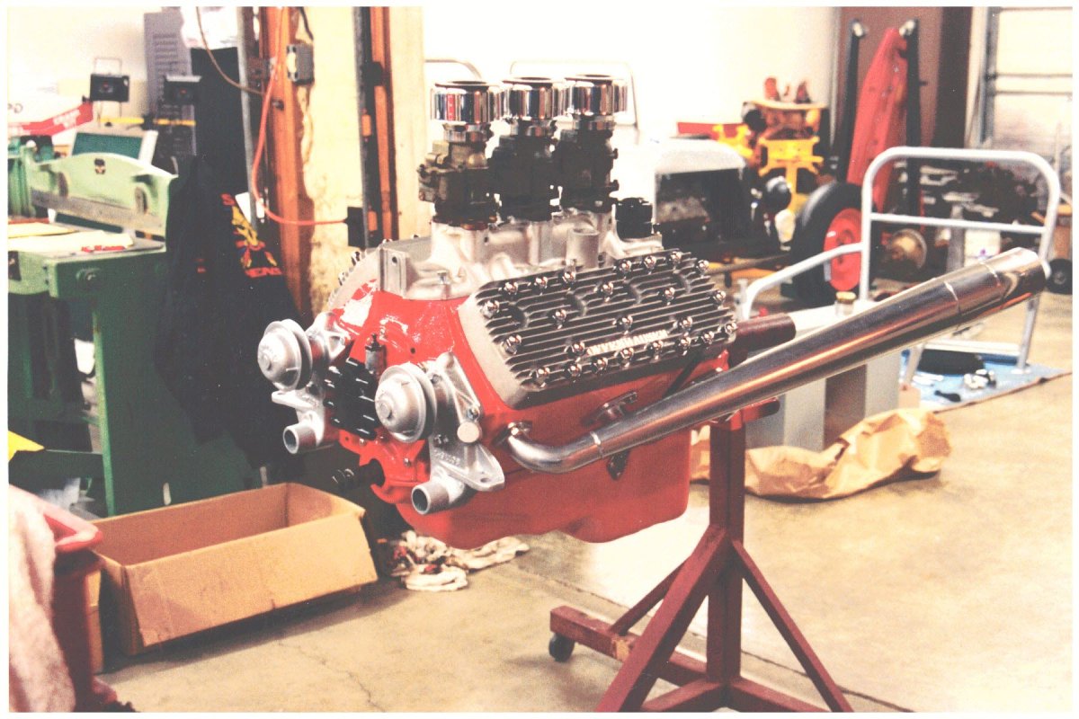

  6. Marty Strode
    Joined: Apr 28, 2011
    Posts: 9,718
    Marty Strode
    I tried to make it work, when I started playing with Flatheads some 22 years ago, without any luck. 2013-04-04 173646.jpg
  7. Frames
    Joined: Apr 24, 2012
    Posts: 5,308
    Frames
    2020-12-05 19.35.19-5.jpg GOODSGUYS   PACKARD 018.JPG 2020-12-05 19.35.19-5.jpg I cut the slinger part off in a lathe. this engine is for a vintage modified roadster drag car. 1/2 " **** stroker. did the same thing to my 27. 2020-12-05 19.35.19-5.jpg
