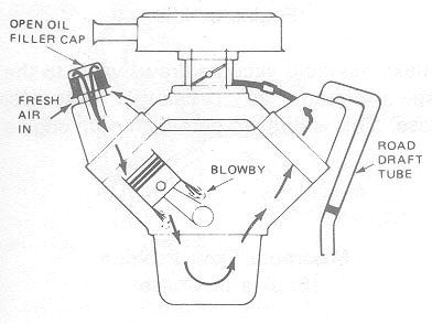

    Usually you replace or modify the road draft tube to run a PCV valve that picks up the crank case air from there and run a breather on the filler neck to let air flow in and through.
    This being a pretty generic PCV diagram it just shows air in, air flowing though picking up fumes and mosture and flowing out through the Pcv.
    The problem with the pcv on the filler tube is you are picking up the air as it flows inthrough the breather cap and it never flows though the engine.
    The mid 60's Corvettes that had the hose running from the car to the filler neck worked in reverse as far as I can figure with a tube running from the old road draft tube to the air cleaner to pick up clean air that flowed though the engine to the hose in the filler neck.

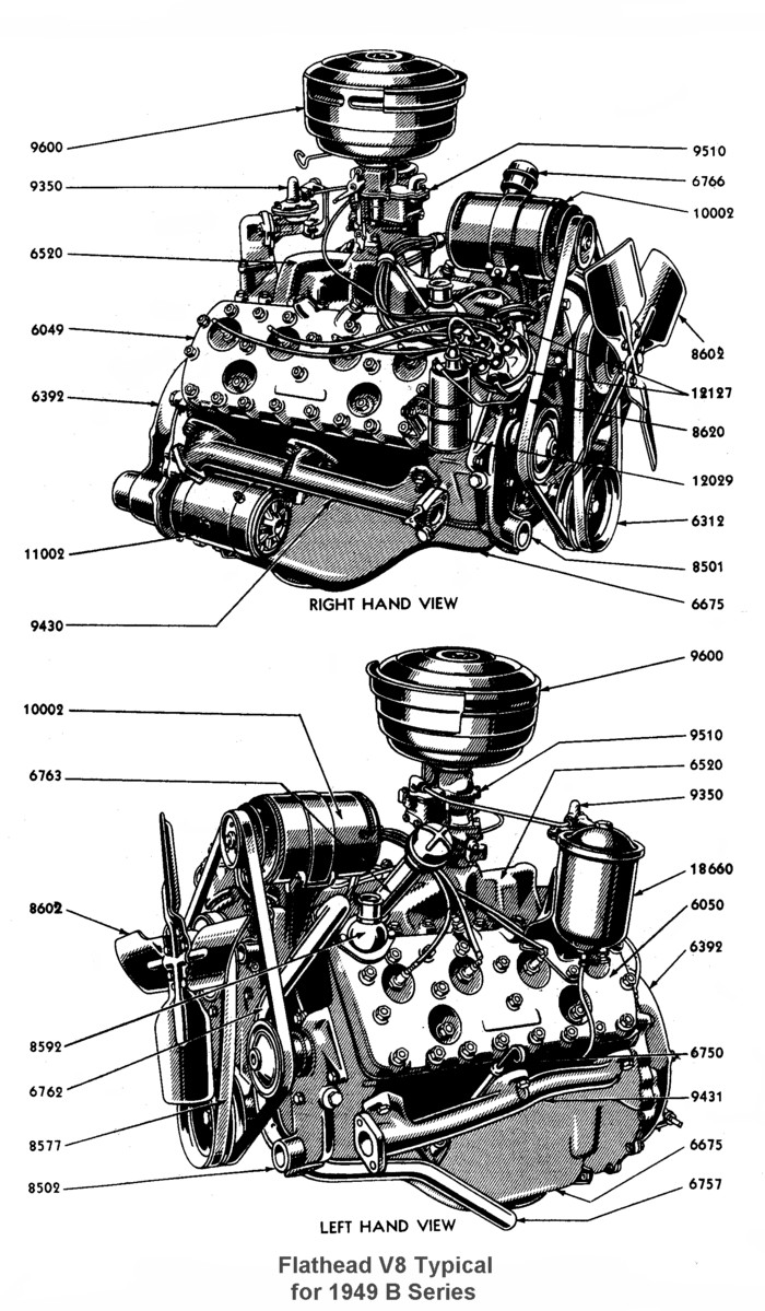

    I wonder what part 6757 is?

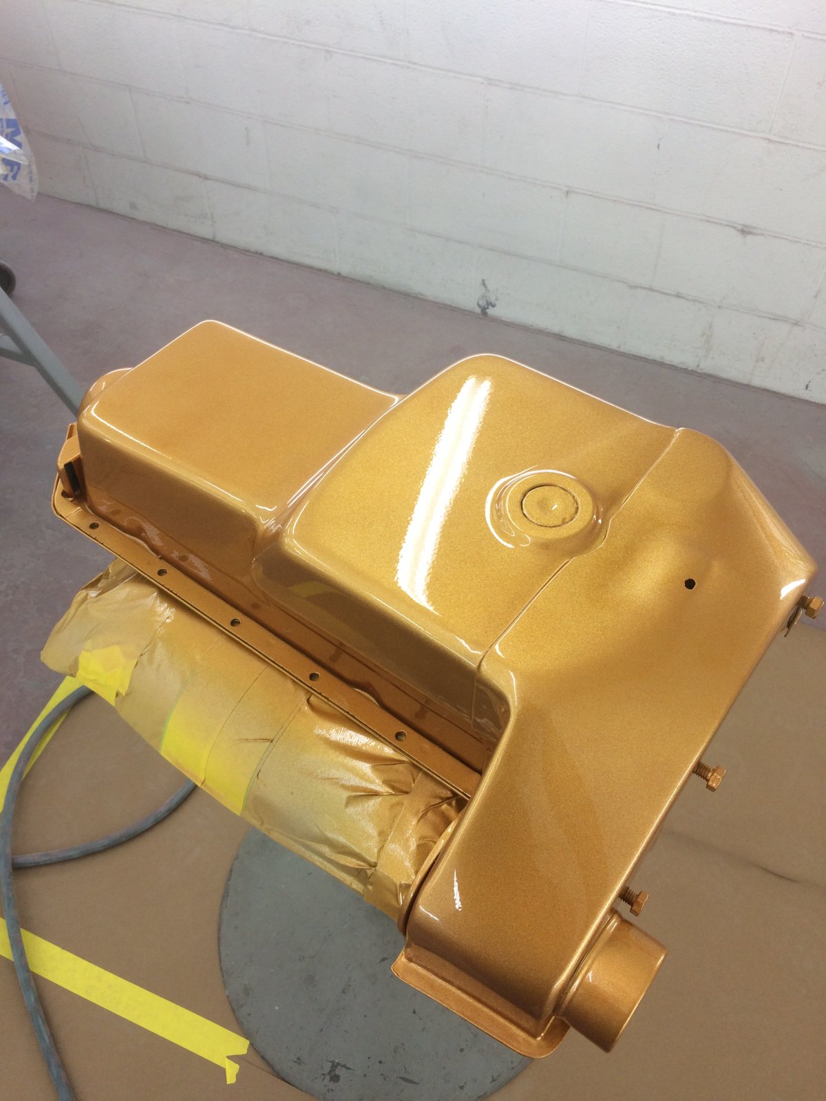

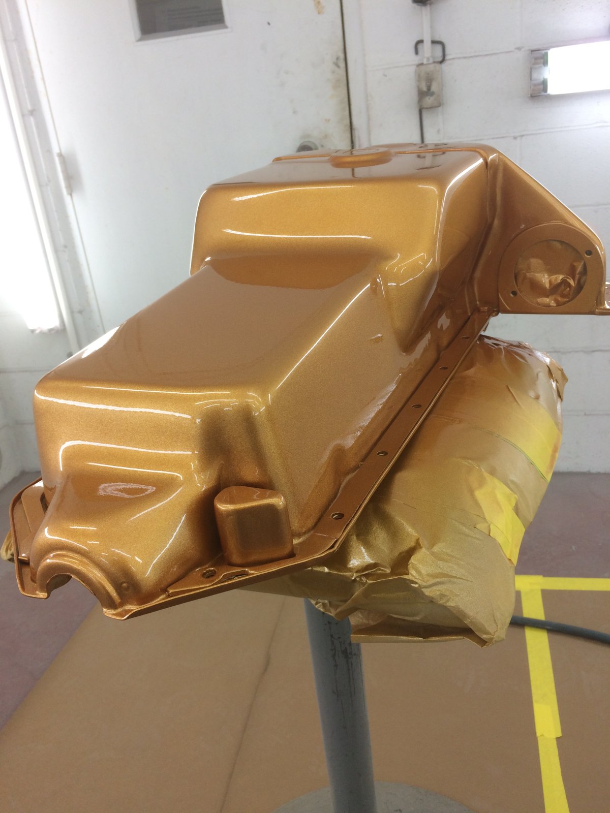

    My 47 oil pan has a vent on the front corner that’s slotted on the back side. It is/was open to the crankcase. (Not now because I welded it up on the pan rail.)I’m going to run a pcv valve of some sort, just not there yet. BE1AABB2-2B11-4550-9671-605E33B83765.jpeg BE00C78E-A5EA-4A35-B837-40B0F5CF2C86.jpeg

    Off topic I know. But, what is the name of the color of paint that you sprayed on the pan?

    It’s called Mayan Gold Metallic. It’s a single stage urethane. I got it from Summit but they quit carrying it. Kirker sells it though, and I’m pretty sure that’s where Summit was getting it. Sorry for the detour, Highlander.

    '35-'48 flathead V8 crankcase ventilation. The outlet is on the lower R/F of the pan.

    I didn't consider the chamber on the rt front of the pan. I wonder how easily that could become a filtered inlet. I have some creative thinking ahead.

    Could you weld shut the outside slot for the original pan outlet, and add your PCV there? I would think that it is already baffled from oil and it would keep the stock direction and concept of crankcase ventilation. If you made up a hard line from valve to manifold, you could make it look at home. You also would close up the "dirty hole" at the bottom of your engine.
    PCV valve
    Blue is fresh air, teal is a filter, yellow is stock air path/oil vapor, red is it going down to exit, Pink is Valve, and green is hard line to manifold vacuum source.

    Why couldn’t you just drill the intake close to this area where the vapor starts down the pipe to exit and then install the pcv valve there, piped to the plenum under the carb? That’s of course if you weld up the open area on top of the pan rail over the top of the vent as I did to seal it off from the outside. Just have to make sure you will clear the generator where your pcv valve goes. 1163F008-D0DE-4D4A-89AD-C6EF7CE6B91F.jpeg

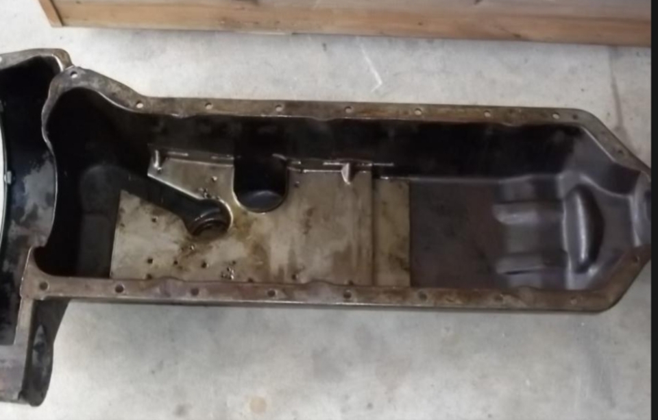

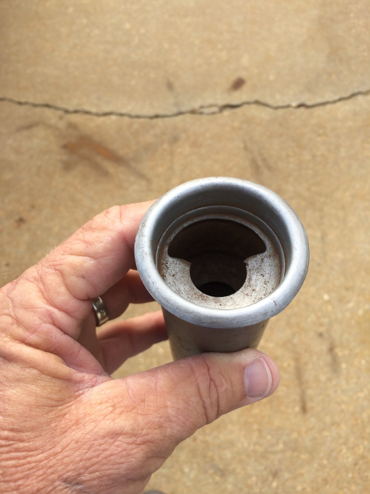

    No such provision on the 1½ flathead (zephyr V-12) oil pan. Explains why the pipe from the valley to the air cleaner is used? Would there be a detriment to reversing the path of case ventilation? Seal the oil cap? Filter the existing vent hole?

    Does the v-12 have a fuel pump stand/oil fill tube on it like the v-8 with this directly underneath it closing off the void between the bottom of the intake and the block? 83752B11-1823-4C2D-AA8B-6777A4EE6B44.jpeg B7058A35-7C36-4FD1-8151-8B71A31A0BDF.jpeg If so, then not having that vent in the pan is of no consequence. If the incoming air goes down through this tube and down into the lower block area, if you install a pcv valve in the front area of the intake, in my way of thinking, it should pull that air back up to it and into the plenum area. I plan to install a baffle of sorts on the bottom side of my intake to shield the pcv valve from pulling in oil spray. Of course, I could be way off base in my way of thinking. My wife thinks so lots of times. :D:D

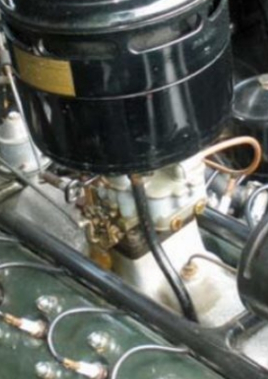

    The Zephyr has a fill tube twice as long, but I actually figure that's for easy oil fill. It doesn't have a baffle like a flatty. Open tube to the bottom of the air cleaner like.pictured above. When I get to the Offy 2 carb I'll add an actual PCV, but because I have an intact ready to go 1 carb gig on it a tube in the air cleaner makes sense. If the Zephyr has it...? If I tube up from the pan vent area I have to seal the existing opening. No big deal. Have a spare pan I can use to make a part, fab a bent tube, blah blah.
