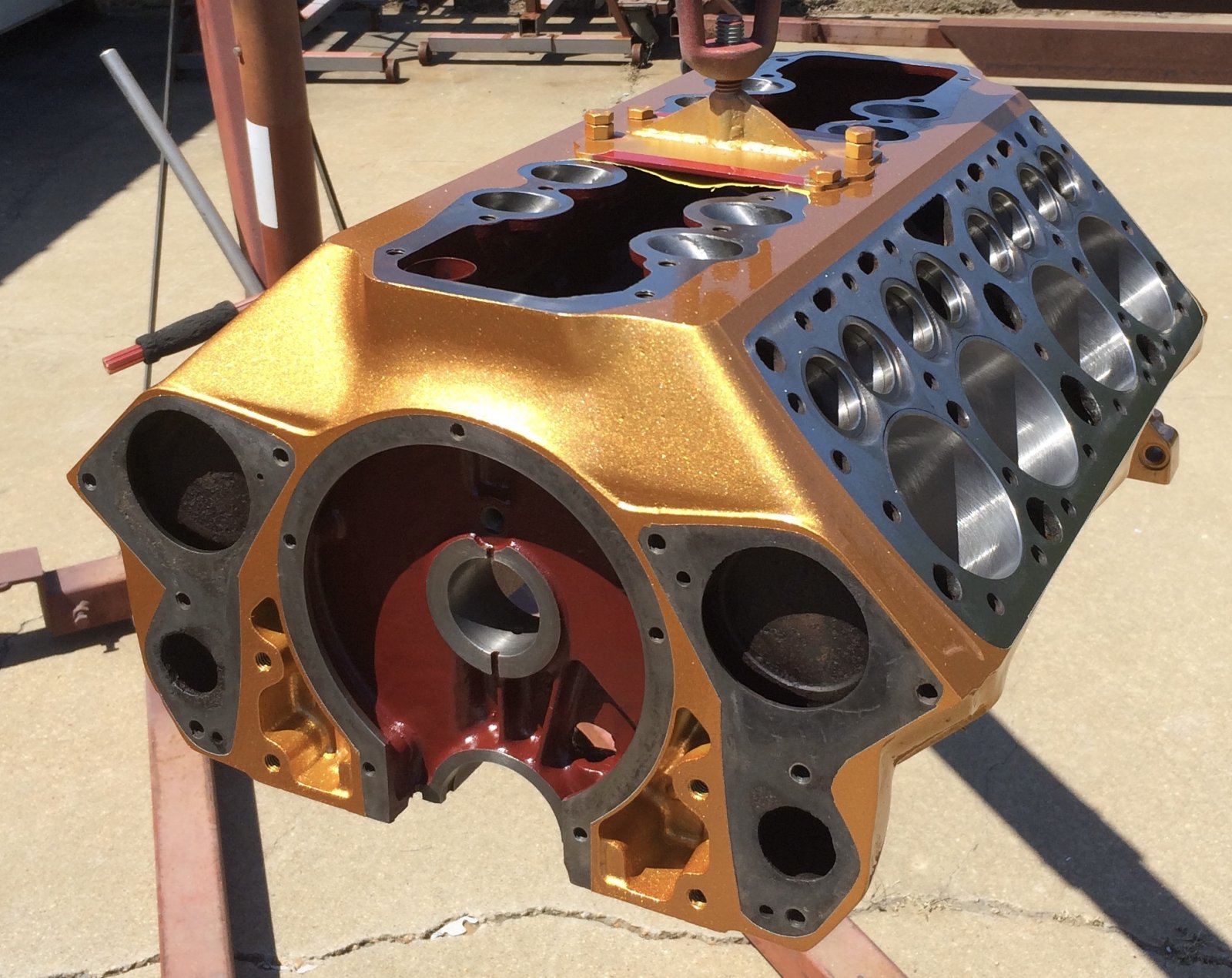

  3. ronzmtrwrx
    Joined: Sep 9, 2008
    Posts: 1,891
    ronzmtrwrx

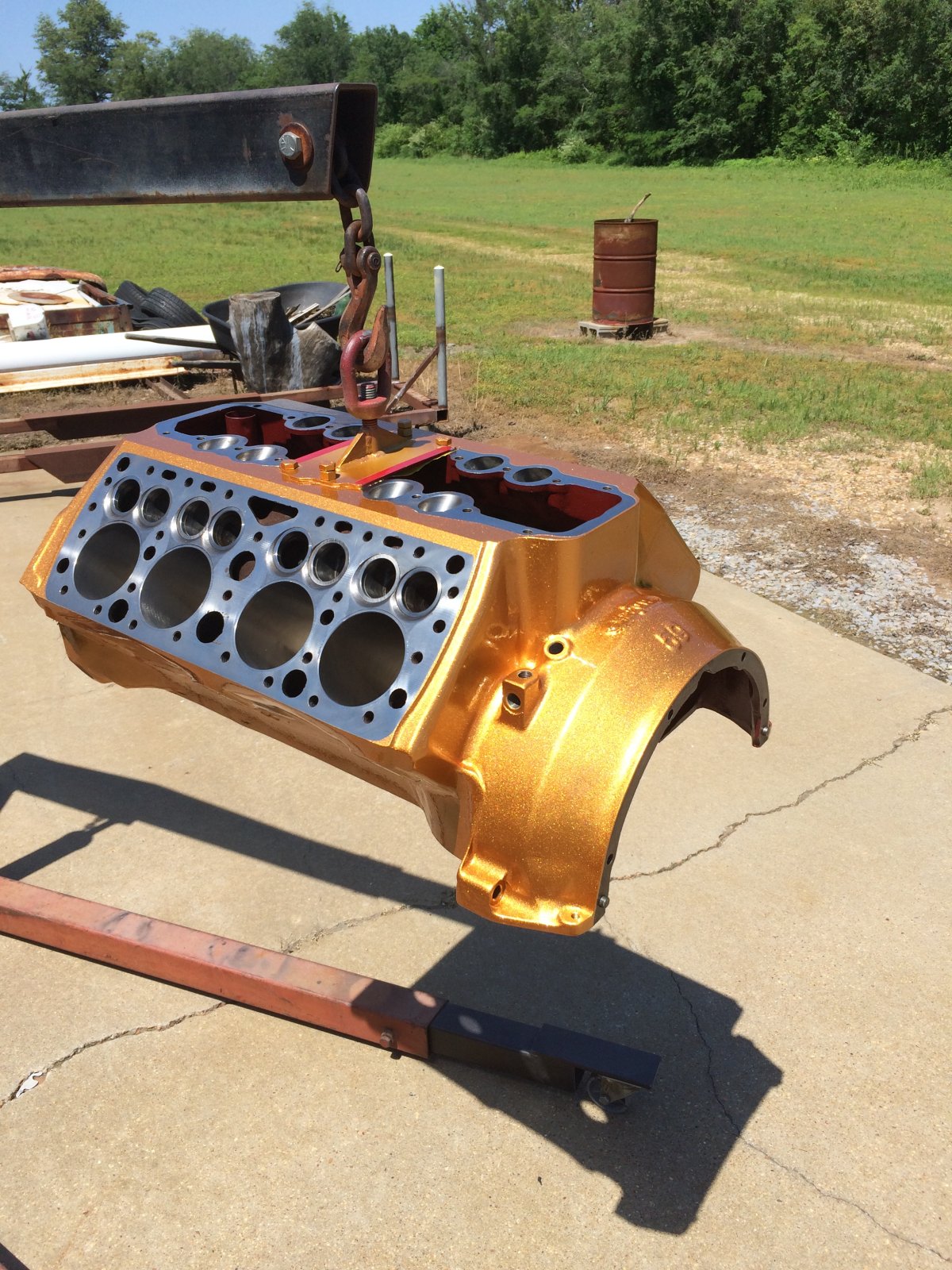

    If you liked the oil pan, you’ll surely like my block: BA6642A2-1F5C-47EC-B305-DC608088C903.jpeg 57F3A476-D882-45C2-9E60-DEB7766FD1E2.jpeg

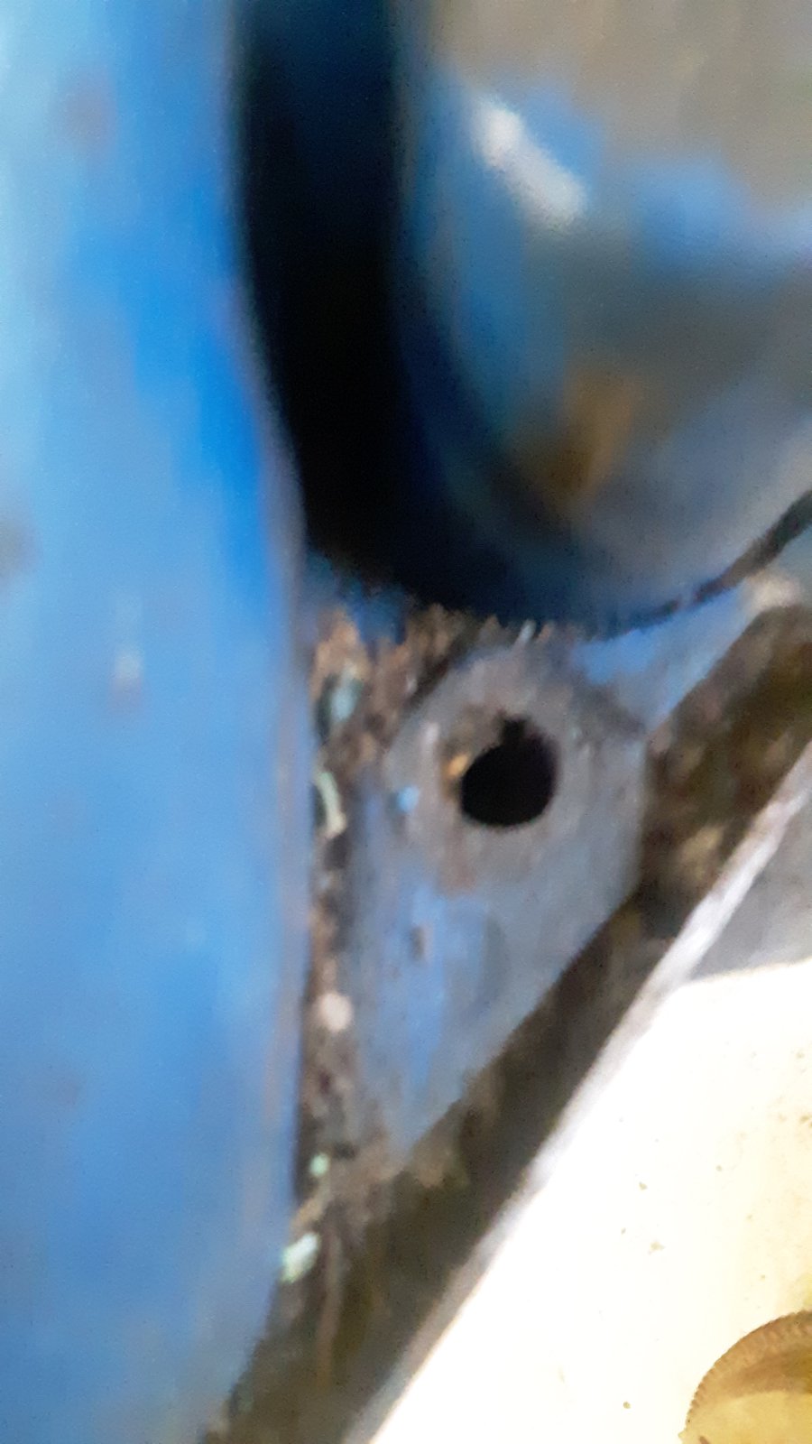

  8. theHIGHLANDER
    Joined: Jun 3, 2005
    Posts: 11,061
    theHIGHLANDER
    This discussion moved this plan in a right direction. Thanks, and yes even for the sarcasm at times. Love that ****.

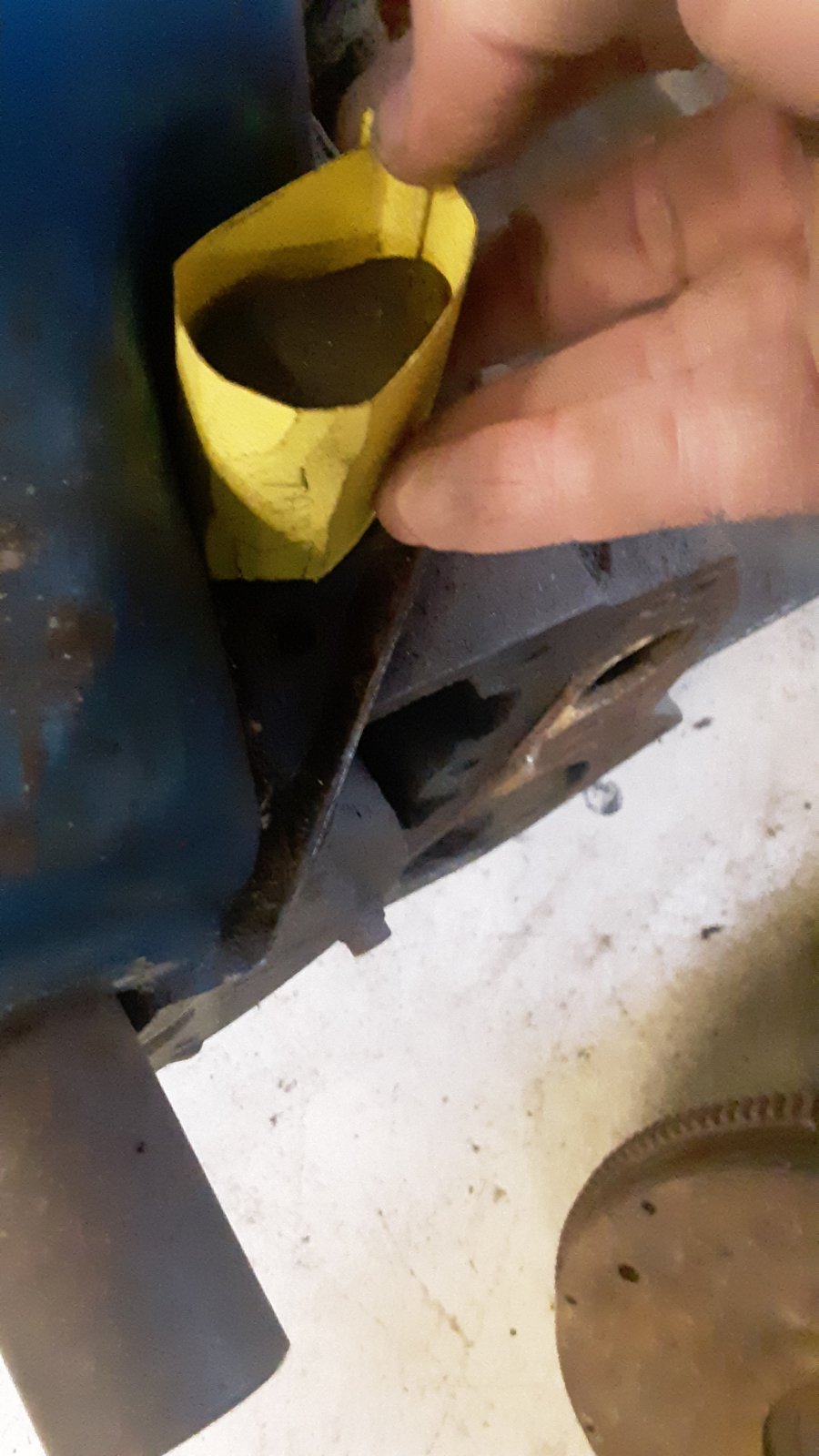

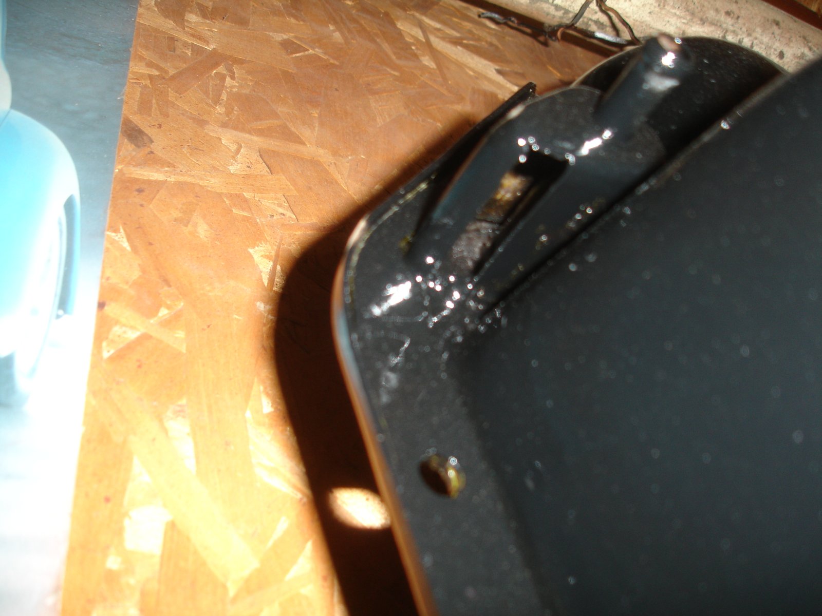

    As we make improvements the less invasive the better, yes? I didn't consider the vent cup on the pan, but that plays. Upon closer examination of the Zephyr here and it's stuff it seems that after 91,000 miles there's little to no detriment of just venting the case vapors right back into the engine. AND it is a vacuum source albeit at the carb airhorn vs full manifold vacuum and tempered by incoming air as well. This is the inside of the Zephyr air cleaner after all those years:
    The inlet for the vent pipe (shined a light in):
    My stock air cleaner inlet, which I plan to run for a whole season just to shake the car down:
    Again, I won't have full manifold vacuum but more than enough to help positively vent the case, especially at speed. The adventure continues and if this goes well and easy, yes as stated before my get up will also take a full on PCV gig but I'm not sure a stock flatty really needs much more than mild positive evacuation. Peak RPM is under 4,000 and highway cruise is 2600. How bad can it be? Why this direction; most non invasive add-on approach. No manifold removal or drilling, simple air cleaner mod and well, you gotta wait for the rest.

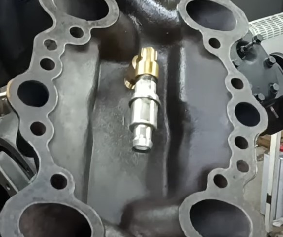

  10. Mart
    Posts: 5,045
    Mart
    I've fitted a pcv valve a couple of times and it is completely undetectable from outside the engine. This was used with a French block. I used a 59A pan and welded up where the road draft tube is.

    My instance is this, how can I do this without the angst of pulling the pan or the intake? I was caught unawares not considering the vent at the rt front of the pan. My engine is done, almost fully dressed and in the car. Had that dadgum Zephyr not showed up I probably would have just "let it eat" like Henry did. I whipped up a cover with additional volume by making a quicky posterboard template, rolled up some sheetmetal, and cut some ½" aluminum for an overall shape. I'm fortunate in that I have good 59A laying about, was able to sit right there and sort it all out. Just got a case of the *** about 4:30 and went for it. So far...
    20230123_165839.jpg 20230123_165923.jpg 20230123_170206.jpg 20230123_165955.jpg
    20230123_170049.jpg 20230123_170102.jpg 20230123_193803.jpg 20230123_193902.jpg 20230123_193827.jpg
    Next I'll cap it, tube it, find a molded hose then make a nice subtle tube going into the air cleaner. I was in the zone shaping and fitting and didn't get pics of the aluminum shape gauge. It will get a mounting tab to attach to that oil pan bolt, and I notched for the pan rail support bar. Next time...

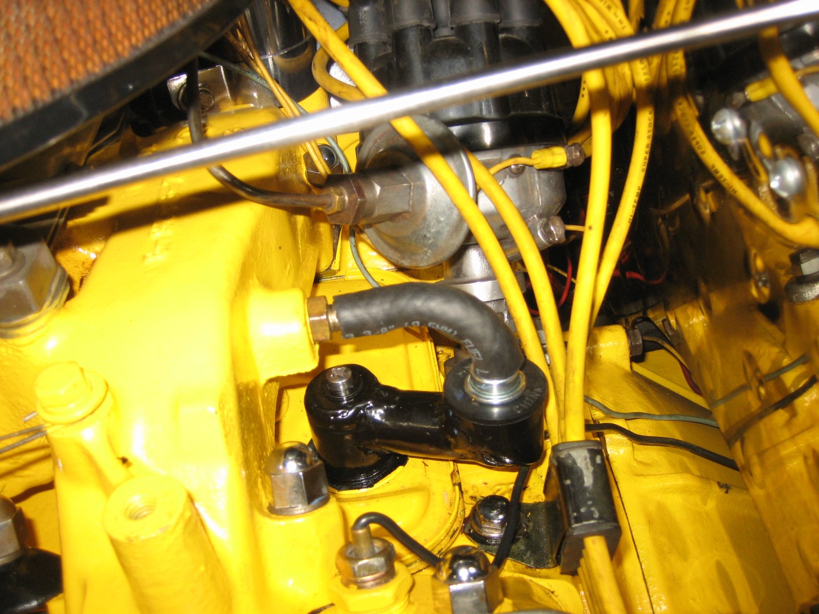

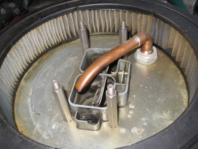

  15. Beanscoot
    Joined: May 14, 2008
    Posts: 3,854
    Beanscoot
    Here's how I vented the crankcase fumes. No chance of the oil mist pooling in the air cleaner and making a mess. Note this is a vent, not a PCV valve connection.

  17. Mart
    Posts: 5,045
    Mart
    Ron I had the valve vertical but it made a gentle shuffling rattle when idling. I put the 90 degree bend in and it stopped the rattle. I think I can hear it when driving at speed now, not sure. It could be something else.
    Rich. I carefully drilled and tapped directly in line with the dividing wall between the two runners. I then opened the hole out into both runners. I used this particular manifold because both runners are at the bottom of the casting. Many manifolds have an exhaust crossover that would make this job difficult.
    Note this is a certain type of pcv that flows towards the threaded end. Standard V100.
    I showed it in a couple of my videos.
