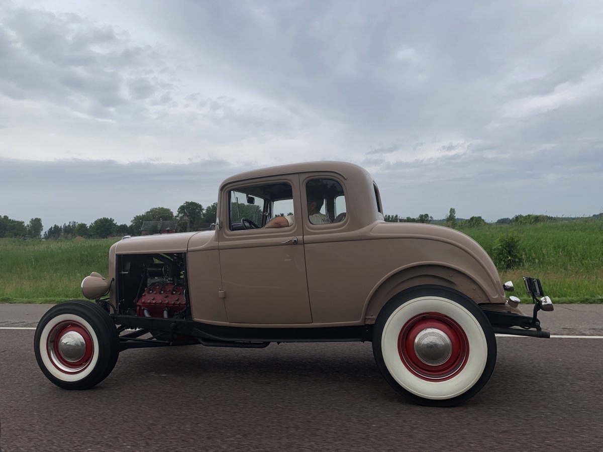

  9. xix32
    Joined: Jun 12, 2008
    Posts: 627
    xix32
    In my `32 5window with a 59a block, I used Red's Headers and 1.75" Diameter "J" pipes and 22" Smithy's, all from Speedway. And one straight section of pipe from my local Napa store. I cut and fitted up and welded all the pipe sections myself. Since I thought finding a muffler shop with a pipe bender that could get the bends right where you want them would be a challenge.

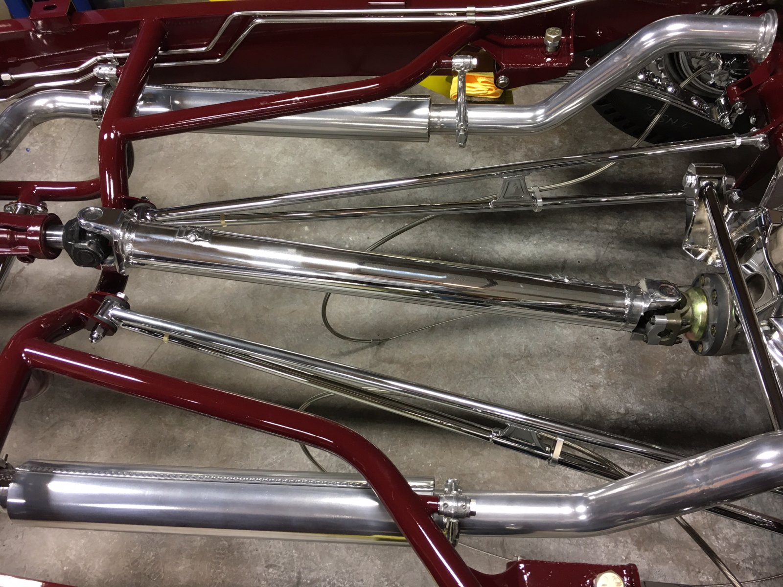

  22. Bandit Billy
    Joined: Sep 16, 2014
    Posts: 16,144
    Bandit Billy
    I see I posted but no pic, shame on me.
