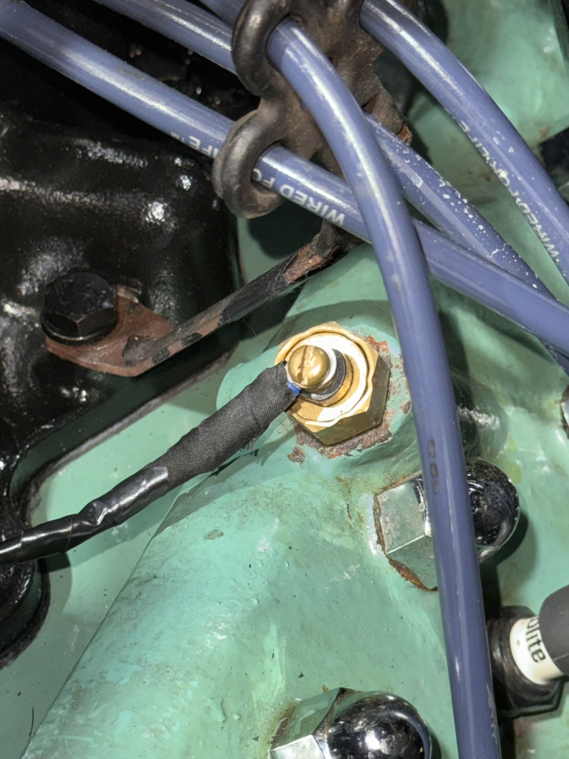

    Good evening. If an electric fan is being used with the flathead (8BA), can one of the sensors in the head be the electric fan temperature sensor wired to the two prong sensor in the other head or do they both need to be OG sensors?
    If anyone knows of a thread mentioning this please kindly share. I cannot seem to get a straight answer and because of this I want to just try it out and see if it works so that I may share if someone else has always pondered this question/setup.
    Also, I am currently using a 180 degree probe in the left upper corner of my radiator (I don’t feel this is reliable) and it seems to not activate the fan at the stated temperature, reason for my thinking. It seems to be kicking on at about 220ish degrees. Still using original temperature gauge. Any assistance to this question is appreciated.
    All in all I’d like to use the original setup/look with the exception of replacing the single prong OG sensor with the fan on/off temperature sensor if possible and have it still operate for the head/system as intended and as the OG would have. Otherwise, I’ll look at other possible alternatives. Thank you kindly in advance.
    **Pictures are of electric fan probe and current OG head temperature sensors.
  16. Bandit Billy
    Joined: Sep 16, 2014
    Posts: 15,701
    Bandit Billy
    It'll work. The two heads have different temps but close enough for that fan sensor. I stuck mine in the bottom of the radiator and I have had no issues for several years. I have two temp gauges in the dash and they read 15 - 20 degrees different side to side (who knows if the gauges are actually correct). I have tested them with an IR and they are close to accurate. Hope it helps.
