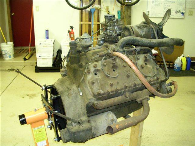

    4TTRUK
  17. Merc cruzer
    Joined: Feb 26, 2009
    Posts: 286
    Merc cruzer
    from Colorado
    Maybe this will help.....

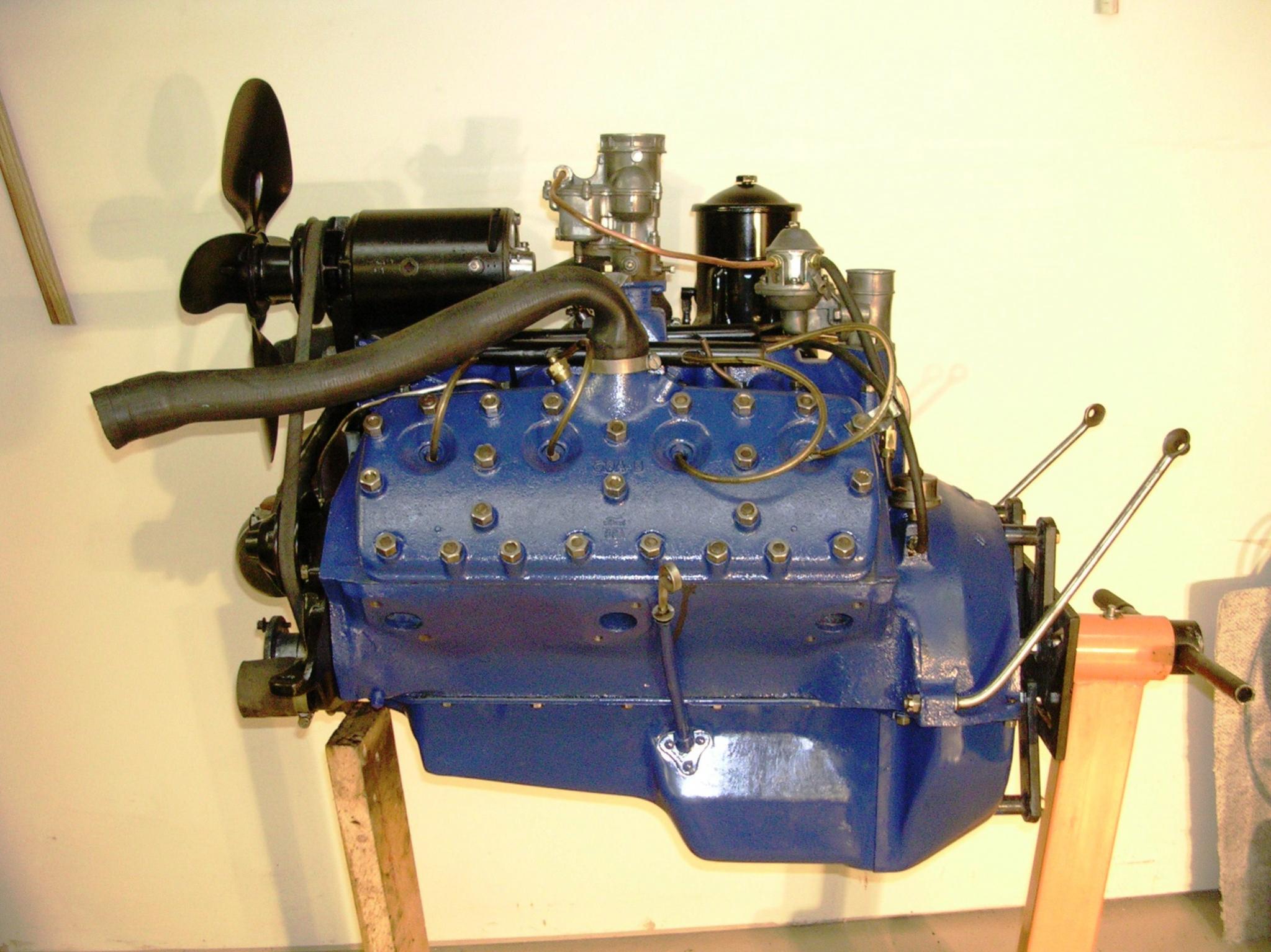

  19. Dad's 1932
    Joined: Dec 3, 2009
    Posts: 205
    Dad's 1932
    from Santa Rosa
    Here are a couple of not very good pics but it gives you the idea . The back of the rod goes to the K member . The front to the engine above the starter in these pics . These are stock 32 Chatter rods . I modified the 8BA to accept them .

    Charlie:
    That is the way the engine came to me. This is the engine I bought to learn on and then cleaned up up and sold it for what I paid for it...$300. I was told it came out of a truck...maybe they were attached to the firewall. The guy I sold it to got a good deal.

    Maybe not, people will wonder why they were bent upward like that, stock they are dead straight. Bob
