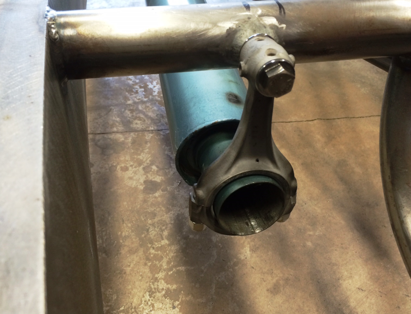

    I used 1.75" pipes on my flathead because that was the size of the 8BA connecting rods I used as pipe hangers.
    Dance with brung ya.

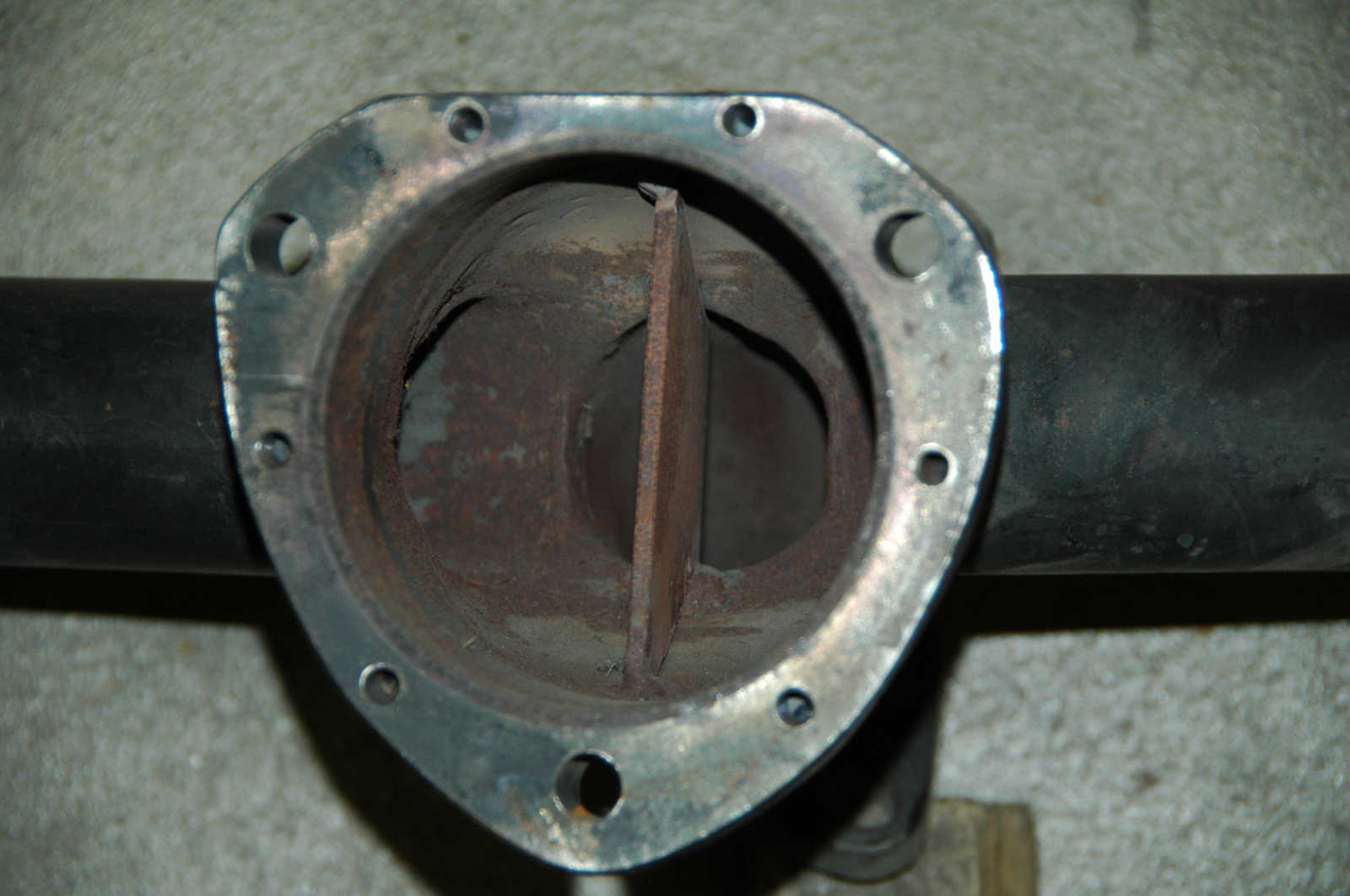

    My current engine is considerably bigger at 321 ci. The lead pipes is 2 1/8 and the flange outlet is 4 1/2.
    Don't skimp on size for exhaust pipe. With flatheads, bigger is ALWAYS better. I have used this same size header on 276 ci engines.
